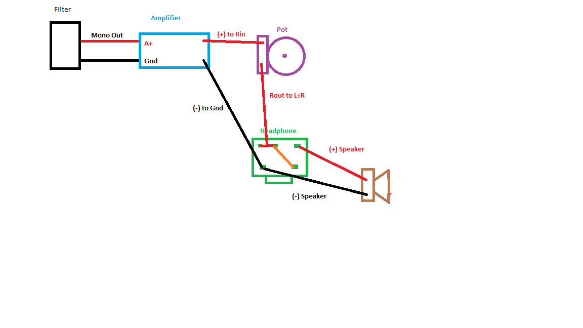

ktechelonbreak
Posts: 78
Joined: Wed May 04, 2016 10:07 pm
Re: USB Audio Wiring Diagram
Post by ktechelonbreak » Thu May 19, 2016 9:48 am
I made a similar schema before for audio setup here:
The setup is for the low pass filter but will work with USB audio as well. Just mix L+R out to A+ on the amp. You get mono sound in headphones but it's the only way I found to get volume control on 1 pot.
I actually omitted the amplifier because it didn't seem to make much of a difference. The USB audio gave enough power that the speakers were decently loud (using 8ohm 1W speaker from Radioshack, it fits perfectly into the slot). In this scenario just take the L+R out and connect straight to Pot Rin and GnD straight to headphone GnD.
