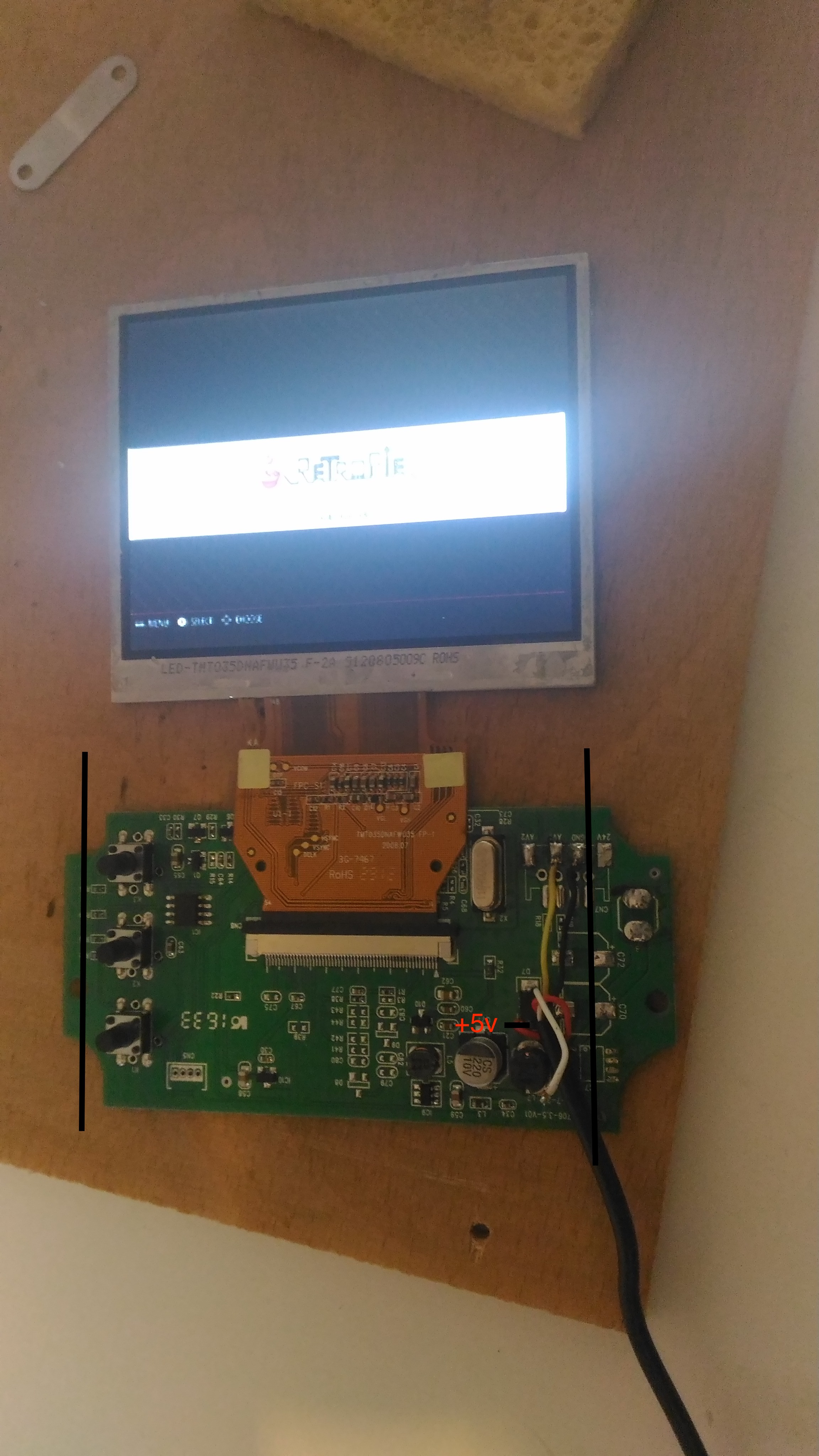

Hello, i've buyed this screen from Aliexpress.
How can convert it to 5v?
How can fit into DMG-01 Case? What part i can cut?
Please Help!

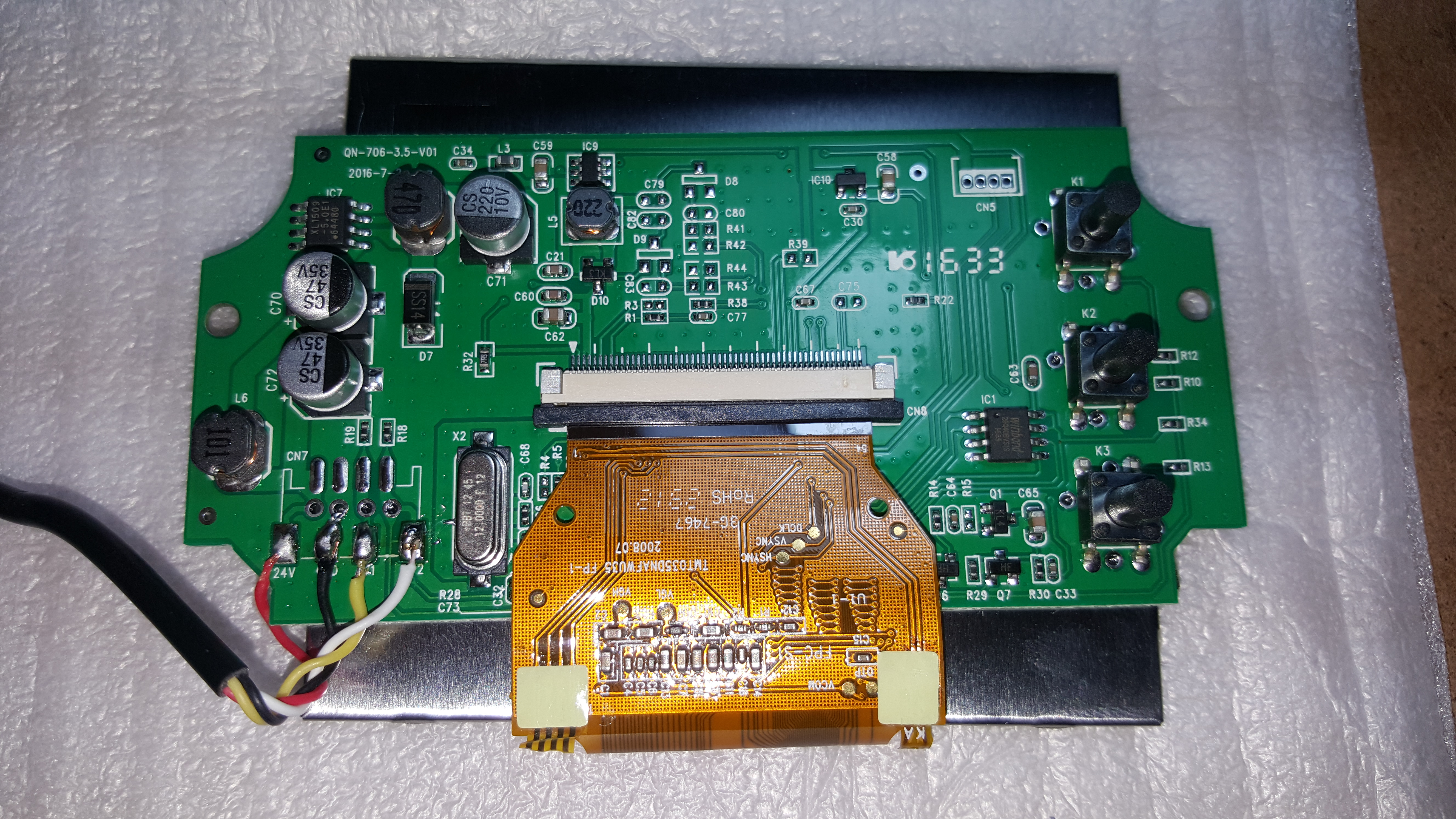

You need to desolder few parts and convert driver to 5v only:
here is how my mod :
Maybe you can remove entire button part to save more space but haven't tested this and you will loose ability to adjust contrast/brightness.

I do not see the image well, the white wire is soldered?
where ?

in my image white is unsoldered, but you can leave it soldered to AV2 or completely remove and use just 3 wires

hi all, i have this same pcb, but also with your images, i have this problem:
[youtube]https://www.youtube.com/watch?v=f4vAgs4lINo[/youtube]
Why?

To reduce the pcb, can i cut in this way without error?
