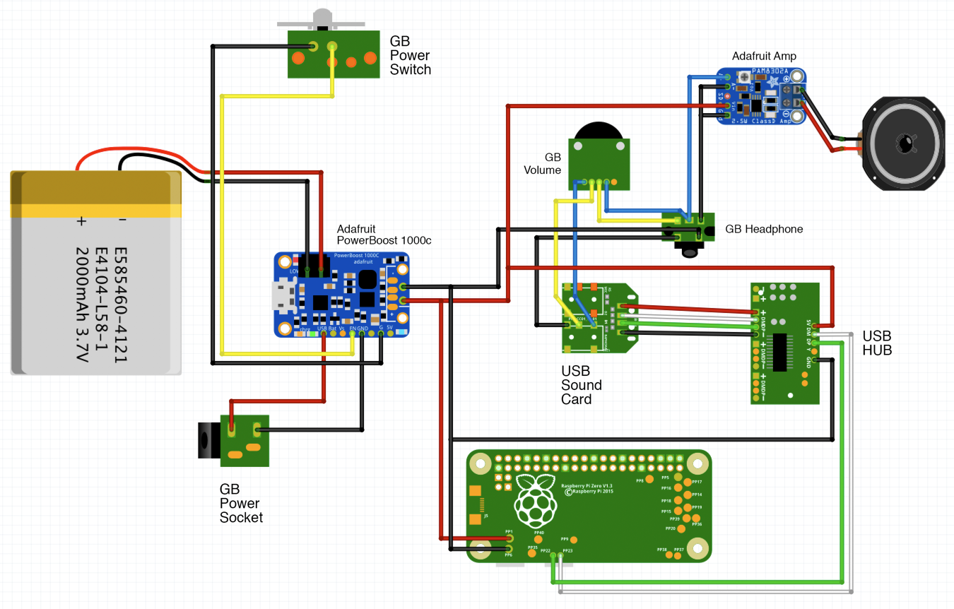

hi guys,
i need some help with my audio wiring.
i'm using a VIVANCO USB 2.0 Audio Adapter
with a Adafruit Mono 2.5W Class D Audio Amplifier and original DMG jack and potentiometer but cant get any sound out of it.
my current diagram:
Does anyone have a working wiring diagram with the components?

Try this wiring. :)
An this USB Audio Fix
https://github.com/RetroPie/RetroPie-Setup/issues/1312

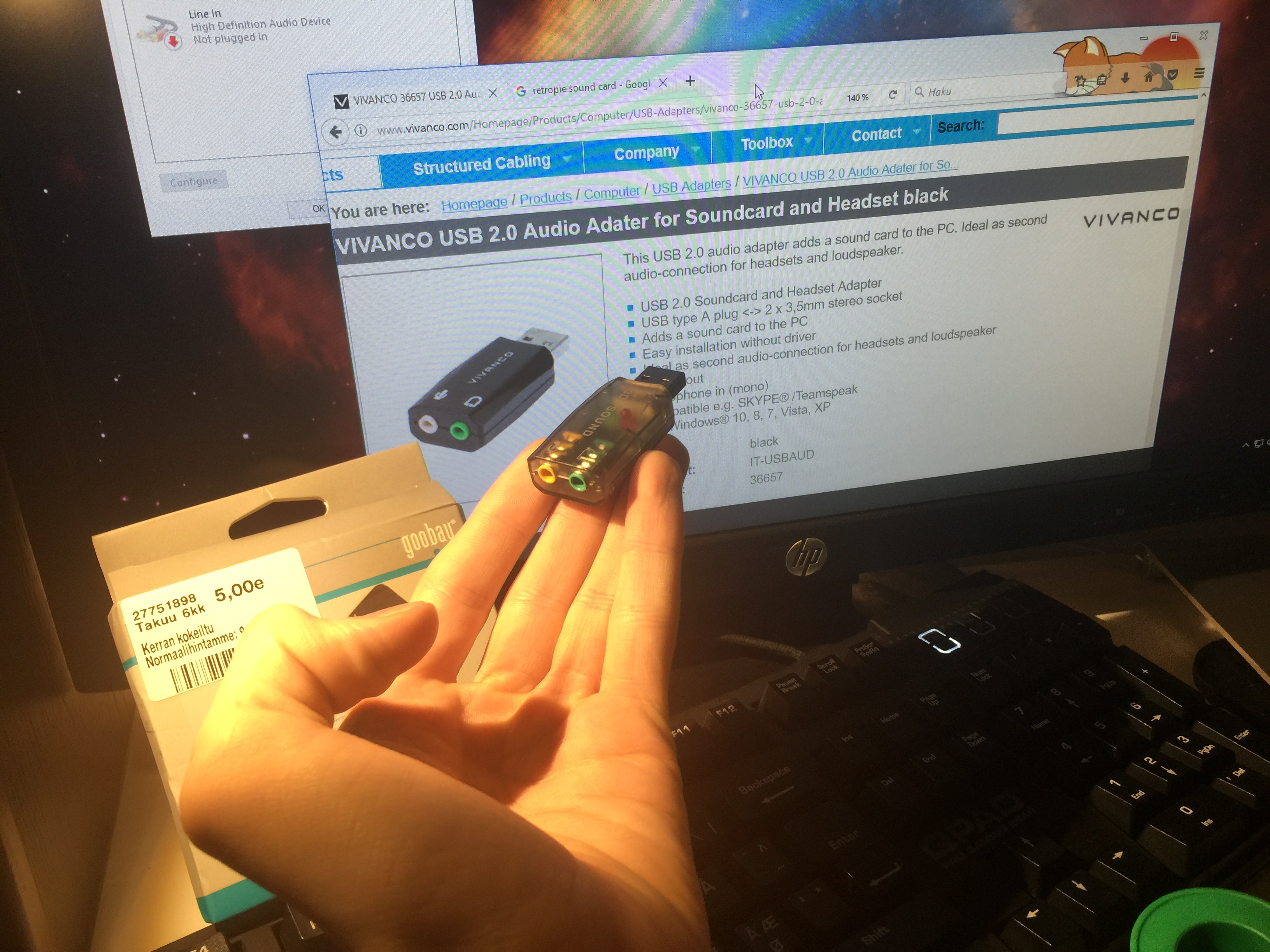

Did you get it working? By some coincidence I've got a very similiar looking dongle lying around. I haven't yet gotten any sound out of it even to external speakers through the 3.5mm plug.
