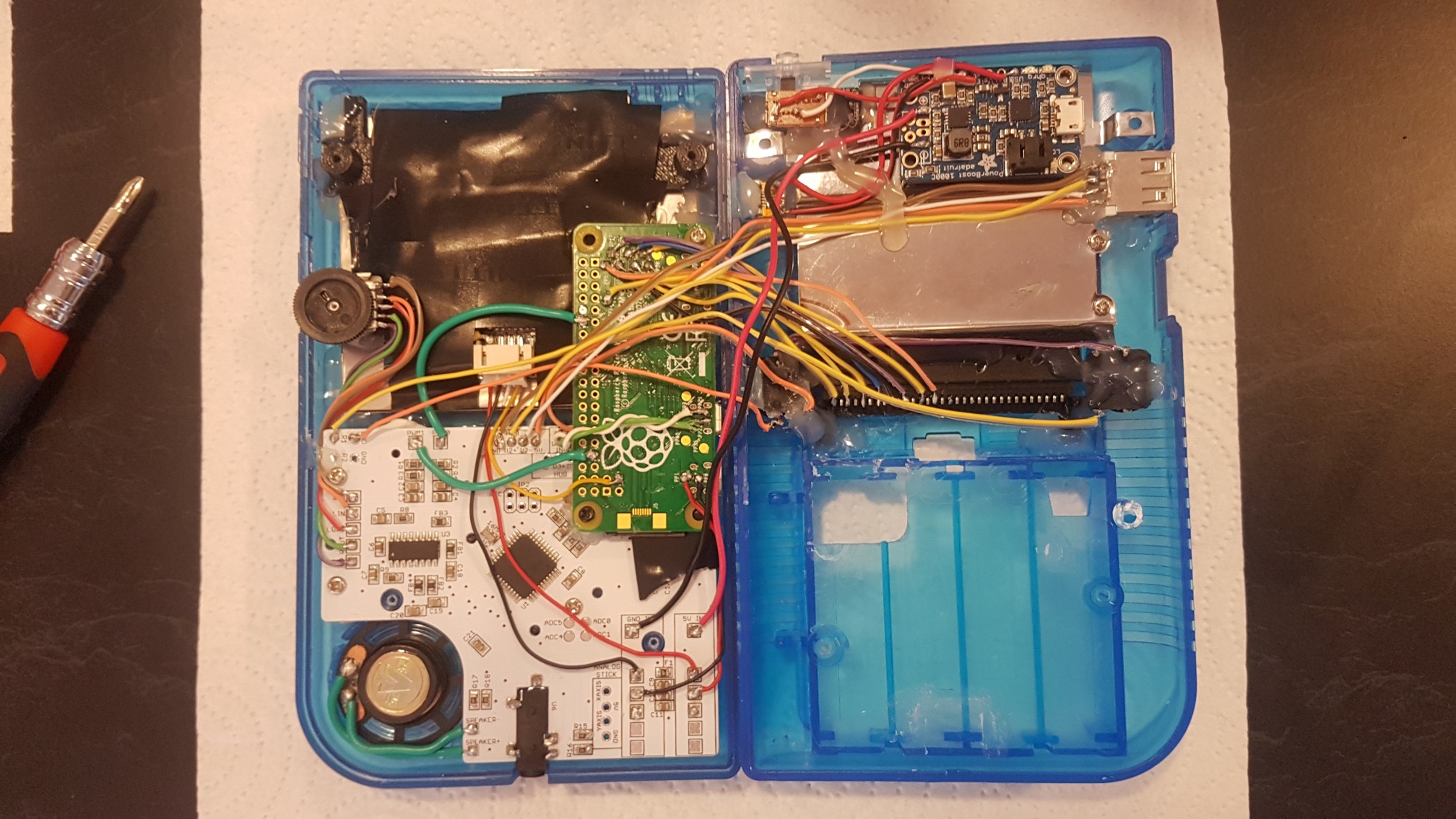

Re: Internal Organization
Post by rodocop » Tue May 23, 2017 12:50 pm
the thinner the wires the better. in my most recent build I used some wire from an Ethernet cable, IDE cable wires, and I used a slightly thicker gauge wire for power.
Also, if you damaged pp22/pp23 you can still use that pi for your gameboy. All you need to do is get an old microusb, cut the end, plug it in, and then use the wires coming from that to solder to. I had to resort to that in my very first gameboy.
Here is an image of my most recent one. It isn't the prettiest, but it closes nicely. (Also note, in the photo the battery compartment is intact, but I actually ended up cutting it out.
Wire managementShow
