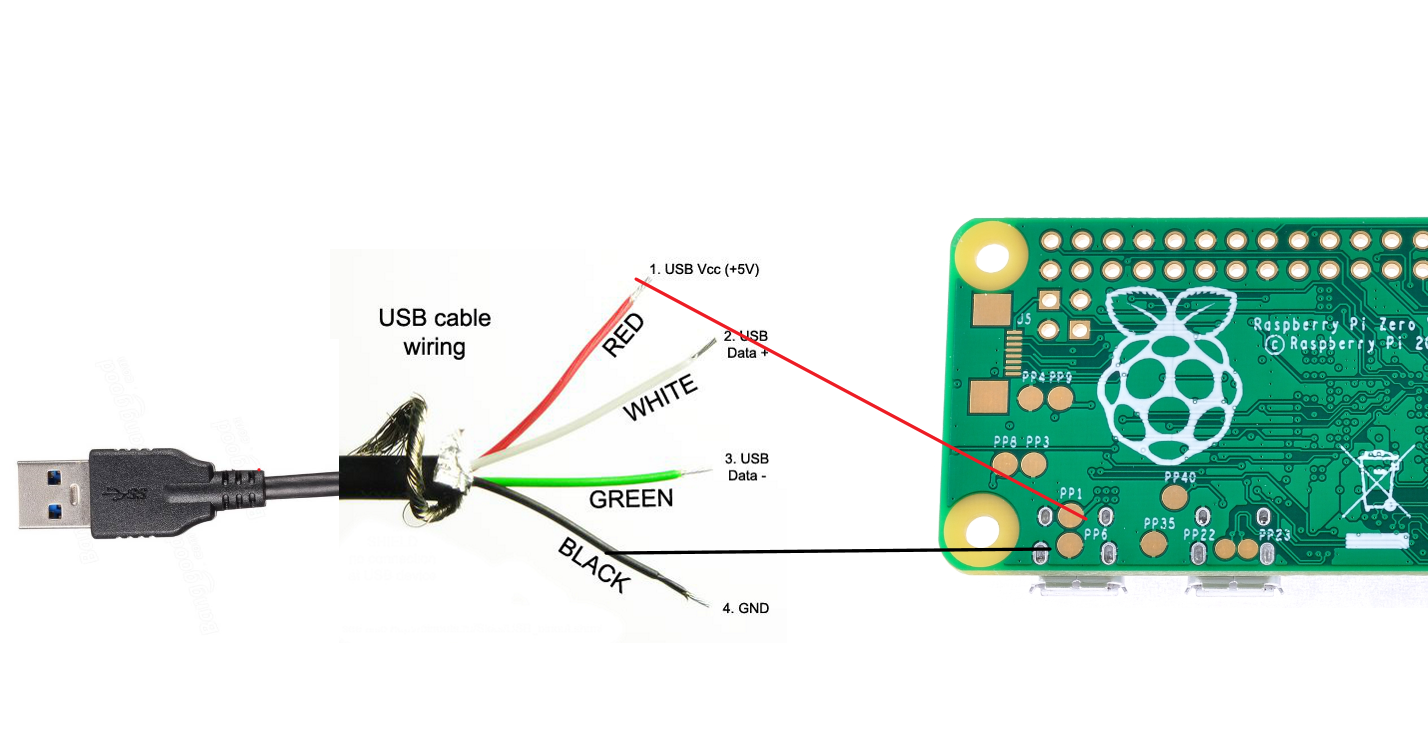

I wired my teensy to my pi zero by using this method, with the green and white going to PP22 and 23. Nothing seems to happen with my controls, I haven't tested it with a actual male micro USB to male micro USB but I'll try that soon.
I'm sure I did something wrong or missing something as I'm new to all of this.

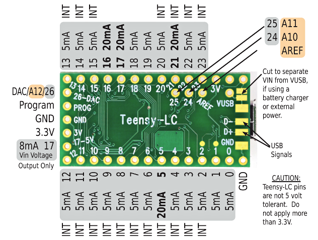

I used the VUSB for power and the D+ and - and ground.

If you could post a picture that would help a lot.
Did you twist the green and white wire to the Pi zero?
I connected a Teensy LC to a USB hub yesterday.
It didn't work at first as some connections where a bit loose and others where a bit bridged. Mainly on the USB hub which was a lot trickier to solder compared to the pads on the Teensy.
After making sure the connections were solid and didn't touch each other it's now working fine.
