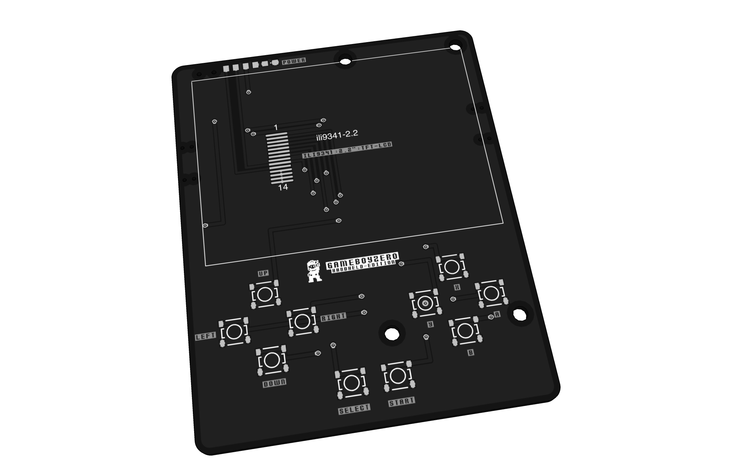

Introducing
Gameboy Zero - Handheld Edition
First off, i have to give credit to @moosepr for his inspiration in creating this.
It is essentially built off of the of his dual stick single board with the ili9341 SPI TFT
What i changed (added)
  • Some super sexy silk
    Widened the board
    Lengthened the board
    Changed joysticks to tact switches
    Added shoulder buttons
    Spent some time doing hand trace routing... ...cus i'm ocd that way ;)
Here is the current GitHub repo.
Money ShotsShow
I am not planning to go into production (except for my own personal use) as this idea belongs to someone else, i simply modified the design :oops: but with blessing from the original creator, i'd love to collaborate
When you have a chance, check out the source, it's under OSH License, so use as you see fit
Thanks (especially to @moosepr)
And as always, everyones feedback (both + and -) are welcome

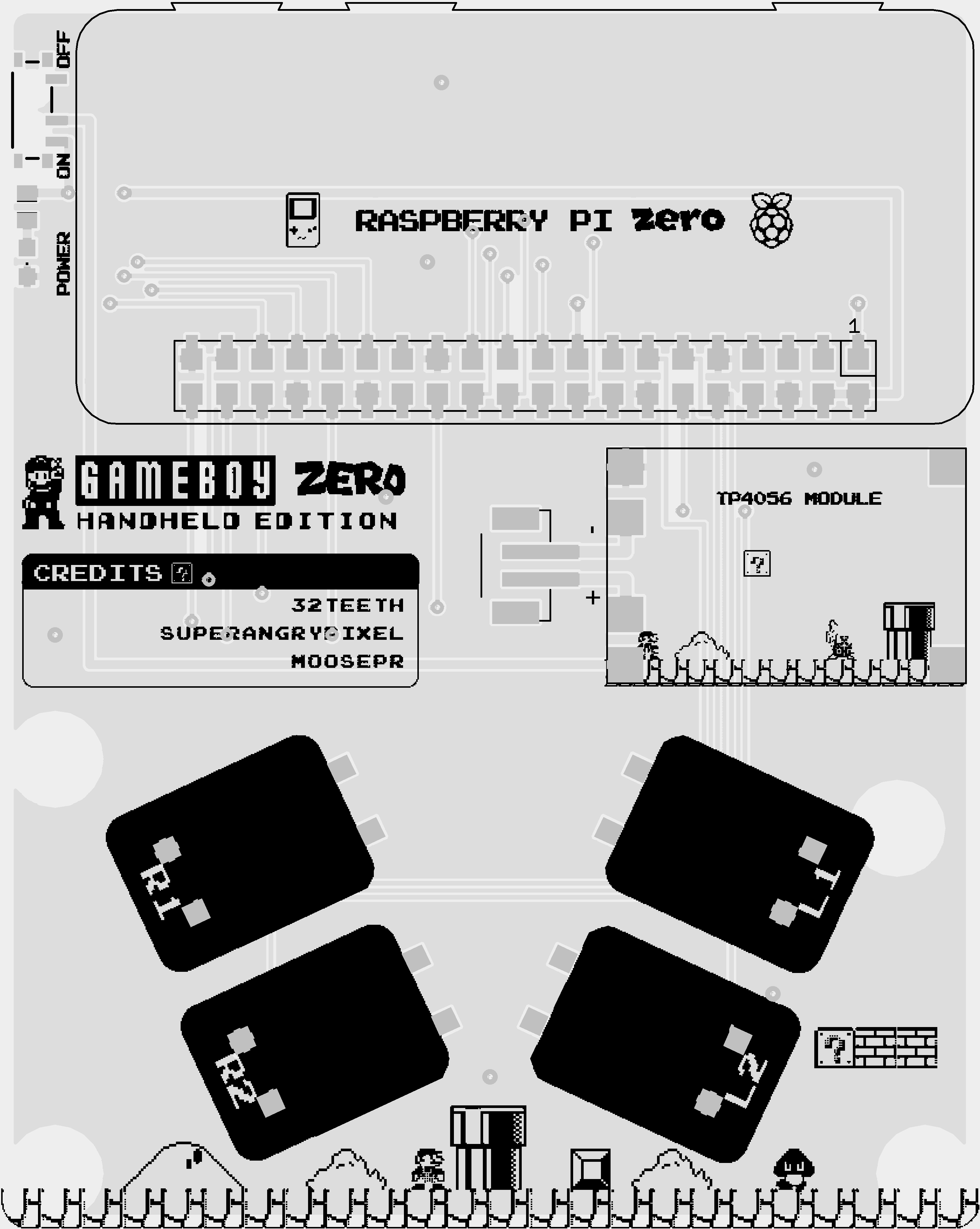

Post by moosepr » Fri Aug 18, 2017 5:30 pm
Ooh nice work there! One thing I will say, your right shoulder buttons will actually clash with the pi zero! It sits flush with the pcb

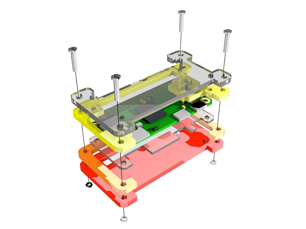

i have. but what i think i may do is have a layered plexi case similar to the pibow pi cases
layered caseShow

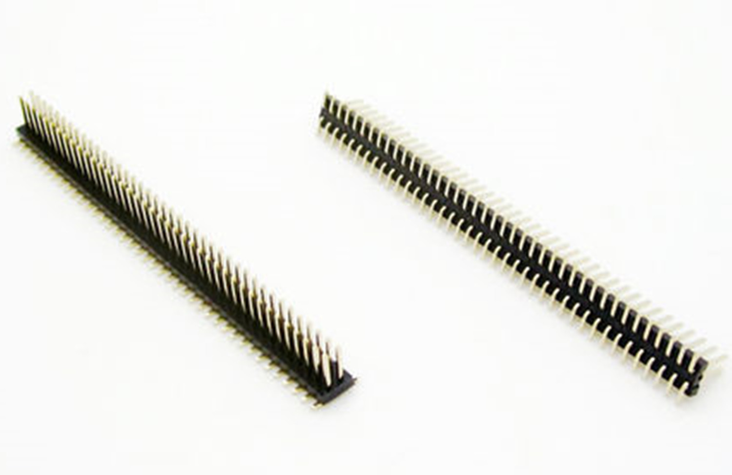

I did consider that and have ordered the first run of PCBs from Seeedstudio.

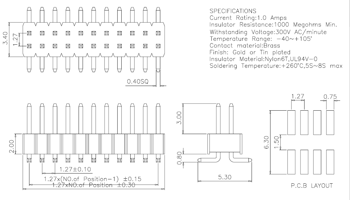

The first intent is to have male smd header on the board, and the fit the pi on to of that.
male headers smdShow
if the consideration is to have the board flush agains the pi, i may move the pi in slightly.
You insight is valuable and appreciated as this is inspired by your project.

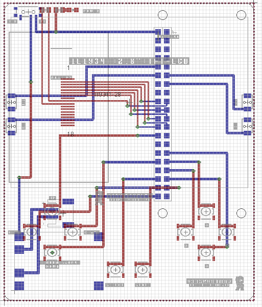

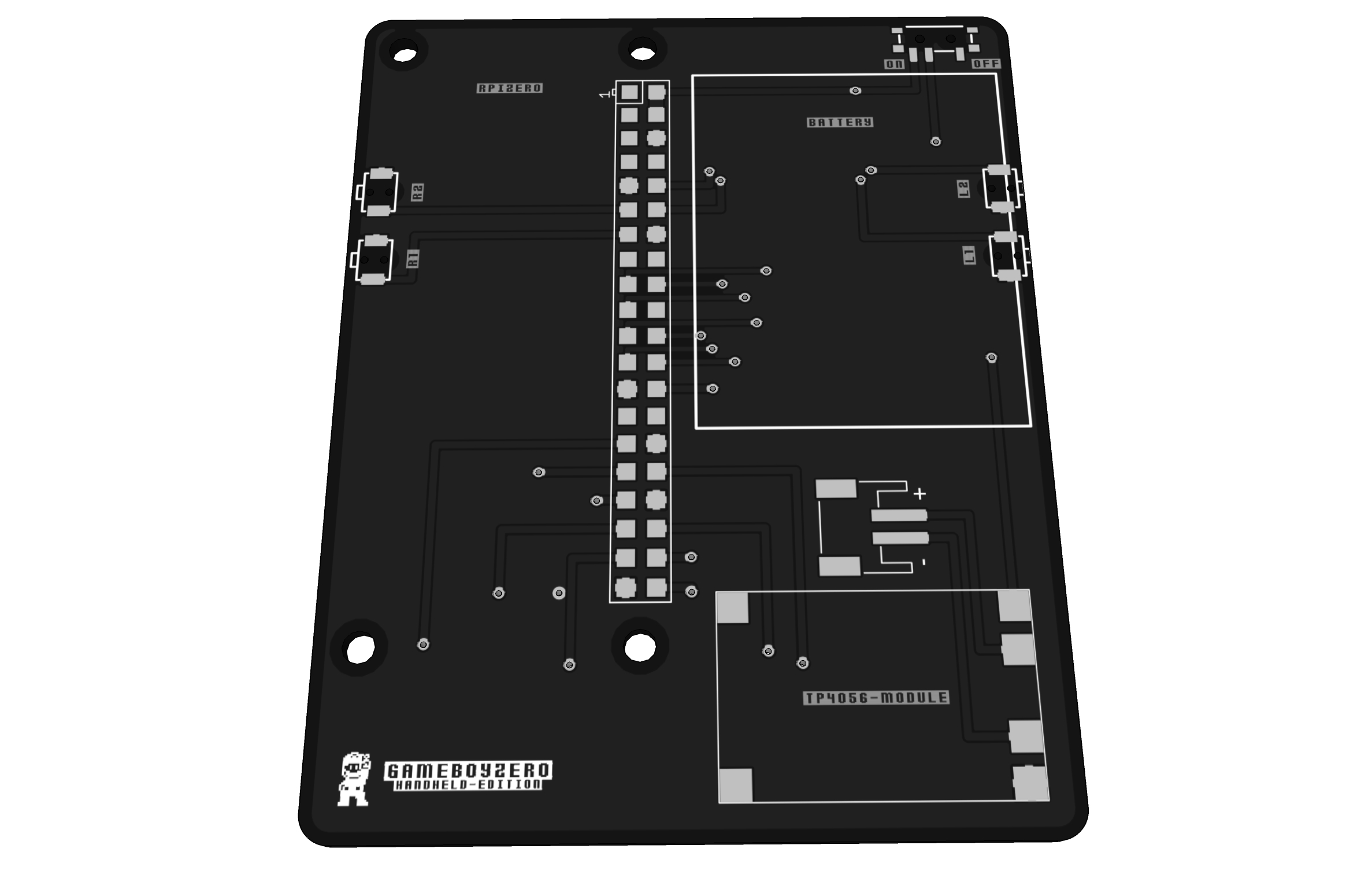

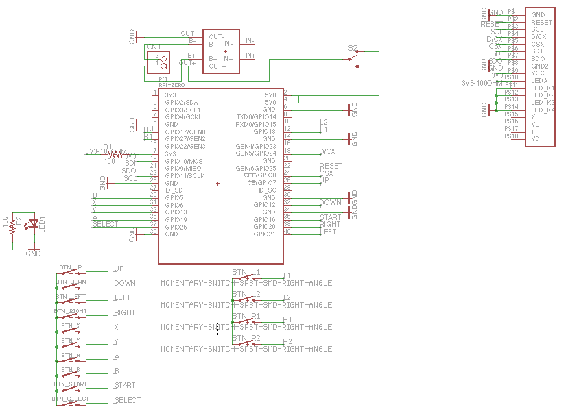

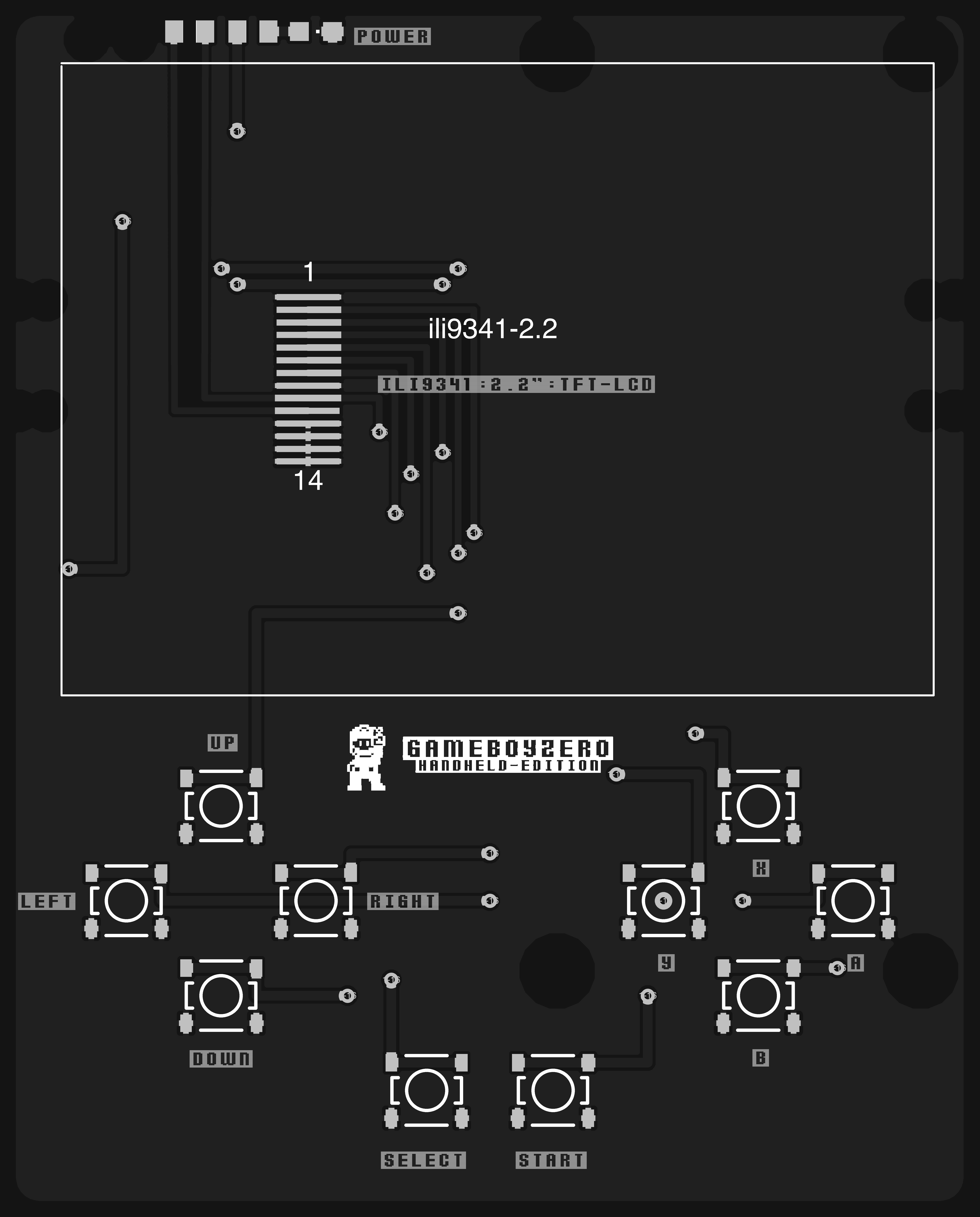

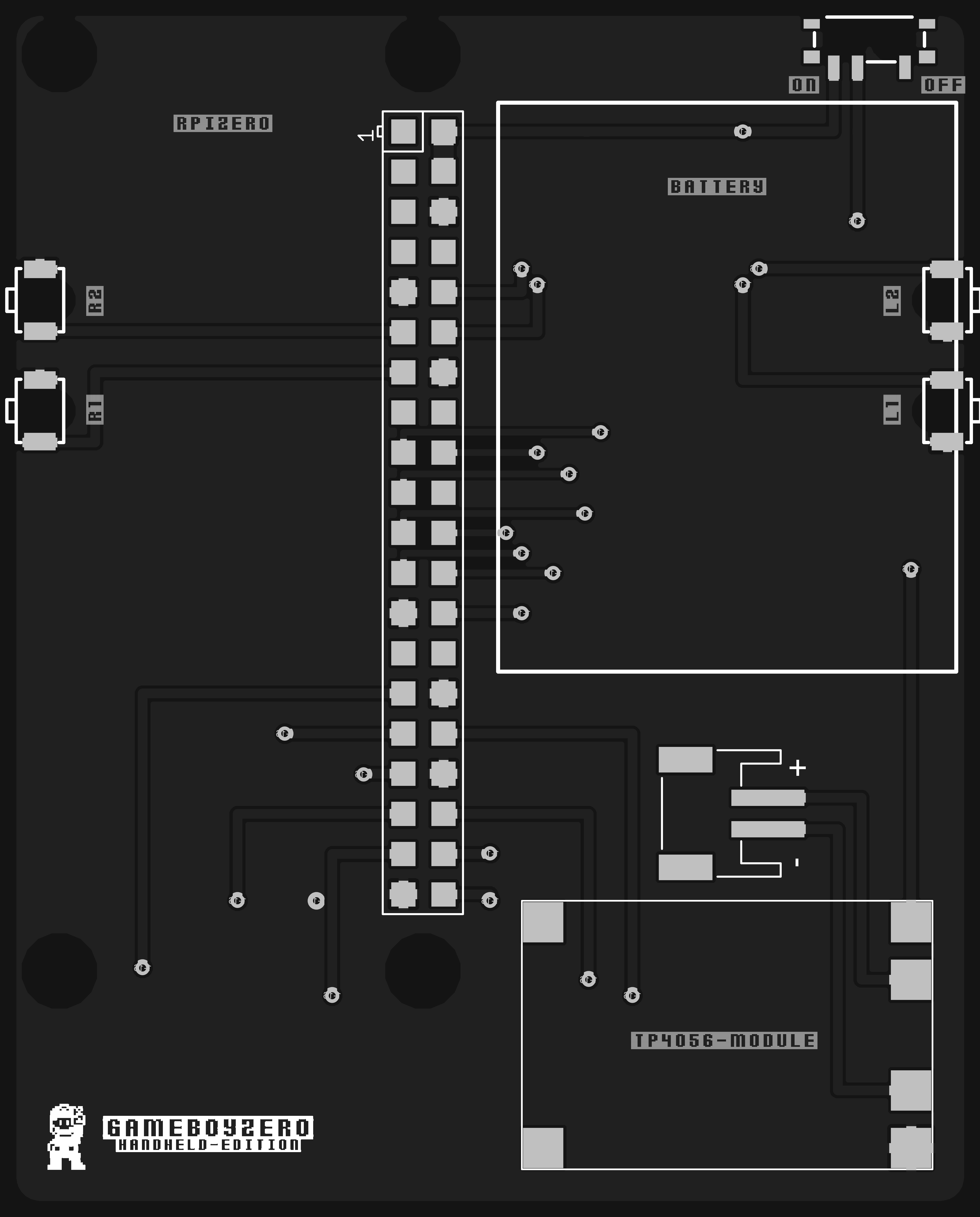

The GitHub repo contains the 2.2 as well as the 2.8 version with battery outlines on the back (you know, so you can double side tape it)
2.8 inch version schShow
Screen Shot 2017-08-18 at 8.38.37 PM.png (47.7 KiB) Viewed 12703 times
2.8 inch version brdShow
Screen Shot 2017-08-18 at 8.38.48 PM.png (59.69 KiB) Viewed 12703 times

Post by moosepr » Sun Aug 20, 2017 2:35 pm
You might need to be careful with the smd headers. When I did the pi footprint, I took a standard zero footprint and changed the though hole pads to smd pads.
The smd header pins actually need slightly different pads due to the "legs" sticking out
The danger you have is that you cooper pour is tied to ground, and your overhanging pins will be at risk of touching that as well as the intended pads

Post by 32teeth » Sun Aug 20, 2017 6:31 pm
Again, great insight
I'll revisit the eagle drawing and see what it looks like simply with the amd header instead of Pi pads
Now that the general layout is good. I may just put the zero outline on the board

Post by 32teeth » Mon Aug 21, 2017 7:44 am
This one should work well
https://www.digikey.ca/product-detail/e ... -ND/614772
As you will note from the trace route of the board, i intentionally kept everything around the 2x20 connector at right angles, and the traces come straight for a bit until they take turns
It was done just for that reason you mentioned!
Screen Shot 2017-08-21 at 9.43.11 AM.png (24.11 KiB) Viewed 12599 times
Again, good insight from you
Thanks for sharing

Post by moosepr » Mon Aug 21, 2017 1:10 pm
You should probably be ok. A line of kapton tape each side of the connector should keep things safe. I'm actually thinking of redesigning my pads for the zero so they can be multi use
[edit] I have been adding some 'fingers' to the zero footprint i use. If you use eagle you can have it if you like?
