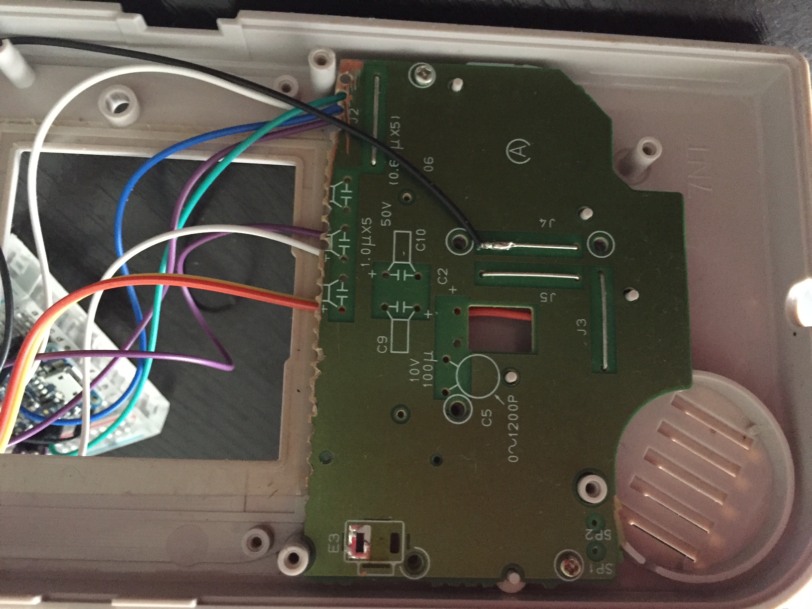

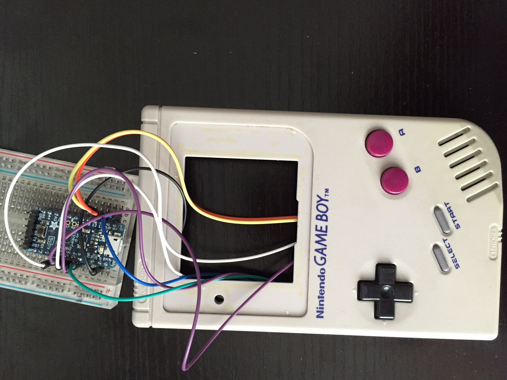

Hi All
Just a FYI, i am planning to use a Adafruit Pro Trinket 5v instead of the teensy only because thats what i currently have with me.
Works ok, have modded the PCB and works with the code below, works but not too pretty.
Just follow the tutorial on the adafruit pages https://learn.adafruit.com/pro-trinket- ... d/examples
Still need to mod the case for the extra buttons.
