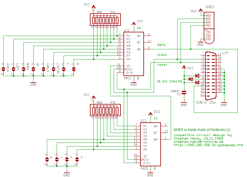

I've also been wondering this and was considering finding a USB gamepad chip (no luck) then thought why not rebuild the SNES pad circuitry (I built a SNES arcade stick including the circuit a few years ago) It's a very simple, 2x chips and a few resistors. I managed to buy enough 4021 SMD shift registers and networked resistors to build 25 SNES pads for under £10 (Price of 1 Teensy) and the SMD parts are small enough to sit on the button side of the DMG controller board taking up no space, then it's just 5 wires to the GPIO and support for SNES pads is built into RetroPie

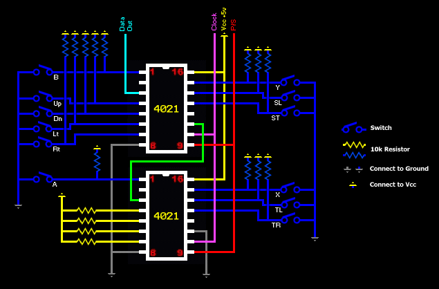

One of the early blog posts on the retropie blog showed the SNES pad interface.
http://blog.petrockblock.com/2012/07/19 ... bly-guide/
its supported by the GameCon_GPIO_RPi Module
https://github.com/RetroPie/RetroPie-Se ... n_gpio_rpi
you can connect a SNES pad directly to the gpio headers with only 5 pins rather than a pin per button +GND
I have included two SNES Circuit schematics below, the top one (Black BG) is easier to work from but the bottom one has the SNES port included
I will make a full wiring diagram for this soon. I haven't even started assembling my GBz yet even though I have been planning and buying parts for it since October

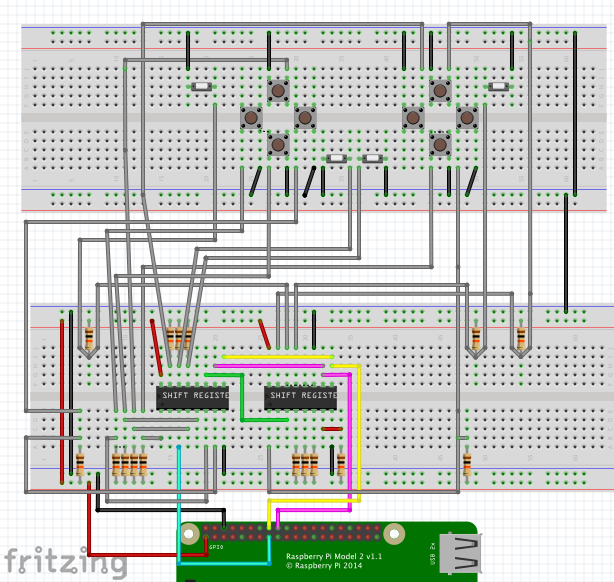

Post by FreddySalted » Sun Jun 26, 2016 3:02 pm
Here we go, I've thrown together a quick breadboard design in Fritzing. it looks a little messy but it's cheaper than a £10 Teensy at under £2 for a pair of 4021 Shift Registers on eBay (much cheaper if you buy in bulk) and a handful of resistors
