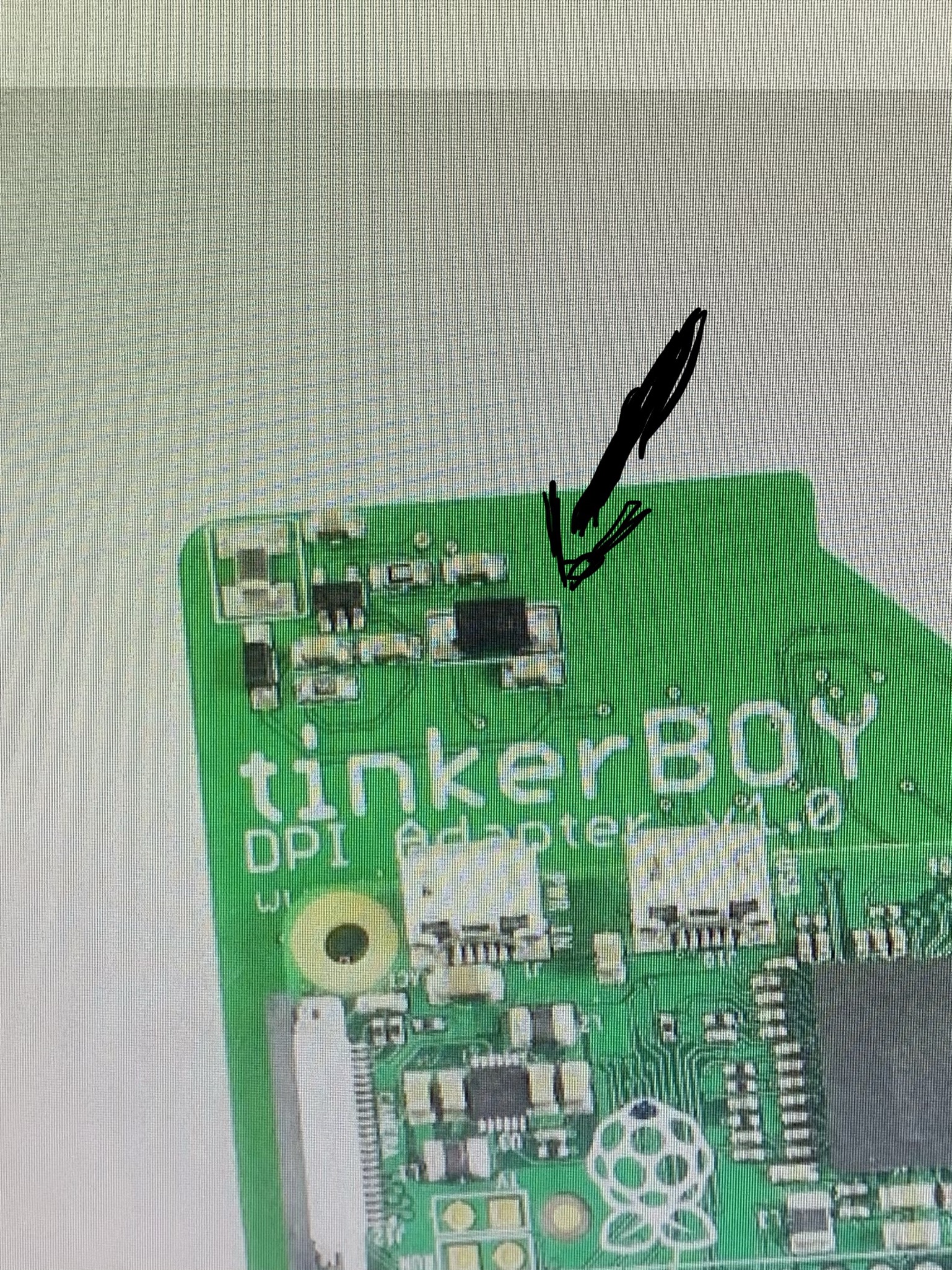

this is the led driver you need use by tinker boy and othermod dont know the part number on top off my head send tinker boy a dm

That's a diode, dude. This is an LED driver and the ic I was referring to...

I’m so sorry I was on a bumpy train ride without my glasses. I had a similar heat problem when I made one of these I replace with this one problem solve

Ah no worries, thanks for the tip. Do you have a link to the data sheet or where I can purchase this driver? I've googled 1N6HJ but it just returns one relevant link but it's all in Chinese.

Read the FAN5333 datasheet. It says it's recommended to have a Zener diode for open-circuit protection. The diode you're using is too small and might be the reason why the fan5333 gets very hot when no load or no lcd is plugged. Look for Zener diode in sma package with atleast 24v rating. The fan5333 is also very picky on what inductor to use. Try the recommended parts on the datasheet.

For the Zener diode I tried all these diodes and they all work perfectly fine.
For the inductor just buy a 10uh and around 1A rated.
