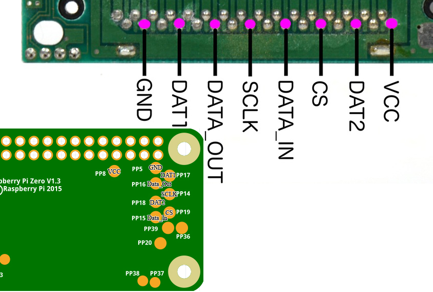

Hi so i am a bit confused as to the pinout and which items go where.
is this correct?
VCC-pp8
dat2-pp18
cs- pp19
data_in -pp22
sclk-pp14
Data_out-pp23
dat1-pp17
GND- to any ground or pp6?
This doesnt seem to match up with wermy's. i dont use pp15,or 17, and i seem to have pp22 and 23 that wermy doesnt use.

I'm having the same problem. I dunno much about SD pins. I had it the same way you do, and the pi wouldn't even turn on. As soon as I put the card in the pi itself, it booted right up into retro pi.
Kb's pins seem different. Either way, seems the way you have it up there (the way I did it too) doesn't work for me. Maybe I should try the other pins that wermy uses.

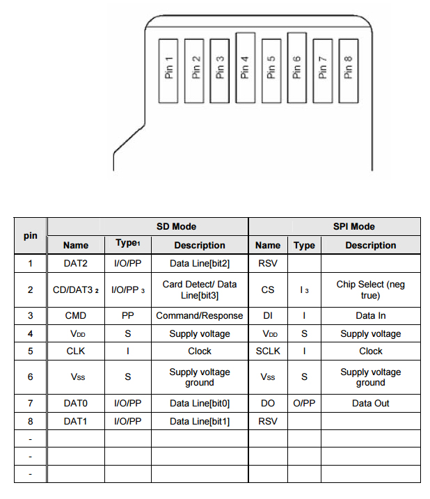

Based off this chart I was able to mock up a quick and dirty guide. I haven't been able to test it as I was having trouble getting the SD socket soldered to the board so give it a shot and let me know. I do know PP22 & PP23 are Data + & - for the USB interface, that should be used for the USB hub/Teensy. All SD pads are on the one side of the board.

Unnecessary but I can confirm the guide is correct.
