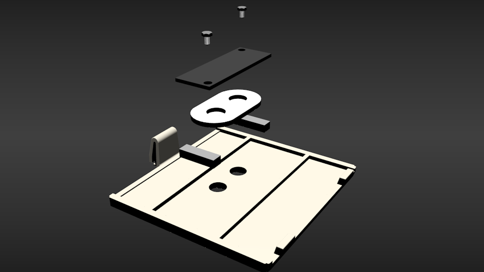

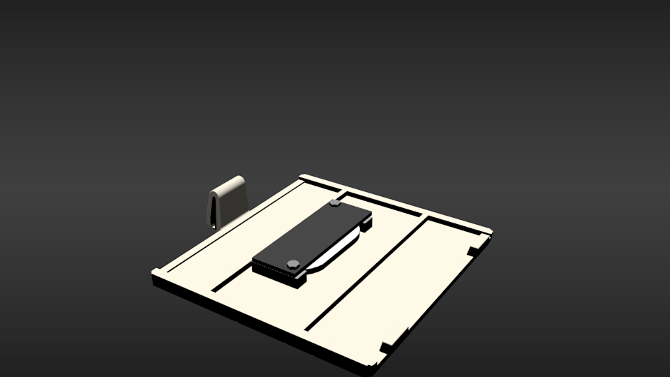

okay here's my plan. use the a/b button membrane as the backbuttons and mount the button board ontop using some plastic spacers which will be epoxied to the battery cover. don't have the board yet so I don't have all the dimensions needed for the spacers, but they need to be 3mm deep to clear the membrane.
the board is 1mm, the membrane 3mm, so any battery that would fit without removing the battery compartment ribs should fit with this rigging provided you shave off the compartment ribs.

You could have some thinner boards made quite easily and use kitsch-bent's A/B Silicone buttons to make things even thinner.

Post by rumblepen » Sun Mar 24, 2019 9:08 am
using silicon buttons was the original idea, but then I positioned a membrane to test out placement and I liked the smaller nubs better.
