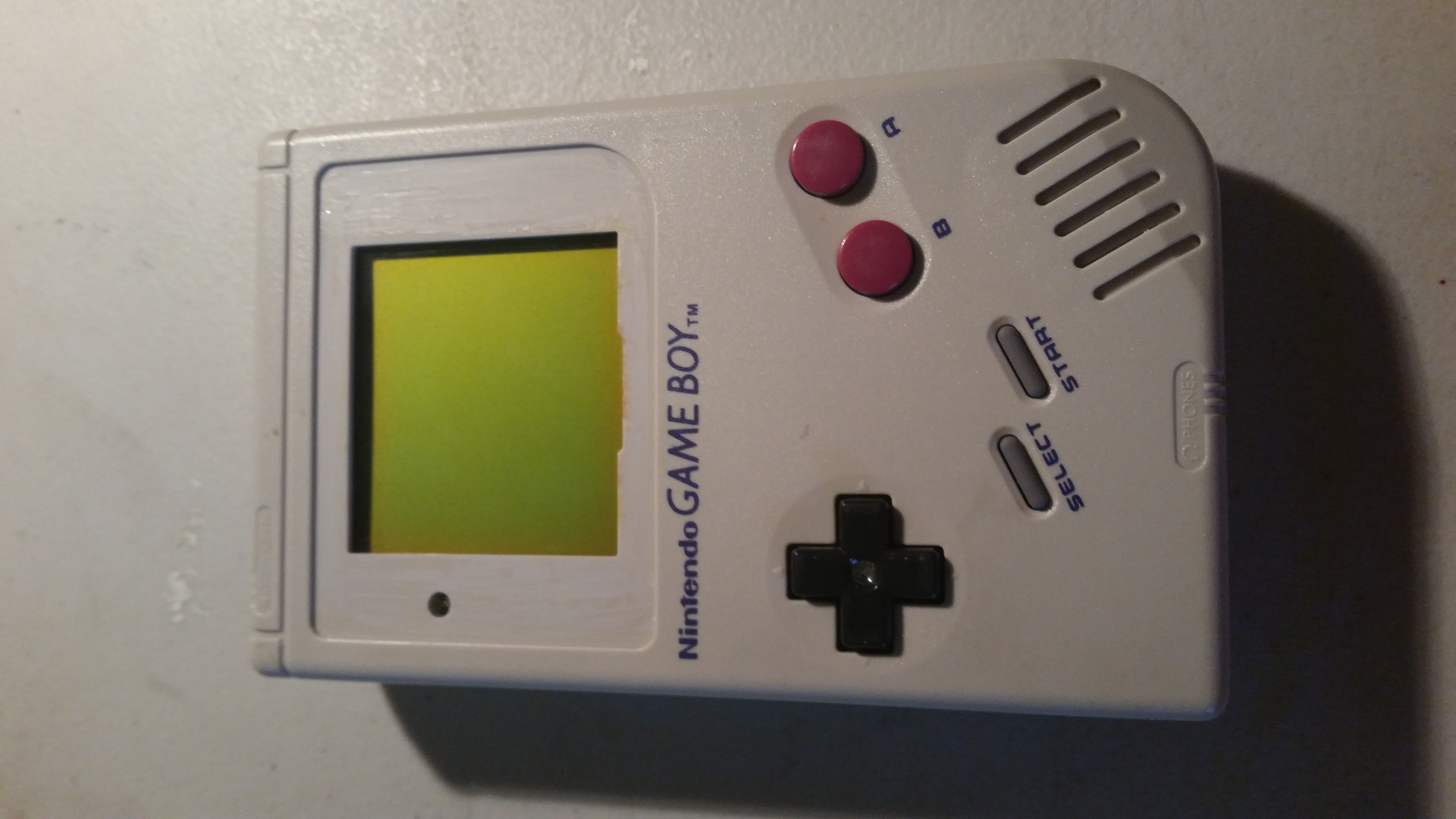

Heres my Gameboy! My original one from when I was a kid never abused it always took care of it but its sat in a closet for the last 15+ years thought Id breath some new life into it.

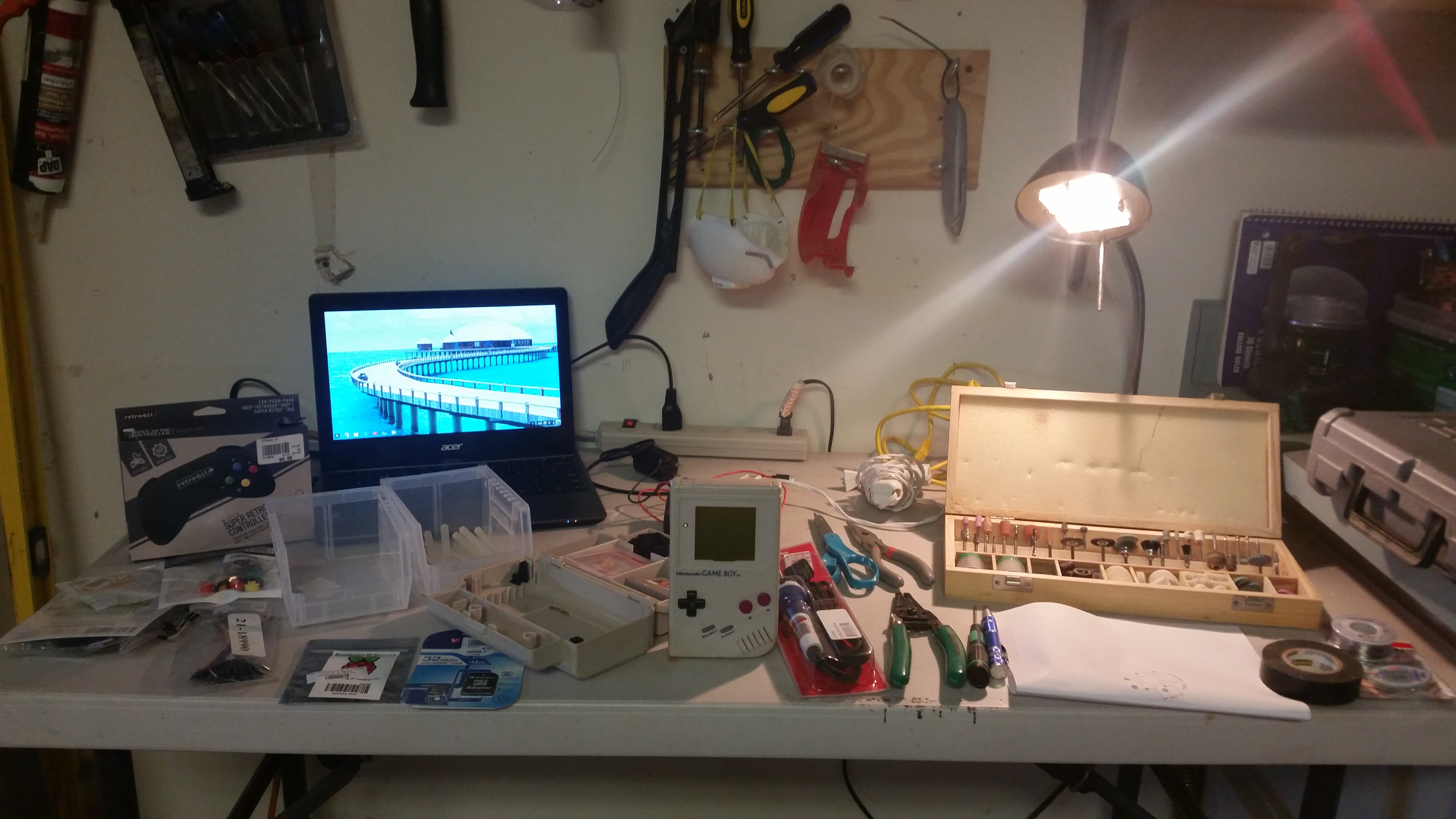

My workshop for the next few weeks! More tools and parts on the way. I'd estimate I've spent about $150 so far on this project and I shouldn't have to buy anything else. Luckily only tool I needed specifically for this project was solder equipment.

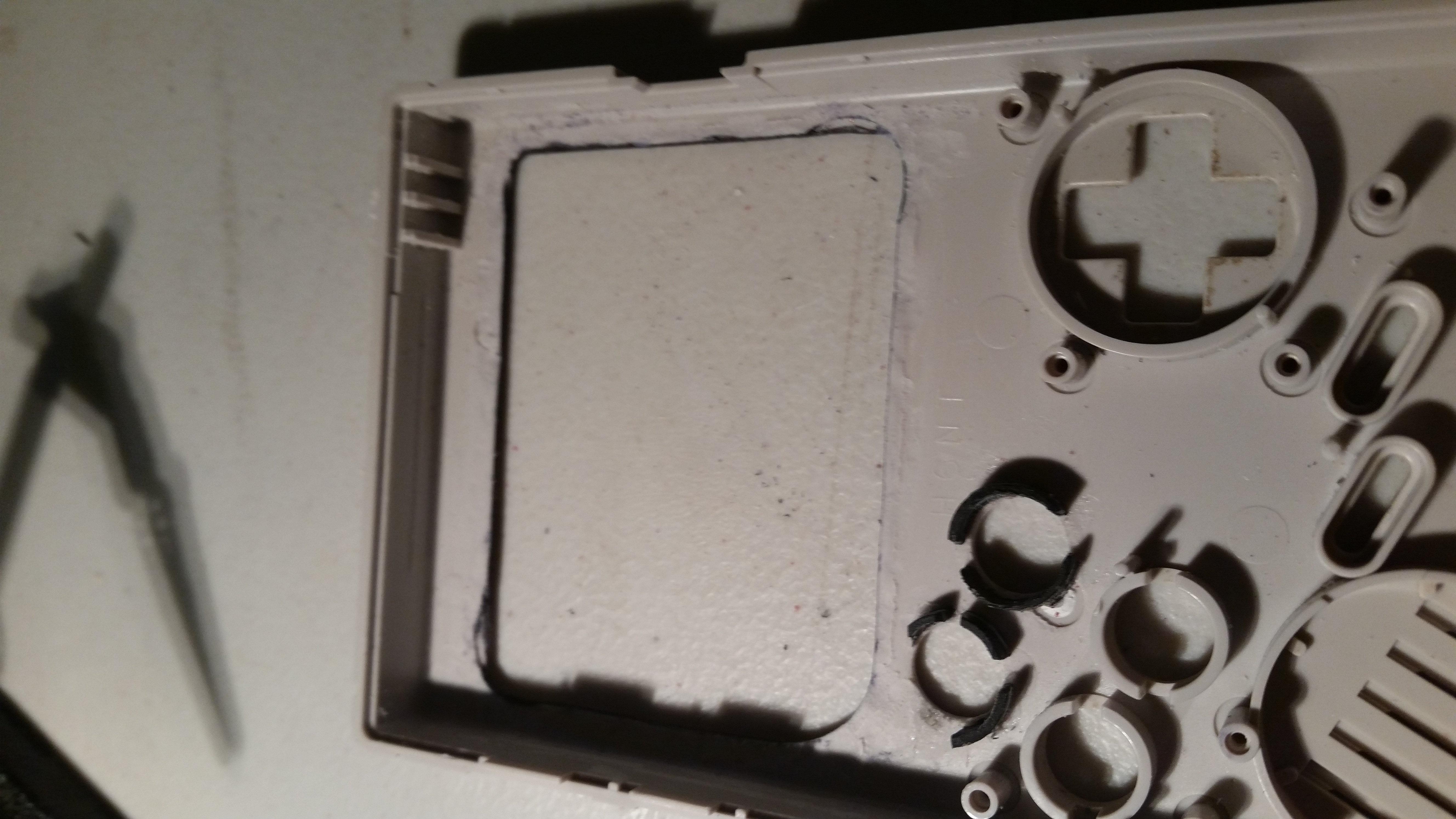

Case cleaned up pretty good, this is a rough draft It has been cleaned up a lot more since this stage

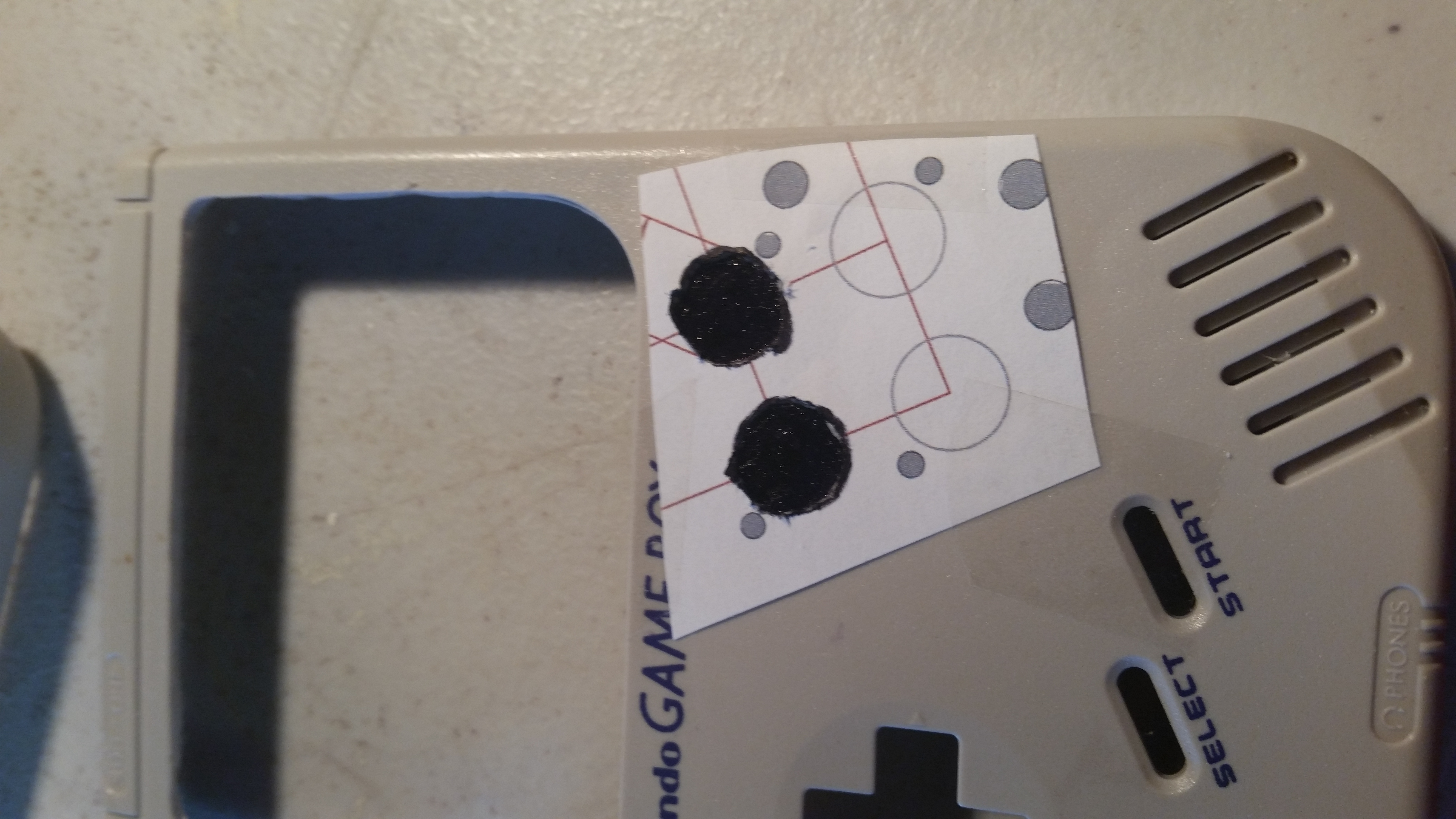

Pretty handy drill guide from the kitsch website where I ordered the button pcb board from.

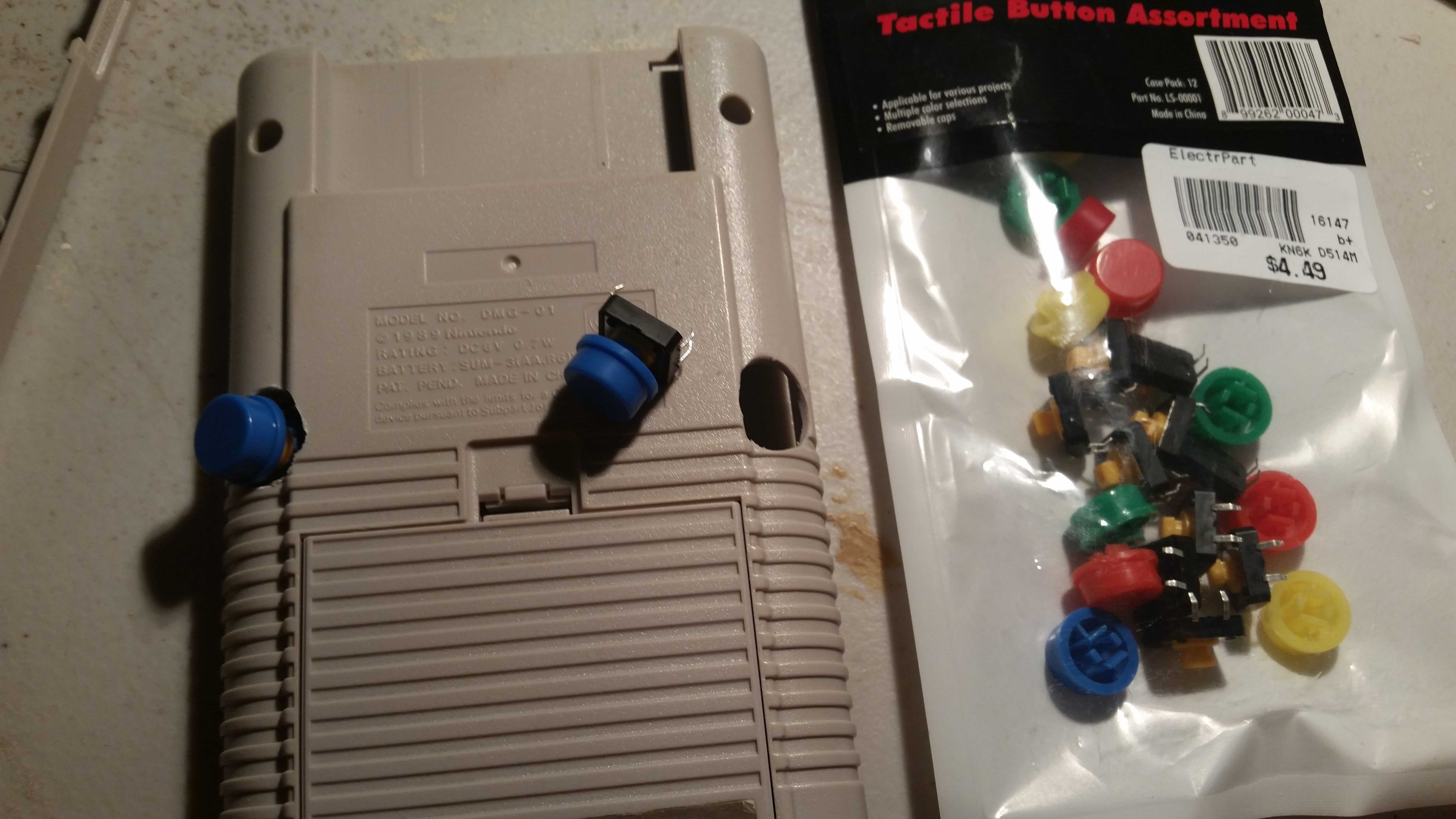

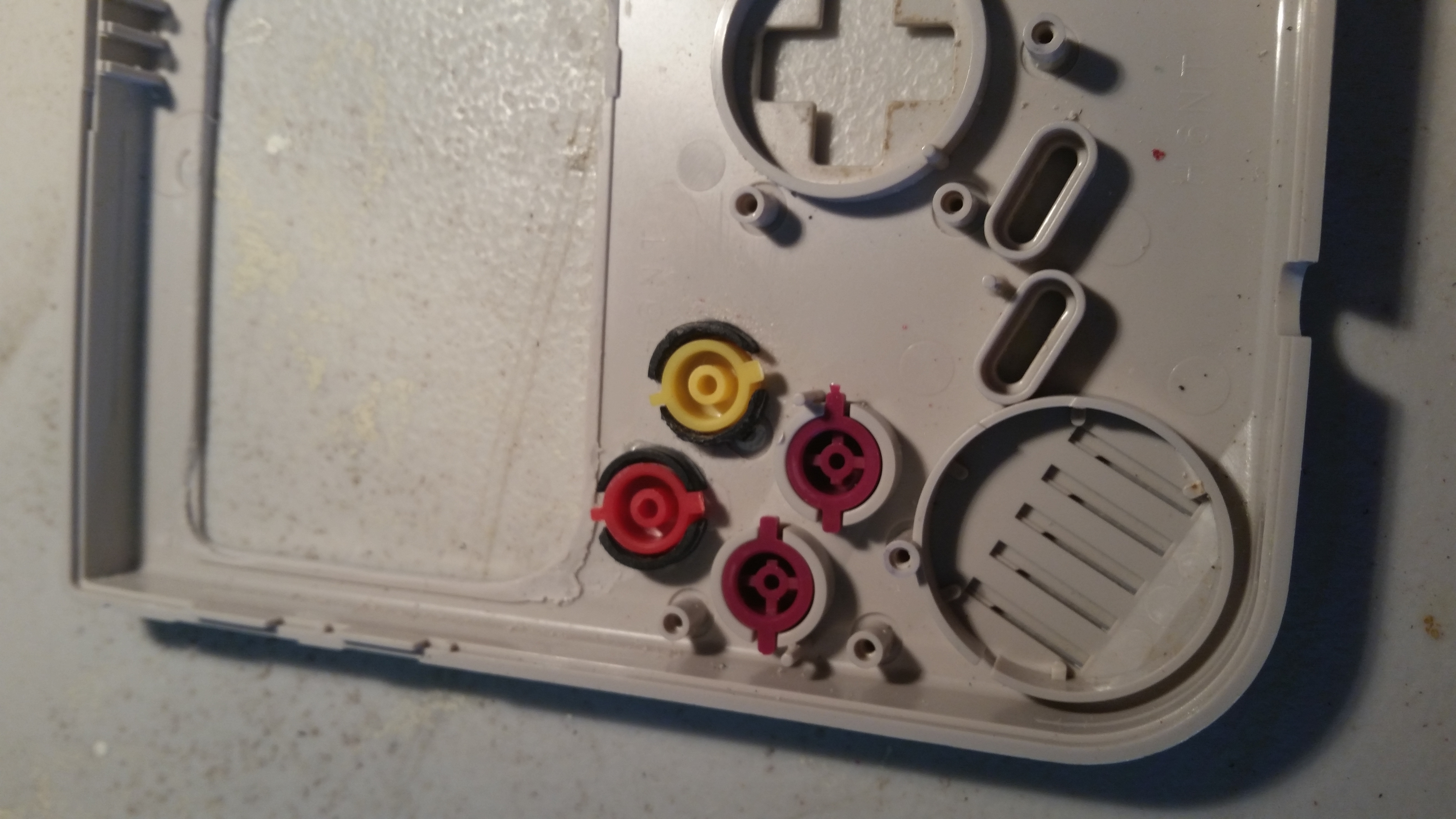

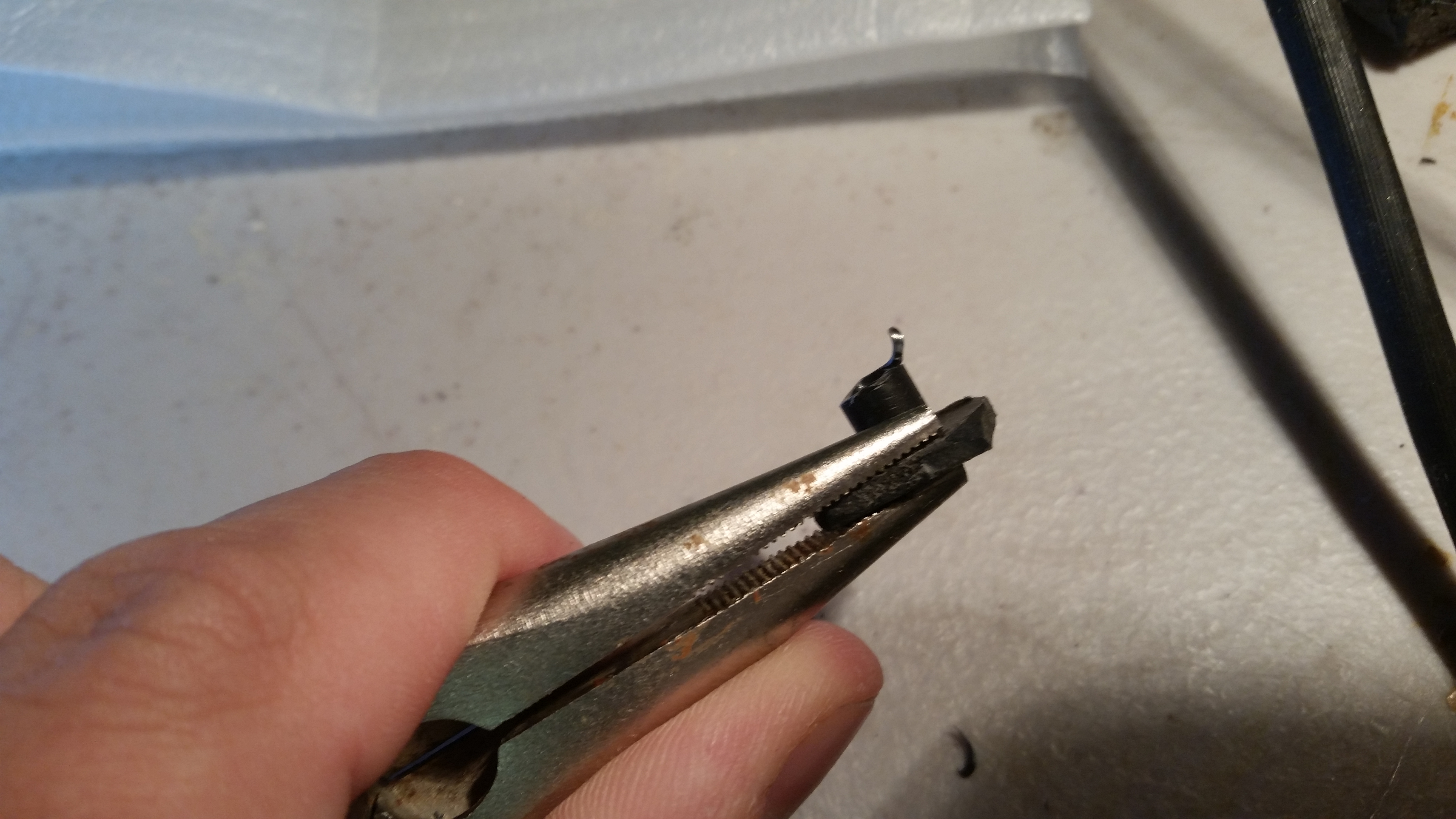

I am kinda disapointed in how my L/R buttons turned out, I couldnt find the tactile switches from the main guide in store and I really didnt want to get a 100count on amazon so I just went with some store bought buttons. Problem is i kept drimmeling and drimmeling to get it to fit and then turned it over and realized how big of holes I made. Not sure how Imma patch this part up but ill think about it.

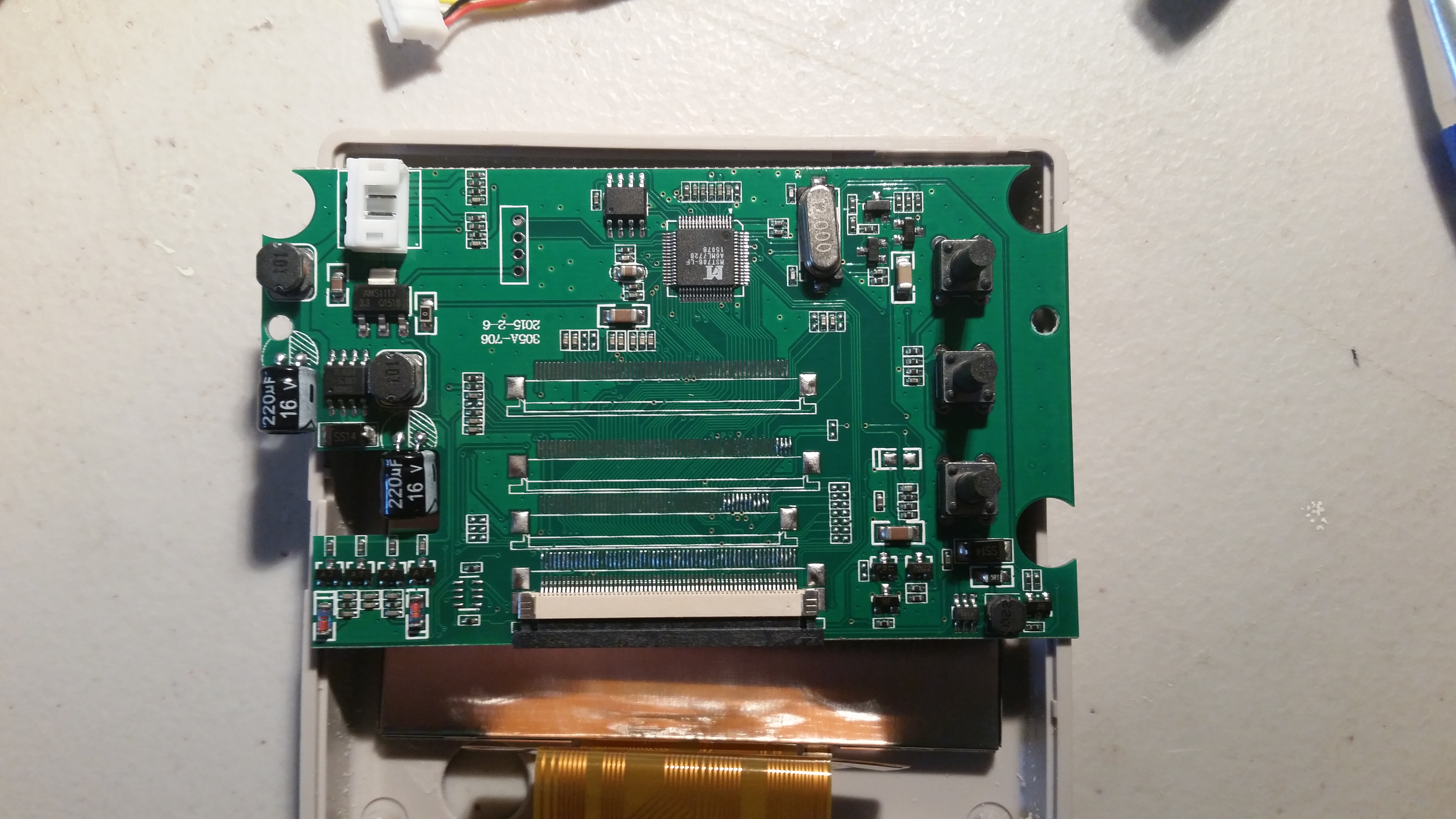

Well I didnt pay enough attention to the fact that ATian on Amazon was not one of the good sized screen pcb's. Sent back and ordered one from e-life which should have the right sized one? Replacement arrives tomorrow so well see.

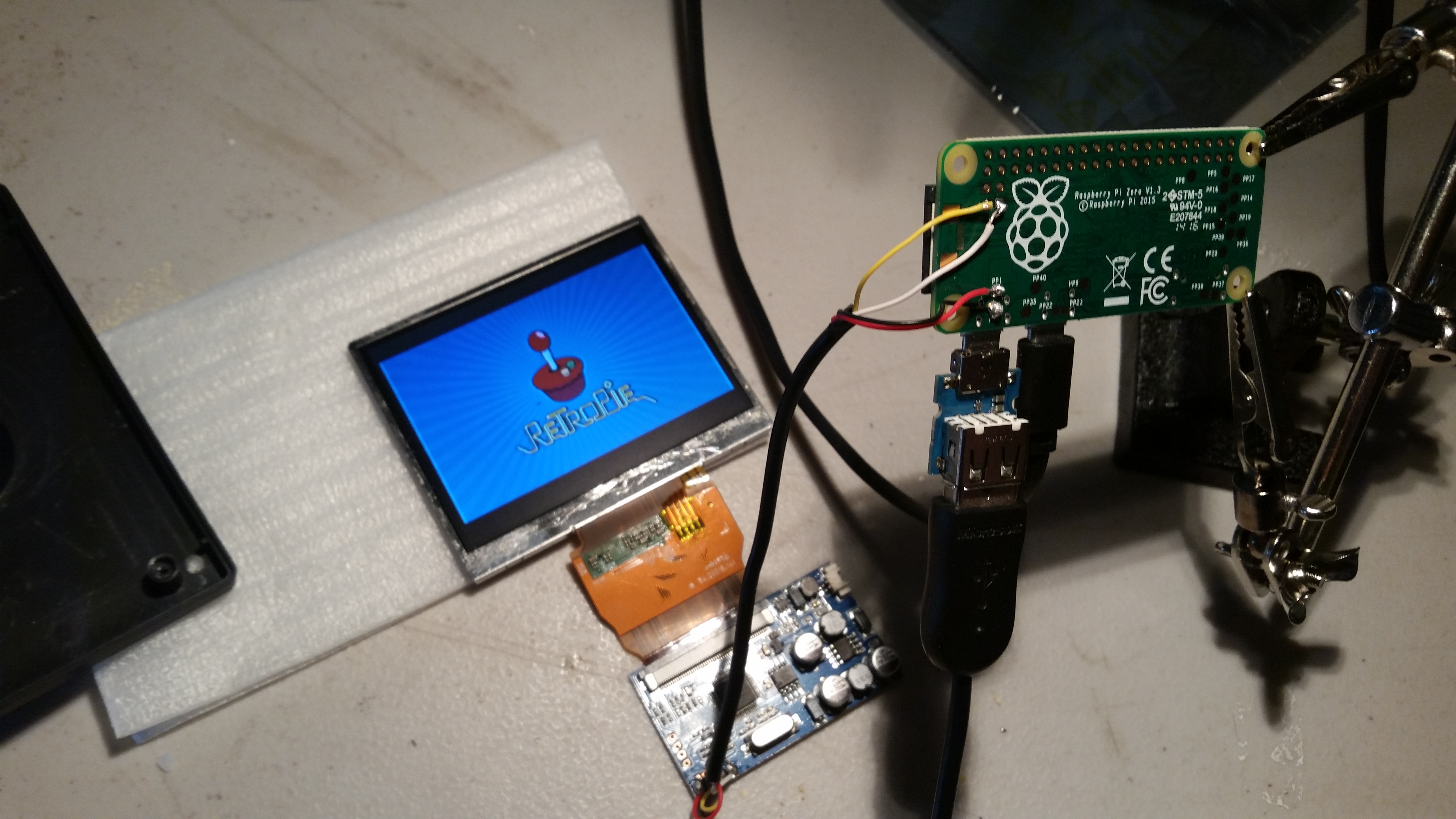

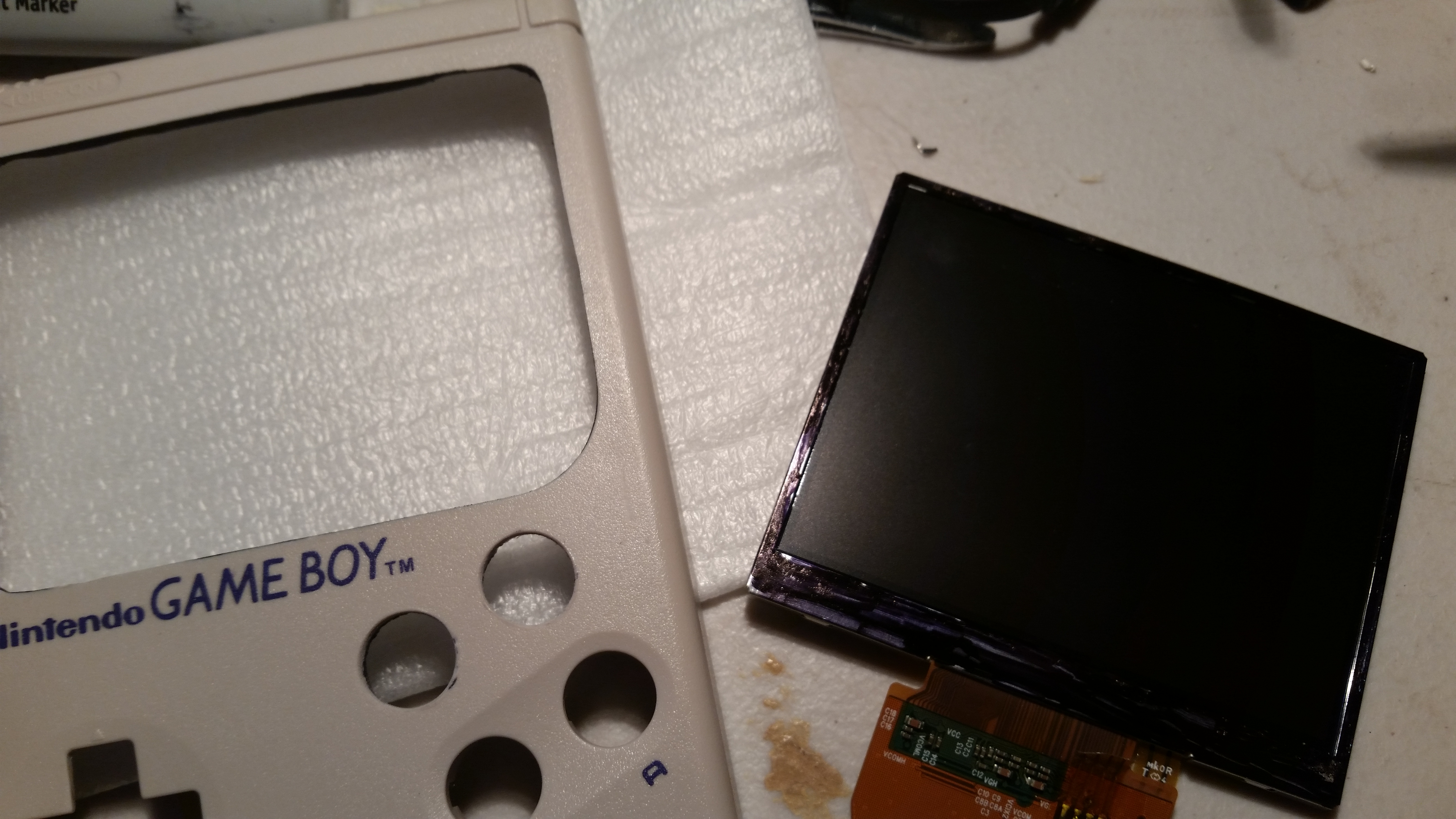

BW e-life screen arrives and is correct size woo hoo. Also allegedly works off 5v so i dont have to solder anything together we will see.

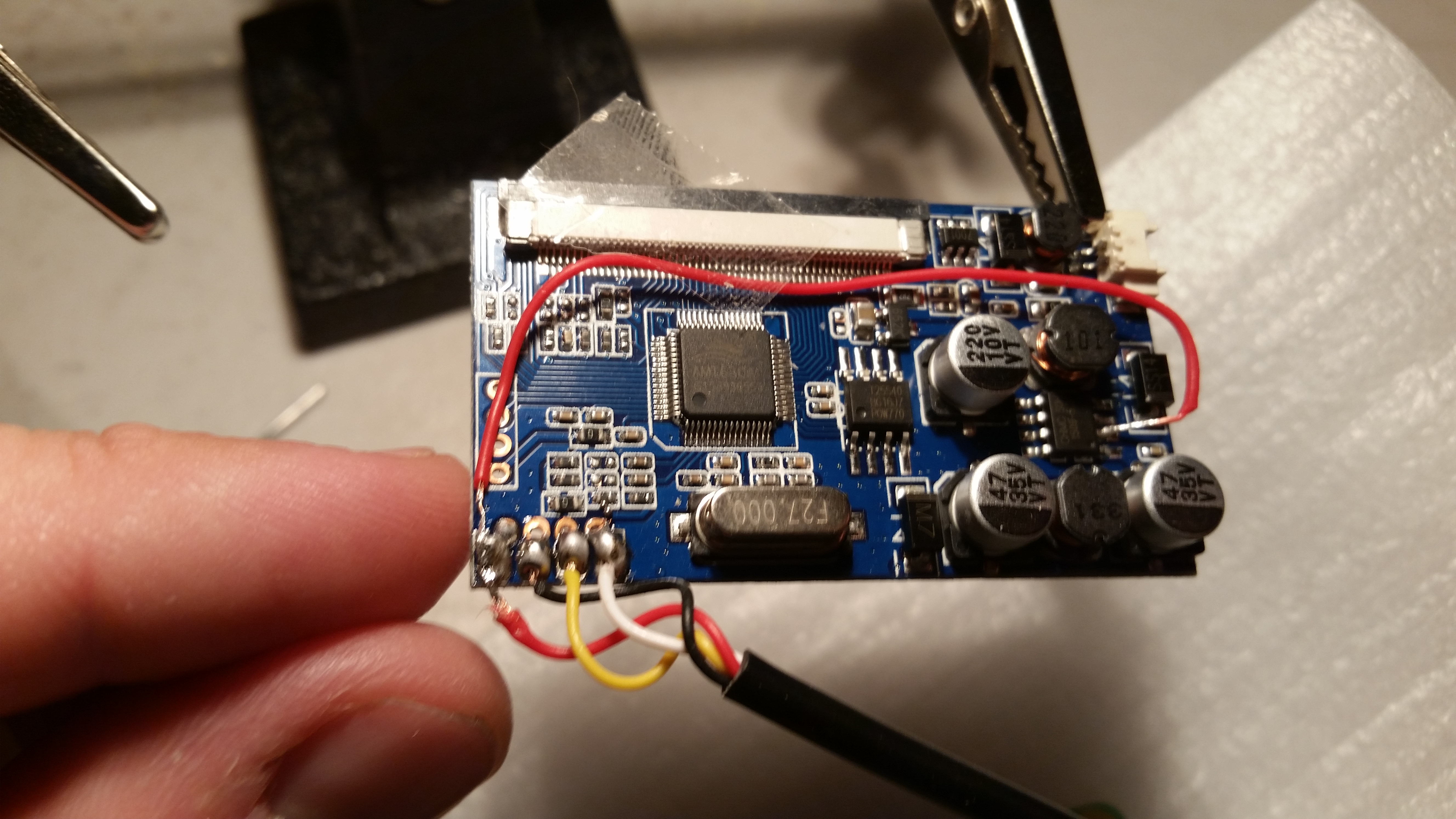

Holy cow it actually works, soldering the video connections was a pain in the butt, tried my best to get the wire in the hole for the R/Y wires.

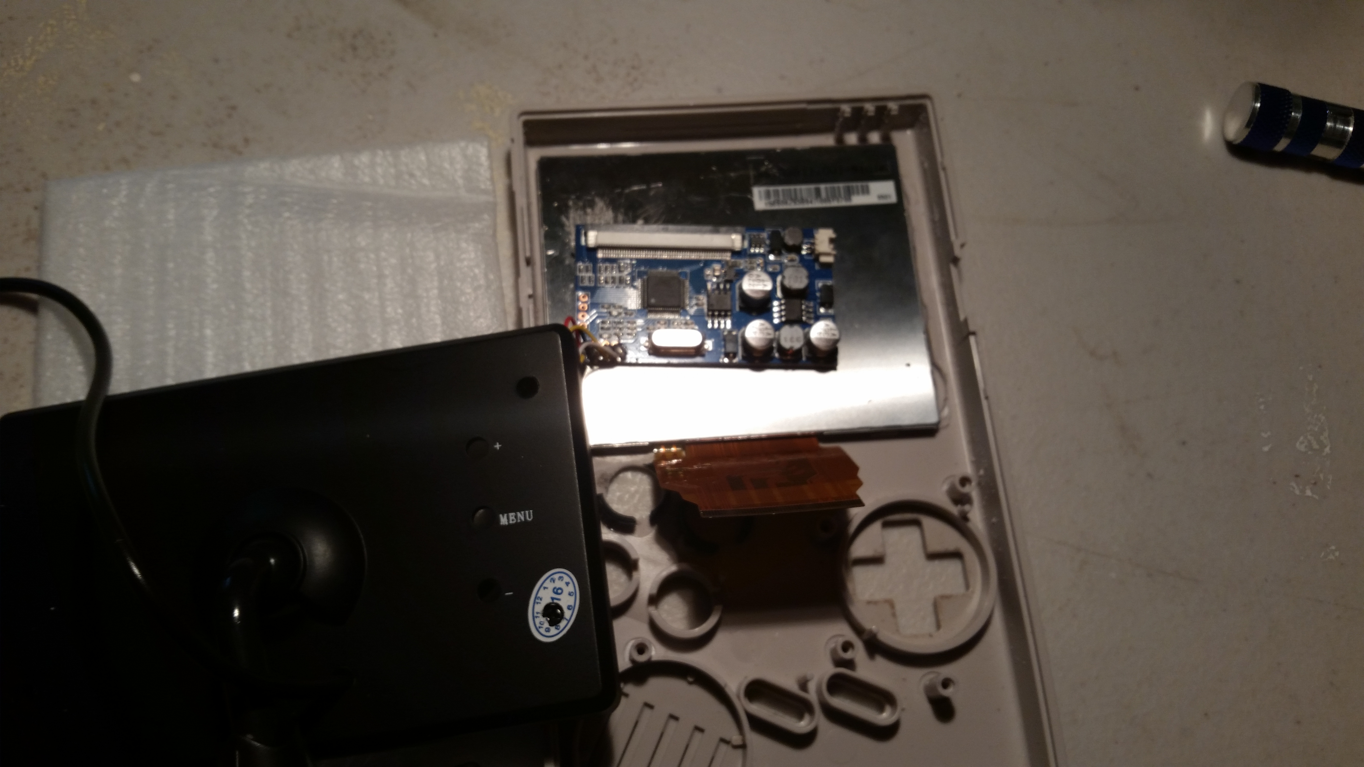

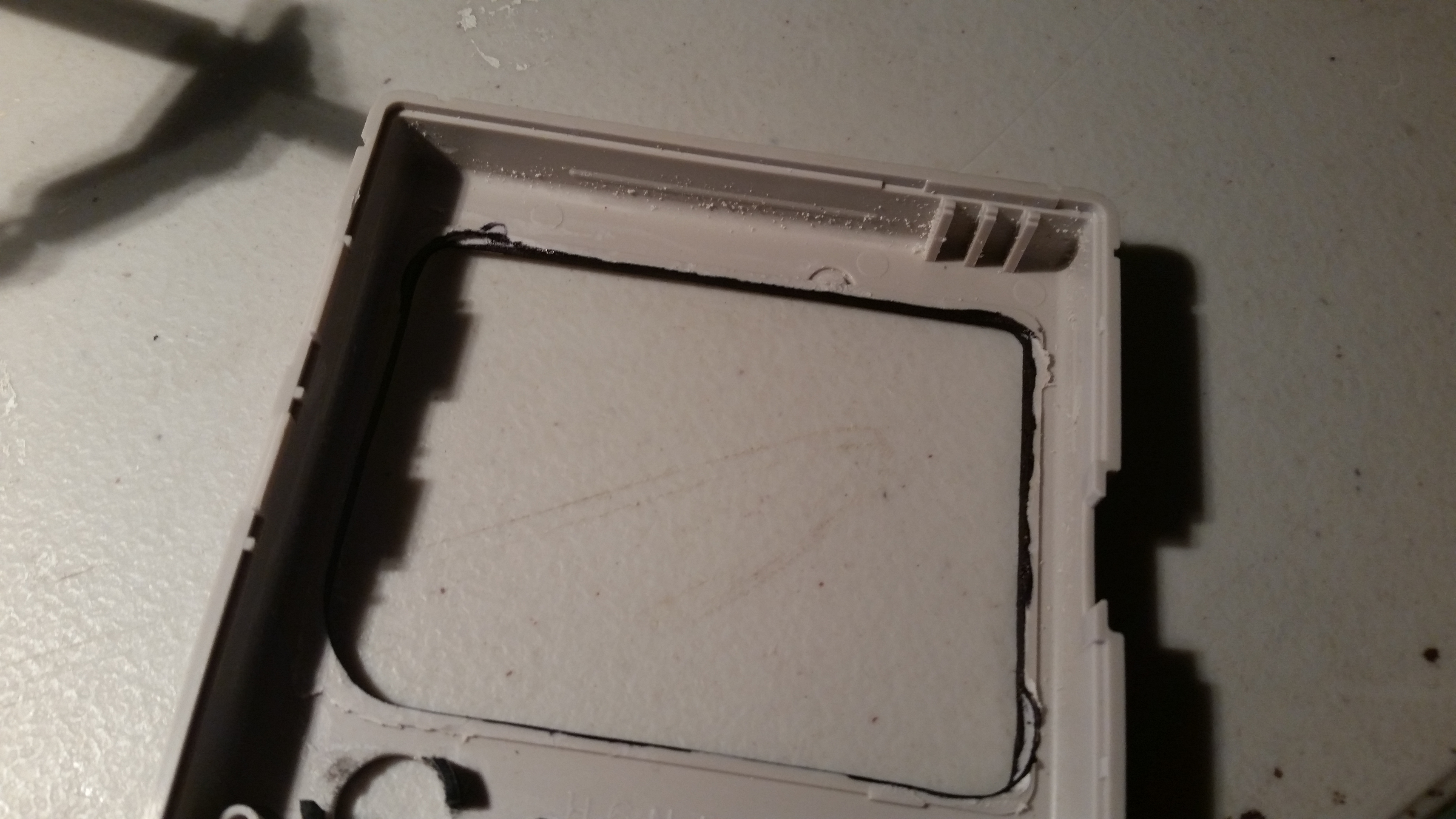

Decided to black magic marker the inner screen hole of the case and the silver on the screen. Turned out OK but not much of this will be showing.
After trying to get the screen in there right I felt like it wasn't sitting very good in there so I decided to grind down the plastic around the edges flatter.
Looks way better.

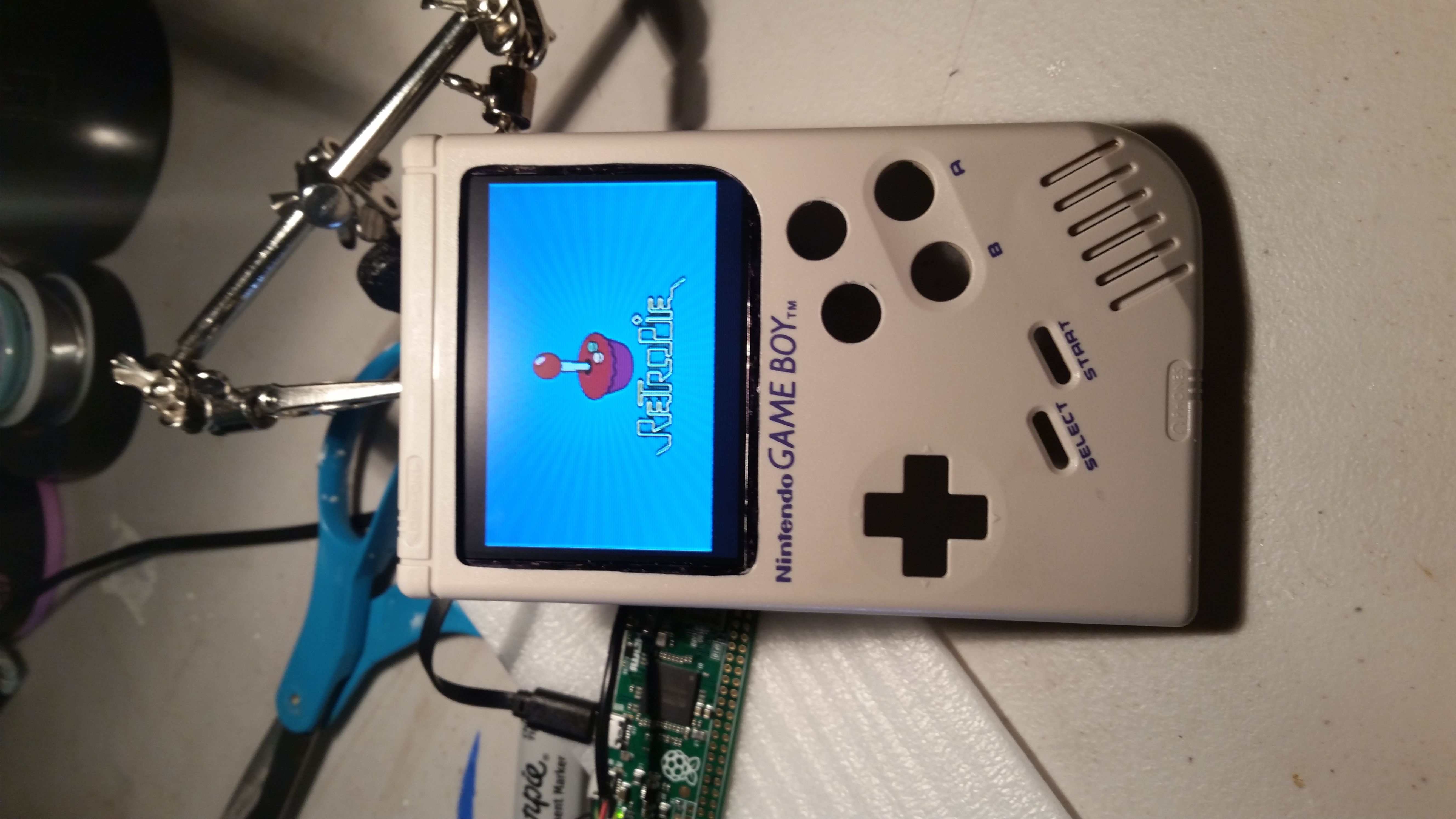

I said to myself YER A WIZARD HARRY when it actually turned on again!
Not to mention got RetroPie loaded up on my SD card, not sure how to configure that next but I am pretty sure I need a working gamepad or controller neither of which I have at the moment, will have to wait until monday when the rest of my loot comes in.
Looks way better.

Heres what the screen looked like before it had a lot of white static going on, hard to see in just a picture but it also was kinda flickering.
Thanks to @ChunkeeMonkee we had the same screen variant for BW and said placing the bypass would fix it. Also this was a PIT to solder, showed my fingers to scale of how tiny this board is. Soldering to the chip on the right turned out way easier than jumping the two red cables kept having issues with the blob of solder moving around... Finally got it though
And was a success! Hard to tell from this picture but the quality is way better now.

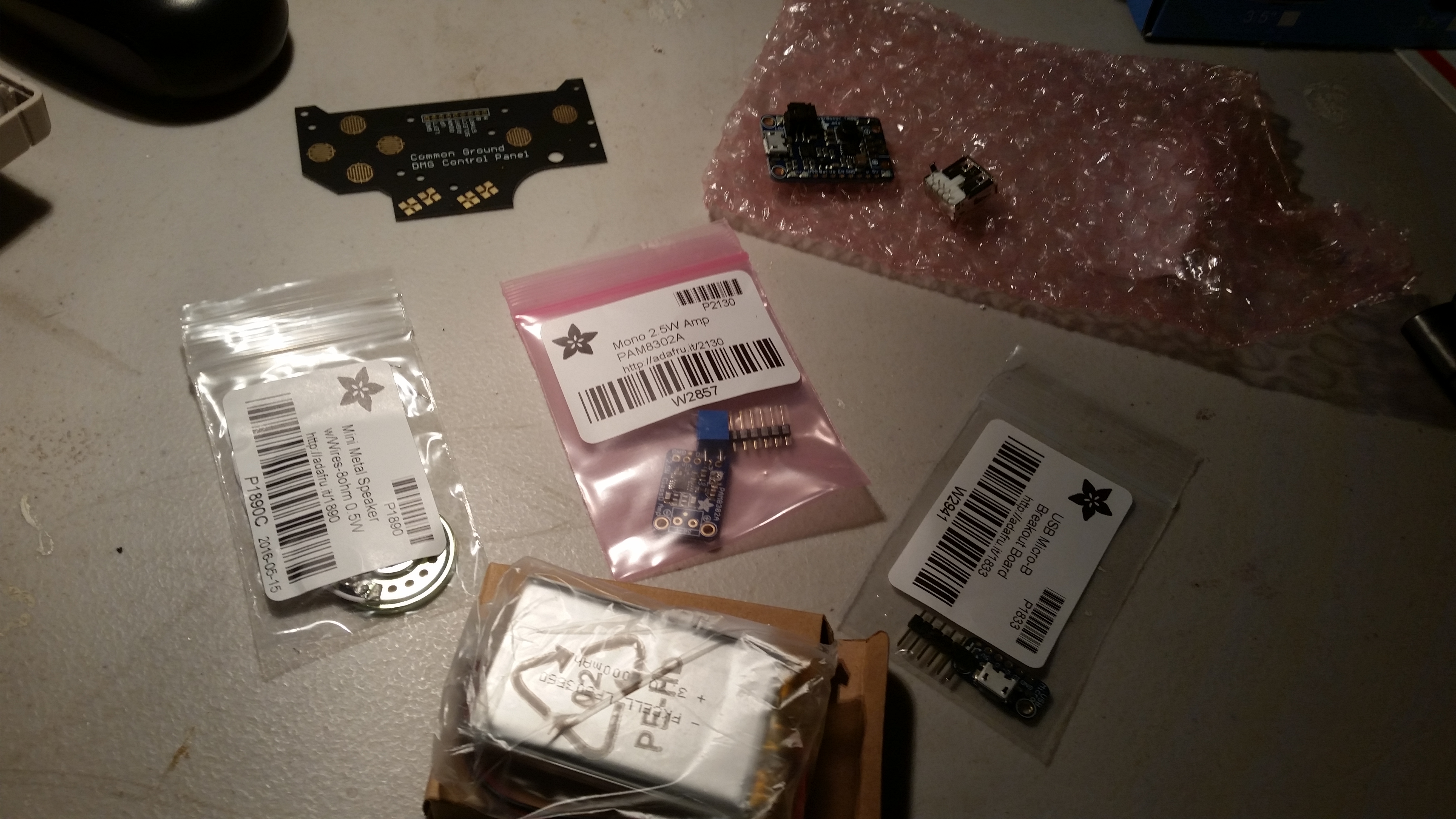

Been a few weeks since my last update. Got some parts in and one that I ordered the wrong thing. Also was down and out for about a week with a medical condition (nothing serious) but made me wanna lay around instead of work on stuff. (All better now!)

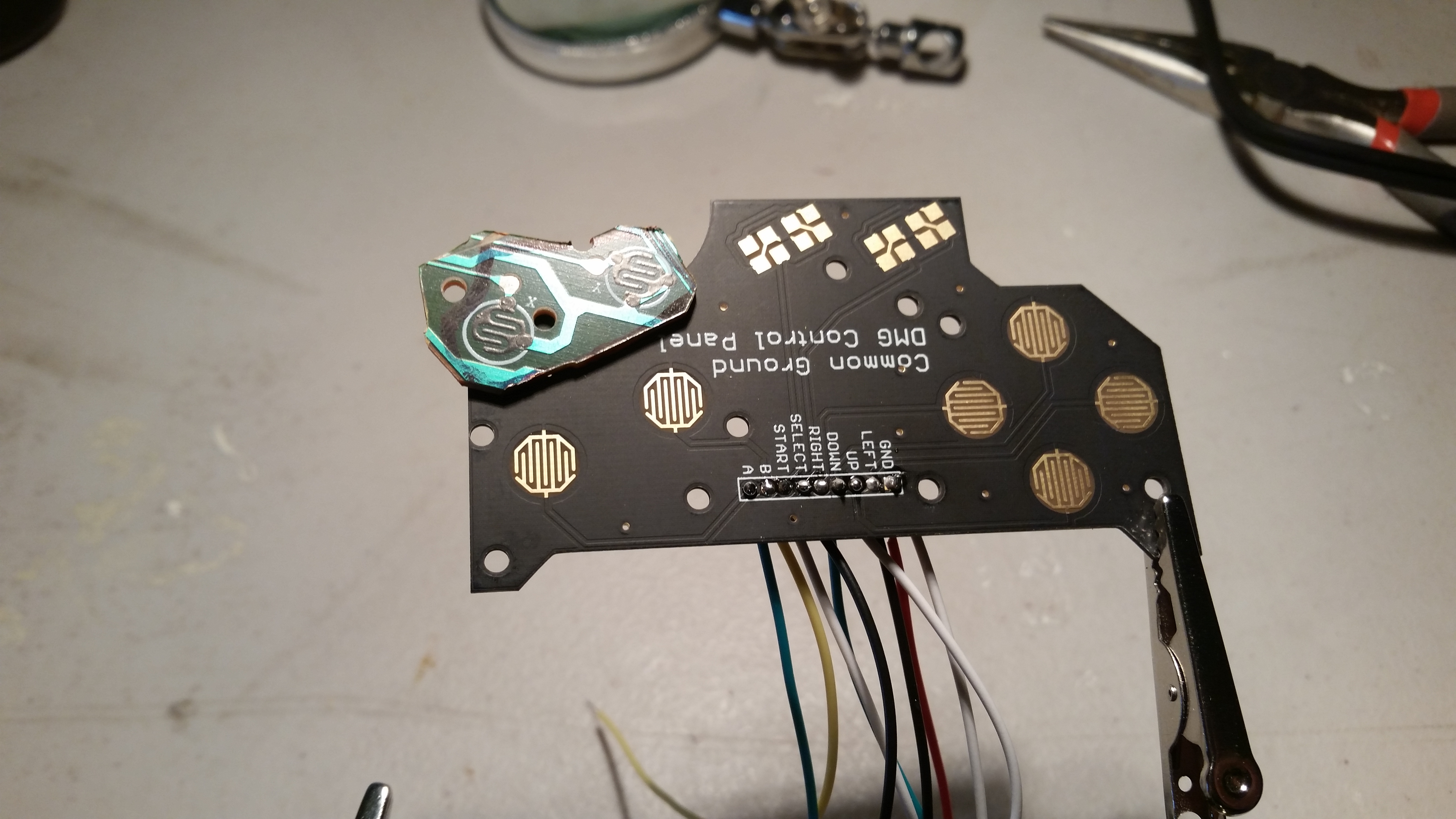

Got all my parts from Adafruit and also my button control board.

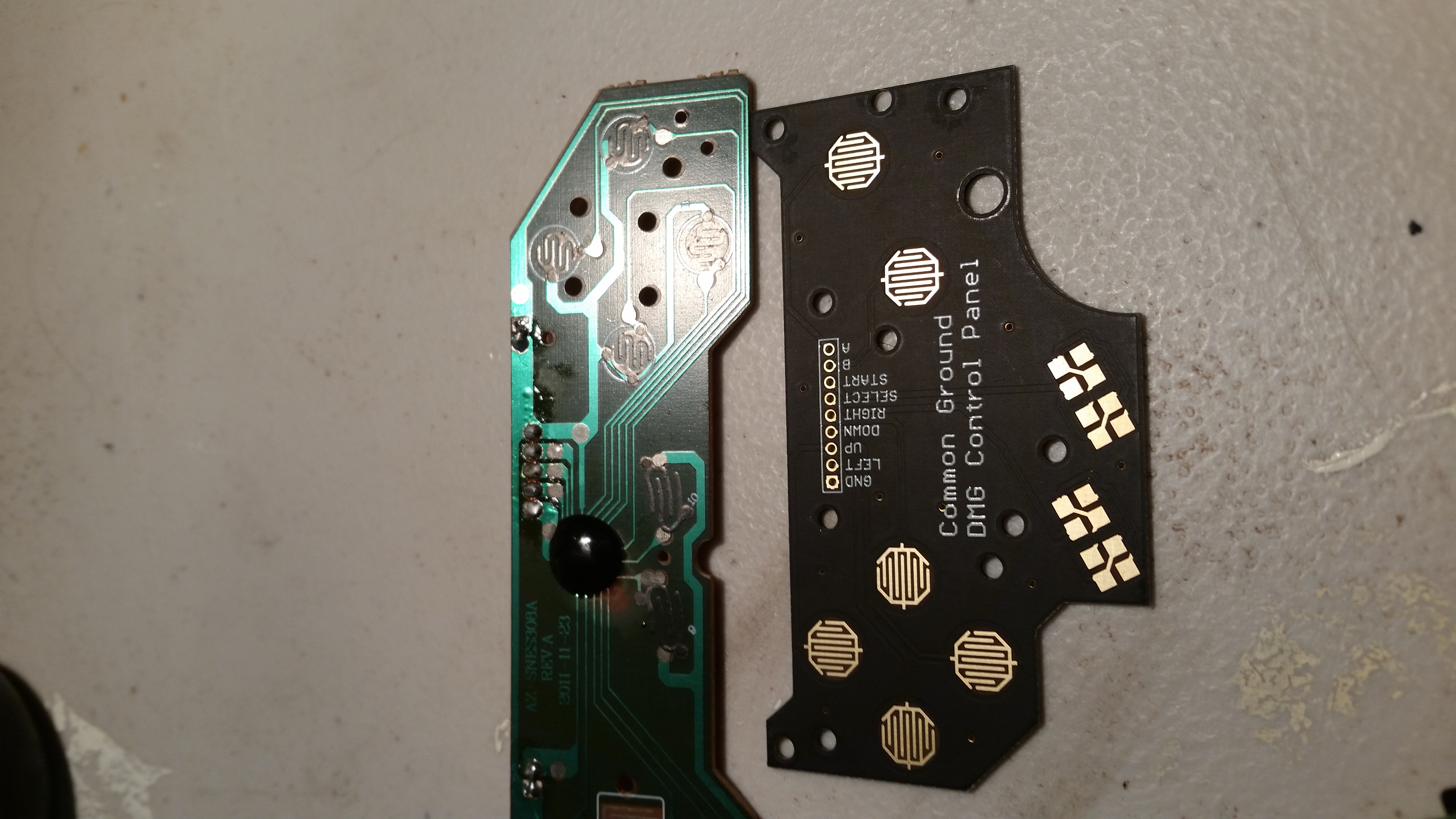

I opened it up and was scratching my head where my X/Y button's were, and realized I ordered just the replacement board and not the one that comes with X/Y Buttons. Didn't really wanna wait another week and spend $20 getting another board or trying sending this one back so decided to hack up the $5 controller I bought and see where it goes.

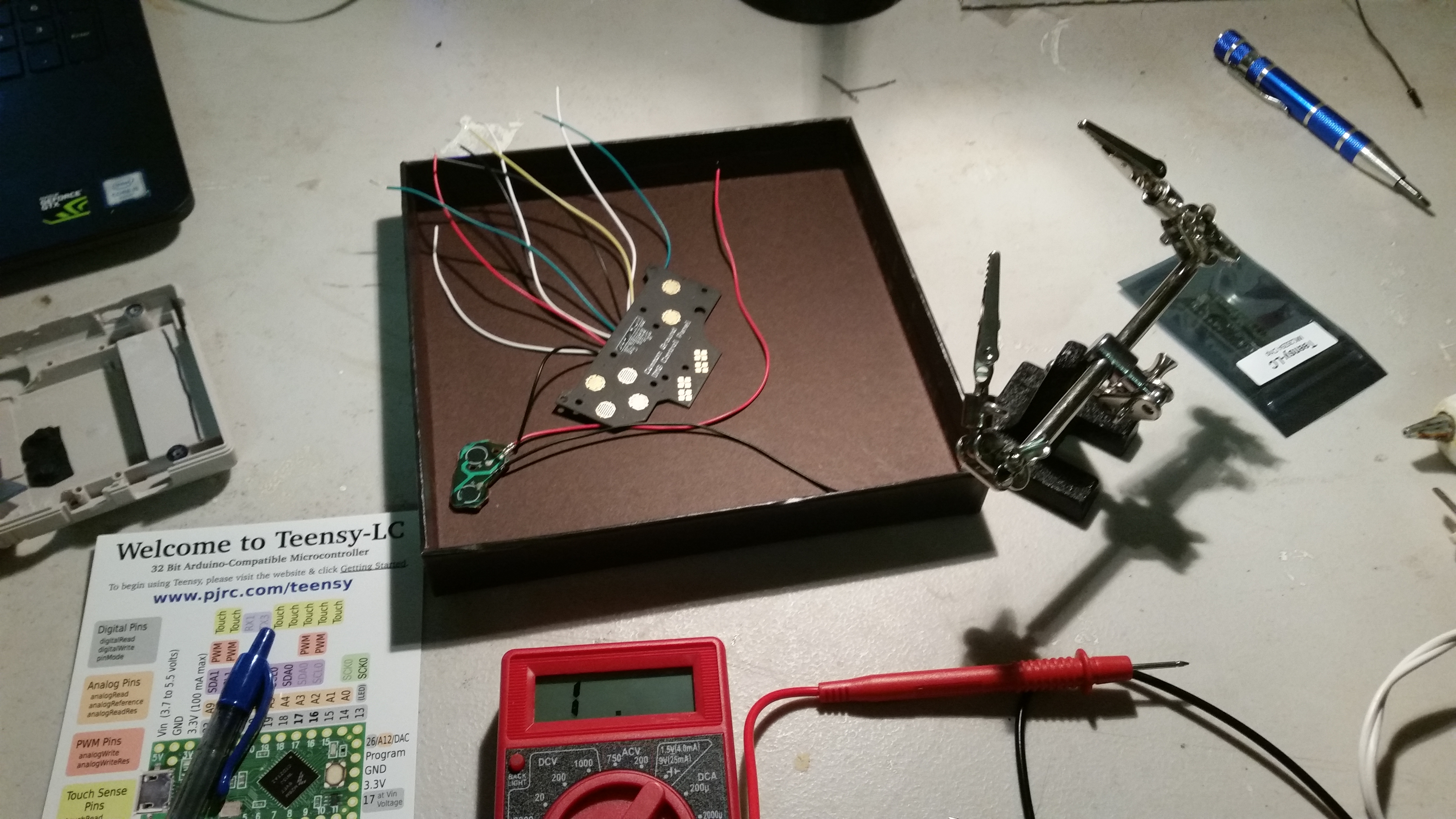

My board cut down to size, I plan on just hot gluing it together and seeing where it goes. Also In the picture I had it in the wrong side, the X/Y will be on the other side of A/B

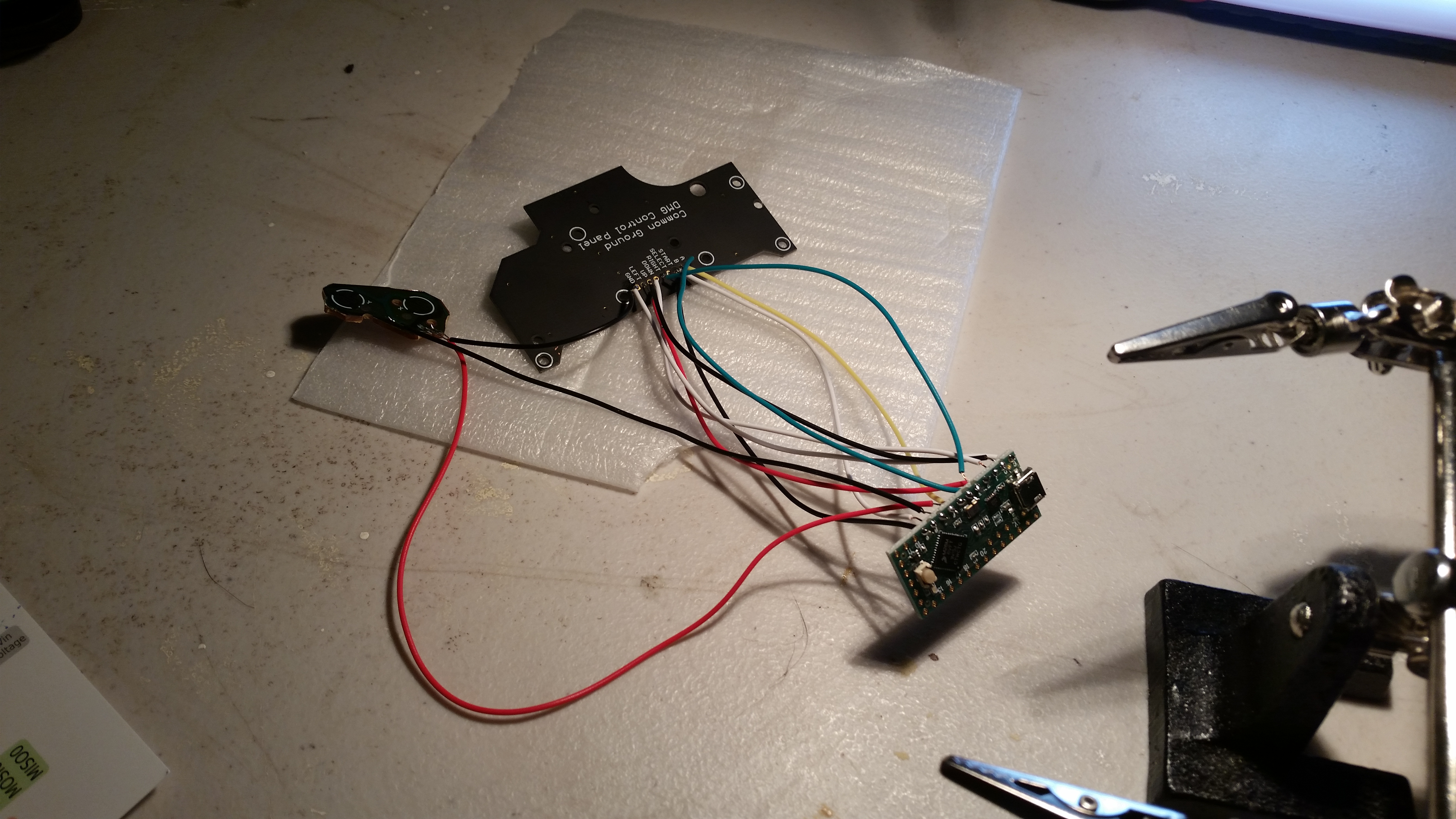

Bought a new multimeter from Harbor Freight for $5 since my other one was old and didnt work. Tested all the connections and they seemed to be fine. We will see.

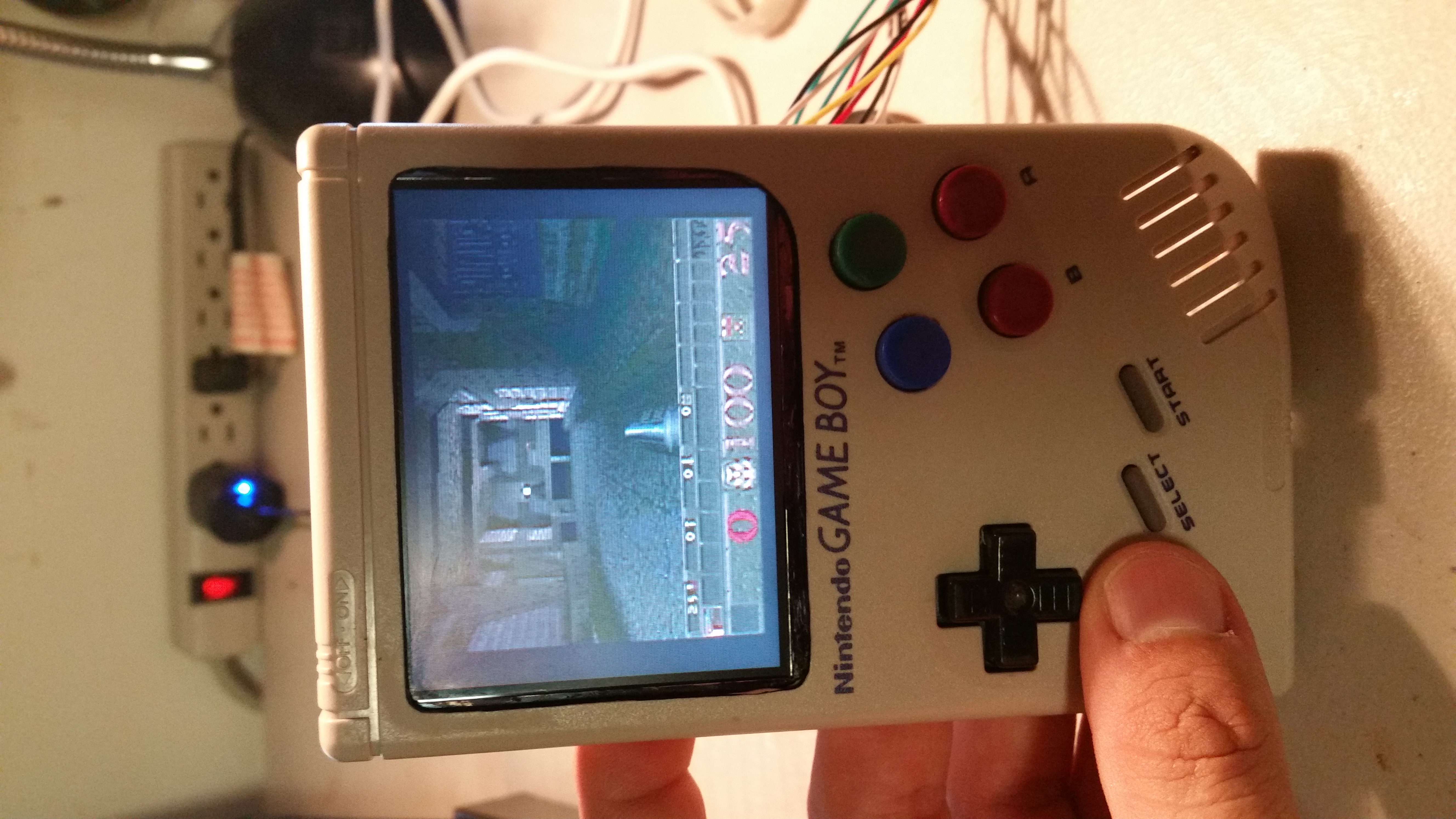

Holy turd monkey it works, setting up the Teensy took about 5 mins thanks to the Wermy guide given this noob had never used that program before it was quite easy.
Playing Quake, although I noticed that my Up/Right buttons are sticking together when I push up so I cant really run straight going to have to check on that next time.

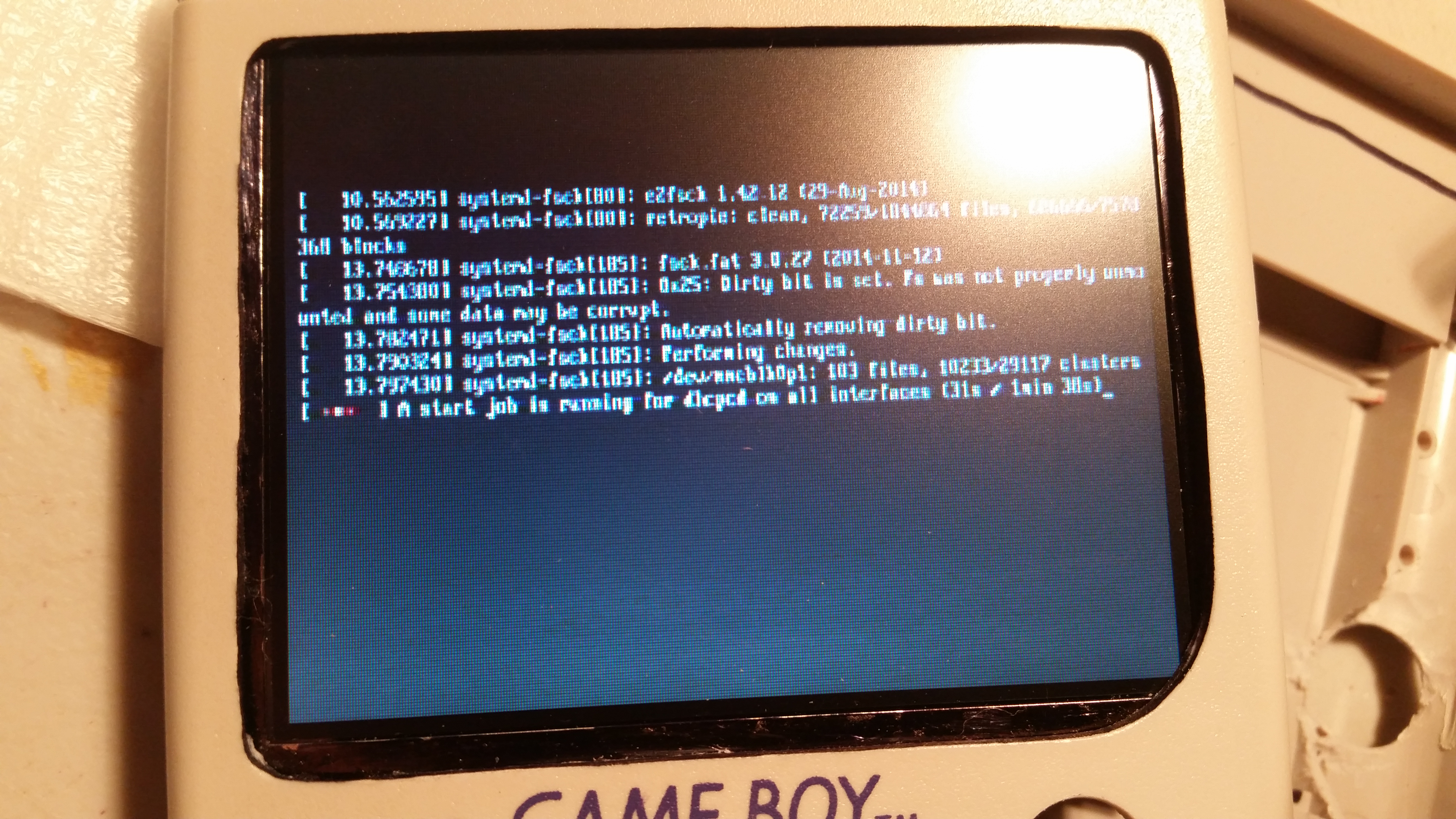

Lastly edited the boot code to run on 320x240 thanks to this forum post. Now the text is readable.
http://www.sudomod.com/forum/viewtopic.php?f=12&t=1106
