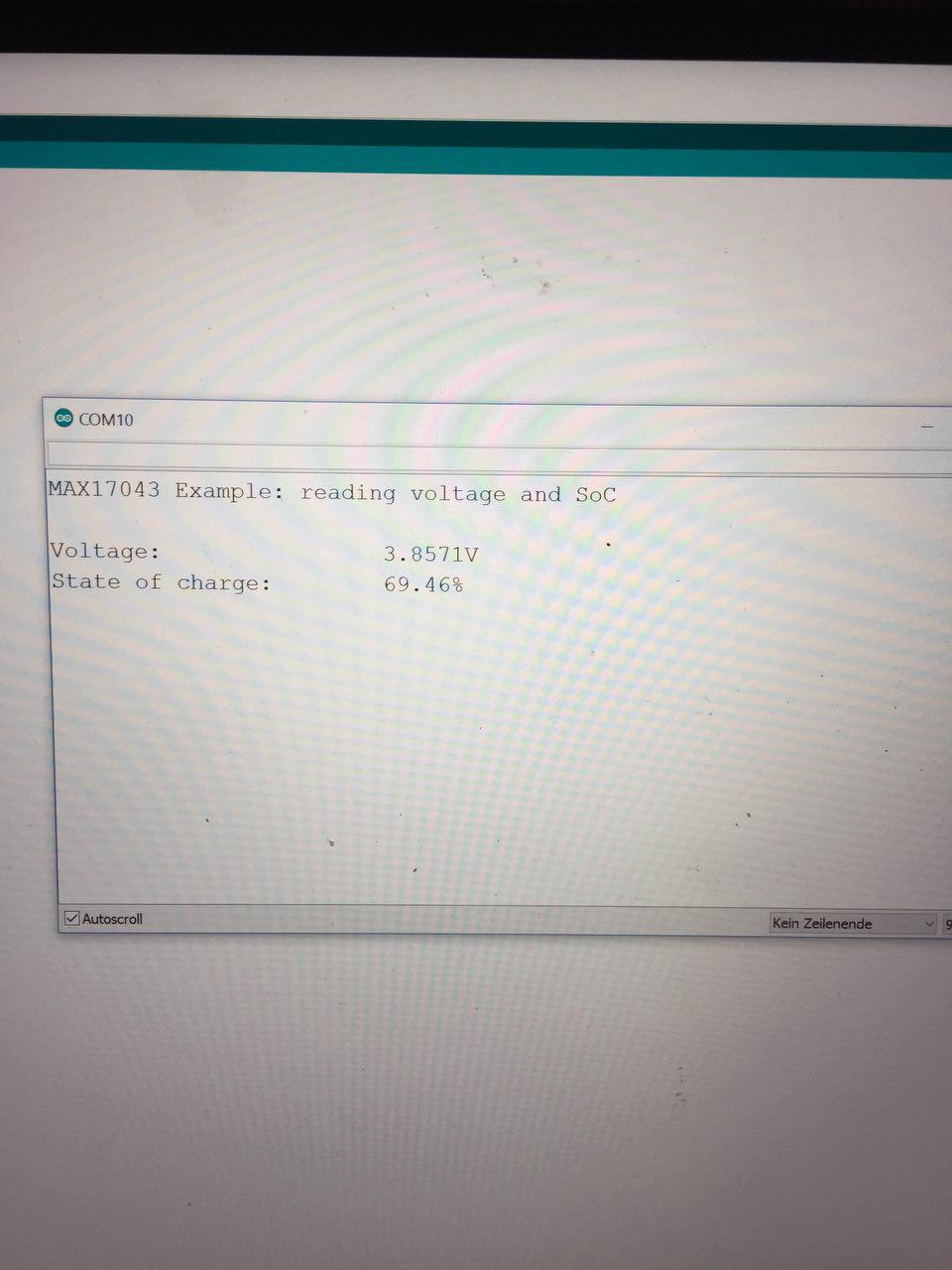

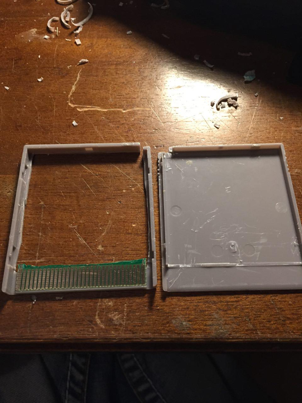

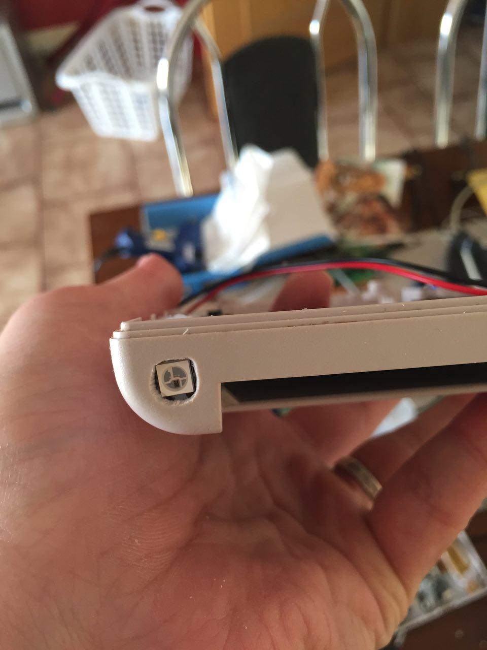

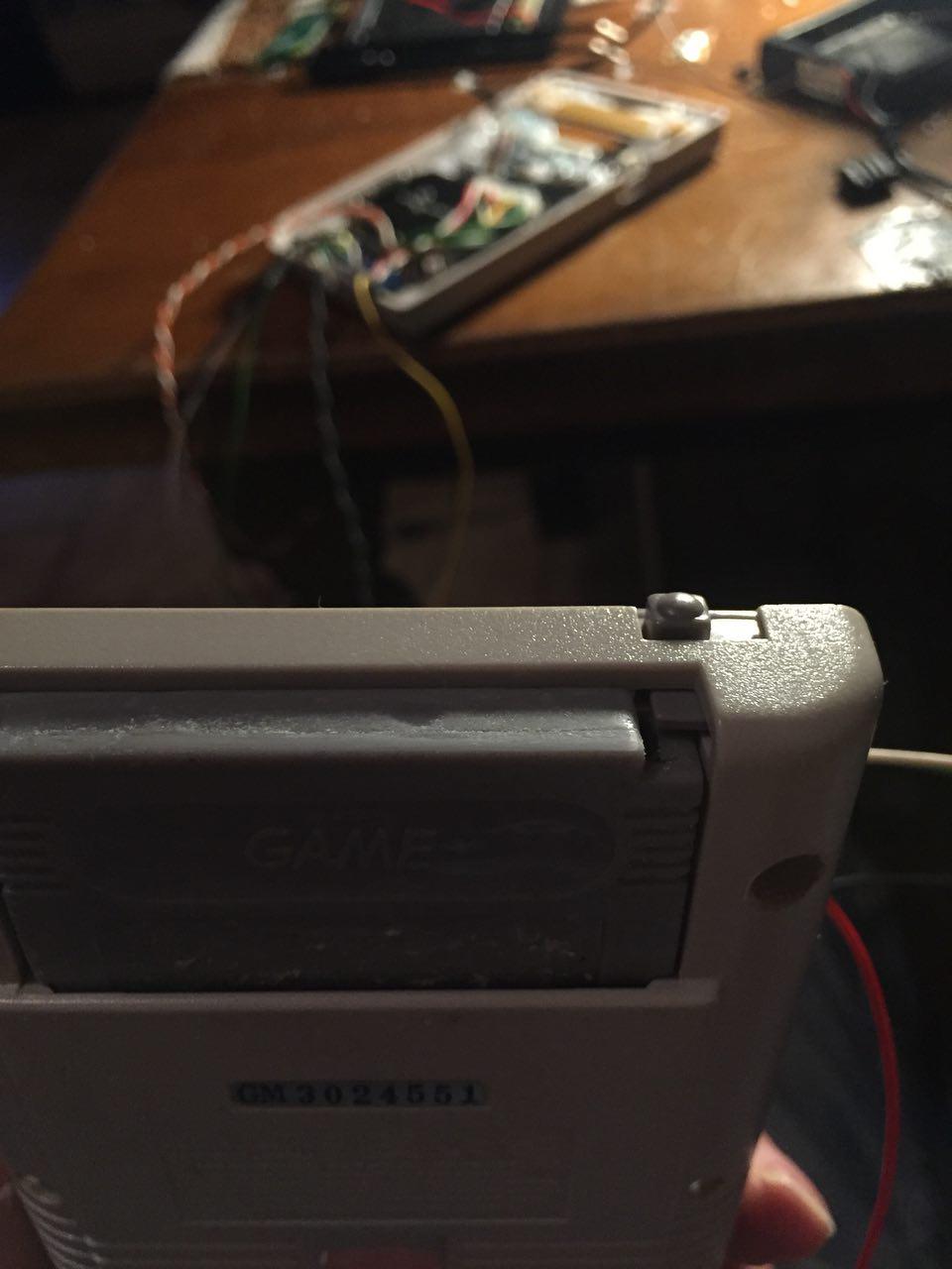

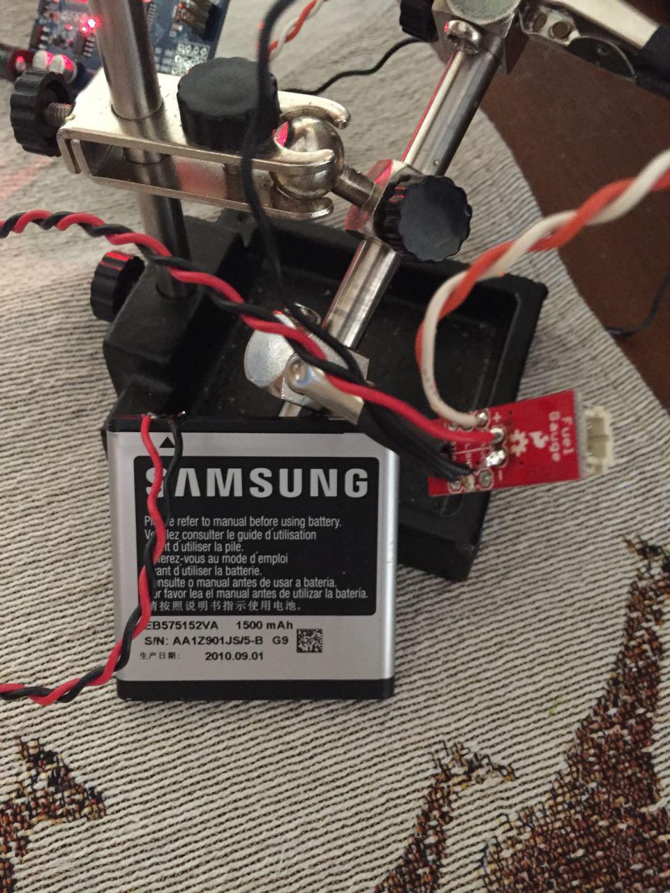

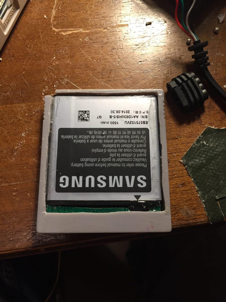

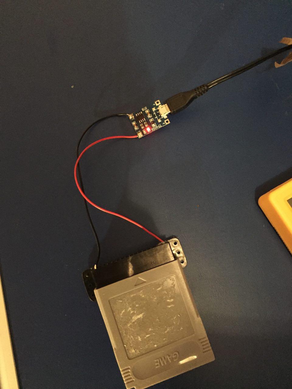

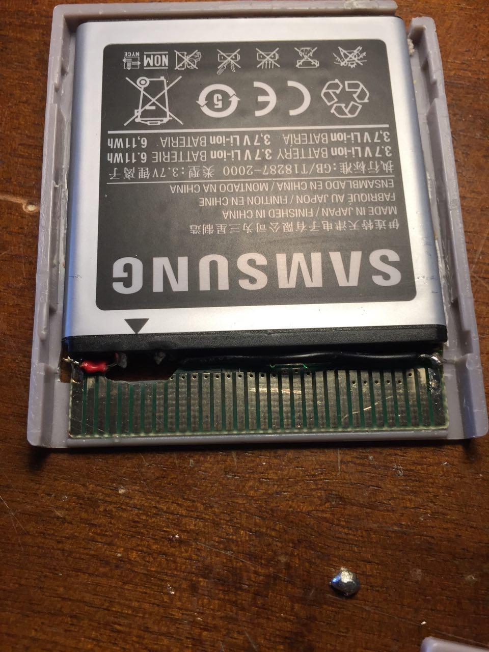

I never understood why you want to have the SD Card in the cardridge, cause when you have ALL Roms, you have them all, no need to reach the SD Card easily...And in case of trouble there's ssh. But What to do with the now empty Cardrige? What do you need most on a mobile gaming station? Right! Batteries. So I put in some good old fashioned Samsung Galaxy S1 (I9000) Lion Batteries (which you can get with up to 2900mah). I Also wanted to know how much juice is left in the battery while gaming, So I grabbed a nice small MAX17043 and a WS2812b RGB LED an soldered it to the Arduino Pro Micro I'm using. Cause thats what Arduinos can do best, measure stuff :) Here are some first pictures.
[spoiler="See Pictures"]
Some pre testing with the MAX17043
Values looking good
cutting the cardridge
Battery soldered to Cardridge
Hail epoxy
even the original Cardridge stop thing works
charging test through the Cardridge Reader
Top View ws2812b

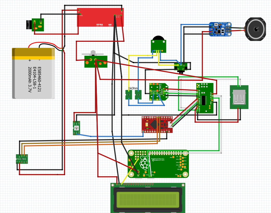

Here is a quick Wiring-scheme.
I also use the arduino (together with the max) to indicate the zero to shut down wenn the battery goes below 3V

I anticipate that your Volume wheel wont work for your speaker if you put it infront of the amp. Youll need to put it after the amp. This sucks cause you wont be able to regulate your headphone volume anymore.

That's a valid point, maybe setting the system volume to 1-10% does the trick

Maybe I am wrong but setting the system Volume to 1% coukd lead to quality loss. I thought about hooking up a potentiometer (Volume-wheel) to my teensy and map it as media keys. This way I wouldnt have to worry about coming up with some crazy wiring. But this is just theory right now.
