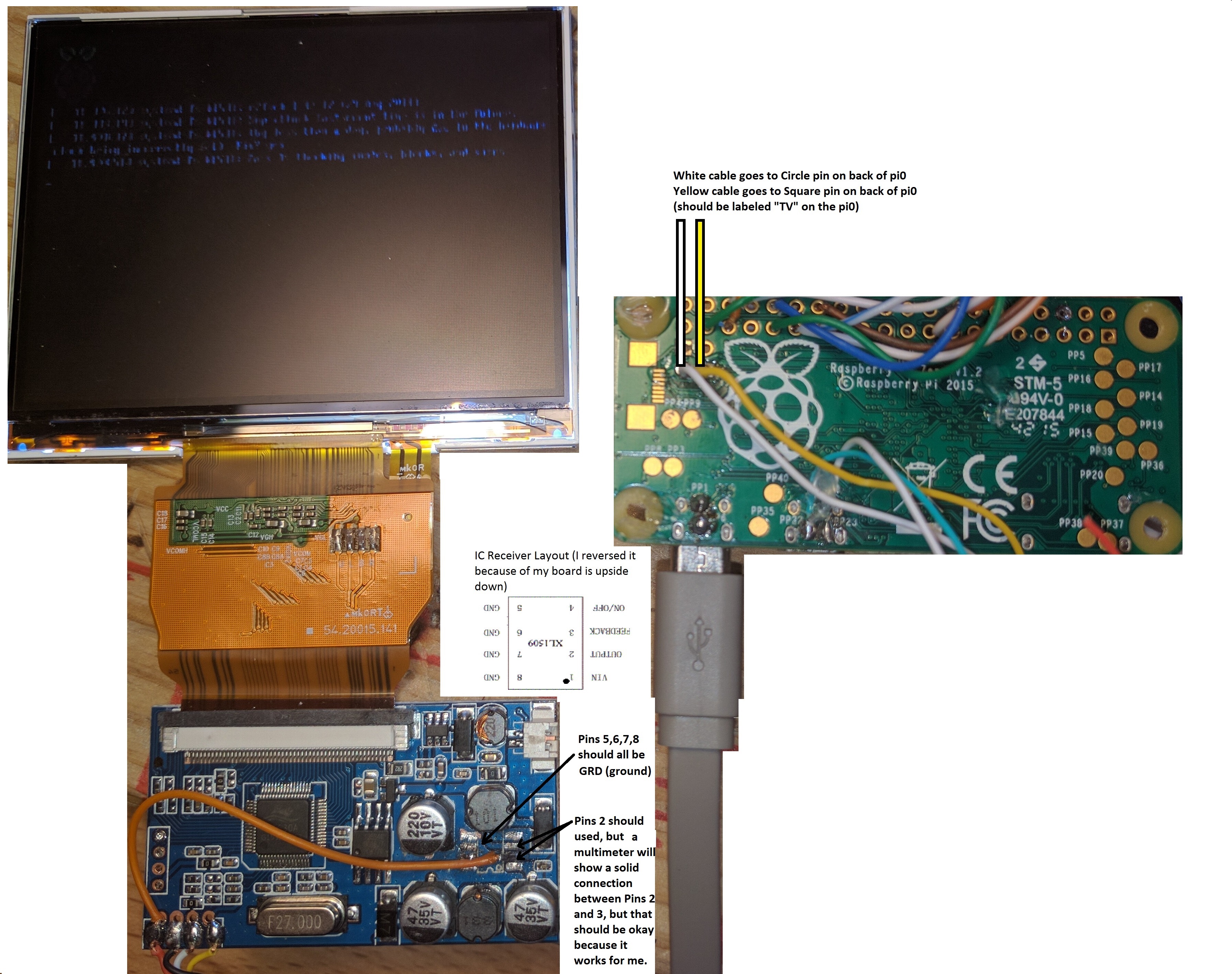

MaKro wrote:try swapping lcds
No difference.
Did you test it with 12v before you modded it?
Yup, runs off 12v no problem.

dirtybeagles wrote:
MaKro wrote:
dirtybeagles wrote:
No difference.
Sure you got the regular wiring right?

Re: DirtyBeagles Build/Progress
Post by Fleder » Sat Jun 04, 2016 2:10 am
Please make a quick sketch which wires is connected where.
They need a common ground or else it will not turn on. Maybe this is the problem.

Post by dirtybeagles » Sat Jun 04, 2016 12:51 pm
I fixed it. I was reading a little bit and found that unless there is a video signal being inputed into the display, it will never turn on. I had my White and Yellow cables reversed which is weird because in another display having white in the square and yellow in the circle the display worked... I confirmed the proper setup and have it posted in a picture below. Thank for everyone's help, including you [mention]Fleder[/mention]

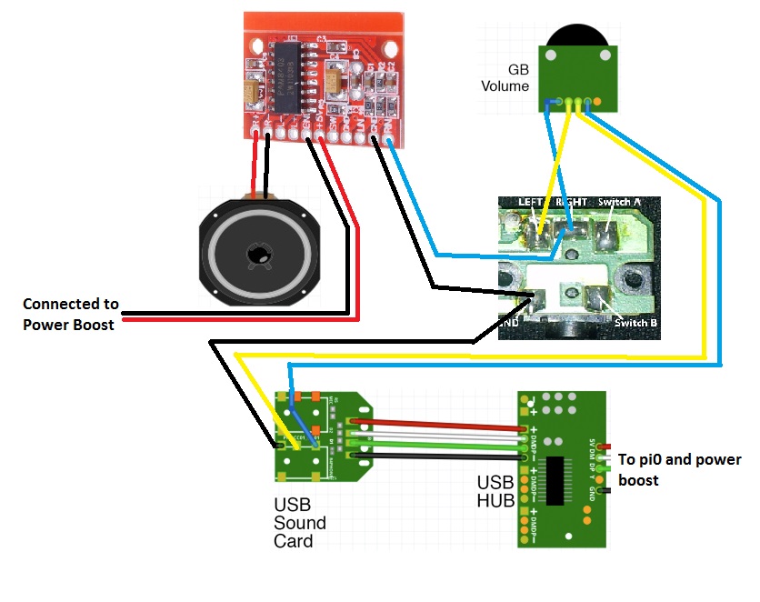

Anyone know how to use a usb sound card without an amp? I have my usb sounds card connected to the gameboy volume wheel now and the wheel connected to the headphone jack like other people I have seen but I am getting so much static from the speaker I so not like it. I think my amp is just not a good one so I am wondering how to connect it without one.

dirtybeagles wrote:Anyone know how to use a usb sound card without an amp? I have my usb sounds card connected to the gameboy volume wheel now and the wheel connected to the headphone jack like other people I have seen but I am getting so much static from the speaker I so not like it. I think my amp is just not a good one so I am wondering how to connect it without one.
Is there static from the headphones? Is the headphone jack before or after the amp?

Post by dirtybeagles » Sun Jun 05, 2016 8:18 pm
MaKro wrote:Is there static from the headphones? Is the headphone jack before or after the amp?
There is no static from headphone jack. Here is my diagram:

Post by MaKro » Sun Jun 05, 2016 8:58 pm
If you play with the amplifier cables while audio is playing is there any effect?

Post by dirtybeagles » Mon Jun 06, 2016 8:03 am
MaKro wrote:If you play with the amplifier cables while audio is playing is there any effect?
Good question and Yes. When I press my finger on the audio jack (white cable for me or the white cable going into the gameboy volume wheel) it has a huge effect on the static and gets way louder. When I take my finger off it goes back to low static sound.
