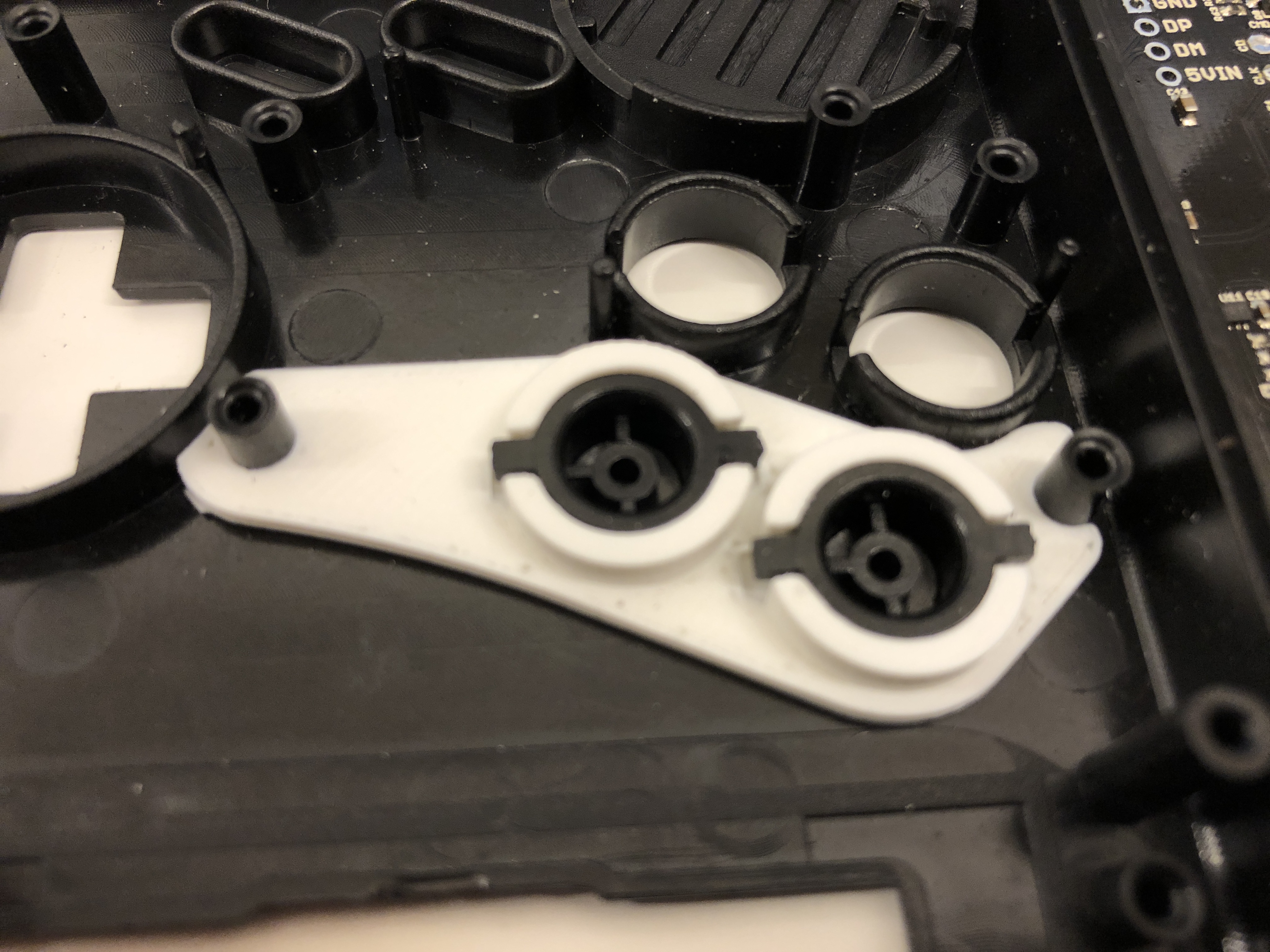

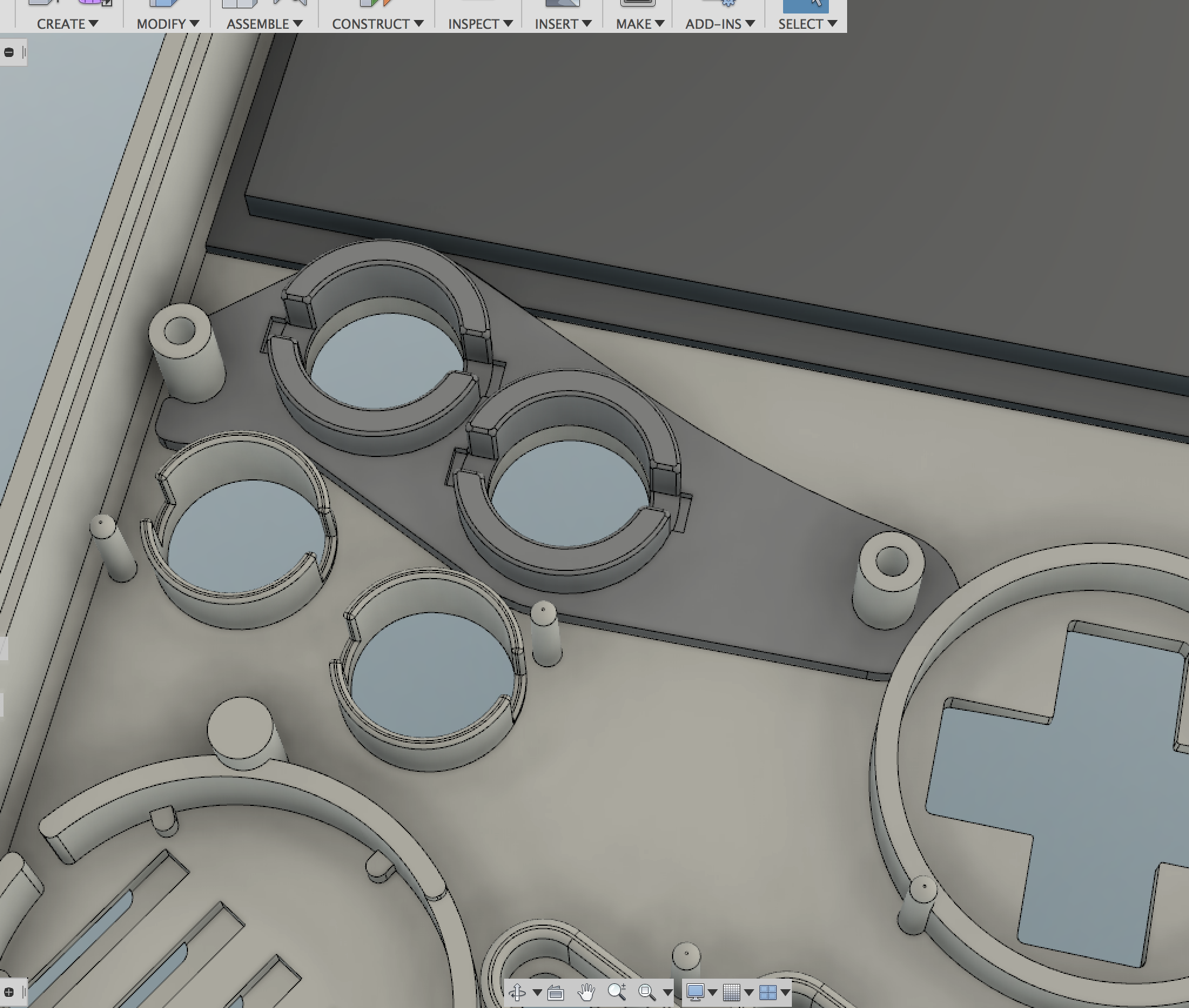

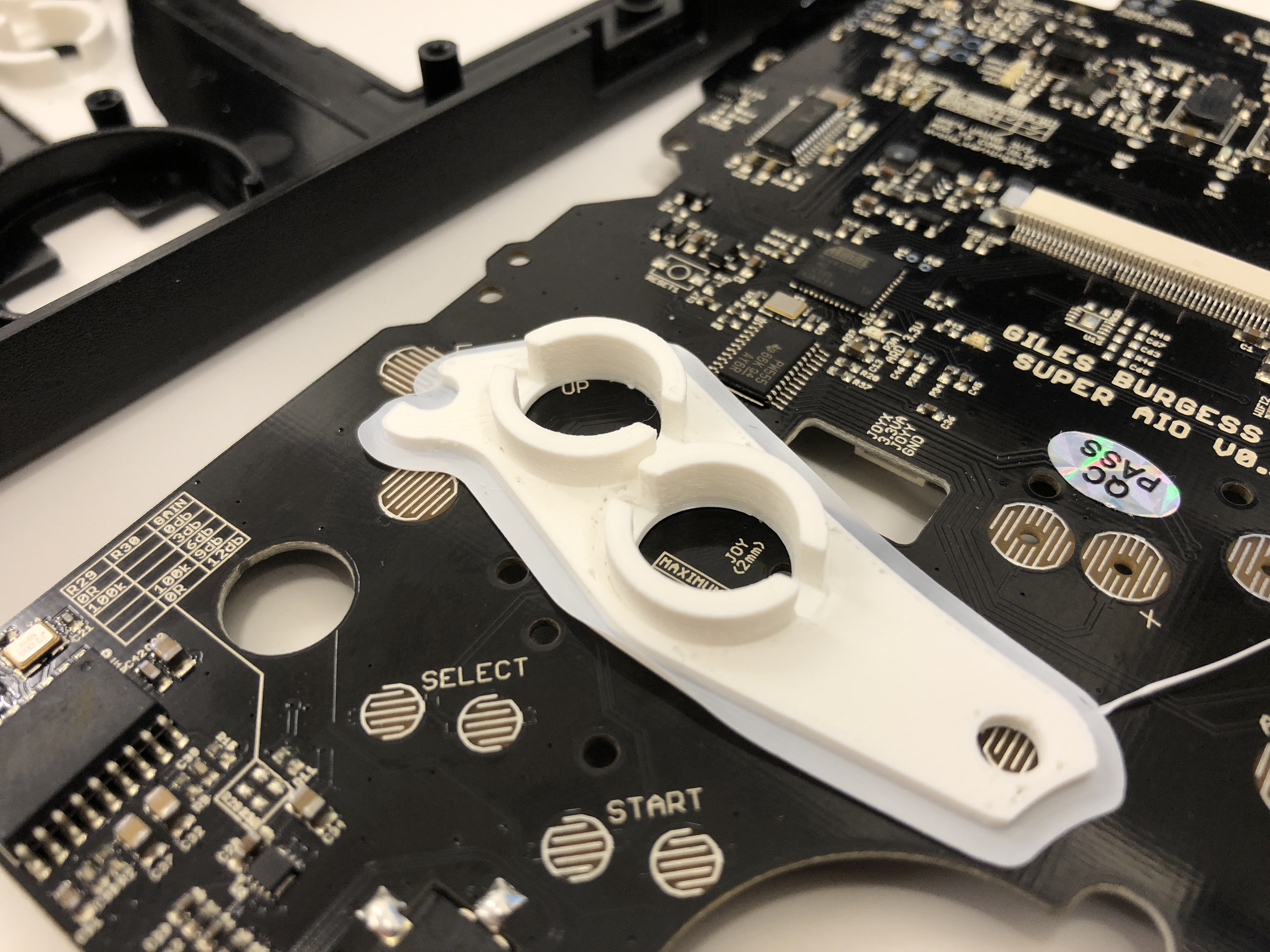

Post by ubidefeo » Fri Feb 16, 2018 1:12 pm
hi Neolith
thank you for sharing these design files, they're very helpful to work out helper parts.
I am in fact working on assembling my Kite Super AIO (after a year) and am enjoying the process.
As a long time Fusion 360 user I'm glad I could access the whole timeline.
I've made a couple minor changes to reflect the XY buttons positioning based on the included Kite's outline (which I patiently managed to close and extrude 1mm). The screw posts are also out of alignment, so I've modified the couple I used for my button wells adaptor.
Hope you guys can use these designs. I've also made some studs to facilitate drilling the holes for such buttons, but I don't have them printed so can't test they really work :)
Enjoy
Screen Shot 2018-02-16 at 20.58.45.png (1.01 MiB) Viewed 10275 times
Top-Button-Wells_v2.stl.zip
(199.69 KiB) Downloaded 486 times
