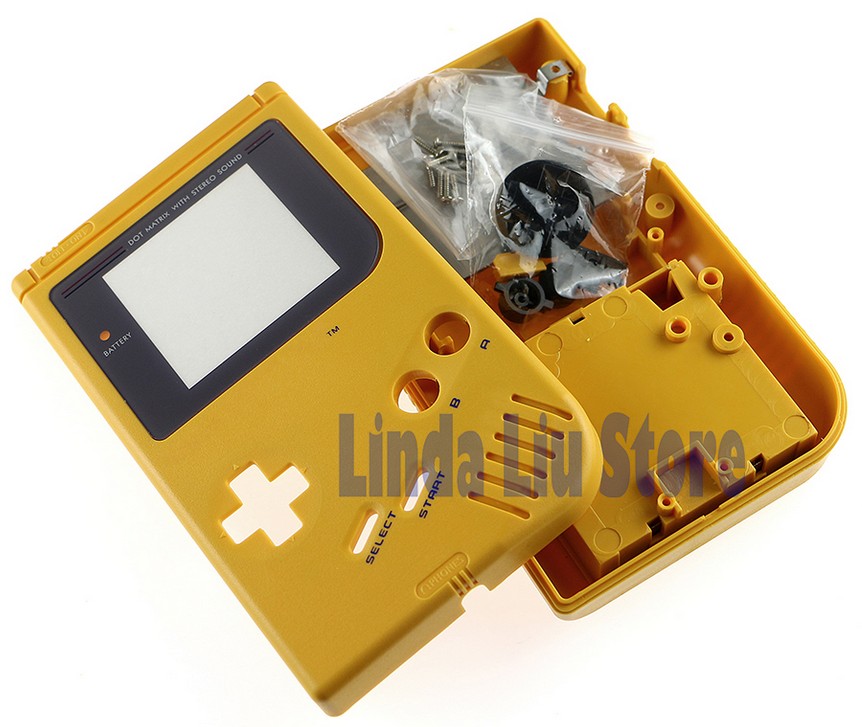

Gameboy DMG case - aliexpress (plus gameboy plastic buttons, silicon rubber pads and case screen cover)
Gameboy DMG case.jpg (110.9 KiB) Viewed 6916 times

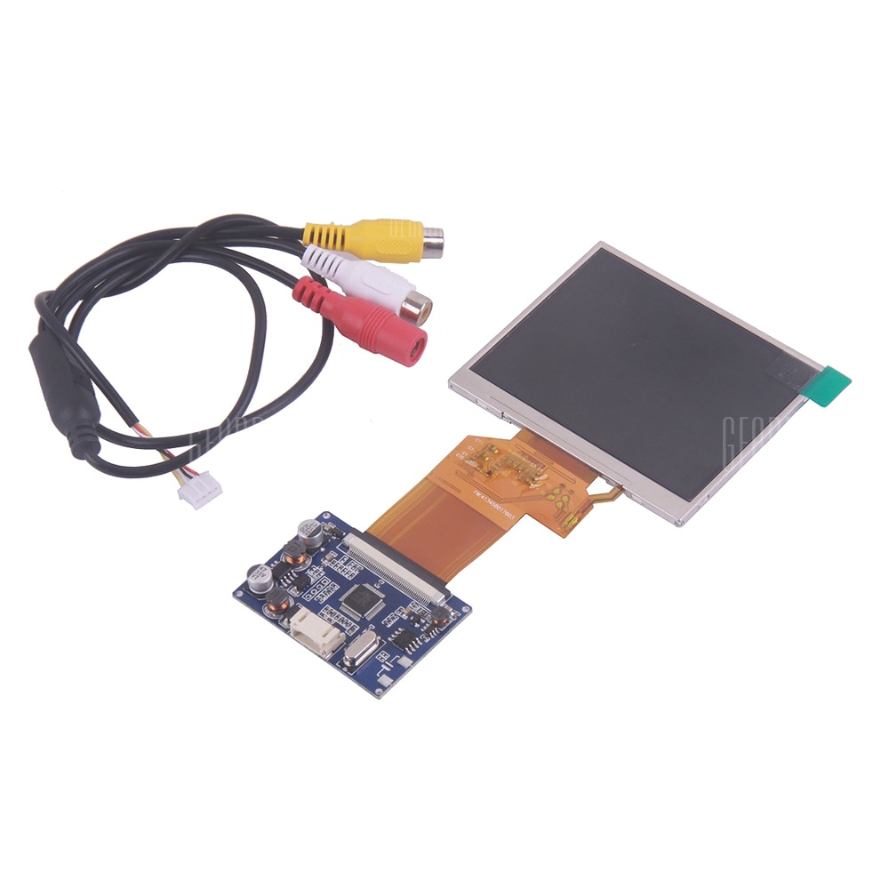

3.5 inch TFT LCD Display - gearbest (composite display that wermy used)
3.5 inch TFT LCD Display.jpg (75.37 KiB) Viewed 6916 times

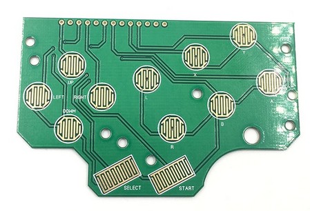

6 button PCB Controller - aliexpress (ordered 6 button pcb just in case I would decide to use all 6 buttons)
Button Pcb Controller.jpg (44.06 KiB) Viewed 6916 times

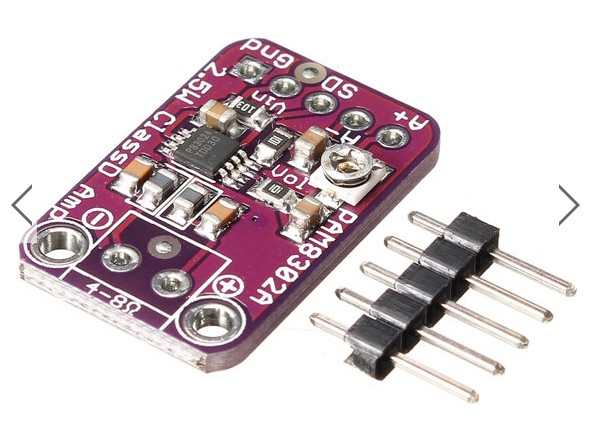

CJMCU-832 PAM8302 2.5W Single Channel Class D Audio Power Amplifier - Banggood (not sure if this is a good substitute for adafruit audio amplifier)
PAM8302 2.5W Single Channel Class D Audio Power Amplifier.jpg (64.33 KiB) Viewed 6916 times

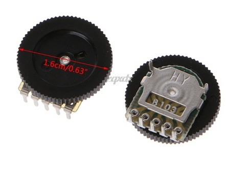

Volume Wheel potentiometer - aliexpress
Volume Wheel Potentiometer.jpg (23.09 KiB) Viewed 6916 times

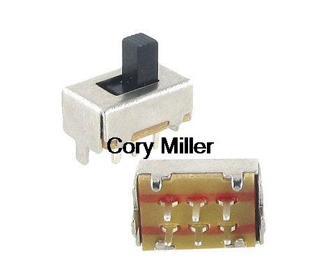

Slide Switch 6 Pin - aliexpress
Slide Switch 6 Pin.jpg (22.95 KiB) Viewed 6916 times

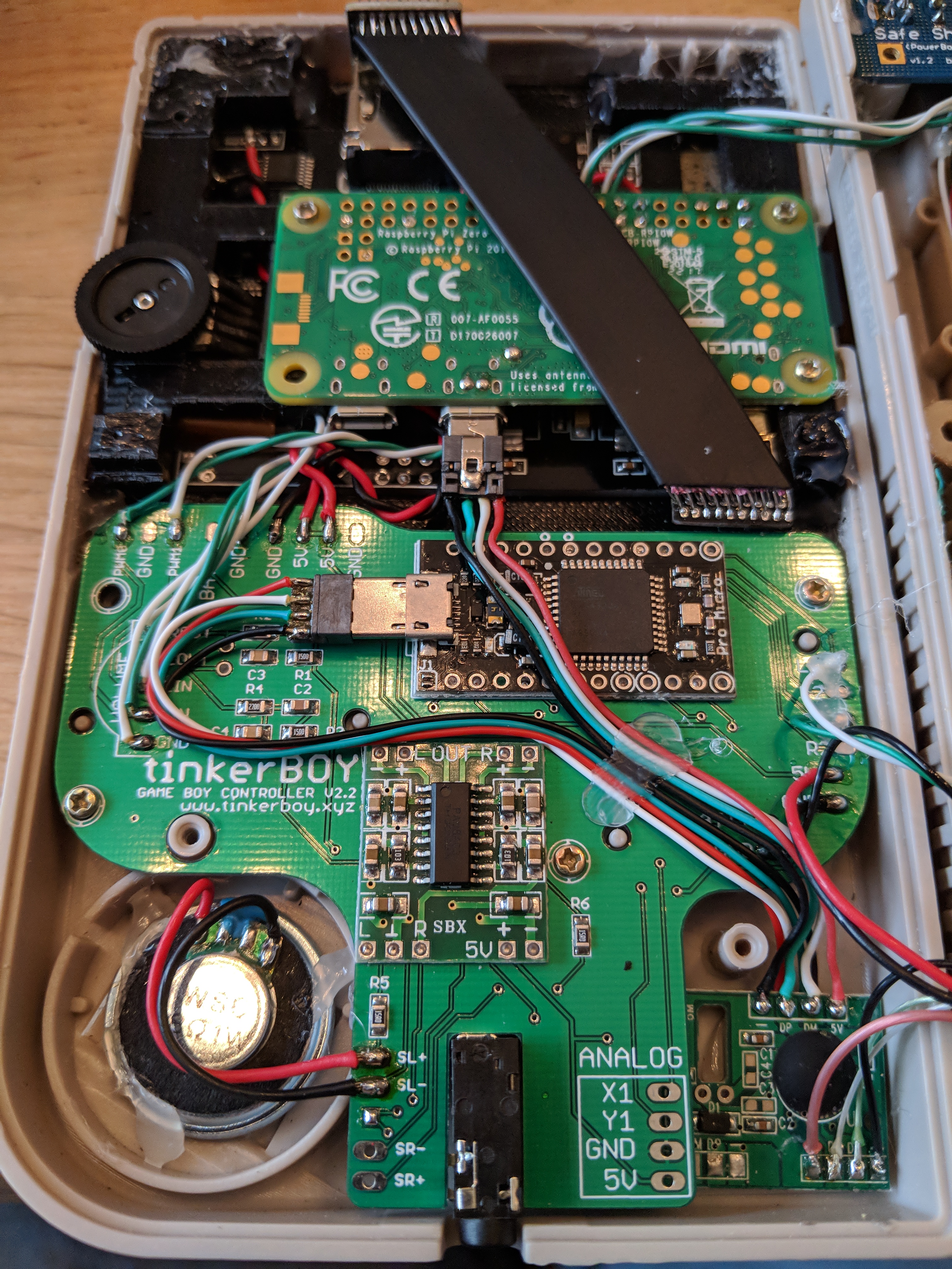

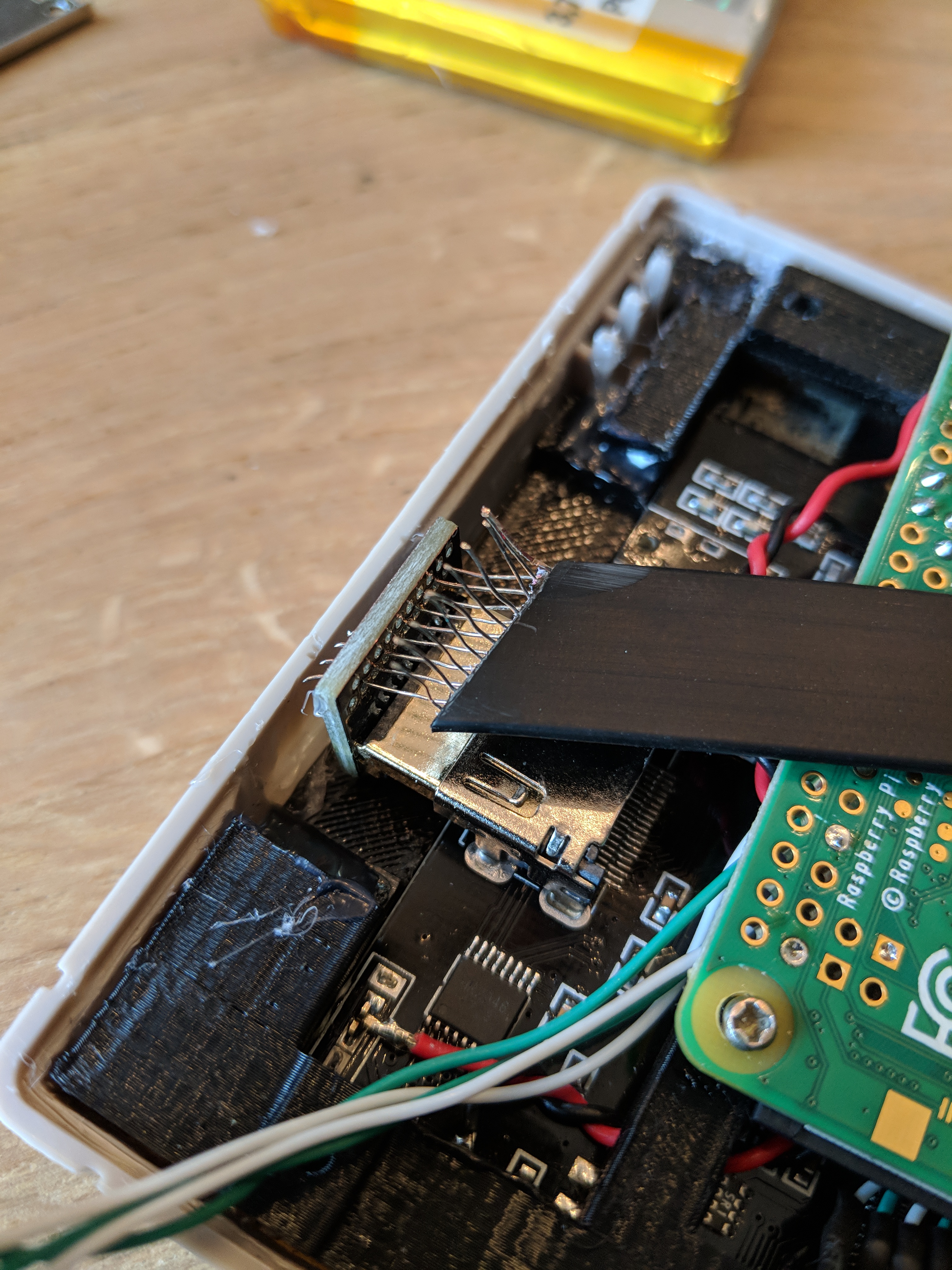

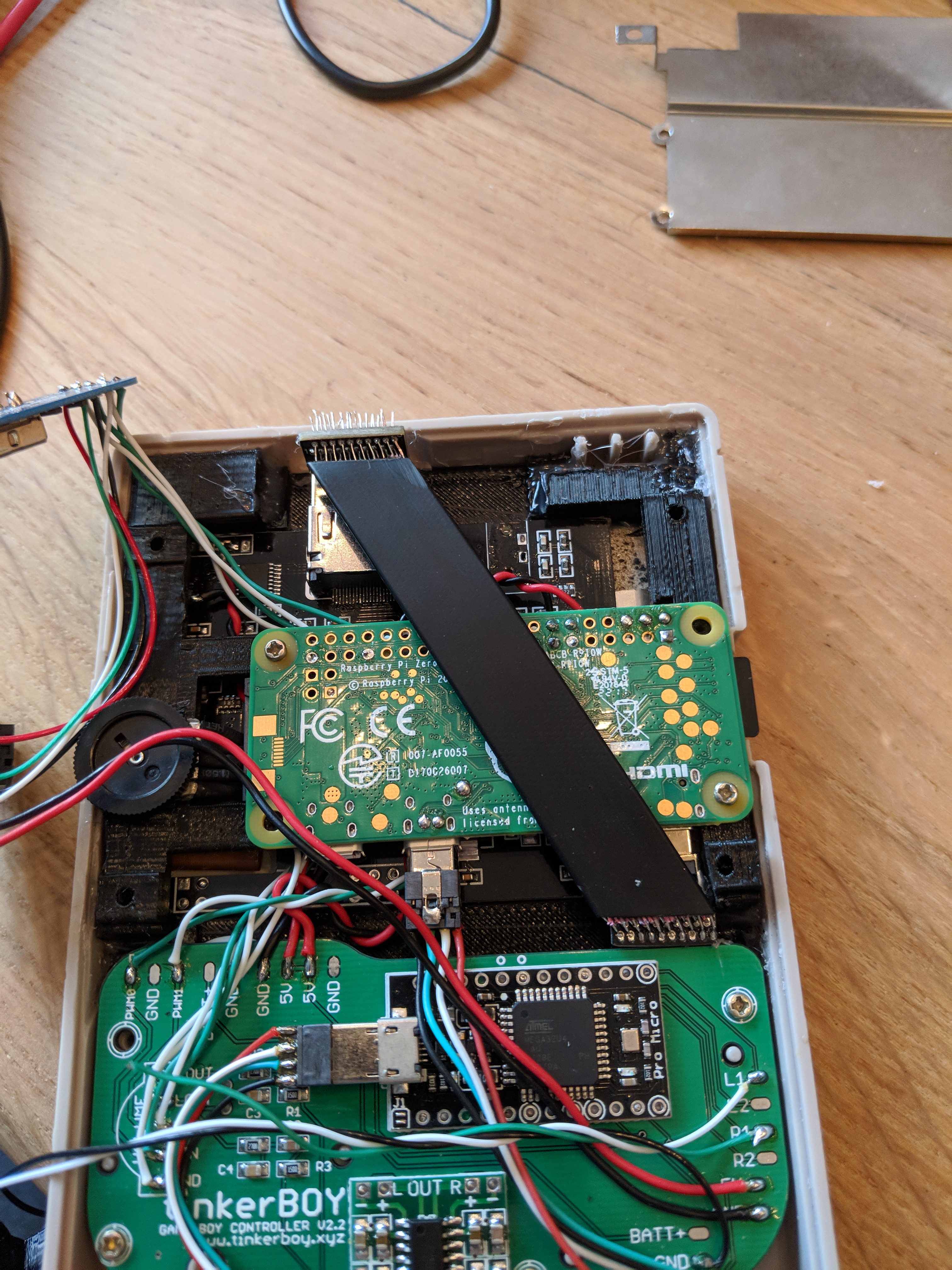

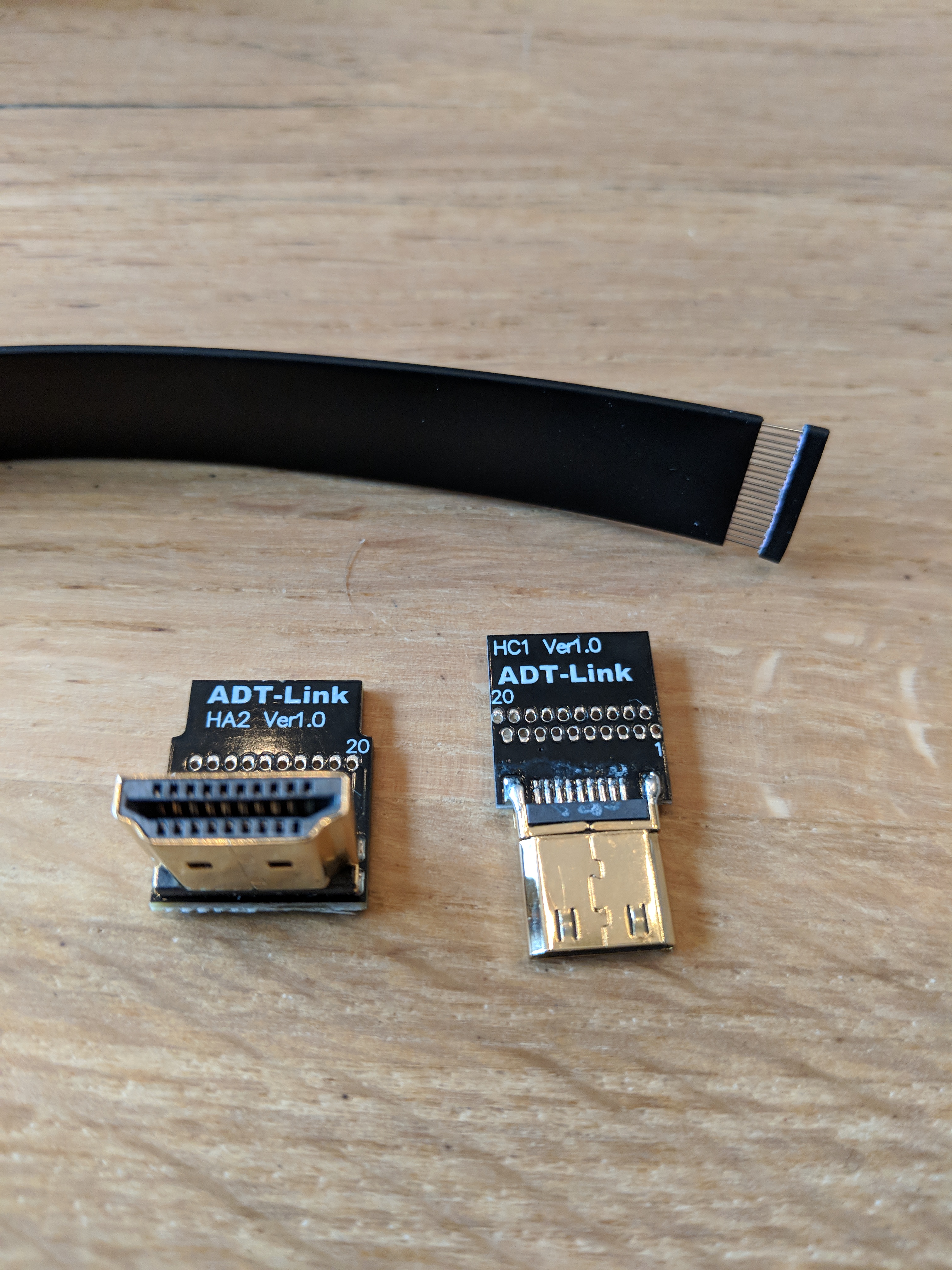

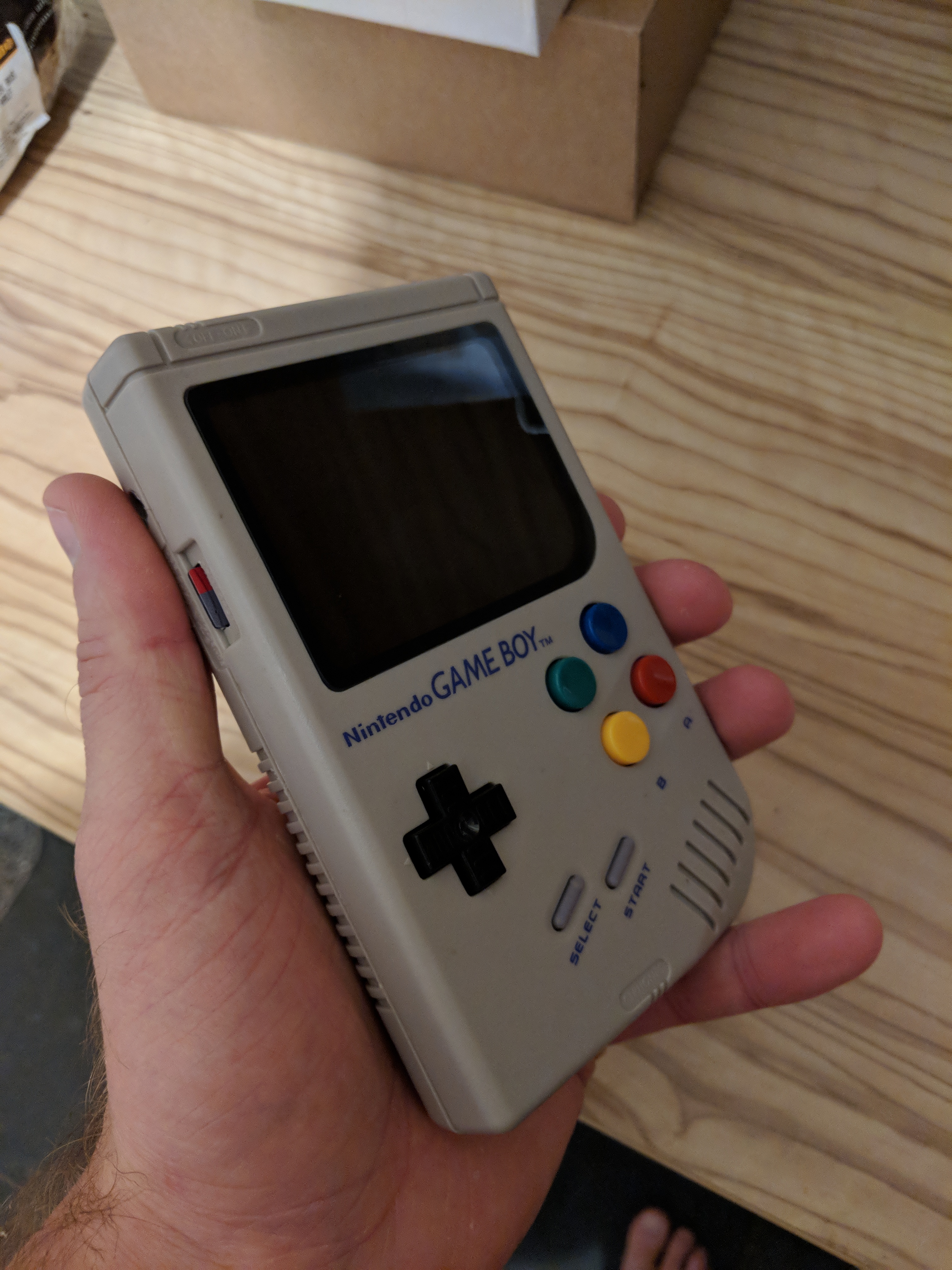

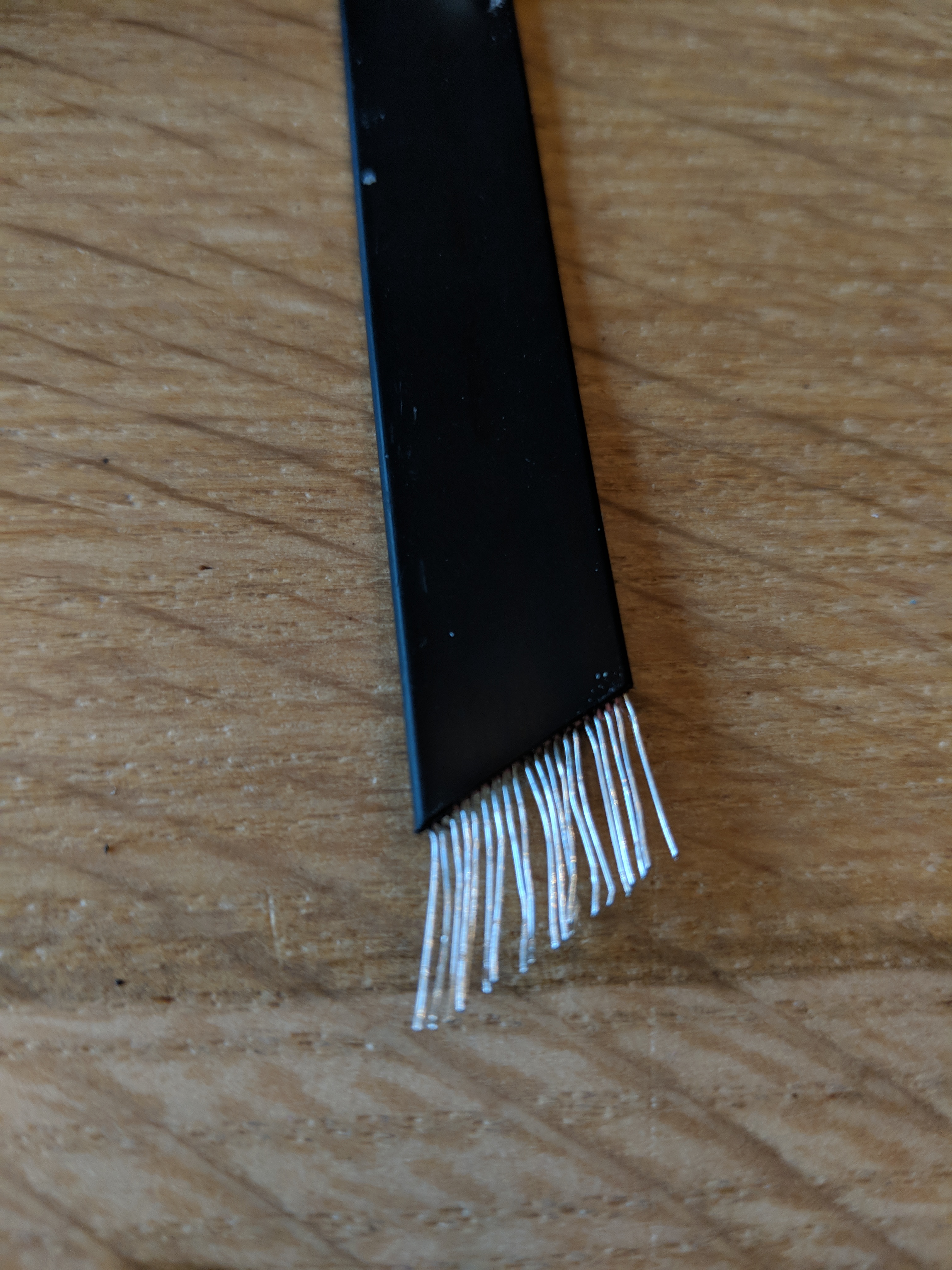

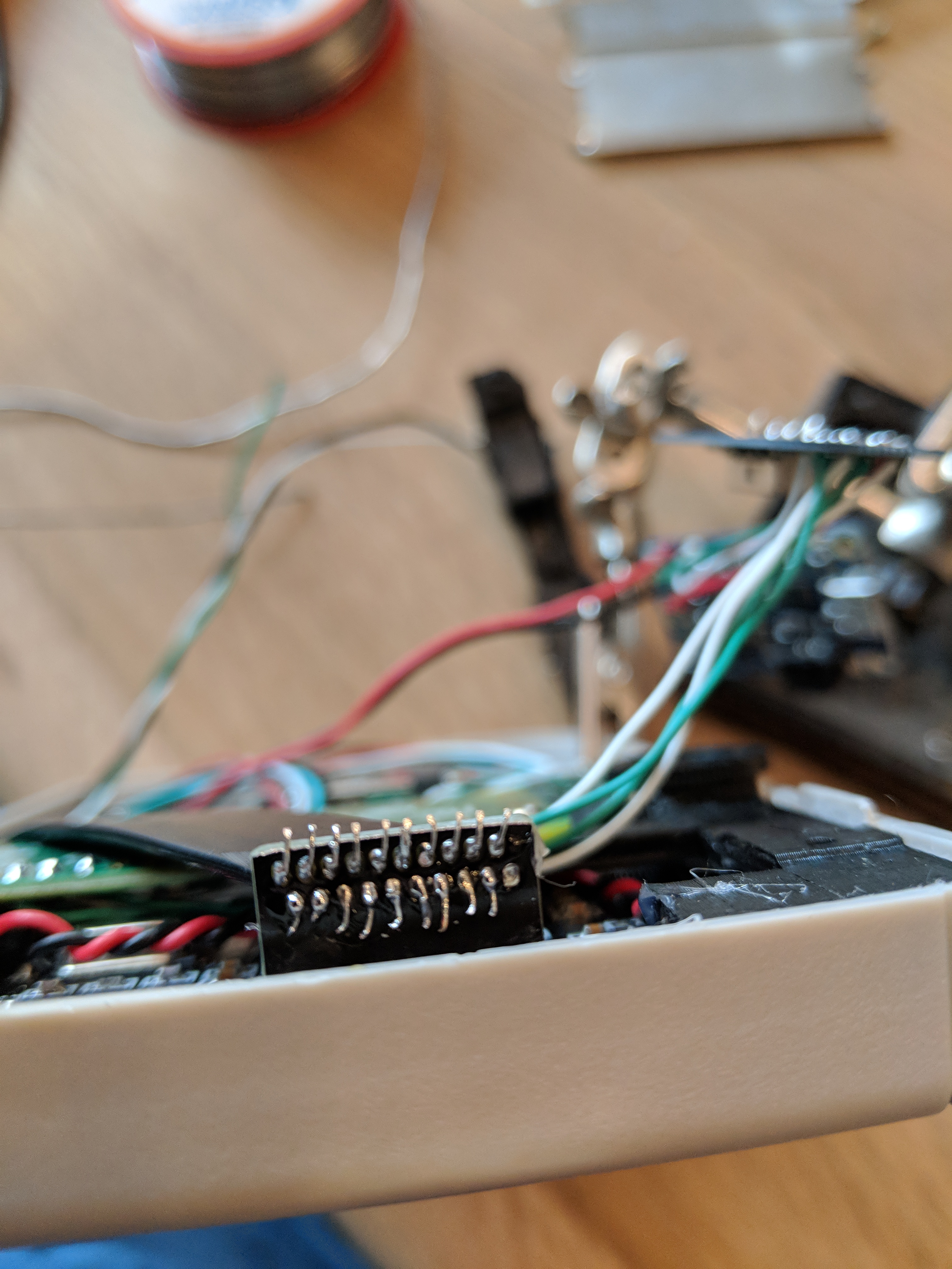

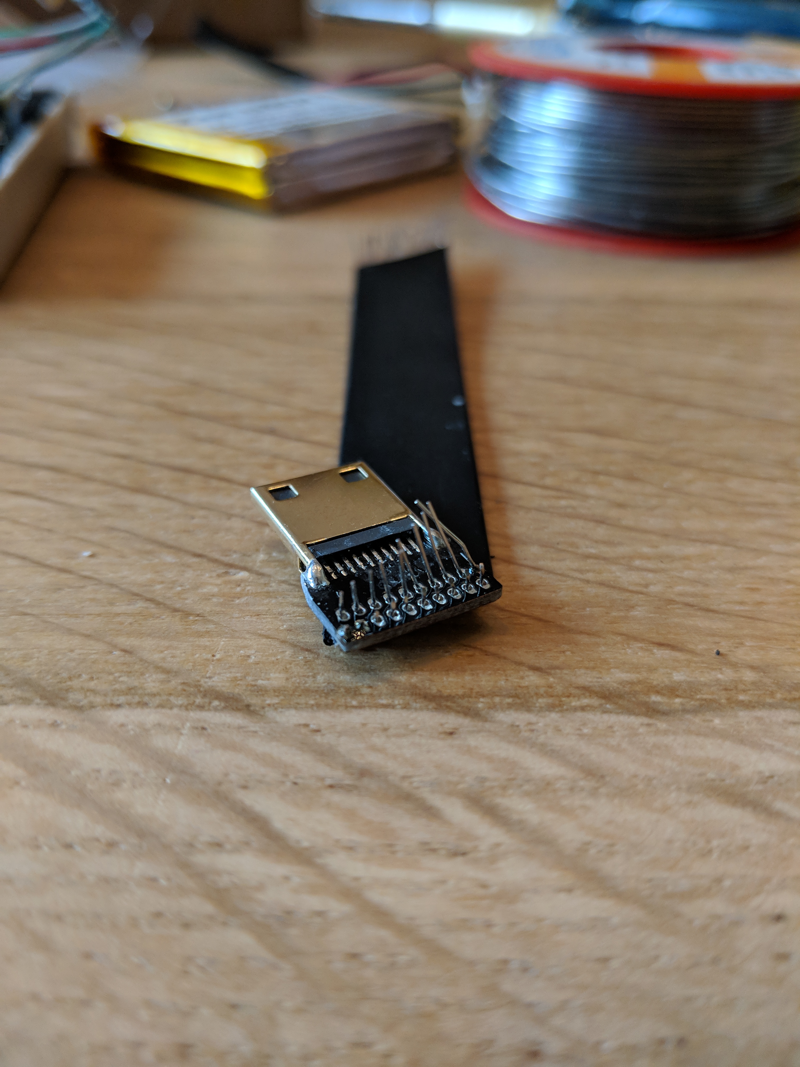

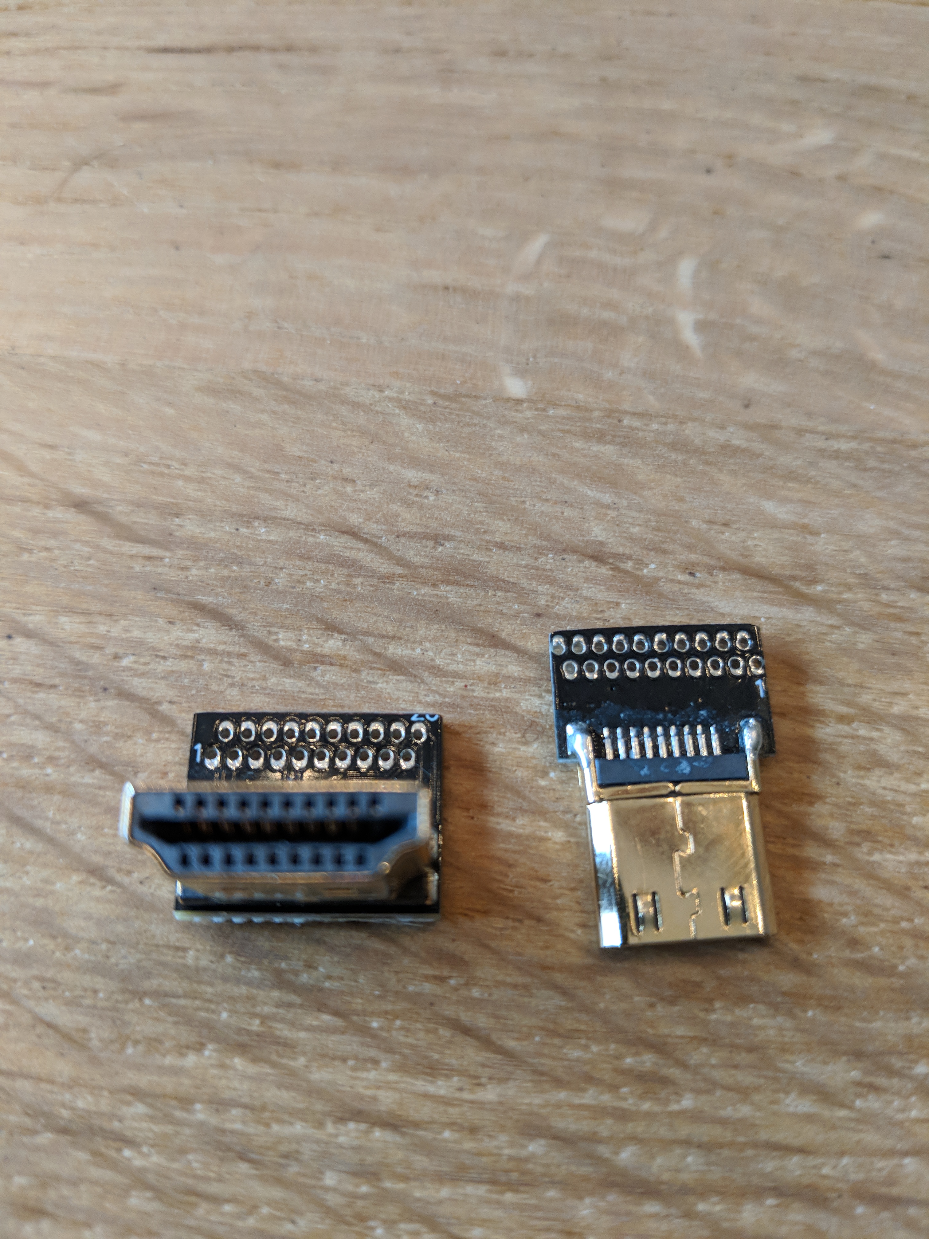

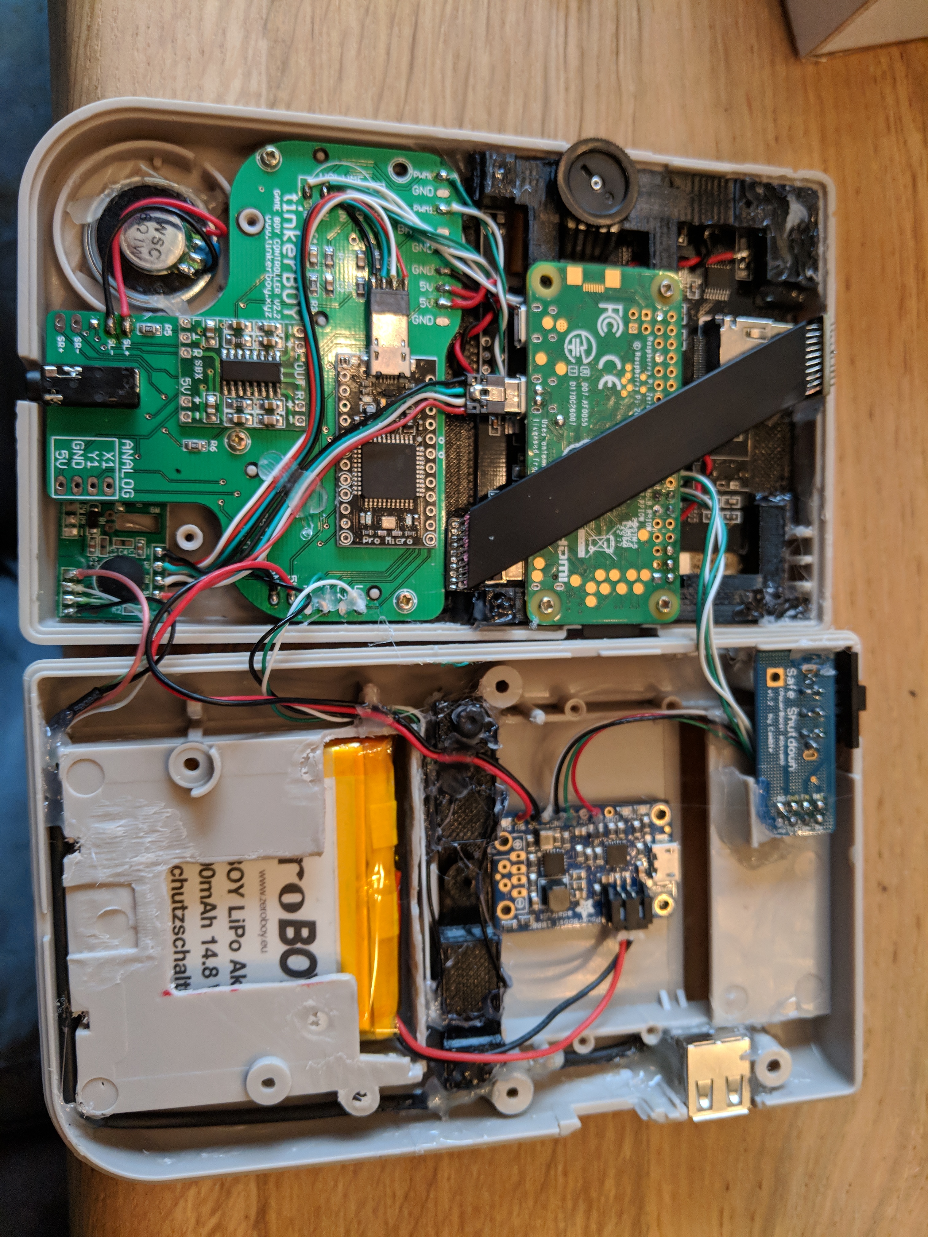

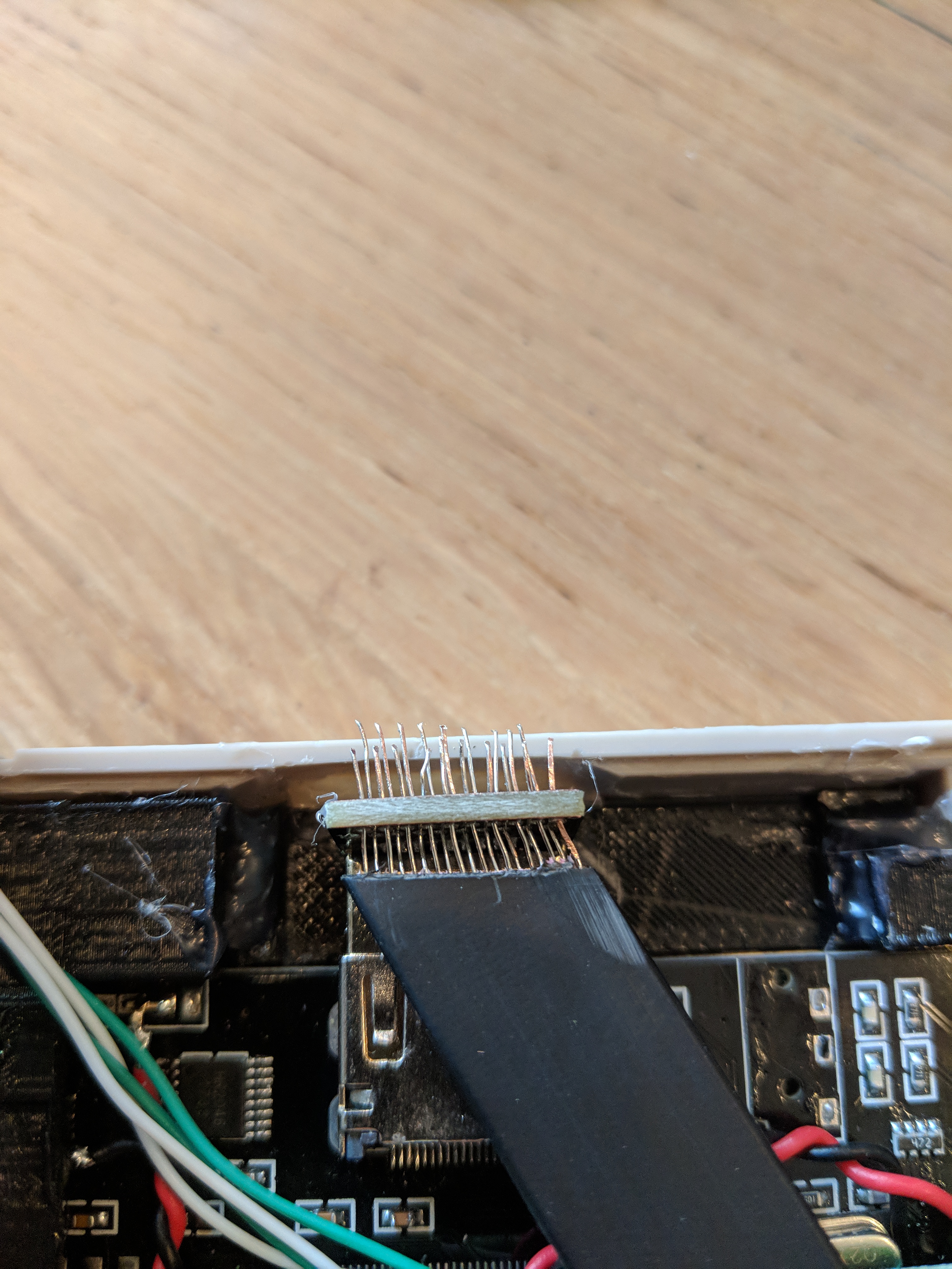

So I followed this build while making one of my own. My main issue was the HDMI cable, and see you had trouble also. I found a great solution! I found a seller on aliexpress who offered custom HDMI FPV cables, but with the ribbon cable soldered to the plugs instead of that flimsy connector. So simply ordered one with the correct plugs and asked them not to solder anything as I want to do that myself (this is the key to my success ;) ) See pictures below.
Parts:
Kedei HDMI screen
Tinkerboy control board
Cambles safe shutdown
Adafruit power module
I won't describe each step in my build, as that has pretty much been covered, but simply wanted to share this as its works and fits perfectly!
