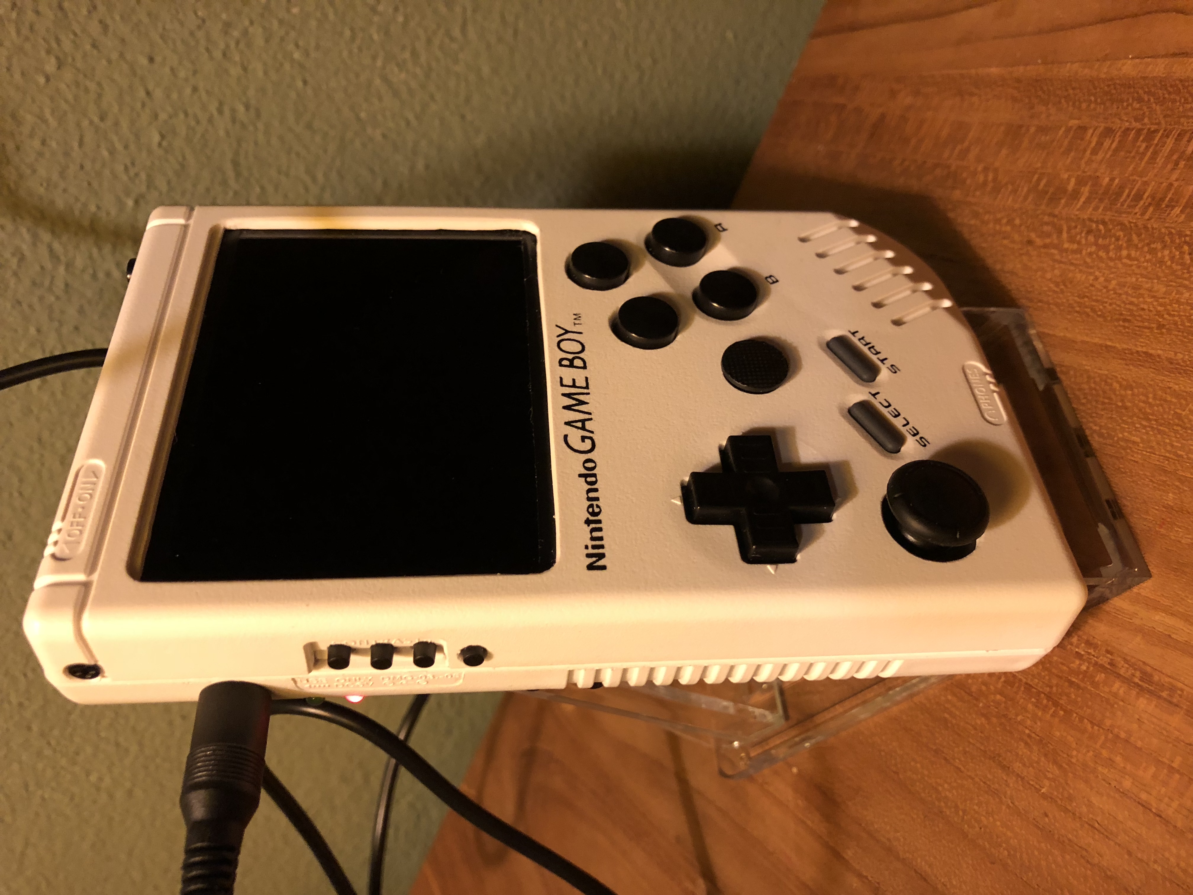

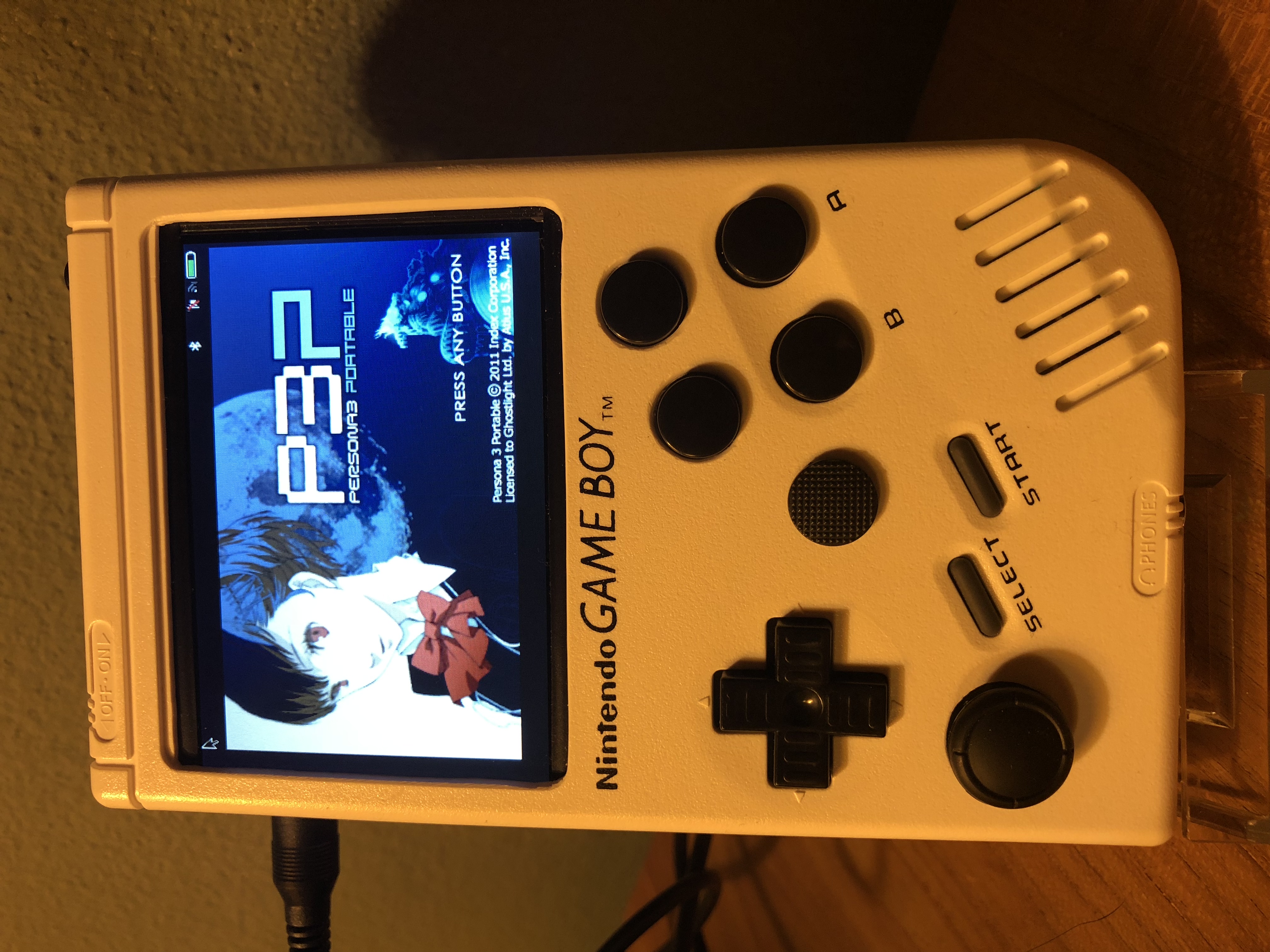

I’ve buid a Gameboy with a Raspberry pi 3B+ inside.
Still tweaking a couple off thinks to optimize the gaming experince. Loving the Joy-Con analoge stick and the psp analoge stick is oke. Also on screen battery indication is a real plus point. Hope they will give a update so the hot key’s will work with the usb controller (pro-micro).
The HDMI screen is doing oke but the refresh rate is still not fast enough, what’s oke is the menu to adjust the brightness/contrast/saturation and volume.
Headphones only, maybe in the fututure i will build in little amp and speakers. But for now it’s oke to reduce some power
Building list:
-Helder’s retro PSU (powerboost)
-5000 MaH lipo Battery
-HDMI screen
-Fan 30x30x10
-Raspberry Pi 3 B+
-Pro-Micro
-Homemade HDMI cable
-Joy-con and PSP analoge sticks
-FPC-6P 0.5MM connector (Joy con)
-Button PCB
-Just the regular (after market shell/knobs/etc.)
Still to do (maybe):
-Replace the psp analoge stick with a Joy-Con.
-Update with a better HDMI screen in the future
-Amp and speakers
-Analoge Volume pot
PS sorry mine English isn’t that great.

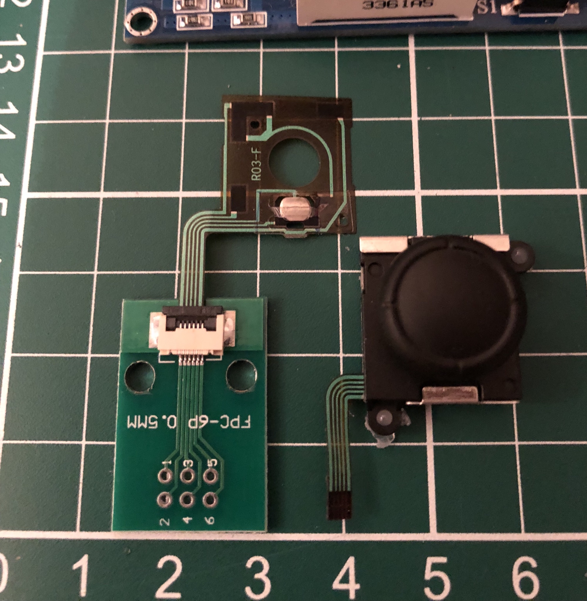

Flowuz
Posts: 7
Joined: Fri Nov 02, 2018 3:16 am
Re: Gameboy Pi 3B+ / Joy-con / HDMI / Retro PSU
Post by Flowuz » Wed Dec 05, 2018 12:21 pm
hueblo wrote:
Mon Nov 26, 2018 11:54 am
Nice work homie. Interested to see how the Joycon is hooked up.
Joy-con pin out.
I had killed 1 so i could see the inside and see the connections. And it was try and error, it is a small ribbon.
1. VCC
2. Up/Down
3. Push (button)
4. Ground
5. Left/Right
Hope it helps you, it playes prety well.
