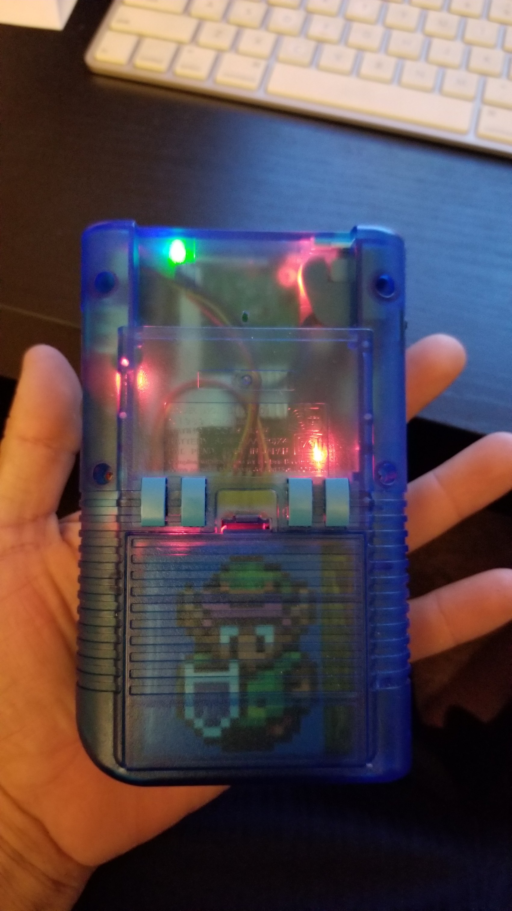

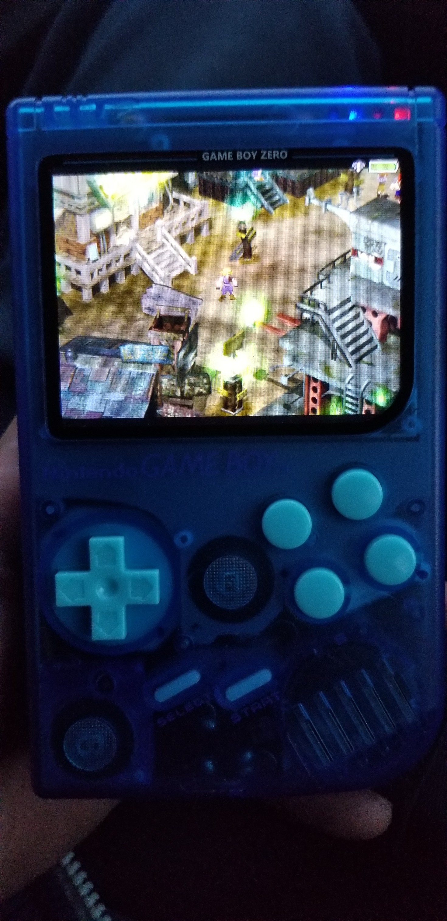

Finished photo first.

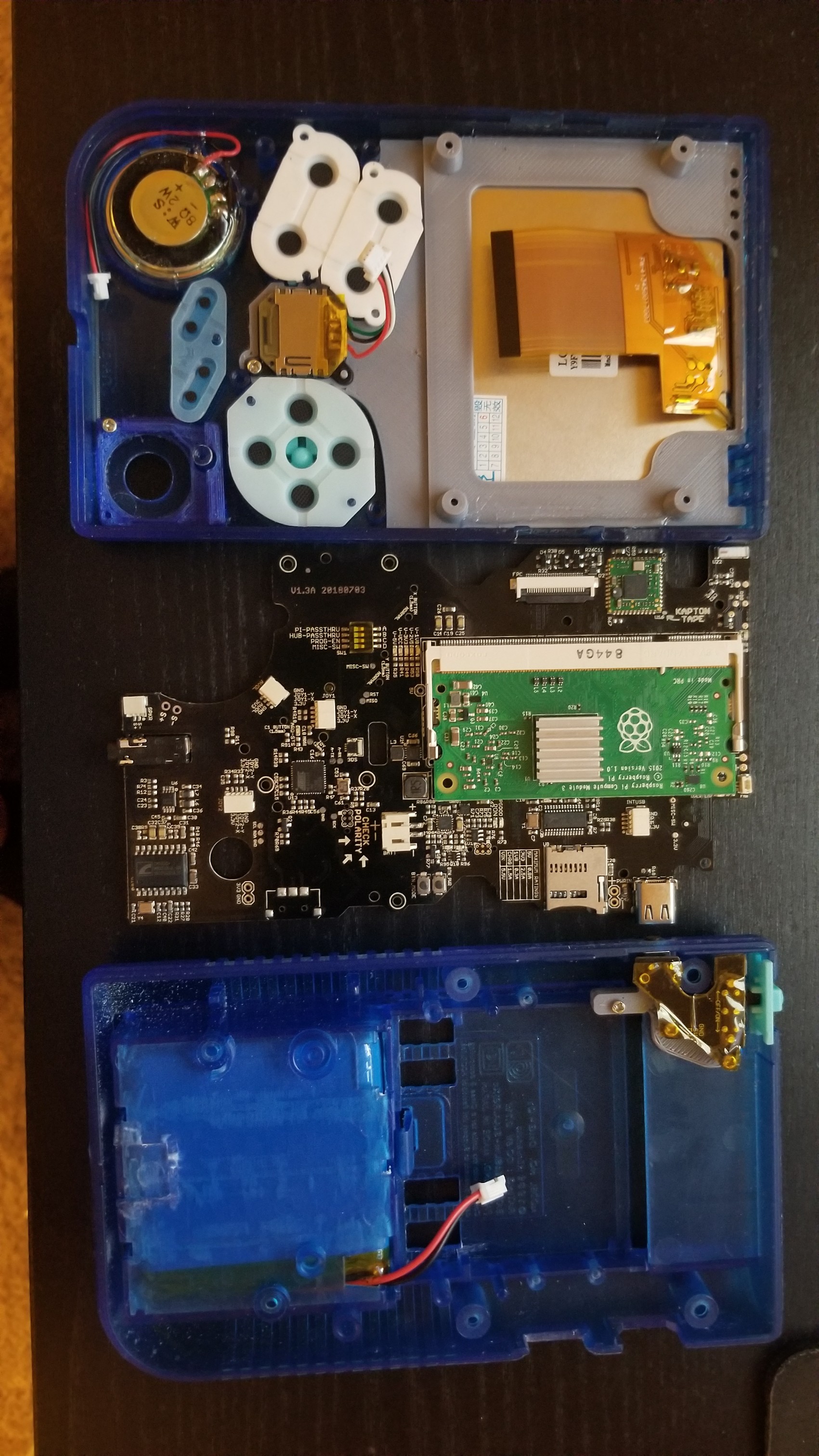

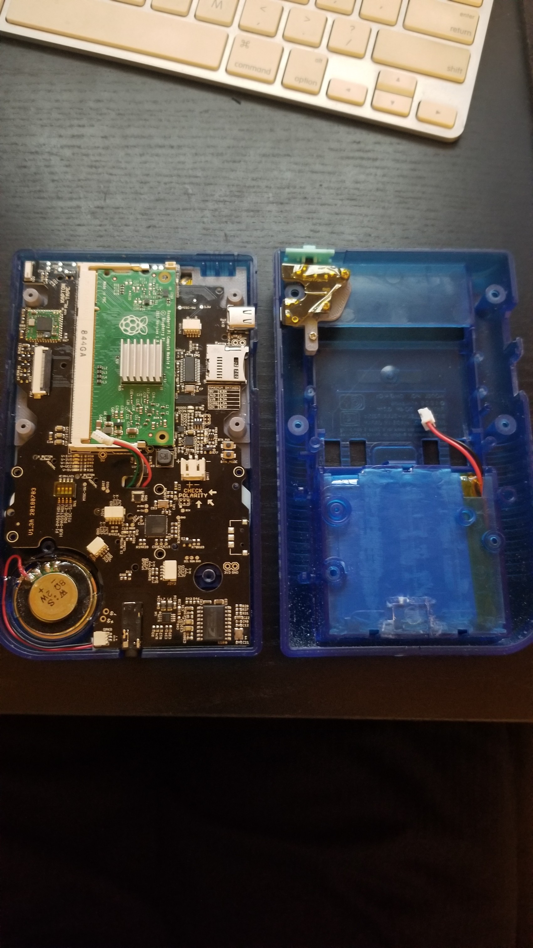

I decided to go with a clear blue case, i didn't get very many pictures of me as i modded the case. but i decided to go with the mandatory 4 button A,B,X, and Y. i also decided to go with 2 joysticks and L1,L2,R1, and R2 buttons in the back. I used HoolyHoos psp screen bracket and and printed up the secondary joystick housing on a 3d printer. I then decided to glue it into place with some super clear silicon as seen below.
I then got everything mocked up to test fit and made sure everything lined up properly. and started connecting everything and siliconing pieces and wires in place.
The next issue i had was figuring out how to get the back buttons to work with HoolyHoos back button pcb. i decided to go with rectangular buttons in the back so i had to carefully and painstakingly file out 4 rectangles on the back of the gameboy, once i finished i then ran into another problem of the buttons having a gap between them and the soft tactile buttons which are provided with hoolyhoos kit so i printed out some spacers and glued them to the back of my rectangular buttons and it worked like a charm.

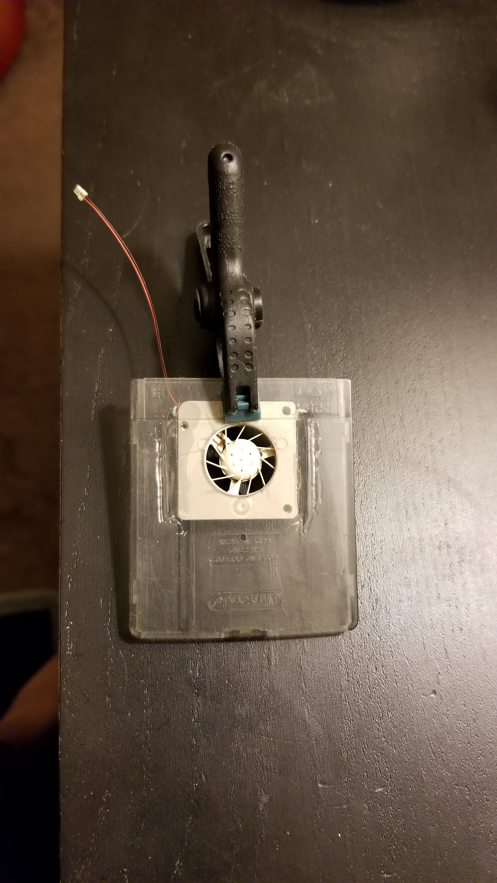

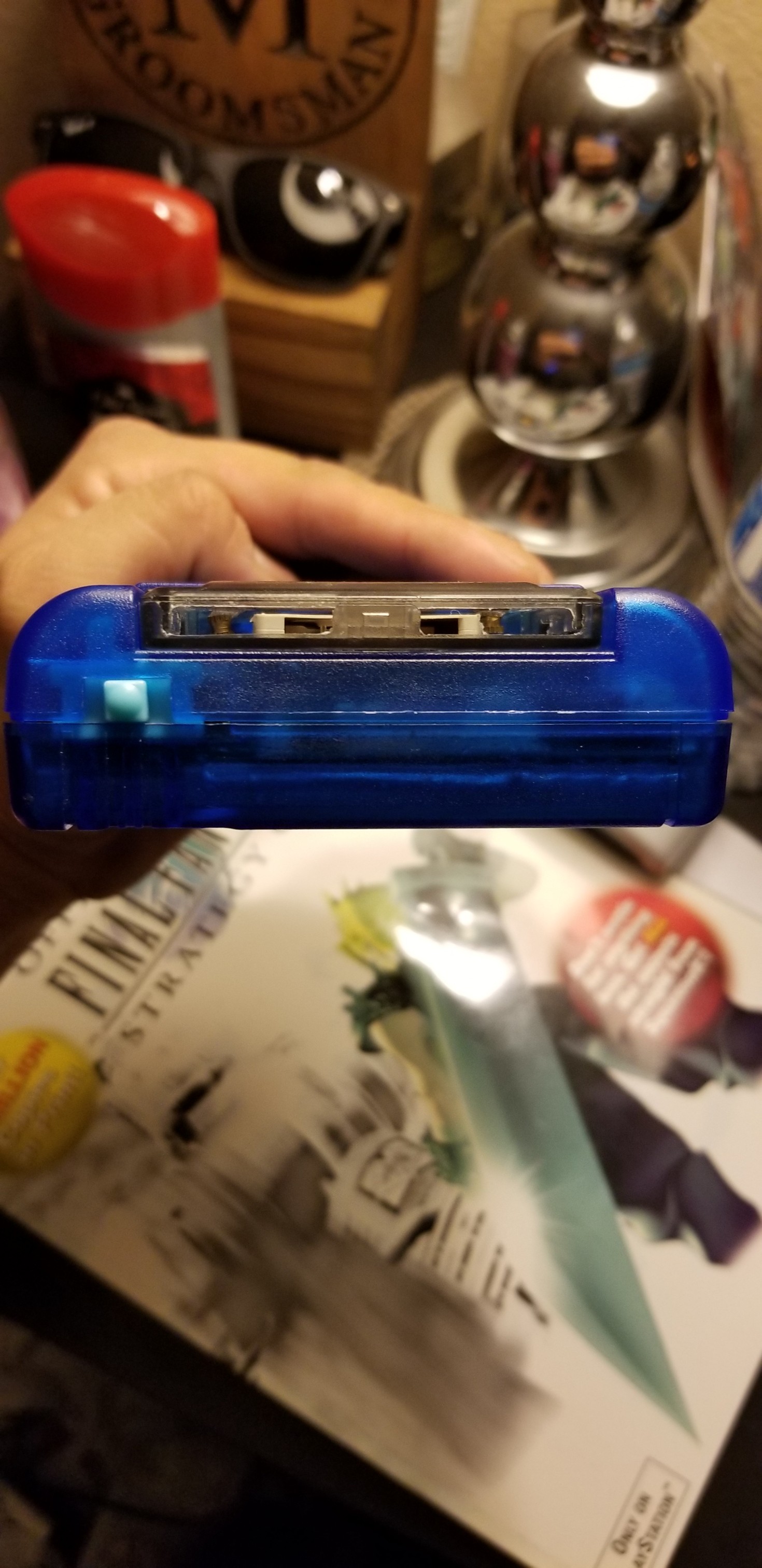

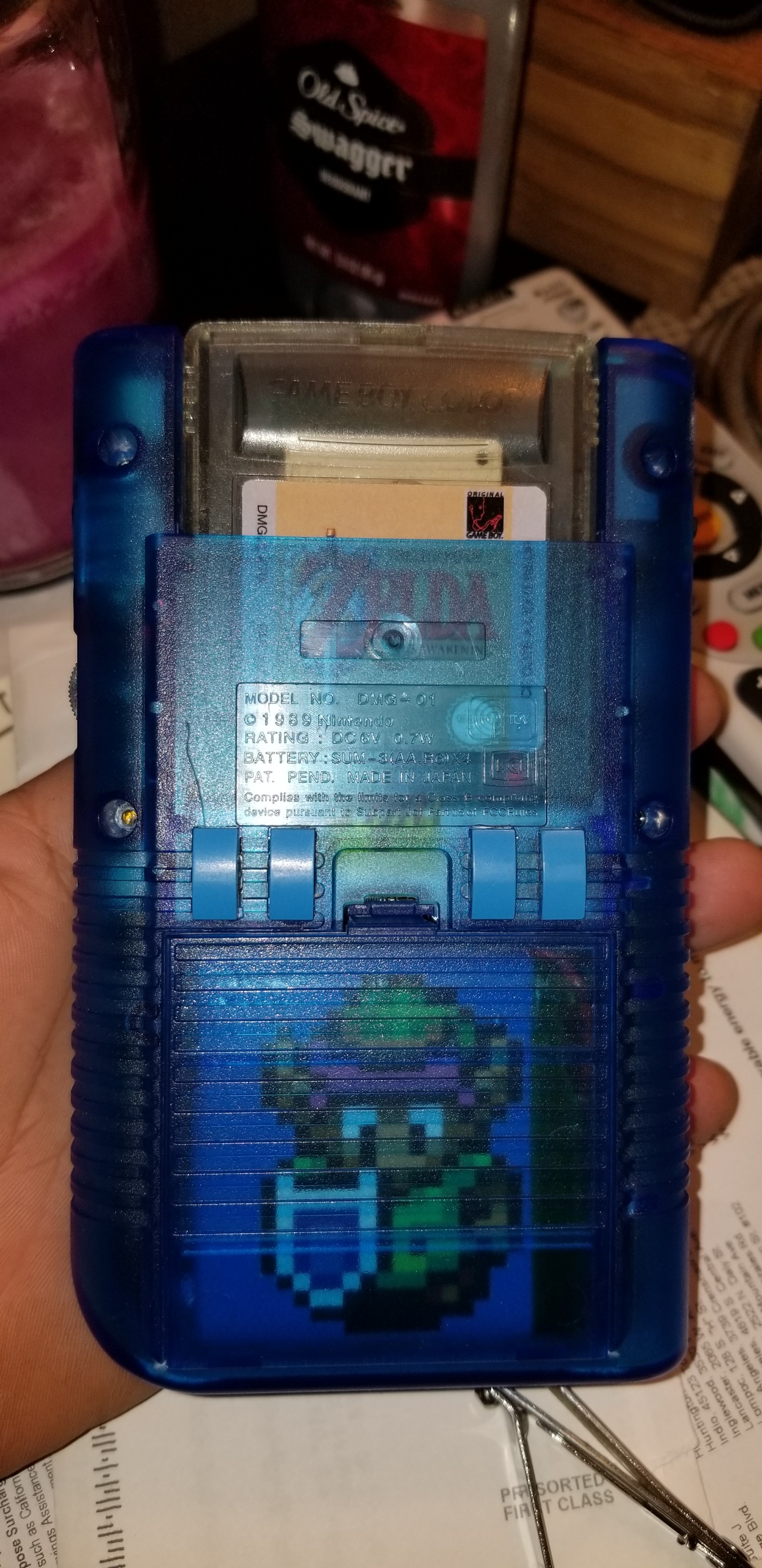

After that everything was good to go, except for the gameboy cartridge. I ended up looking through my collection and found an old Game Boy Color cartridge which had a pretty beat up sticker on it (it was a wwf game) so i decided to tear that one down and throw my fan into it. i proceeded to use the silicon to glue it in place and drilled a hole for the fan and also the wire to go through and also filed off vent holes in the top of it. I decided to go with a zelda theme so i ended up buying a zelda links awakening sticker and threw it on there to cover up the fan. i then made two holes through the gameboy and the back of the cartridge to screw the game in place
i originally wanted to do a more thorough build thread but realized i didn't take as many pictures as i would have liked so heres my last picture of it put together and running. As you can tell with all the filing i had to do by hand i put a small scratch next to my R1 button =[
