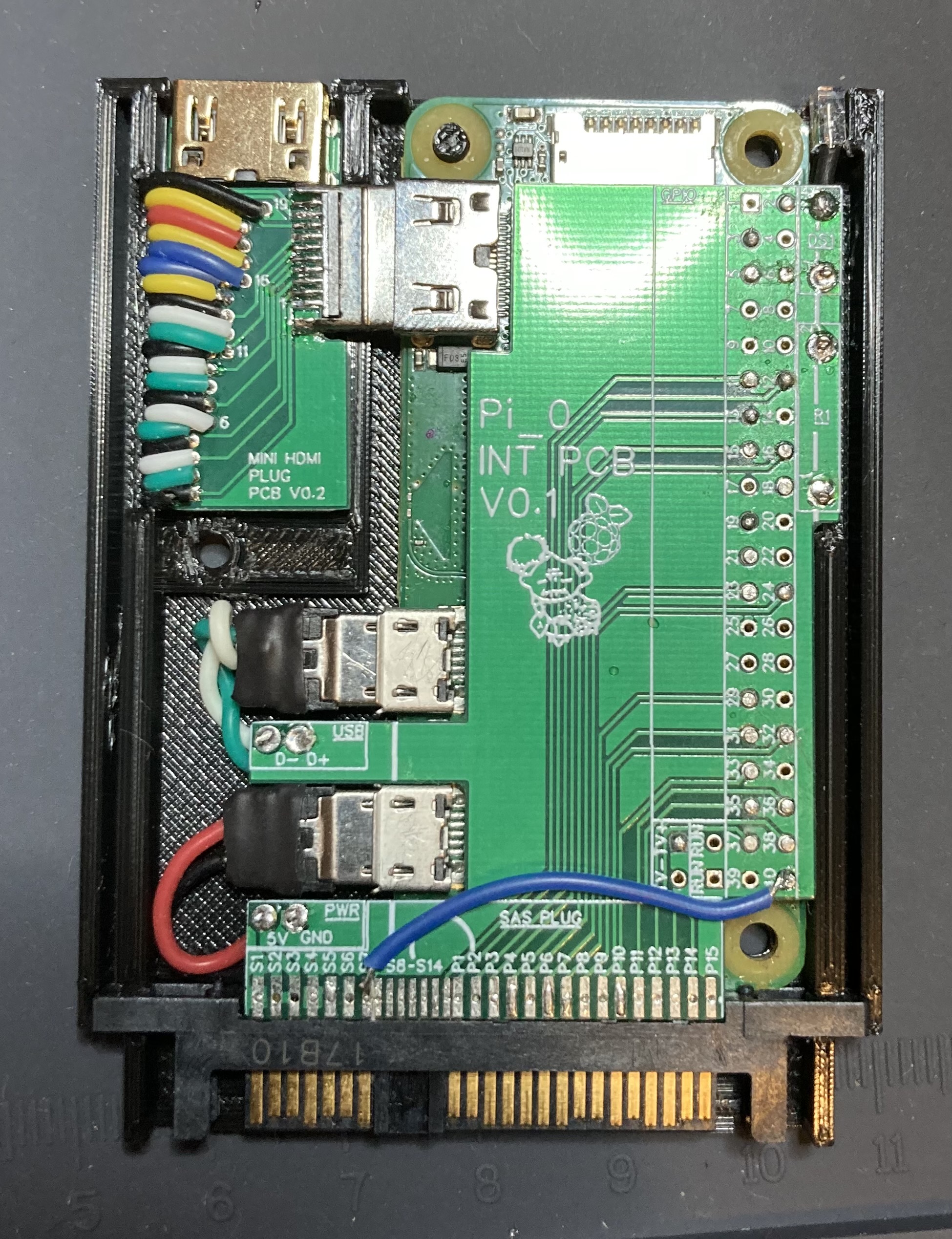

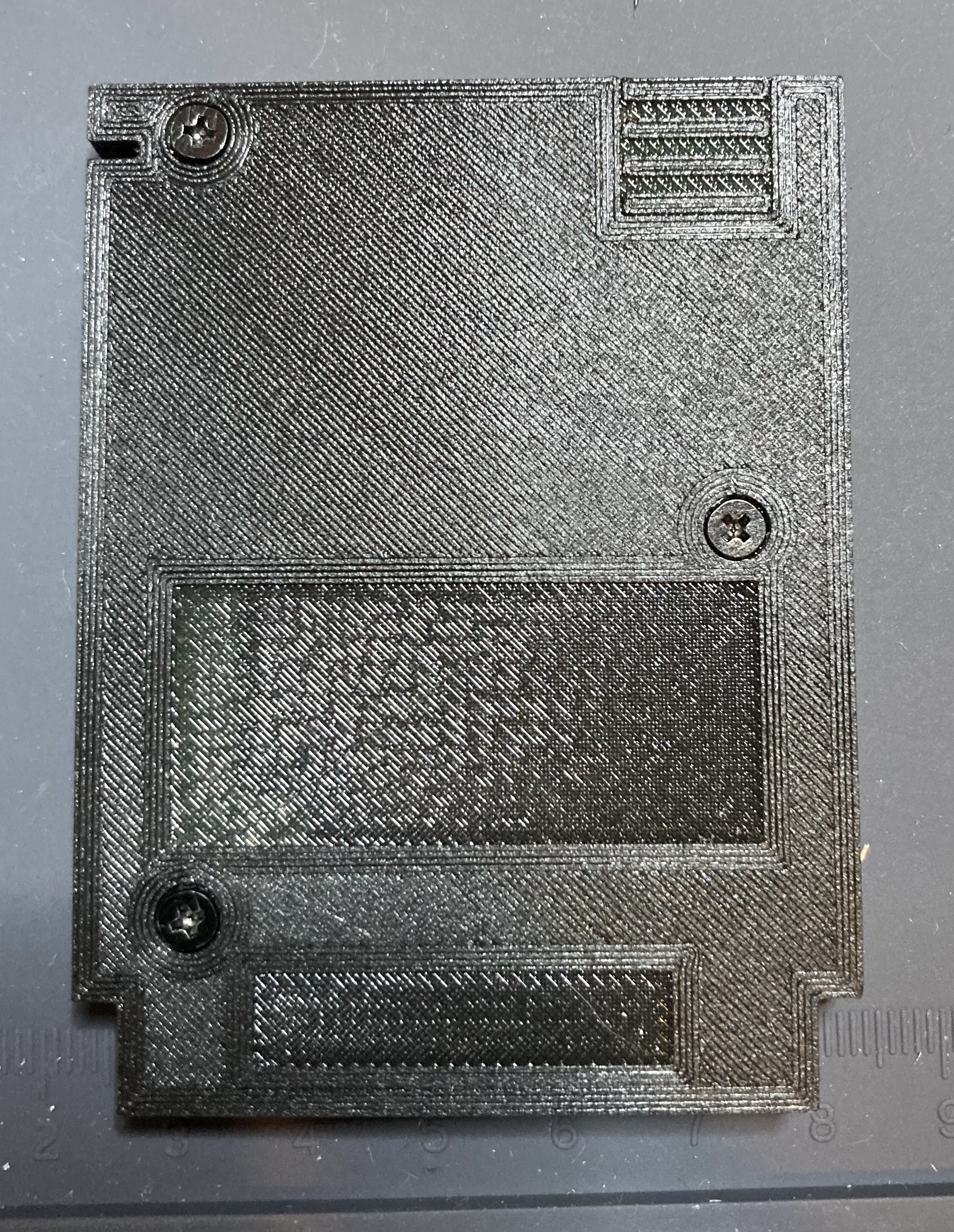

From the beginning of my project, I wanted to try and design my GBZ around installing the Pi Zero W in a cartridge to allow for adapting it to new applications. Additionally, I wanted to keep the game boy shell modifications as simple as possible, which includes using the existing ports to the greatest extent possible.
So, I started with the cartridge and worked out the rest of the GBZ around that. Due to space constraints with the original cartridge size, I decided to design something new…which naturally led to a design inspired by the NES cartridge.
GBZ Pi Zero Cartridge - Front
GBZ Pi Zero Cartridge - Internal
GBZ Pi Zero Cartridge - Back

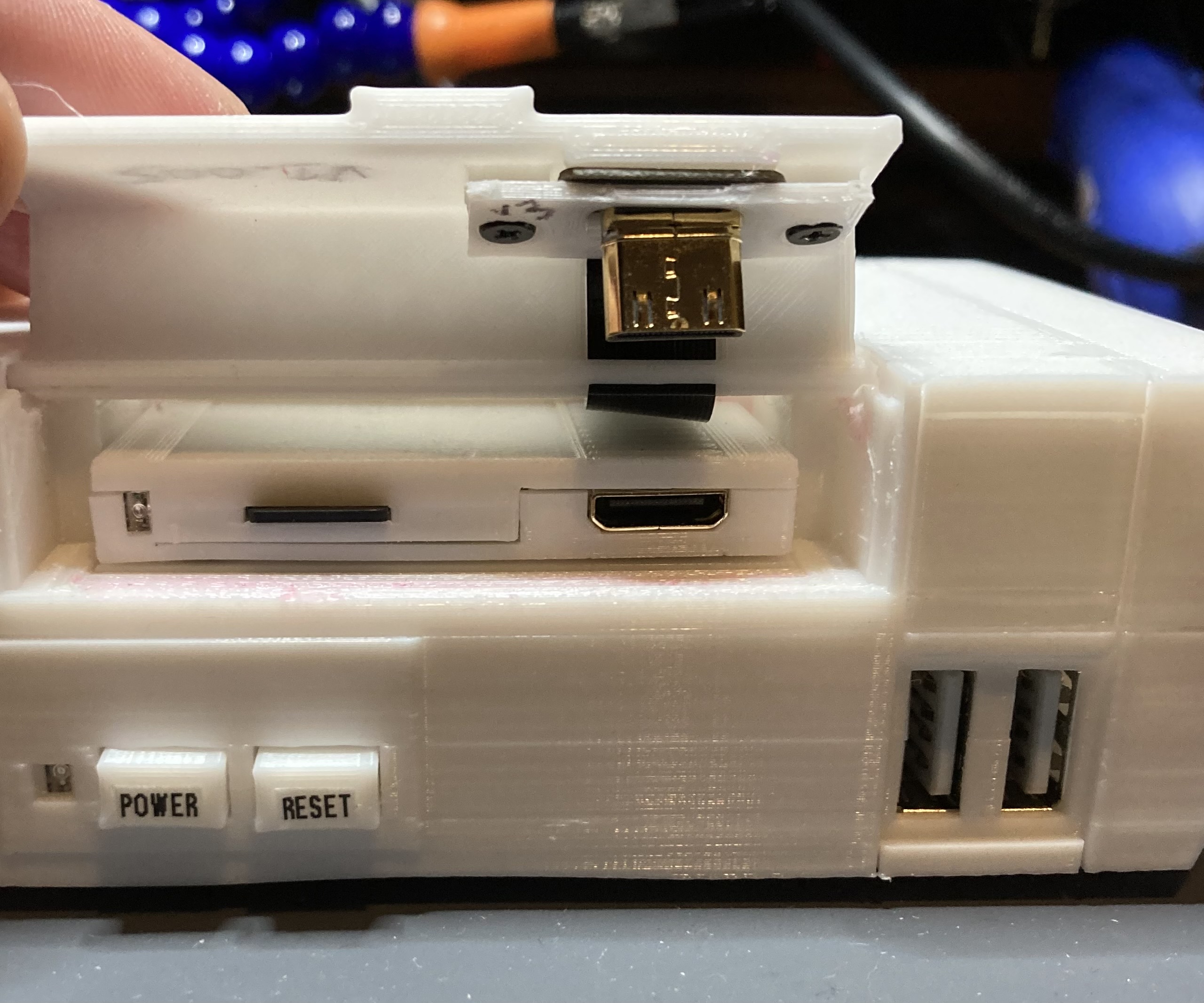

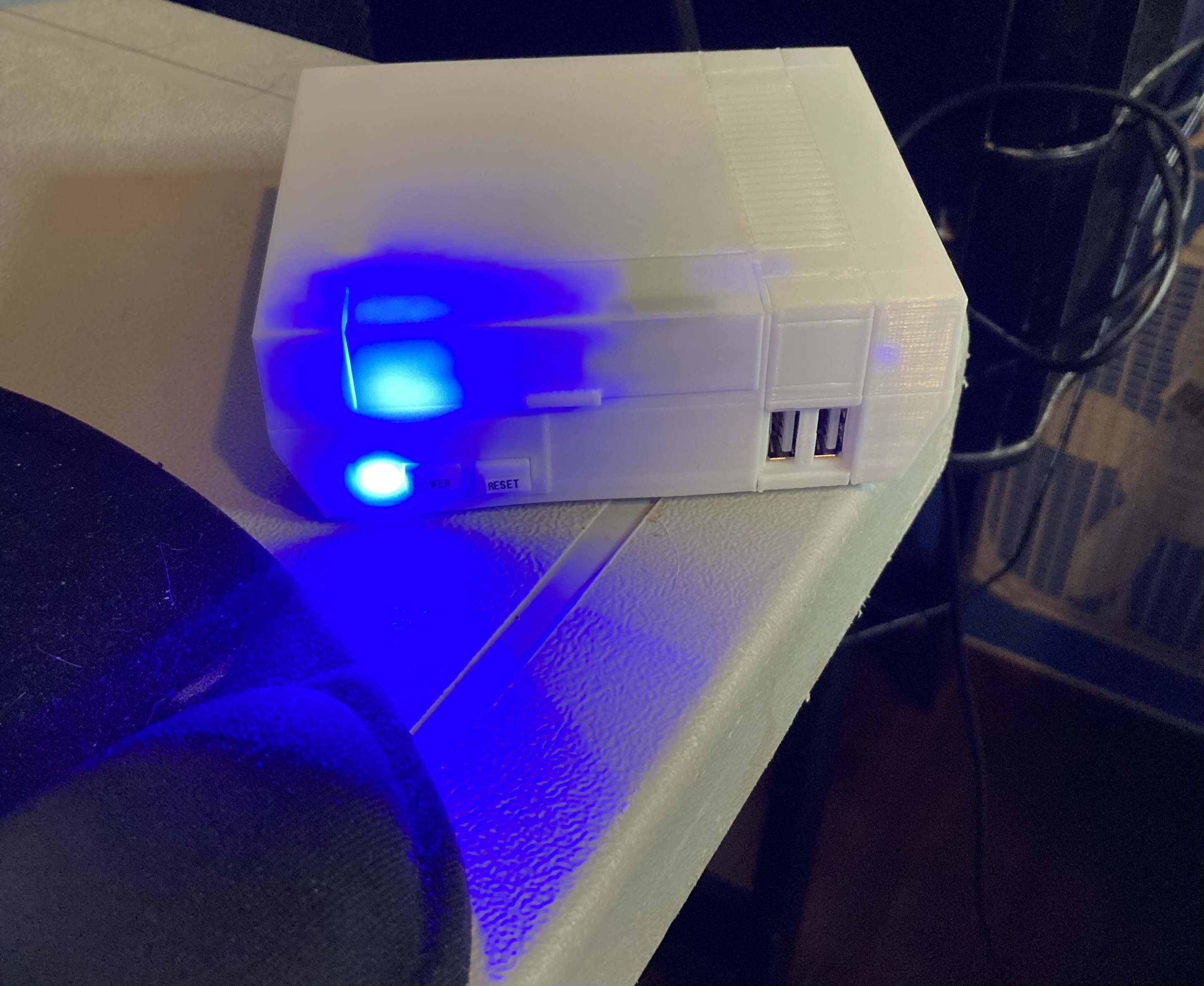

Then, I had an idea of designing a stand alone “system” I could seamlessly switch* the cartridge between to allow for gameplay on the TV, the use of additional gamepads, multiplayer gaming, etc. I have not finalized a name for the additional “system”, so herein it will be referred to it as the Micro NES.
GBZ w/ Pi Zero Cartridge Installed
Micro NES w/ Pi Zero Cartridge Installed
Working on both of these in parallel probably contributed to why this project is taking so long, but it was worth it.
While both of these builds are functional and the Pi will boot in the correct configuration depending on which system it is installed in, there are still some issues I am trying to fix and improvements I am working on - like utilizing a Pi Zero 2 in the cartridge, misc Retropie config updates, making labels, and the list goes on and on.

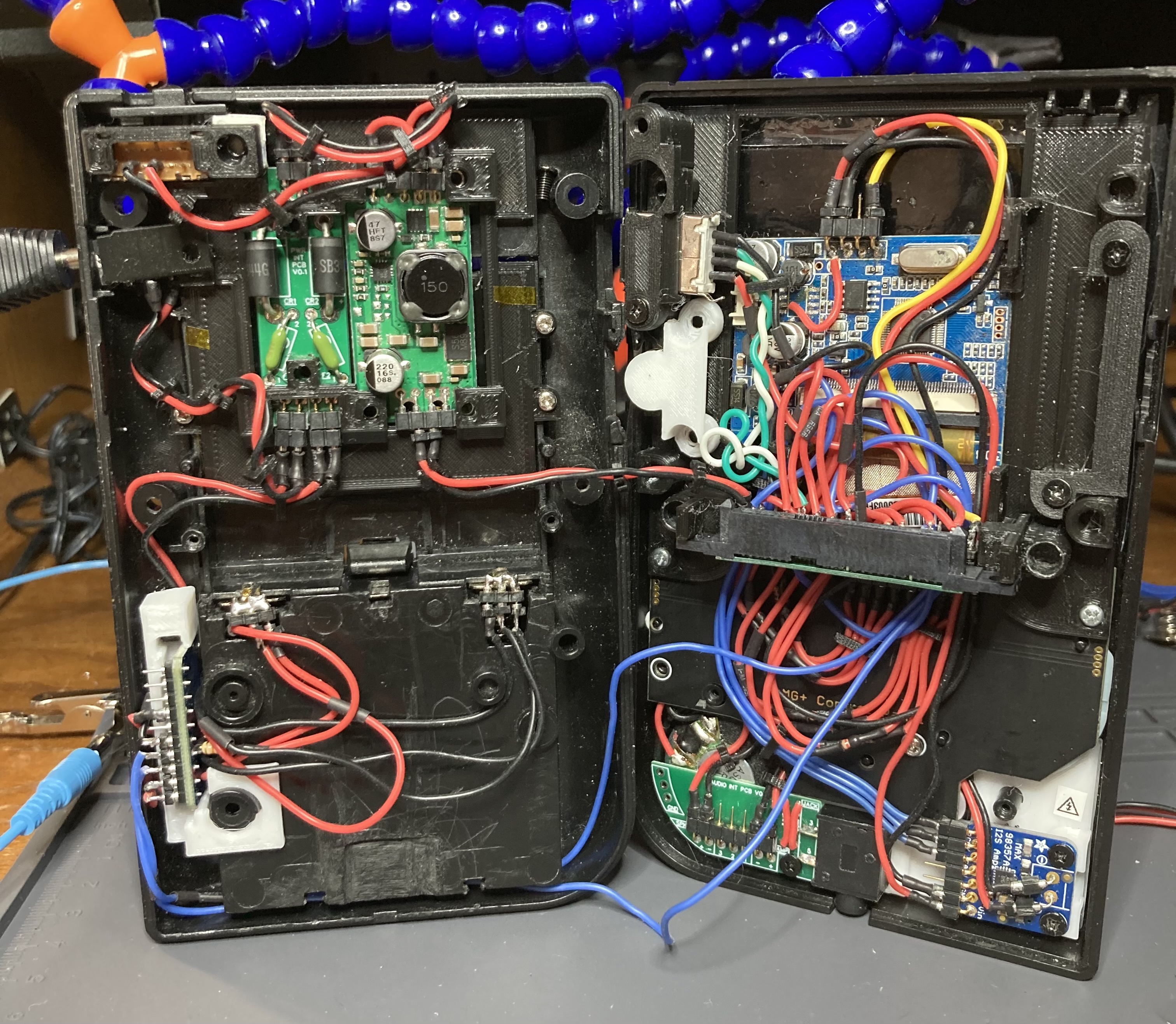

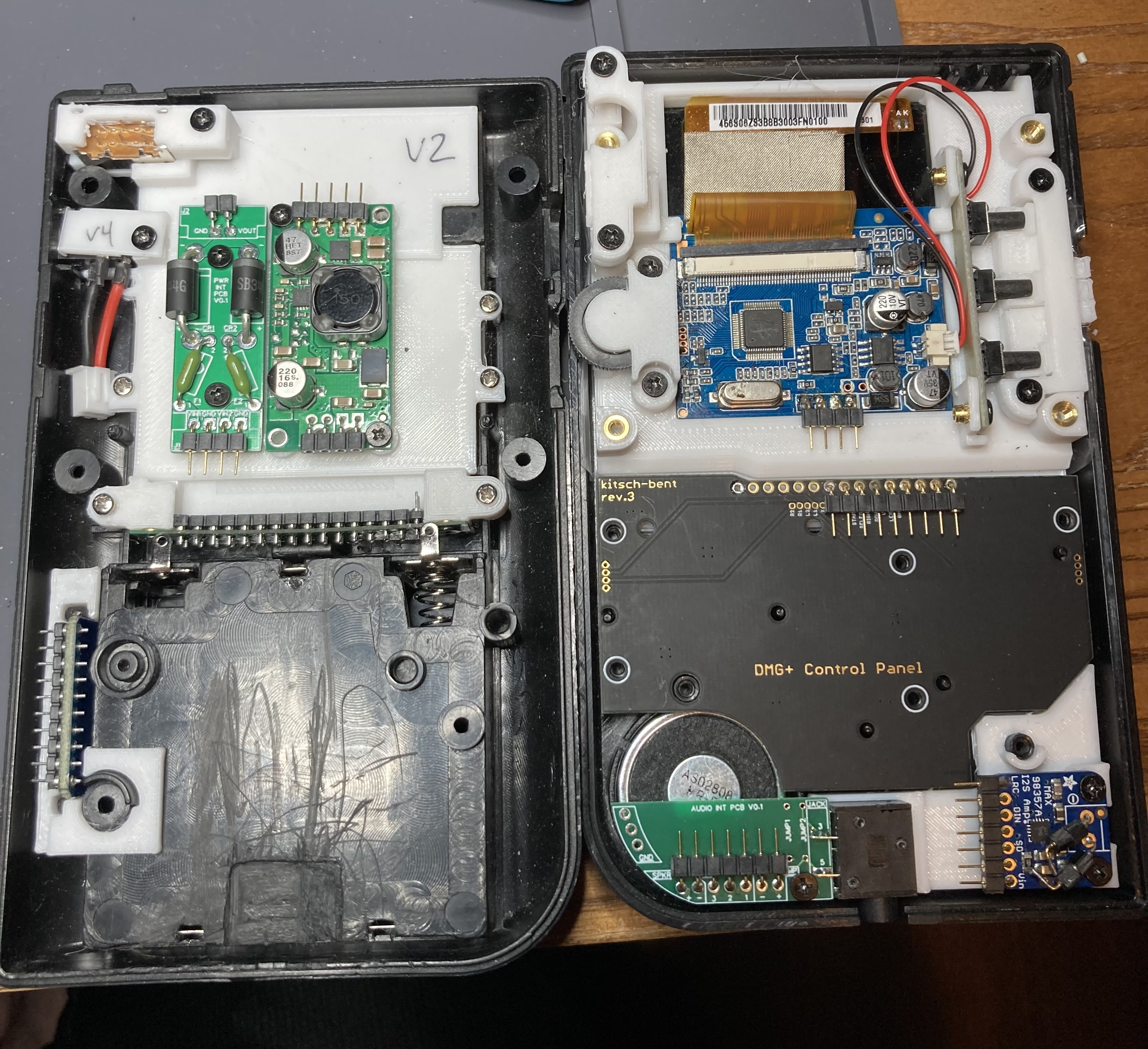

GBZ
GBZ - Internal; This picture is outdated, but it shows most of the parts listed. The next pictures is a lot closer to the latest build.
GBZ - Internal; The wiring is messy and there are some parts missing, but this is what I am currently working on updating.

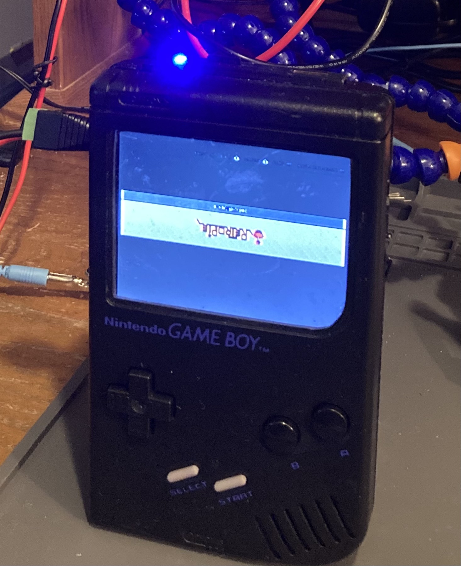

GBZ - Powered ON; Prior to any Retropie Configuration
Power
Input Voltage: 4-28VDC / 4x AA battery
Power Jack: PJ-031D
Power Switch: SK-22H03
Switch Mode Power Supply: S18V20x
Power Interface Board: Custom
ADC Battery Voltage Monitoring: ADS1115
Aux USB Port
Video
Composite Display: BW 3.5” TFT LCD [I do have a screen protector, but I still have not attached it]
Brightness/Contrast Setting Buttons (from display)
Mini HDMI Out via Cartridge
Audio
I2S Amp: MAX98357
Audio Interface PCB: Custom
10K Ohm Volume Wheel
Headphone Jack: PJ-325
Speaker: AS02808MR-R
Gamepad
Kitsch Bent DMG Button PCB (planning on designing my own for additional functionality in near future)
Cartridge IO
IO Interface PCB: Custom
27 Pin SAS Receptacle
Cartridge
Pi_0 Interface PCB: Custom
27 Pin SAS Plug
HDMI Interface PCBs: Custom
Blue Power ON LED
Retropie Config Info

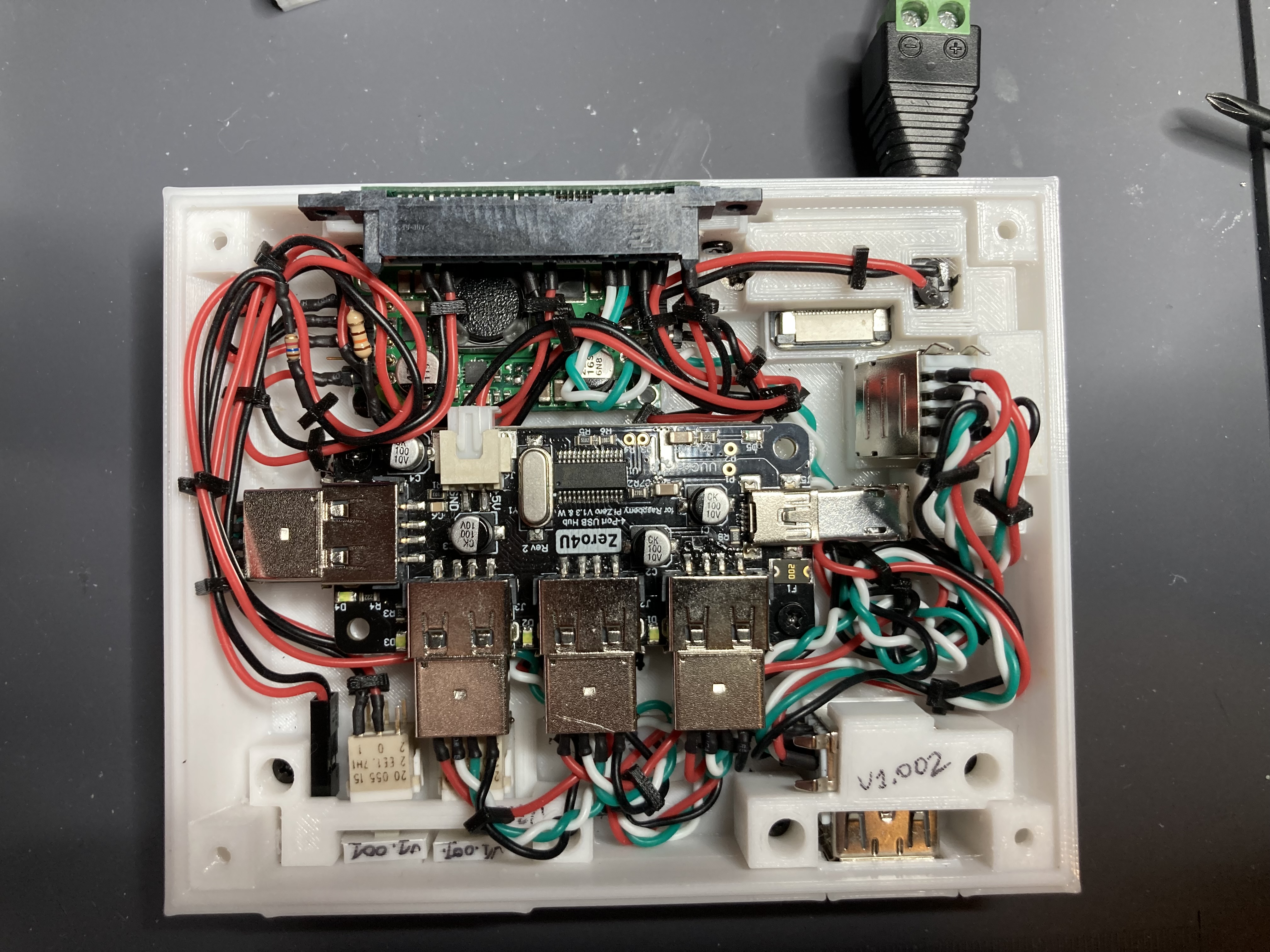

Micro NES
Micro NES - Internal
Micro NES - Back
Micro NES - Powered ON
Micro NES - Powered ON; Prior to any Retropie Configuration

Video/Audio
Mini HDMI Out
15cm HDMI Flex Cable
(admittedly, this connection tends to be unreliable and I need to improve it - luckily the HDMI out of the cartridge works fine)
Gamepad and Aux Ports
4-Port USB Hub: Zero4u
Dual USB Port x2
Cartridge IO
IO Interface PCB: Same as GBZ
