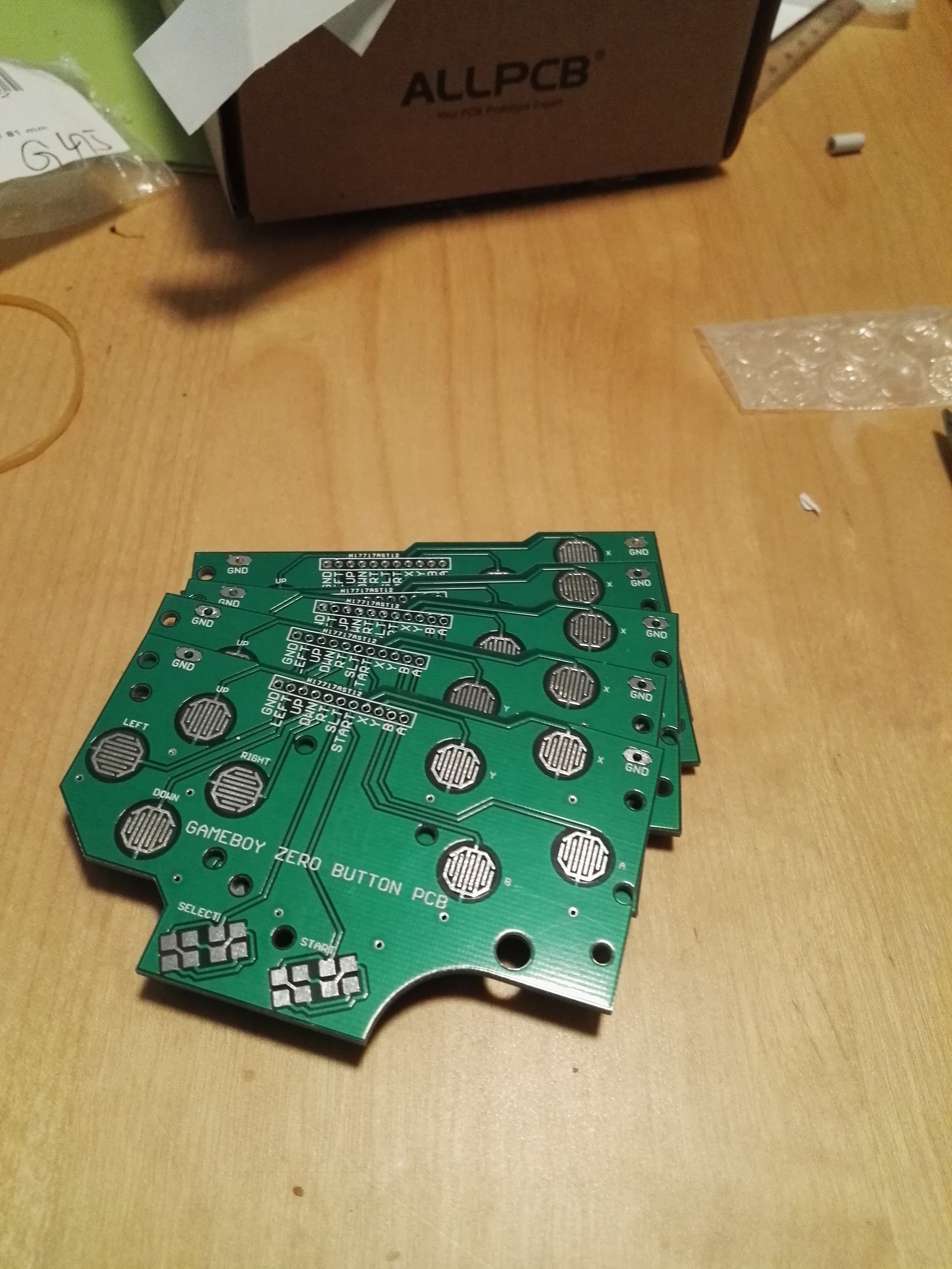

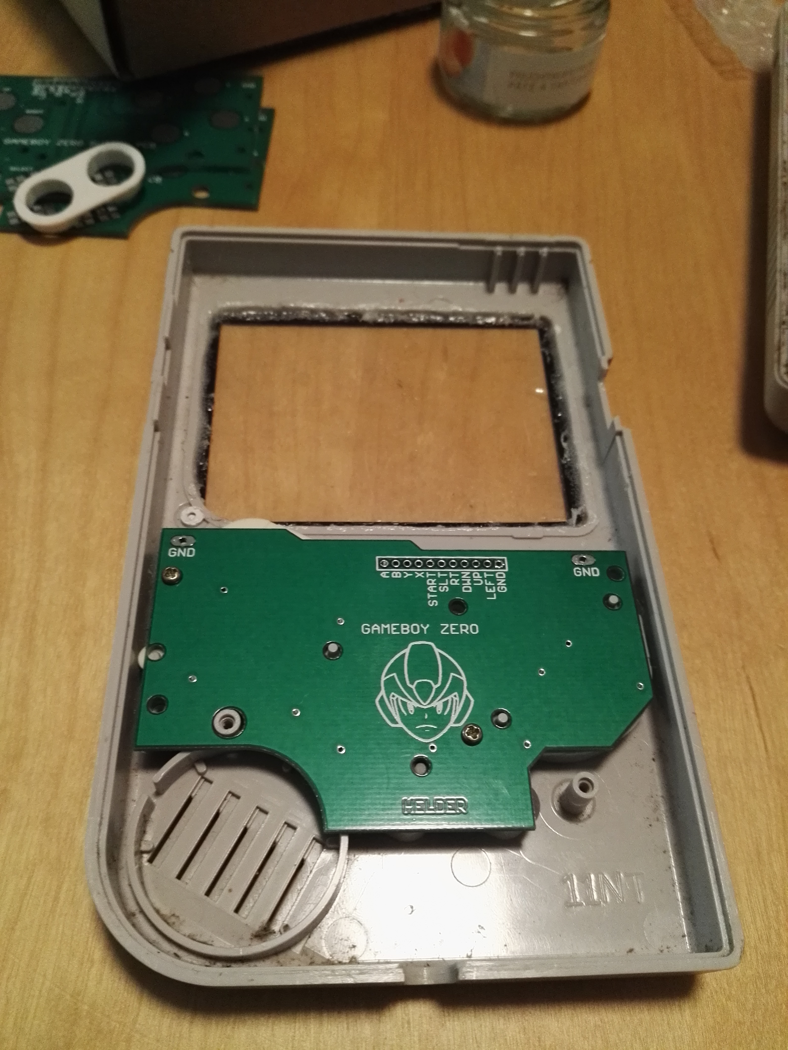

Time for another update(5):
The button PCB's designed by Helder arrived yesterday. Thus I was able to test the printed button holders.
[spoiler="Everythings fits perfectly"]
Button PCB from Helder
backview
frontview
Display, buttonholders and button PCB
[/spoiler]
As I am sure that they work perfectly I am now selling them, if you're interested PM me

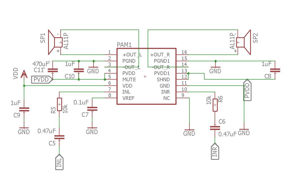

As an audio amplifier is necessary, I implemented a PAM8403 Chip on the designed PWM board. I know that Helder already designed all of it, but I want to learn to do it myself.
[spoiler="PAM8403"]
My schematics for the PAM8403 Amp
https://www.openimpulse.com/blog/wp-con ... iagram.pdf[/spoiler]

Audioupdate:
I have seen that all of you solve their audio problem with the PWM-board and an amplifier based on the PAM8403. Something about that chip bugged me and I spend the weekend researching what it is.
After 40 pages of Helders PCB selling thread and a lot of information I got from him personally (via mail), I found out what it is. The PAM8403 is a powerful Audioamp in a small package. Ideal for the Zero-Pi you say? NOPE ;) The PAM8403 is an audio amplifier designed for speakers, not for headphones or speaker (singular). The difference you ask? Quite simple. The PAM8403 has no common GND and is therefore unusable for headphones. Okay unusable is a strong word, what I mean is it works as long as its mono and you only use one channel not both.
I found some alternatives:
[spoiler="Adafruit Mono 2.5W Class D Audio Amplifier"]This is also just mono. Works, but not what I want. I want stereo![/spoiler]
[spoiler="TDA1308"]Normal OP-AMP[/spoiler]
[spoiler="LM386"]Normal OP-AMP[/spoiler]
[spoiler="LM4880"]Exactly what I was looking for. Simple stereo analog input and stereo output with a common ground. I will use this one. Even has the schematics for a separate speaker channel that gets cut when headphones are inserted.[/spoiler]
Seems like I will just buy a normal OP-AMP and not a whole solution like the PAM8403. I will create a board with the PWM-Analog sound and the amplifier on it. Would someone be interested in getting one, else I will directly implement it in my project and not bother making a separate board.
Re: Pipo's ZeroBoy Project
Post by Helder » Sun Jul 17, 2016 2:59 pm
LM4880 has a switching circuit in the datasheet but you need a separate amp for the speakers, so if you have the PAM8403 already you can just tie the 2 together in a similar fashion.
