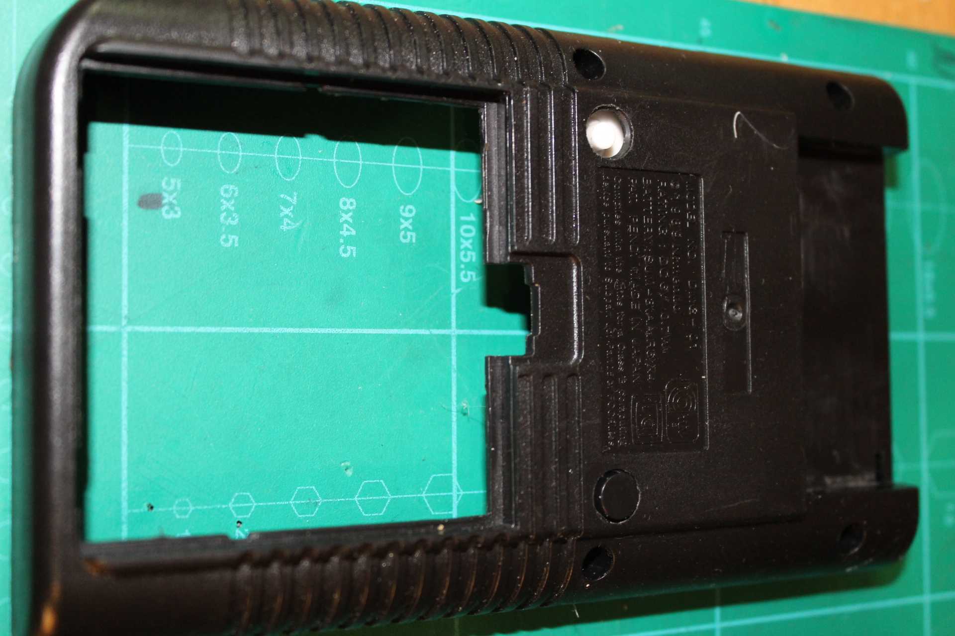

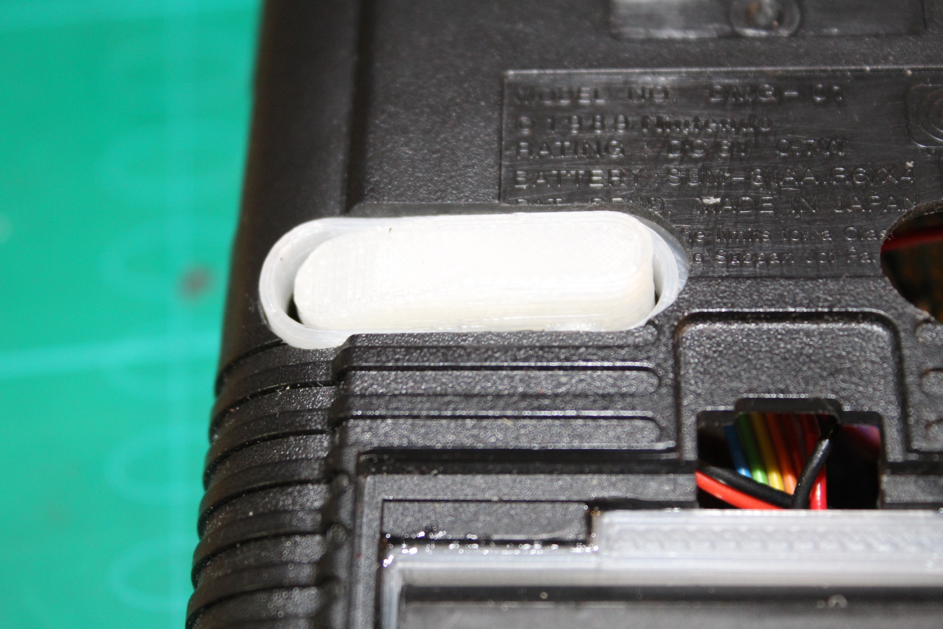

Evilz wrote:Nice !! :shock: :o :shock:
How did you make the hole for the L and R buttons ?
Did you cut the cartridge ?
I used a snes controller L & R buttons as templates and then used a dremel to rough cut the shape, then a small sanding drum to shape.

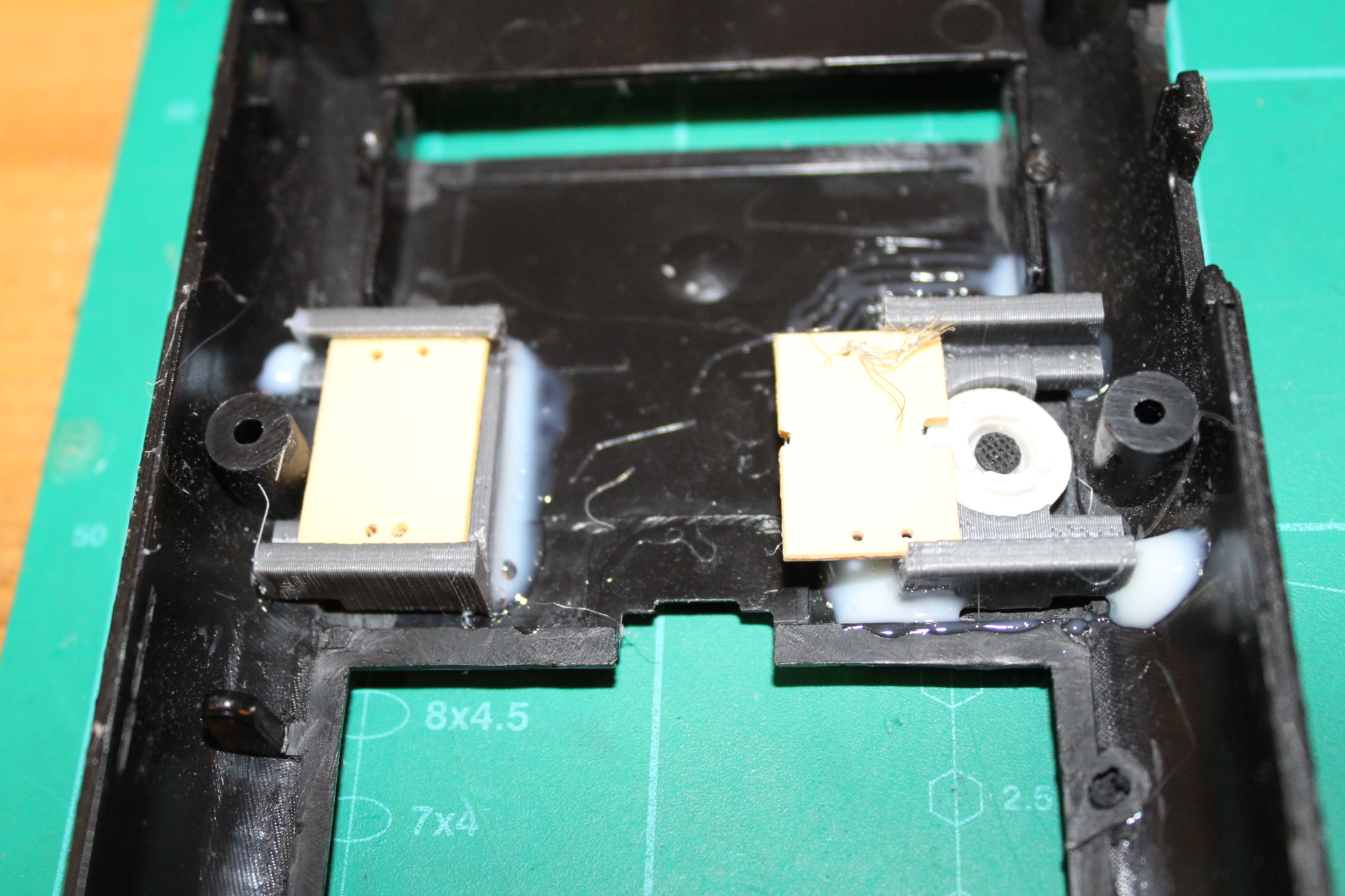

UrbanDROID wrote:Can you post some pictures of the SNES controller buttons mocked up in the shell? I am curious as to how well they fit. was thinking of going this route.
Gone with buttons on another gbzero but here are some pics of of that and the shoulder buttons i was working on.
Will come back to that design later as it was proving to be a bit of a pain. :(

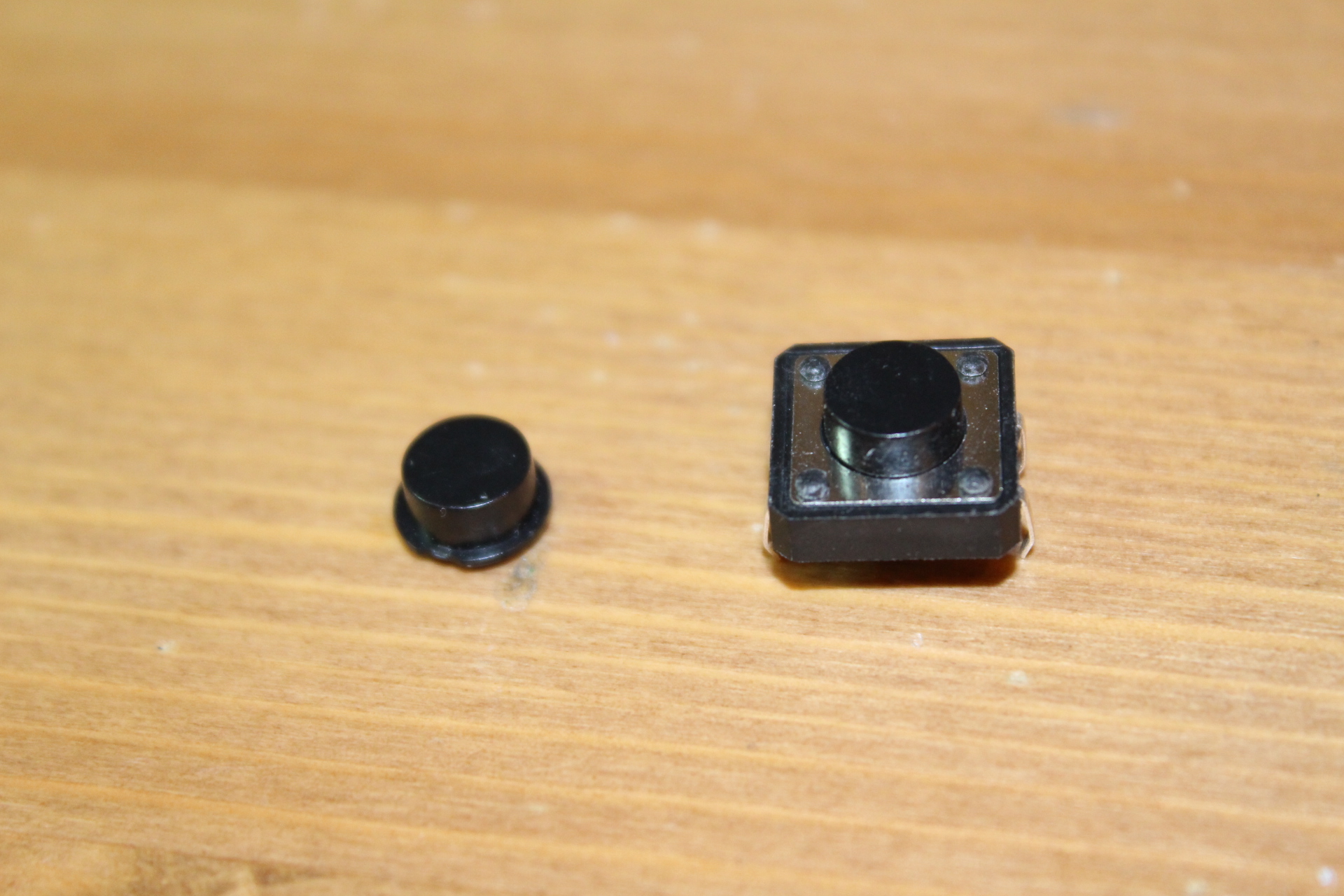

Ninjameep wrote:When i 3D Print the Screen holder And Button Wells you have, ill post in it my build log/post and mention you there o3o thank you very much though for putting them out there~, i also cant wait to see you finish this, what kind of buttons are you using for the L&R , are they tactile switches?
Was going to use these but they are really clicky
so i took it apart and used the button in conjunction with the pcb from my snes controller and put it together like this
from the back they work quite well and feel nice just the right size.
