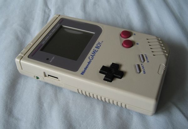

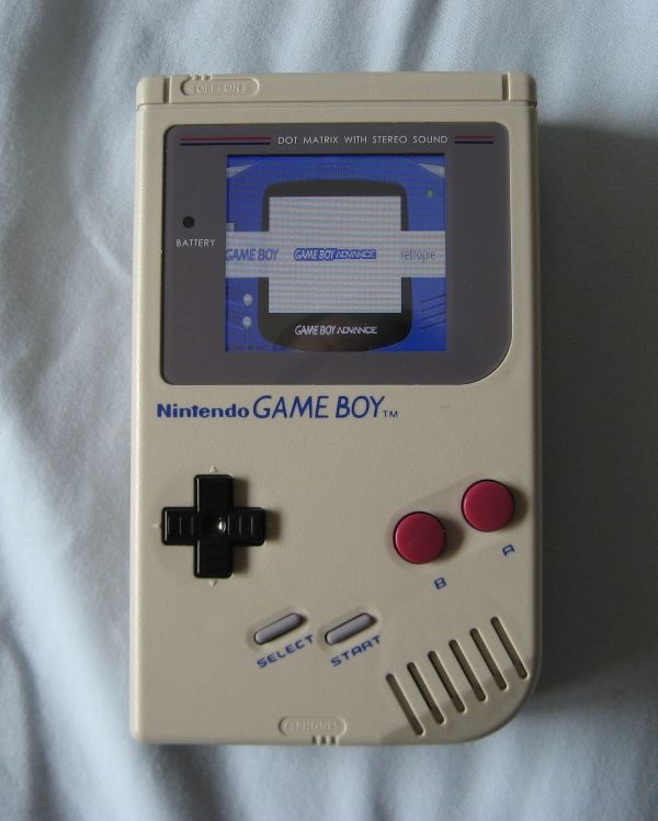

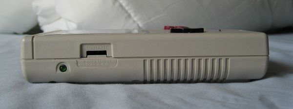

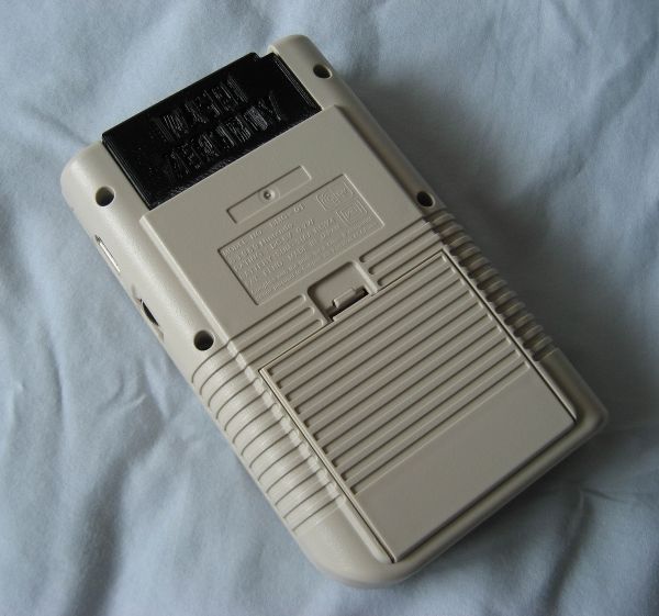

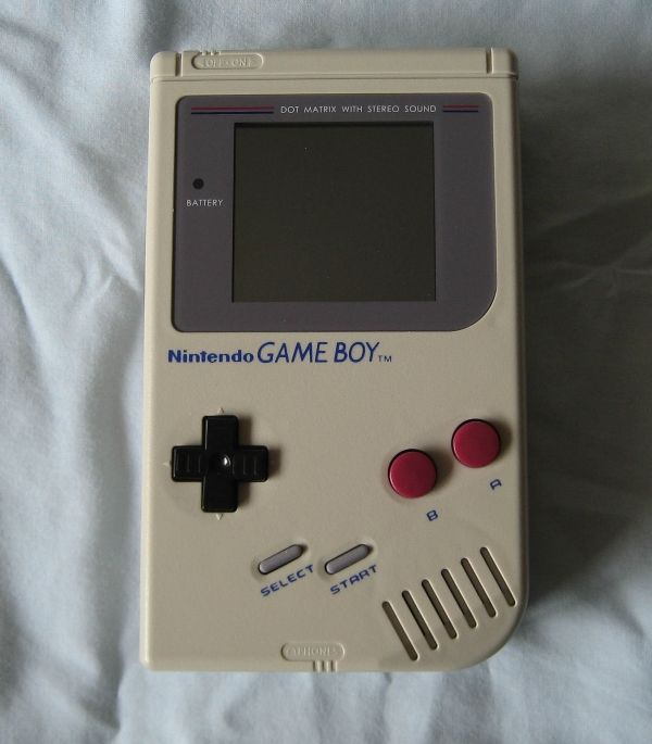

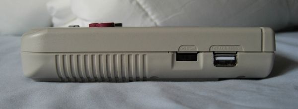

The battery life isn't great with the AA's (just over an hour). I might add more things to this one later but I'm building another at the moment with a larger screen. Managed to keep it as stock looking as possible which was the goal so I'm happy with how it's turned out. Anyway, here are some 'finished' photos (lcd looks odd in photos only, not in reality):

You should publish a guide. I would LOVE to have a close to "stock" (aka, not torn up on the outside) as possible.

The only differences to other people's builds really is that I used overscan to get it to display well in the original gameboy screen space. A composite screen would be better than the spi screen i used though. And I also slightly shaped the 'ext connector' port area so the usb port sat flush, which meant dremelling out a small area of the cartridge slot, as you'll see with most other buillds the port normally sticks out a bit as they're too long for that area without cutting the case slightly. I think that's about it. I'll take a few more photos of the inside when I open it up again if I remember.

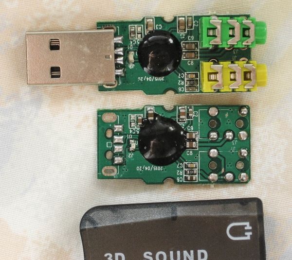

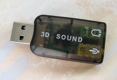

Here's the sound card I used, not seen others use this one so posting a few photos:
I removed the ports to make it just a very thin board. Before and after autopsy:
