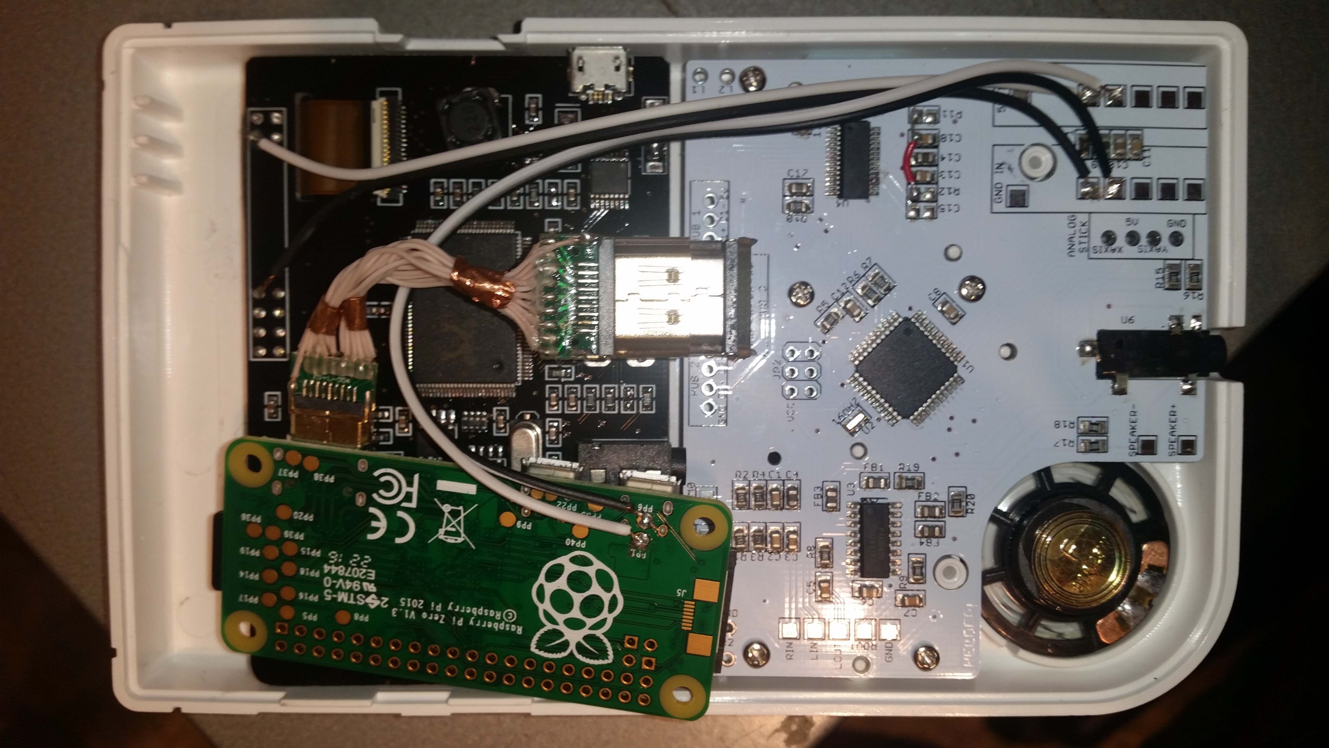

BuToNz wrote:I'm working with the same screen, no AIO though.
Can you give some tips on the HDMI to Mini HDMI connector you have? Is that manually soldered? How did you strip?
I bought a bendy swivel adapter thing off Amazon, then just broke off all the plastic.
https://www.amazon.com/gp/product/B01LZ ... UTF8&psc=1

I have quickly learned my soldering skills leave much to be desired. But, I bought my iron specifically for this project. Don't exactly have experience in the matter.
Either way, I have the screen and Pi power attached to the AIO. Jumped from the powerboost over to the AIO and had a successful test. Both the screen and Pi powered up. Have to be very careful when routing wires or the case will not close. Wouldn't be an issue if I cut the battery compartment, but I am still trying to avoid doing that.

Thanks! Looks really clean. How do you plan on keeping the case shut as the screen covers all 4 top mounting posts?

BuToNz wrote:Thanks! Looks really clean. How do you plan on keeping the case shut as the screen covers all 4 top mounting posts?
I have no clue yet. May design and machine a new mount to attach to the case. No 3D printer, but I have access to a couple CNC milling machines.
I have the 3D printed "kit" that is sold here, but not sure if it will work for my application.

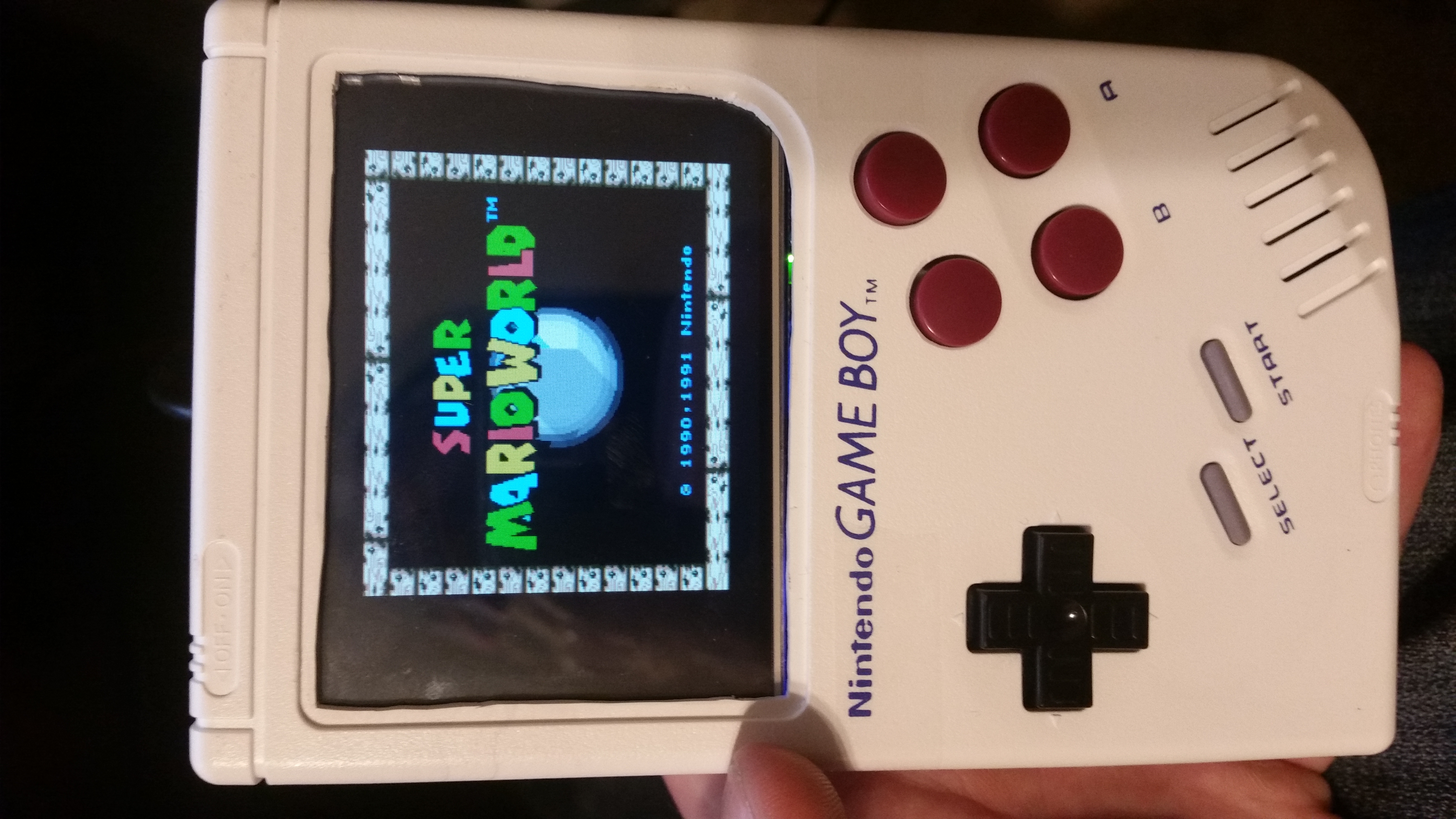

Had to go into the config text file and flip the screen, but it works. And everything fits. Have a few things to work out, but nothing major. Time to start gluing everything into place.

I bought the same screen. And you resolve a problem but.... how !?? :)
I have Raspberry pi3, the place is short for me.
You have a HDMI head in your screen but the wires out from the back.... I can not understand :shock:
Can you explain ?
