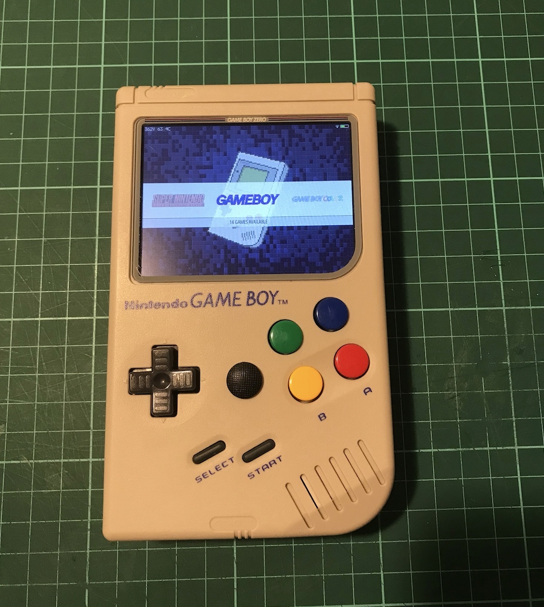

Started with a bigger update this week. Kite´s 640x480 Display, 2 additional shoulder buttons and Samsung S2 4800mAh Battery installed. Also removed the Aluminum Heatsink and installed a Copper one with Noctua heatsink compound. From first tests I get around 5°C less during Idle.
Re: GBZ Kite Aio PI3 Build
Post by YaYa » Sun Oct 22, 2017 10:45 am
Beautiful !
Show us the battery tray :)
