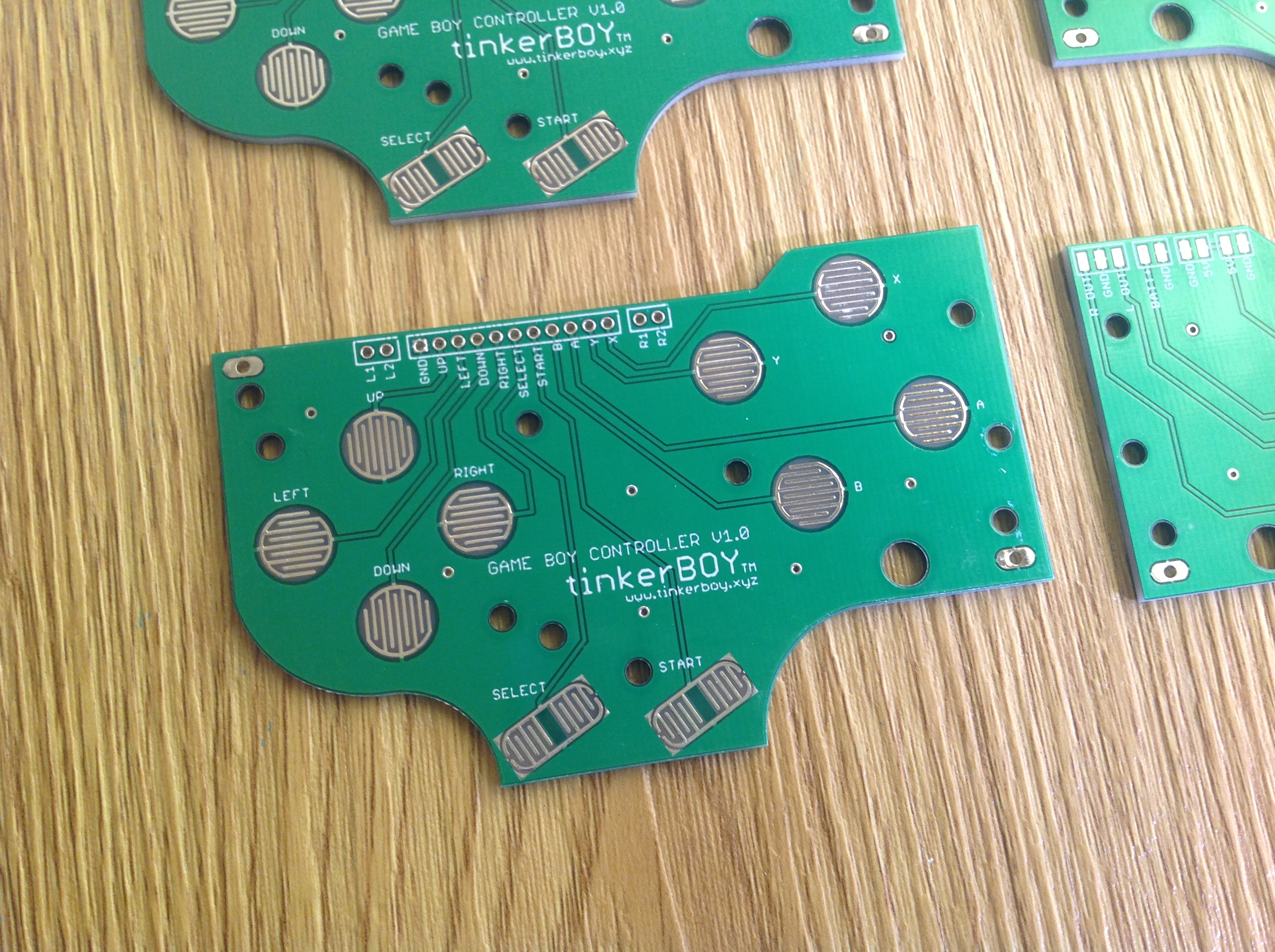

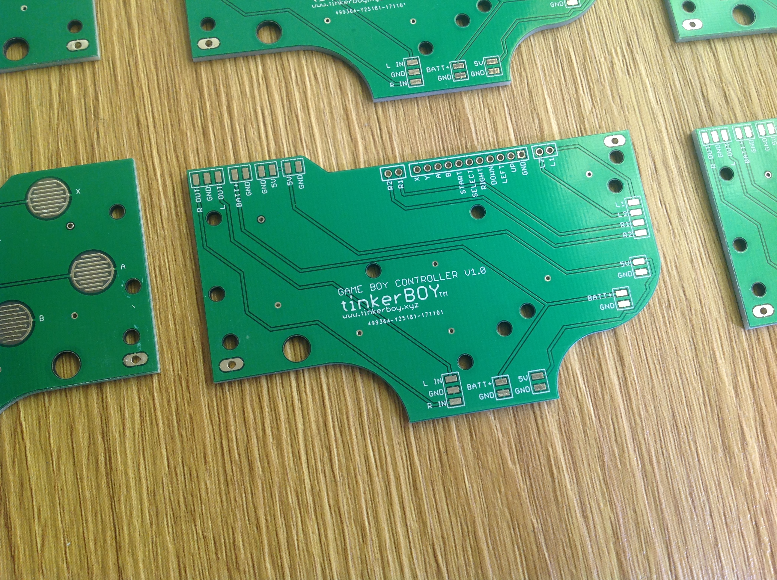

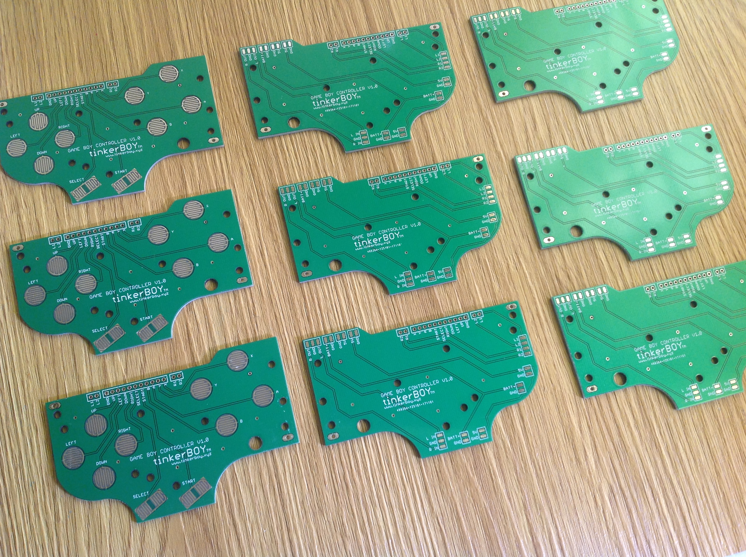

Got my first pcb i made for the controller. Looks greatt!
Hex
Posts: 113
Been thanked: 47 times
Re: [tinkerBOY] Game Boy Three - RPi3 and DPI screen in 24-bit mode [WIP]
Post by Hex » Thu Nov 09, 2017 5:47 pm
Where did you get these from?
tinkerBOY
Posts: 710
Has thanked: 294 times
Been thanked: 206 times
Post by tinkerBOY » Thu Nov 09, 2017 5:53 pm
Just something i made from learning Eagle. :)
Hex
Posts: 113
Post by Hex » Thu Nov 09, 2017 5:58 pm
I mean where did you get the PCBs from. (pcb manufacturer ?)
