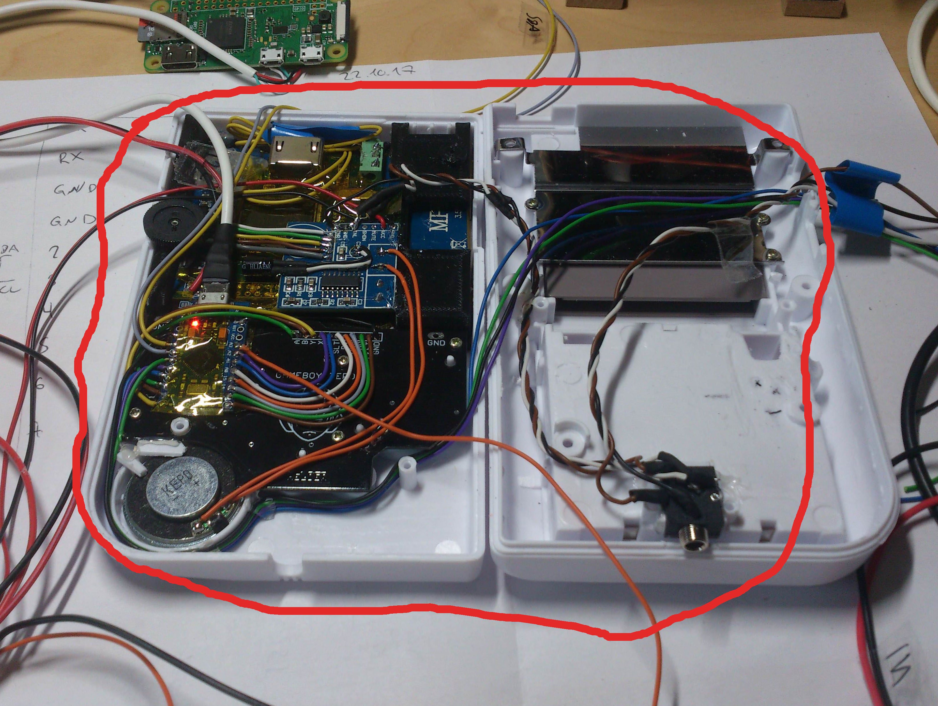

Codemaster123 wrote:
Wed Nov 15, 2017 11:03 pm
how is project, you how connect screen
please share audio setup diagram
I uploaded an image for you: Image.
The important part is not to use the ampifier for the headphones, and you dont need that, because the display can drive headphones.
The amplifier is only needed for the loudspeaker. And because the loudspeaker needs mono, i mixed the stereo signal with the 10k resistors.

@YaYa and @Codemaster123: I thought about using the schematic from VeteranGamer, but as i mentioned earlier:
you are only using the left channel (L+ / L-) on the output side.
So if you are emulating games with stereo sound, you will only get the sound of the LEFT stereo side of both sides of your headphone (your signal path is: stereo -> only left side -> dual mono left side).
You have no static on your build, because you dont have the outputs of the PAM8403 connected.
The solution of VeteranGamer can be of use, if you only want mono sound.
If you want stereo sound (e.g. SNES), you should think about an other solution (i use the schematic i posted).

In reality you don't get stereo sound but a mixed L + R channel over monaural output. But i agree that, in that way, you are not loosing half way one channel. :geek:

In the picture from Salami738 that you have colored, i am sorry but i do not see with precision from where to where are going cables so forgive me if i ask. A perspective picture is not a schematic. You may have the eye of the tiger, i do not. That said, cheers
