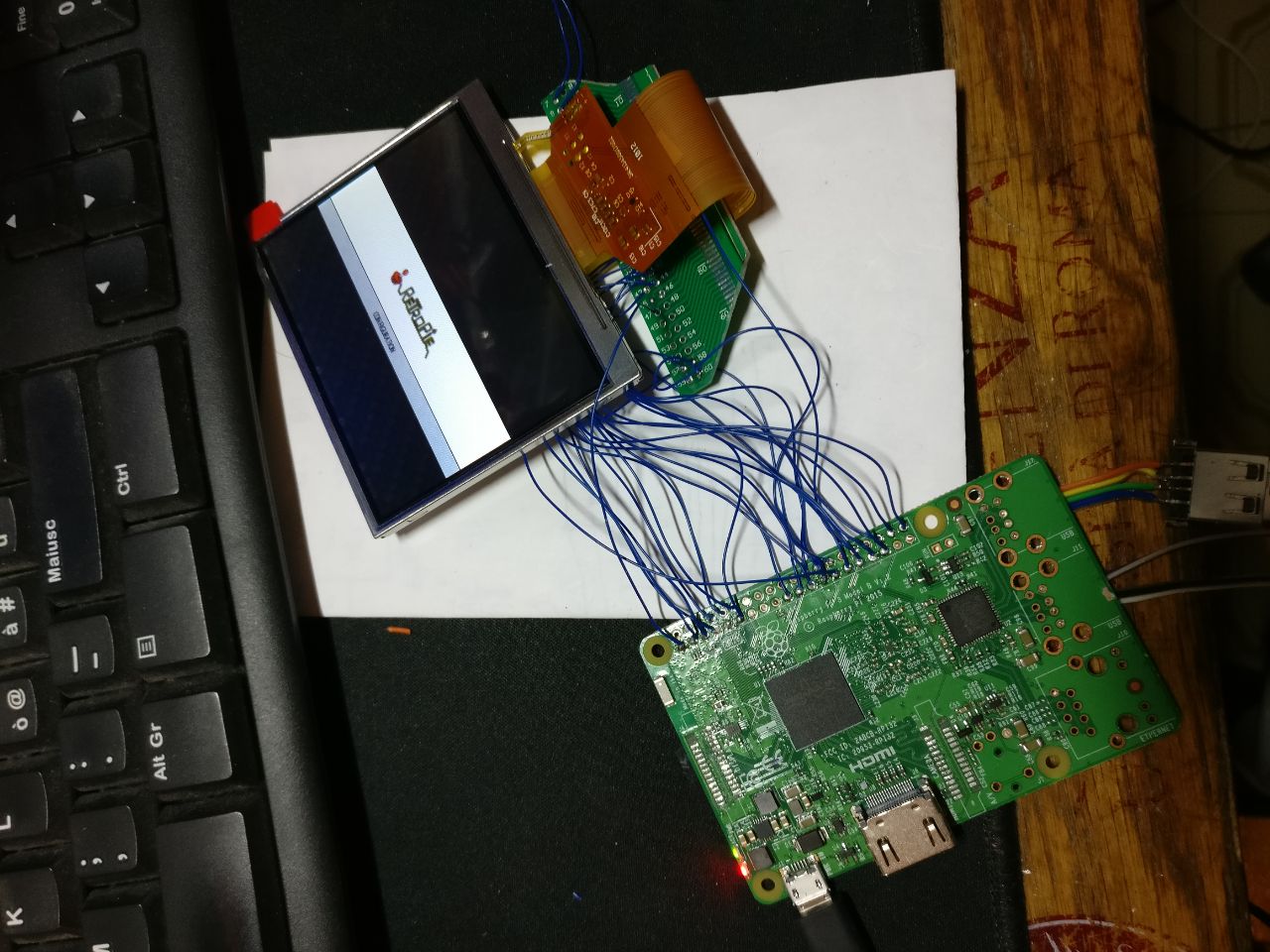

I received the LCD today, I'll keep you up to date

Post by razer.93 » Sun Dec 17, 2017 1:36 pm
It works!
2017-12-17 21.35.25.jpg (189.91 KiB) Viewed 10048 times

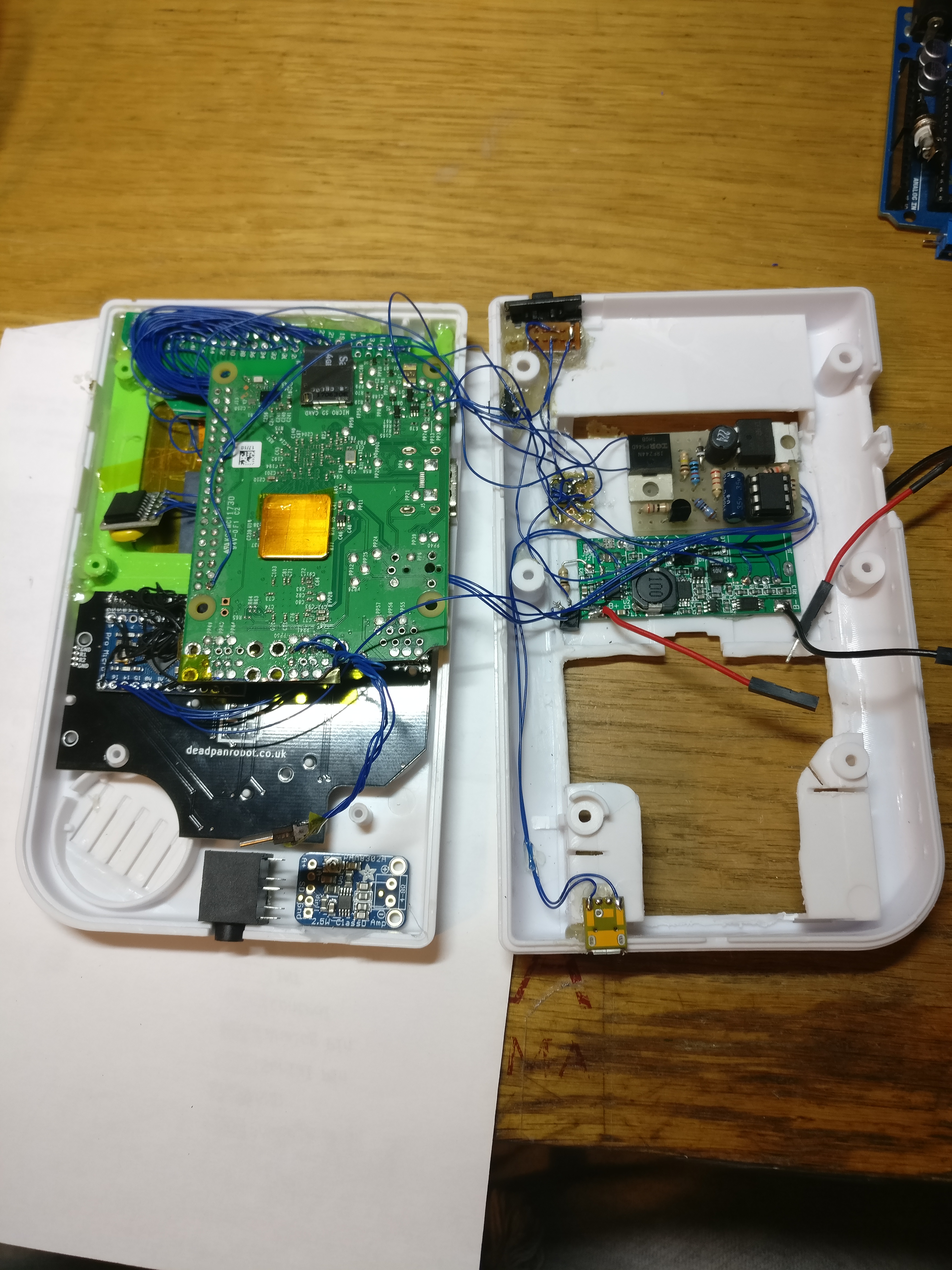

Post by razer.93 » Tue Dec 19, 2017 3:01 pm
Halfway assembly
