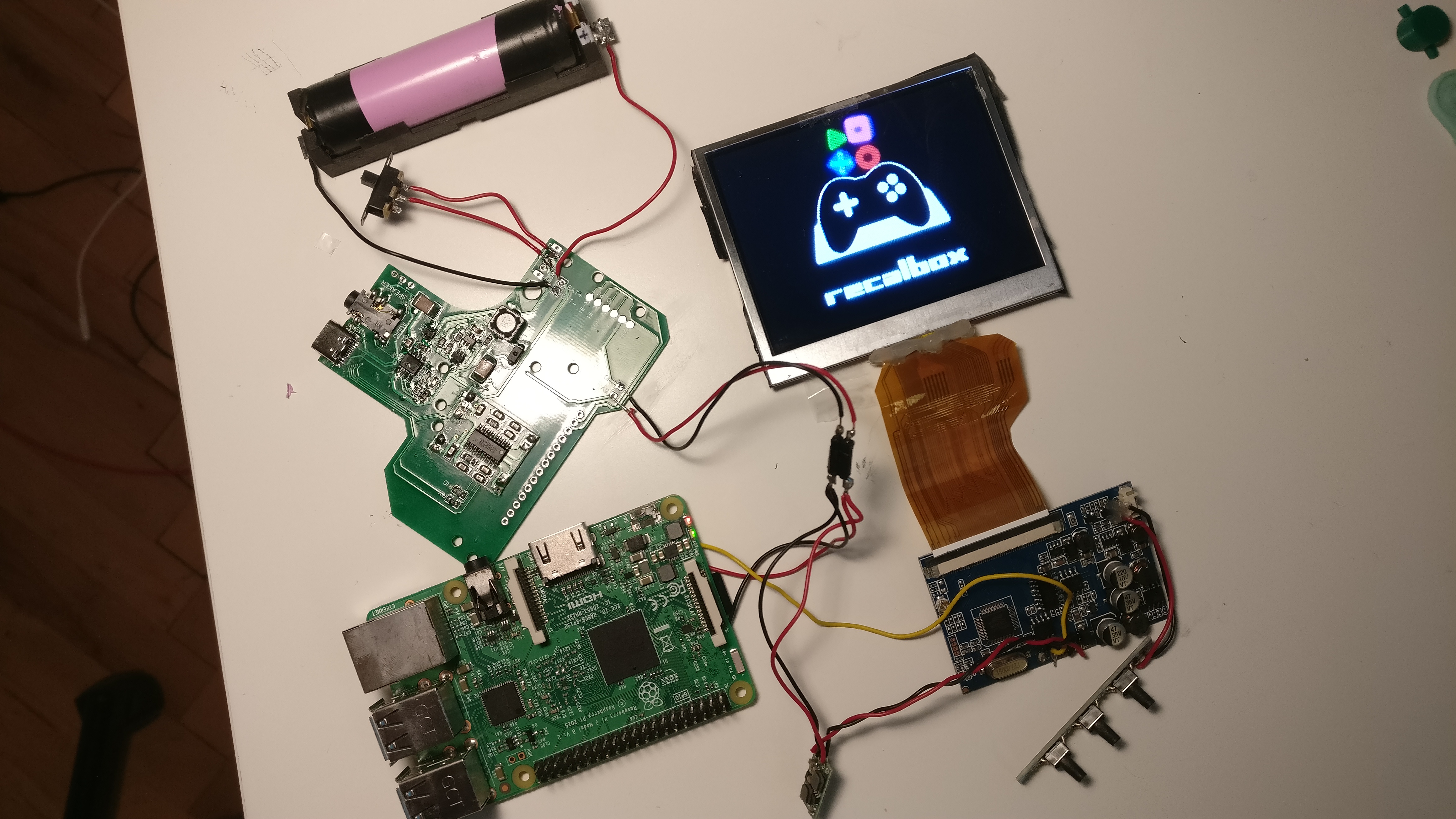

Yeah, that was a big drop. And because of that I didn't even try connecting a battery. That was just using a USB connection. The next time I give it a try, I'll start with a fresh board and components, and test with just the charging components to see if I can pinpoint a flaw in the design.

How much amperage is your boost circuit outputting? Reason I ask is you want atleast a 2A output to power a pi3 and anything else in there, a Pi 3B + will not work properly or turn off at 2A so if you want to future proof it you will need more amperage. But a Pi 3 can run just about anything the pi3 B+ can and uses less power.
The maximal Current Output of the Board is 4A (which make it less efficient and you have to use Batteries that can provided that amount of current but theoretical you can draw 4A (Theoreticaly at 3,7V input of the Batteries and a Vout of about 5V it can provide stable 1,2 to 1,4A)). Currently I tested the total powerconsumption of the Pi, the screen and an XBox 360 controller connected to the Pi. I did a stress test and the setup draw about 900mA to 1.1A of current so I think its enough with this circuit. I also tested the setup with a board laying around with the same Boost IC and it worked fine so it shouldn´t be an issue. Im also planing to power the whole system on 6Vinsted of 5-5.2 just because I found out the raspberry pi3 dont have a undervoltage issue on 6V (Yellow lightningbold) And since I connected the power before the onboard Voltageboard and previous the fuse it should not be a problem because the internal powerdeliveryboard of the pi can handle up to 6V. and also the Screen I used with the "5V" mod only works probably with 6 Volt. Now im using a very very smal 12V Boost converter which work fine but add another part to the system which make it less efficient.

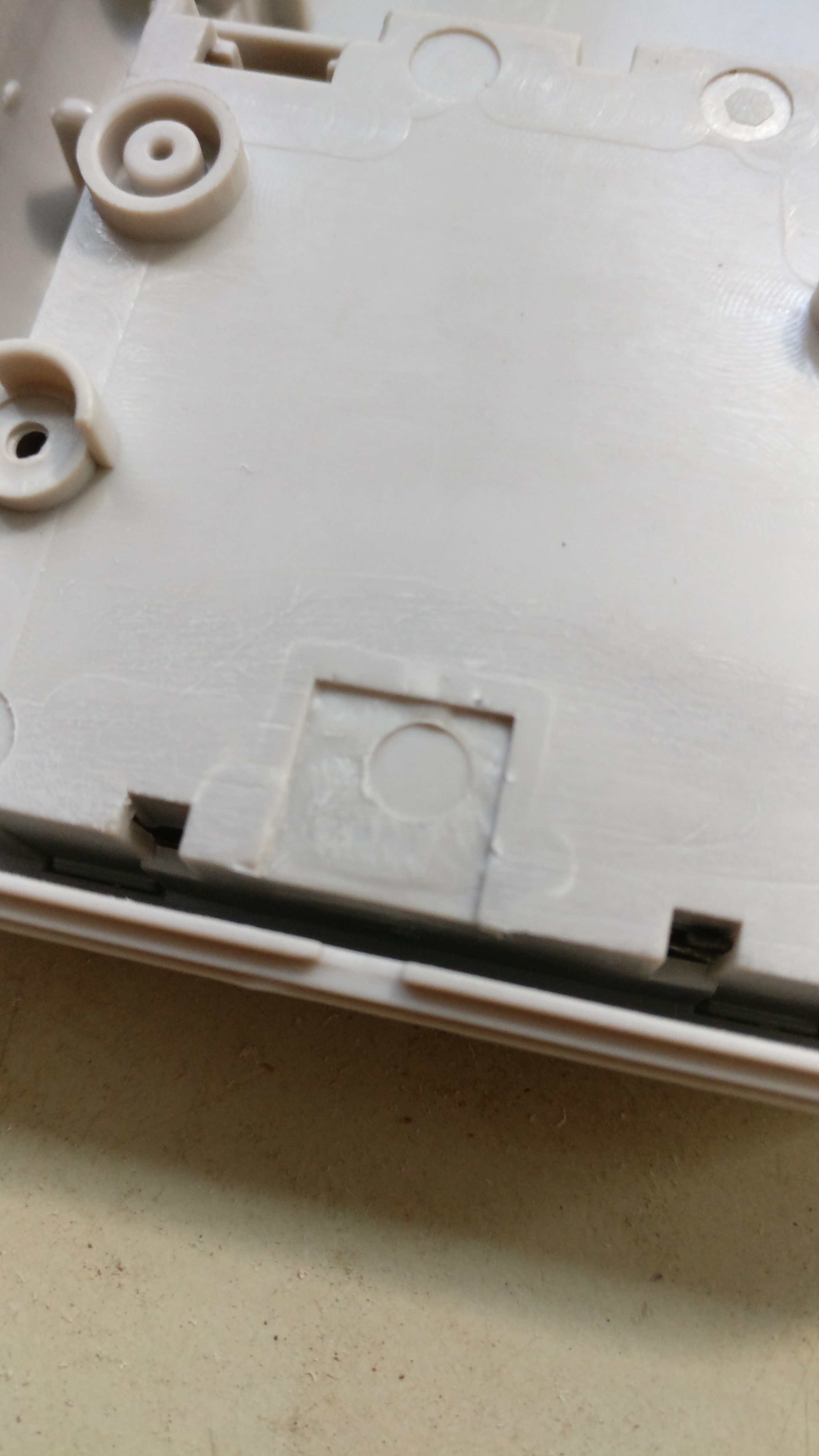

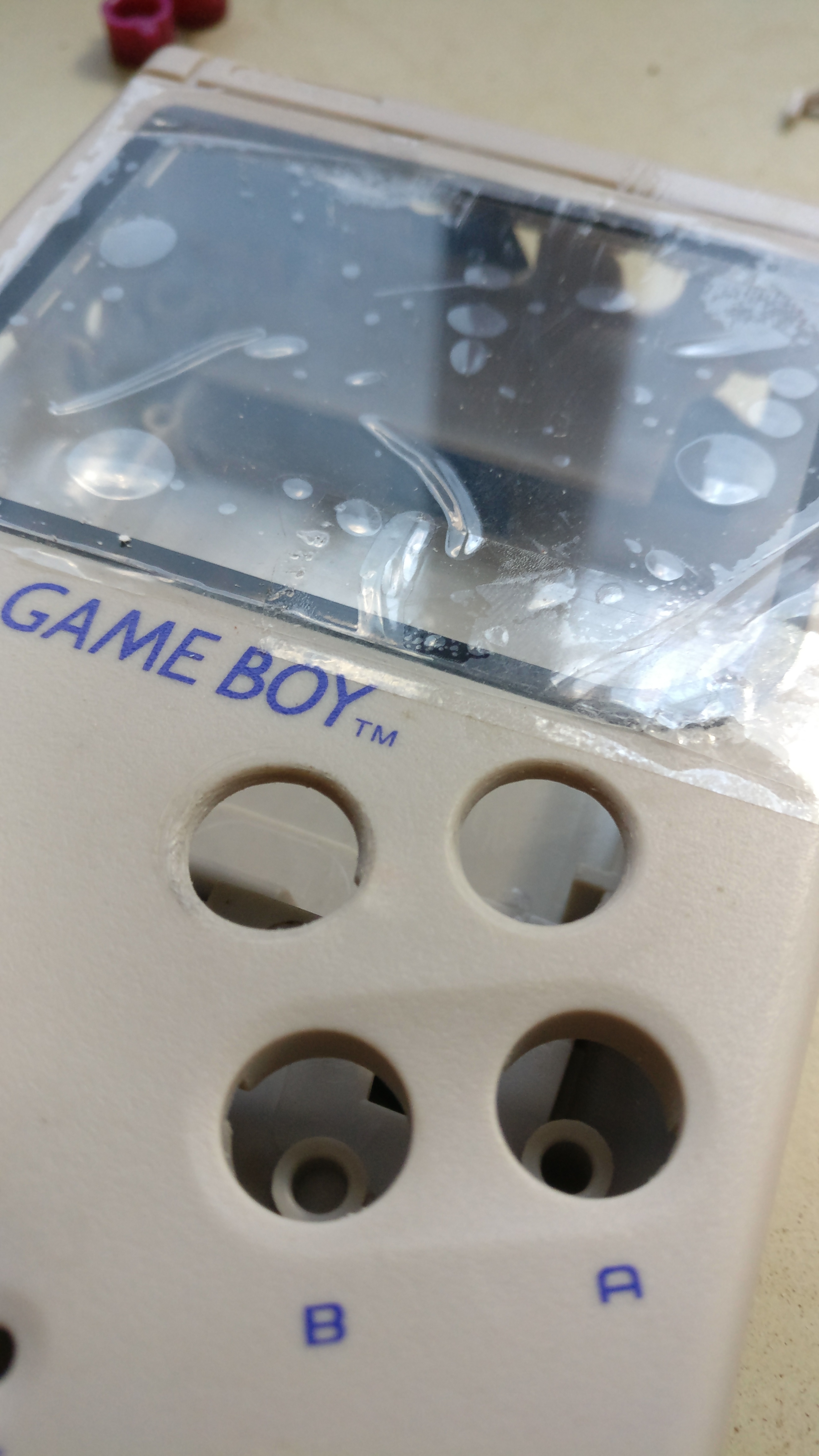

Hi, I just want to update you about my build. Today I finally modified the case to fit the X/Y Buttons and removed the Original Audiojack socket. I also added the screenprotector glass and it looks quit good with it. In the next few days the PCBs will arrive so I update you there when they are soldered and tested.
X and Y Button holes:
Removed Audiojack socket:

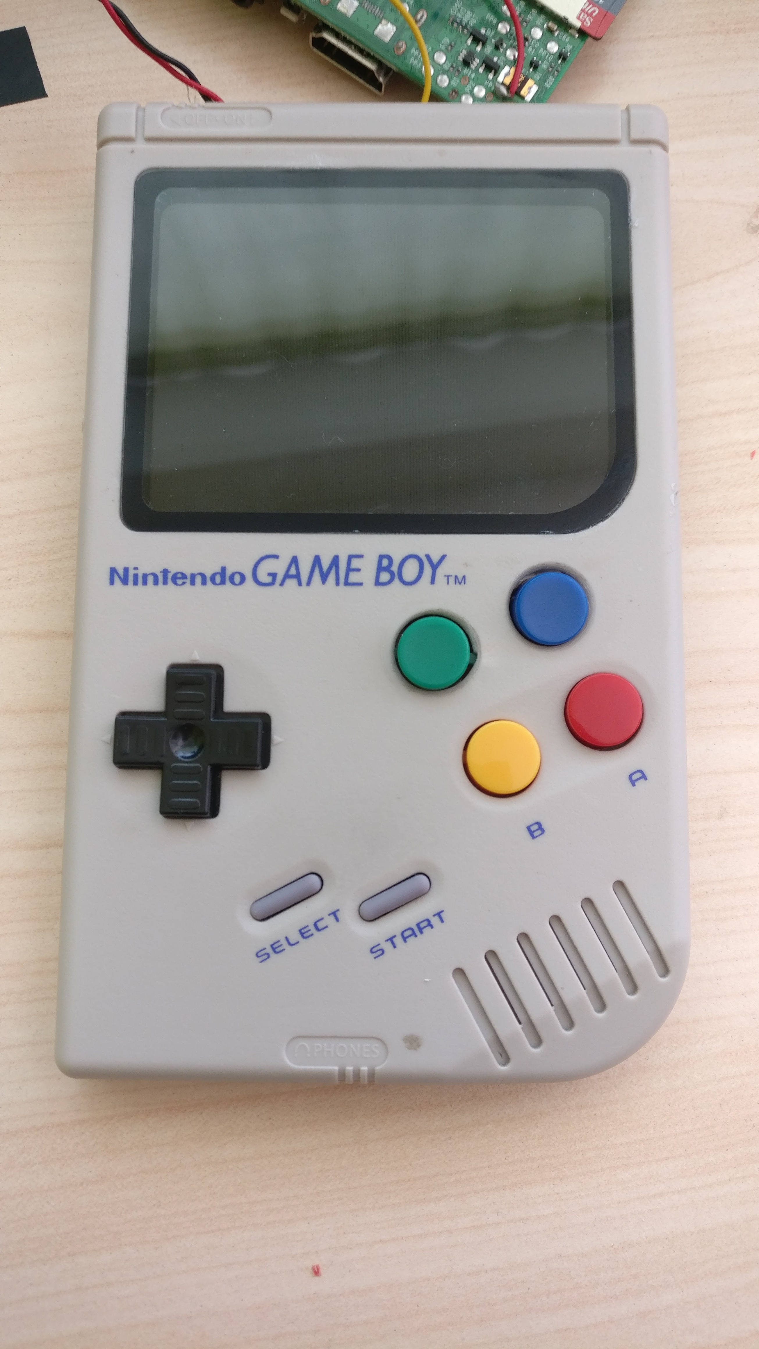

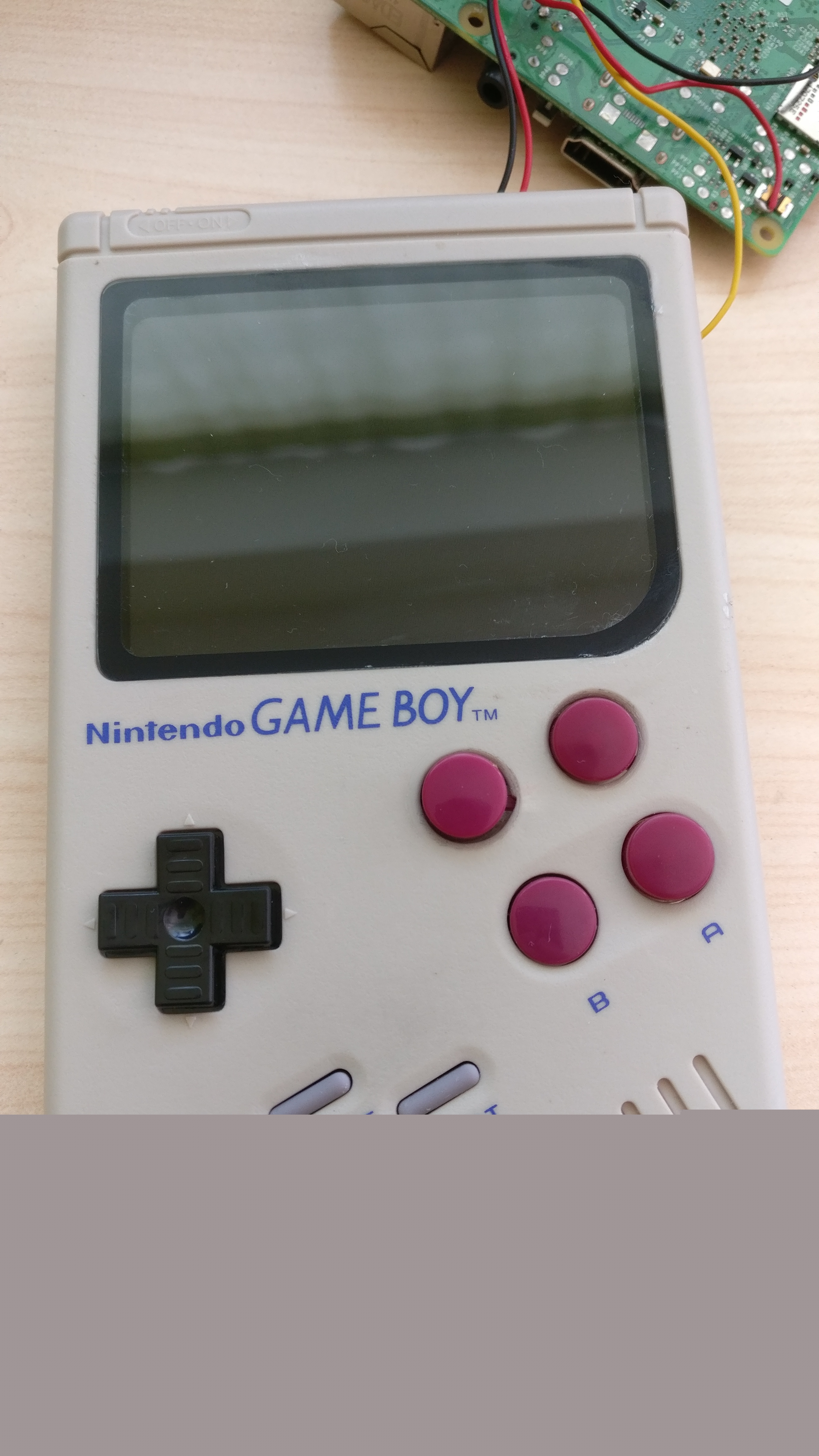

I also can´t decide which coloscheme I should go with the Buttons more like the "Original Gameboy" or a Super Famicom like scheme so I would appreciate which colorscheme looks better.
More Original:
More Super Famicom:

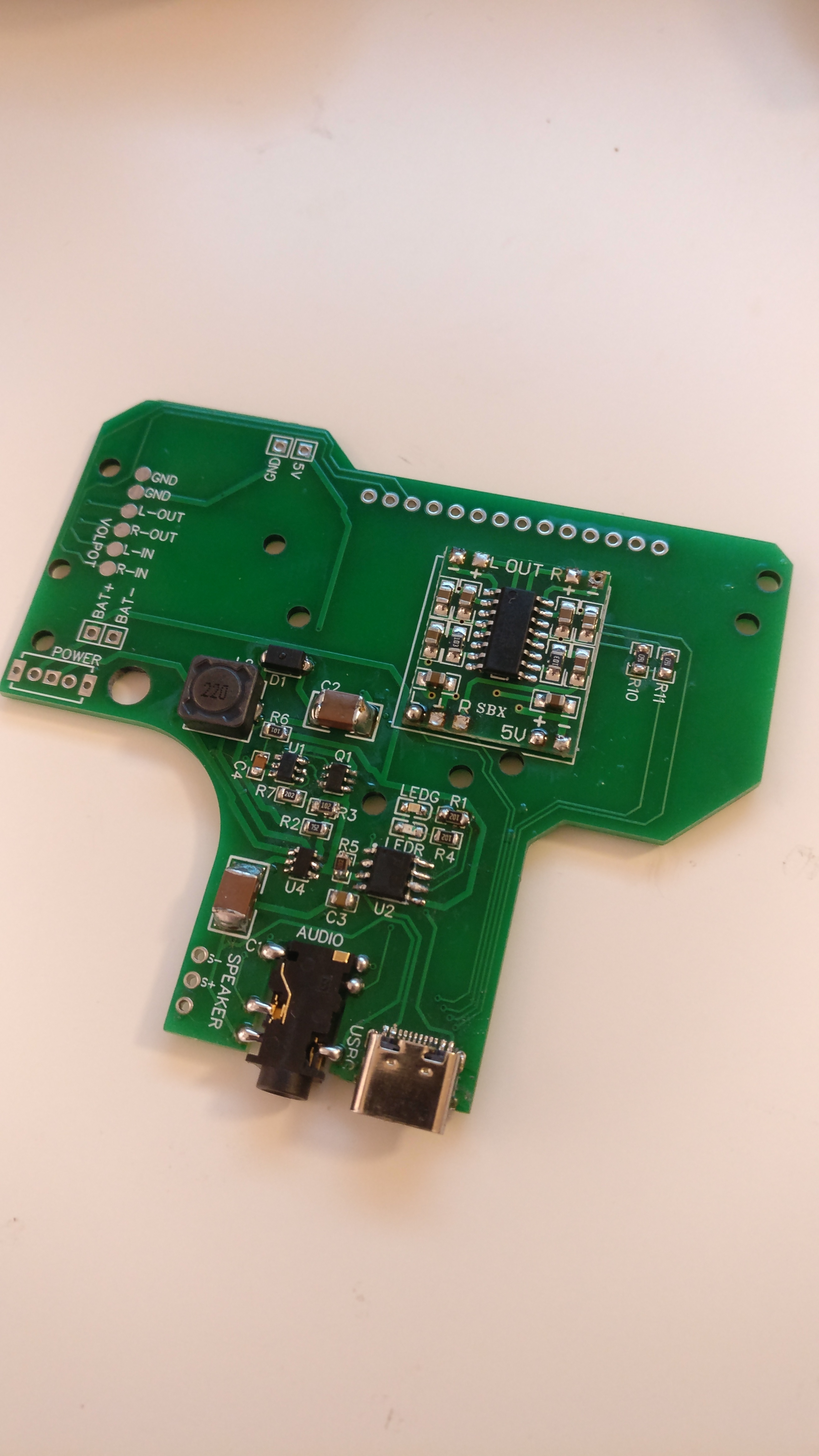

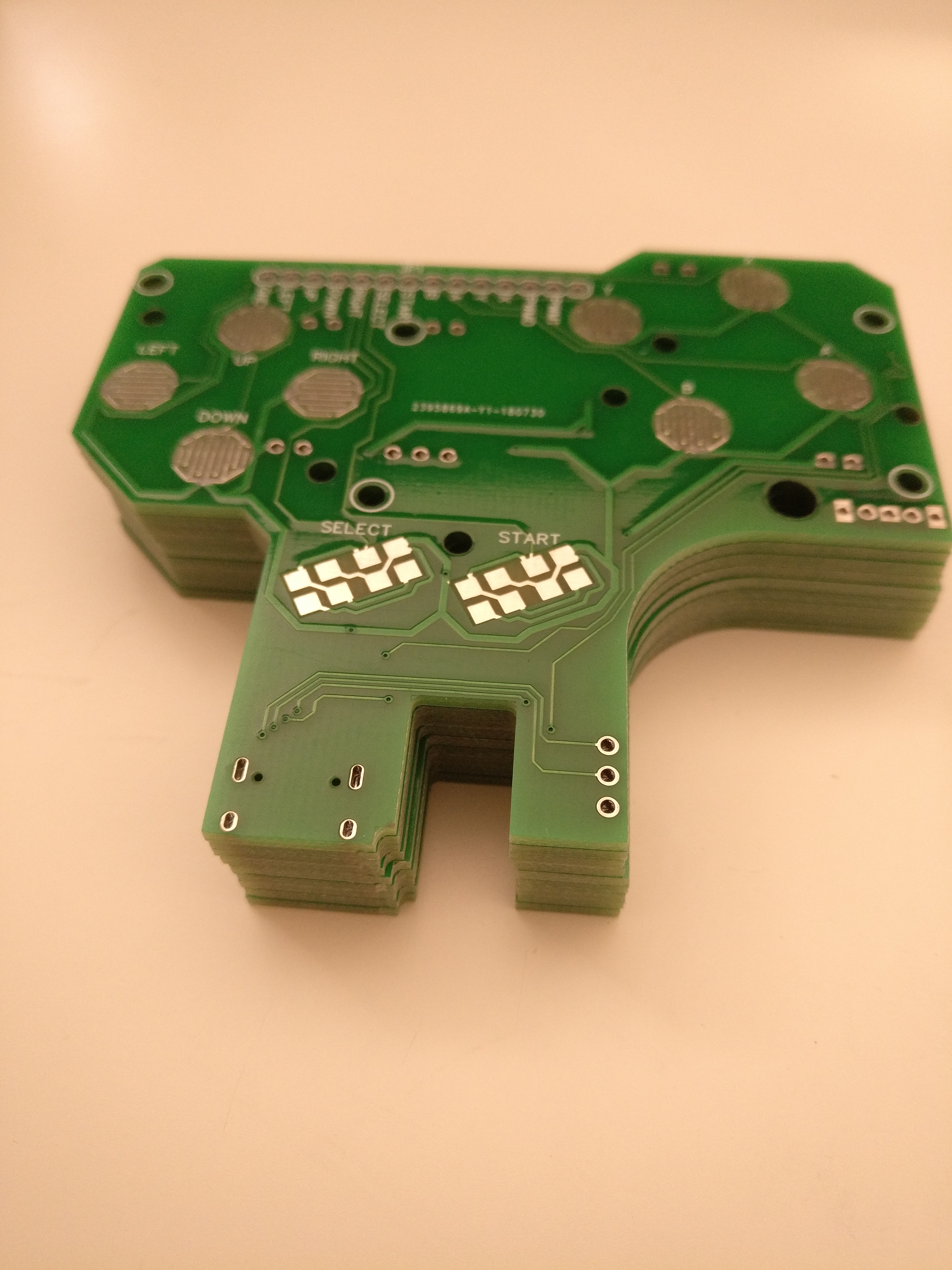

Finally the PCBs came in and I soldered all the components to one of them. They Board works really well and also the "yellow Lightningbold" isn´t there anymore. They fit in alle very well. Only the part where the usb-c charger sits is half an millimeter to long so I sanded it down and now it fits perfectly. Tomorrow I will then finally put all pices together.
Here is the front of the PCB:
Here is the back:
All components soldered on (sorry if the solderjob isnt that good but I only had a normal soldering iron (No fancy hot air solderstation :lol: ) and a few components are really small):
Everything is working (also charging and playing at the same time, the battery in the picture is just for testing):
Also the Batteries came in and they fit perfectly in the original Batterydepartment of the Gameboy.
