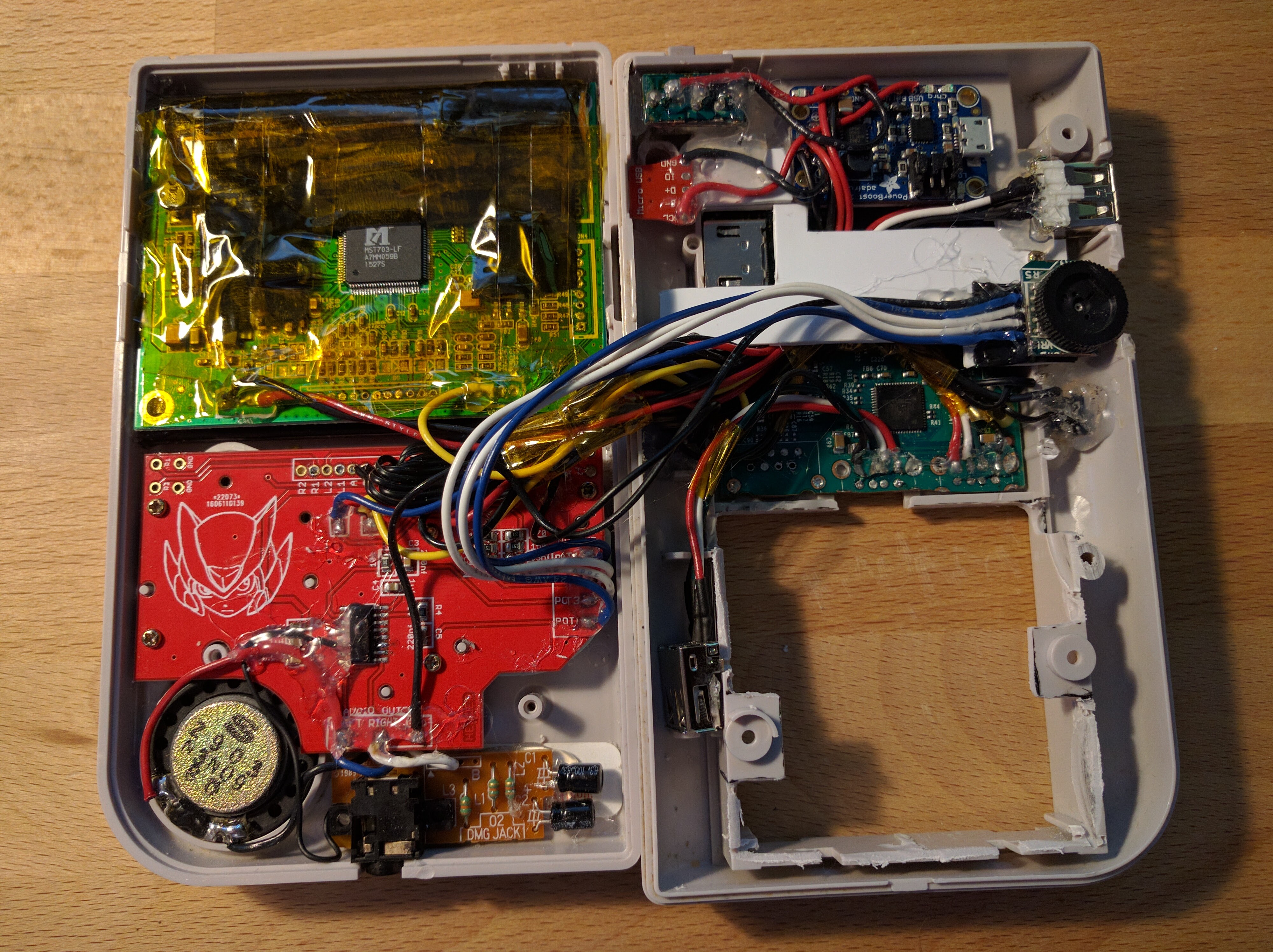

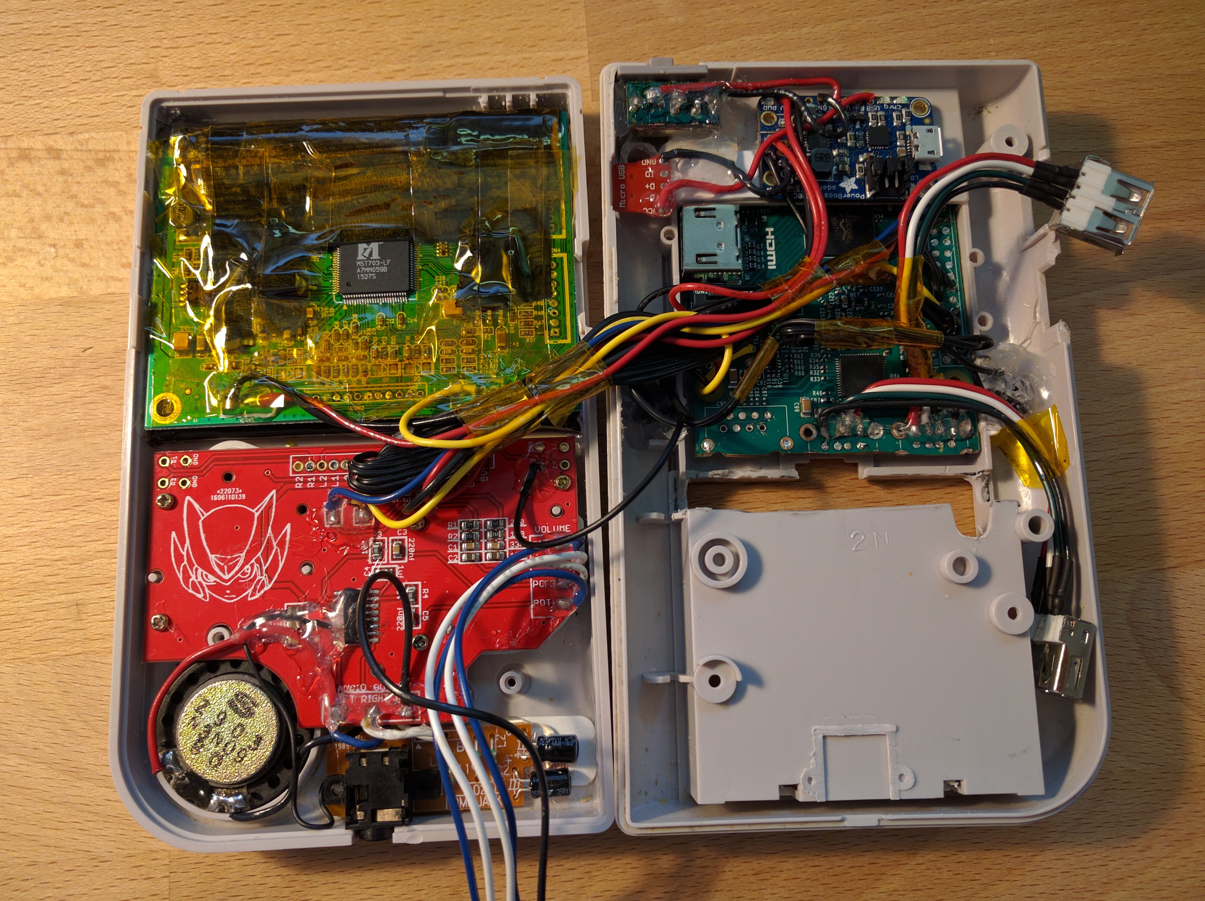

After fixing some audio issues, I connected everything together in the case... and... I will need to do a little cable management for the next few days. This is honestly one of the hardest parts because the cables really do get in the way. The cables I am using are a little bit thicker than my GB0 project, but I think I can work with it from doing some case closing testing.
Everything connected, need to clean it up
[spoiler="ugh, cables"]
[/spoiler]
Preview Picture :)
[spoiler="Preview"]
[/spoiler]

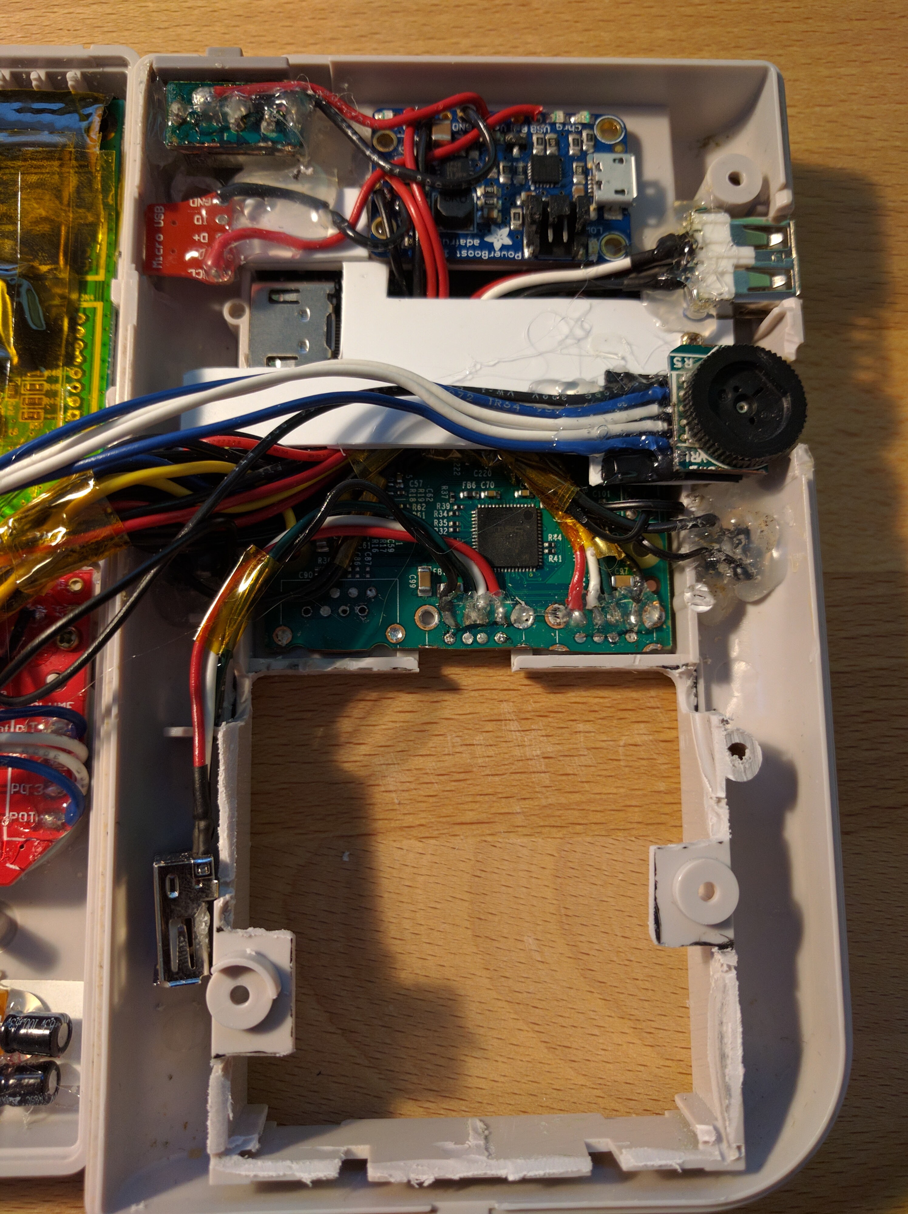

Getting close to being done. The biggest thing left is to figure out how to get the top to close. Maybe a screw hole?

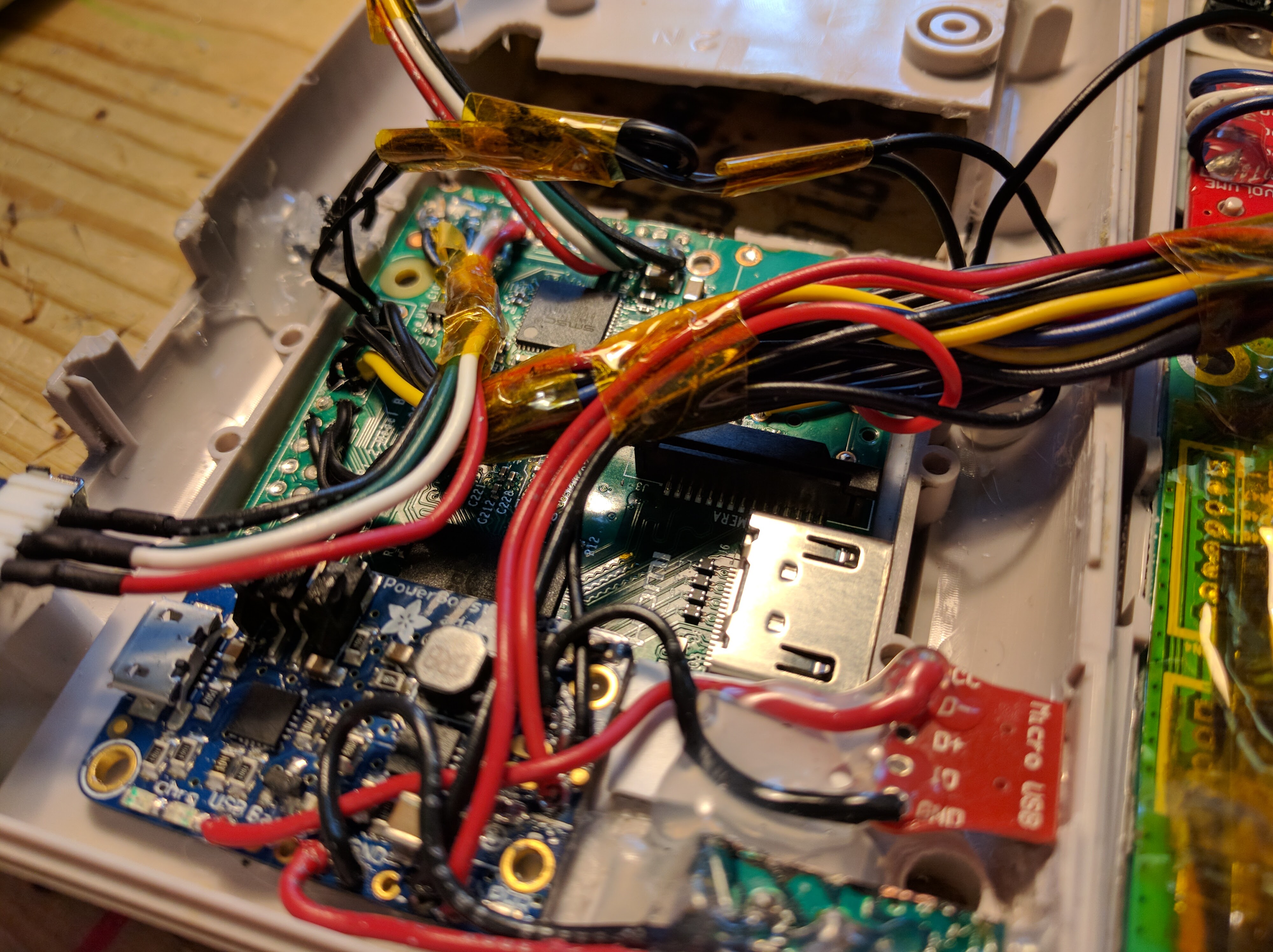

Cleaning up the wires
[spoiler="Wires"]
[/spoiler]
Had to remove the Camera connector because I did not have enough room
[spoiler="Before"]
[/spoiler]
[spoiler="After"]
[/spoiler]
Put on my bracket to keep things tight
[spoiler="With bracket"]
[/spoiler]

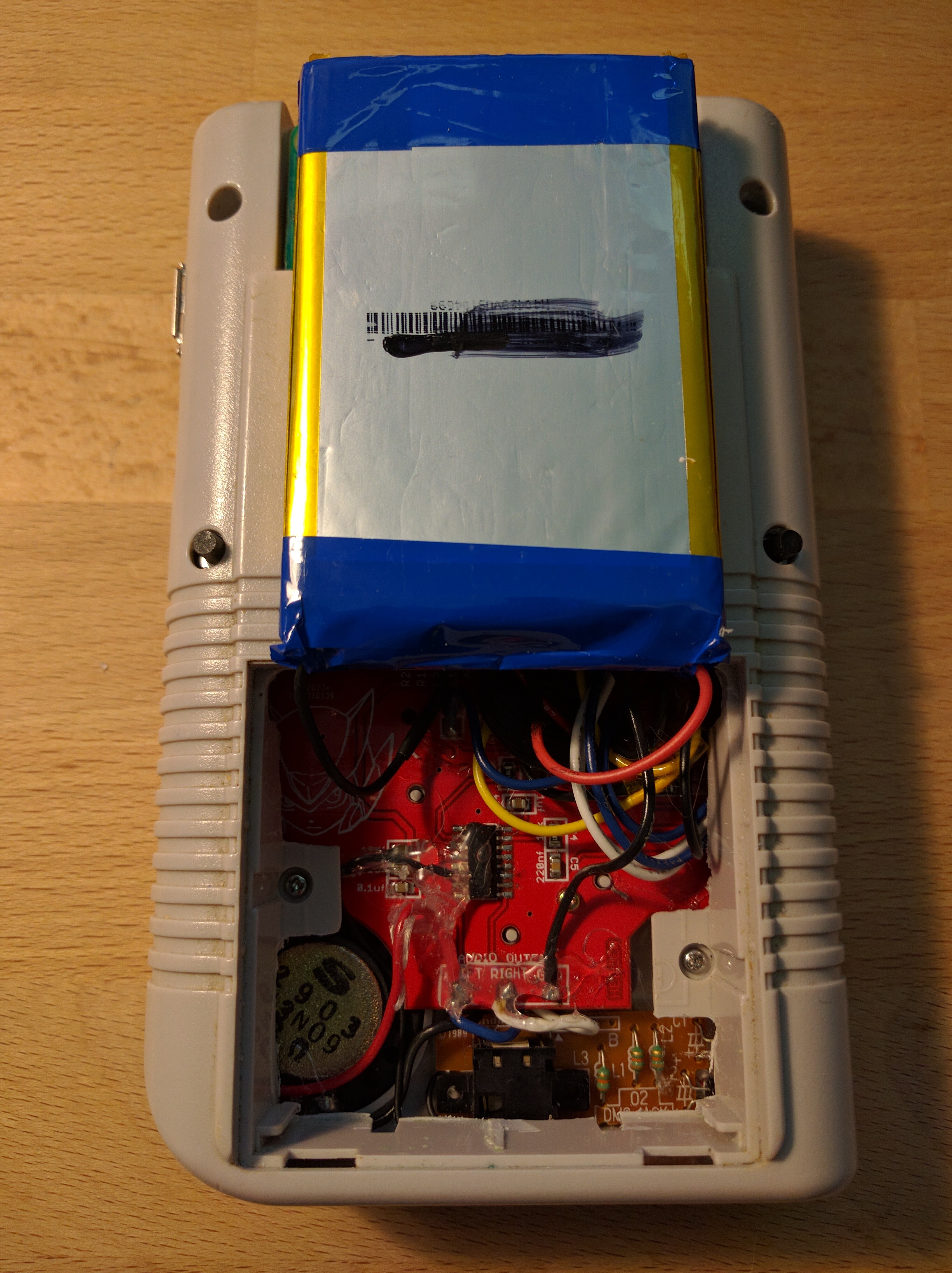

Does it all fit?
[spoiler="Before Battery"]
[/spoiler]
[spoiler="With Battery"]
[/spoiler]
[spoiler="Success"]
[/spoiler]

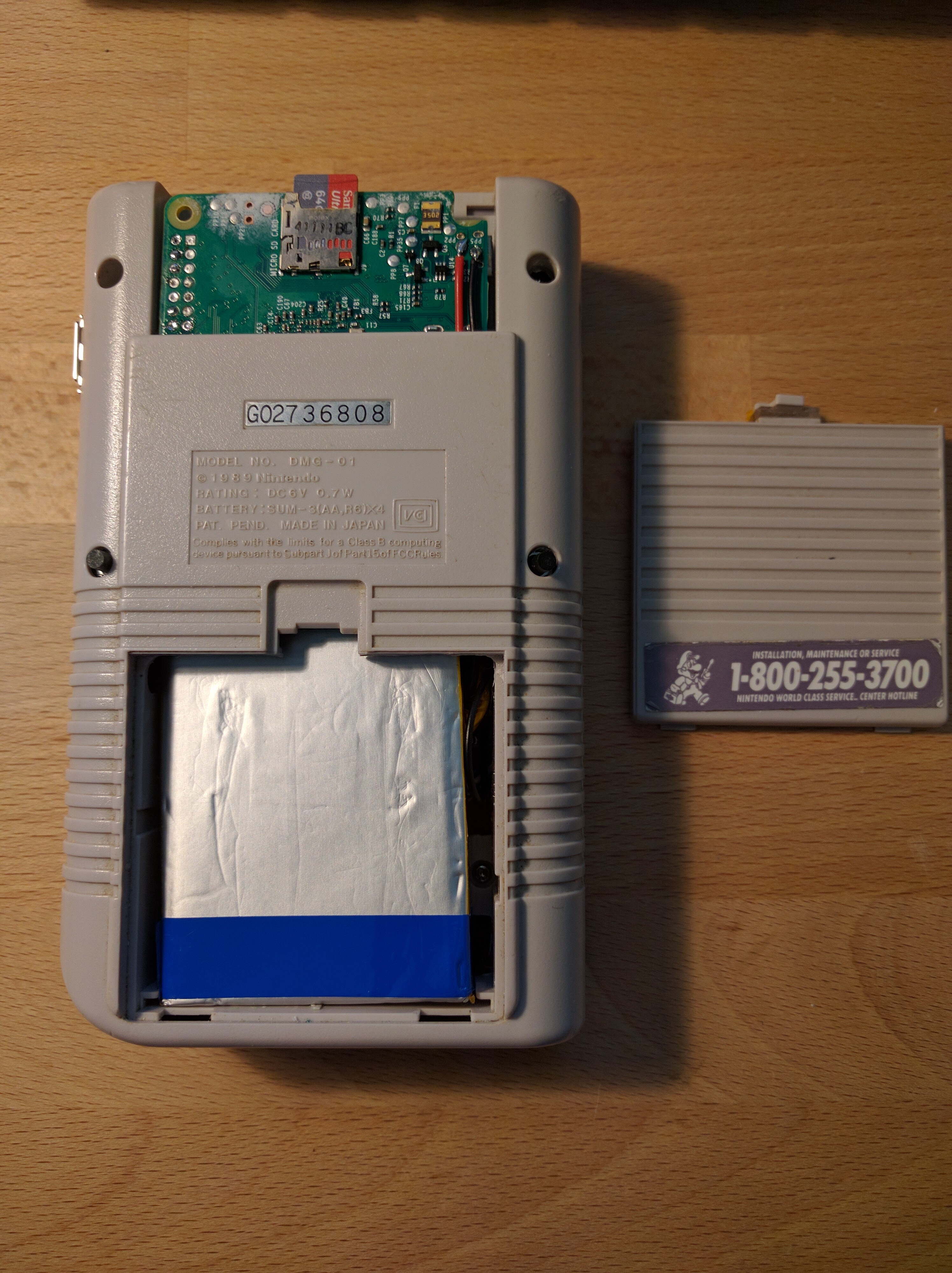

Also, I had to remove the battery compartment
*The battery was too big for it to fit + the wires I was using so I had to cut the battery compartment off. Not too big of a deal.
[spoiler="Removed Battery Compartment"]
[/spoiler]

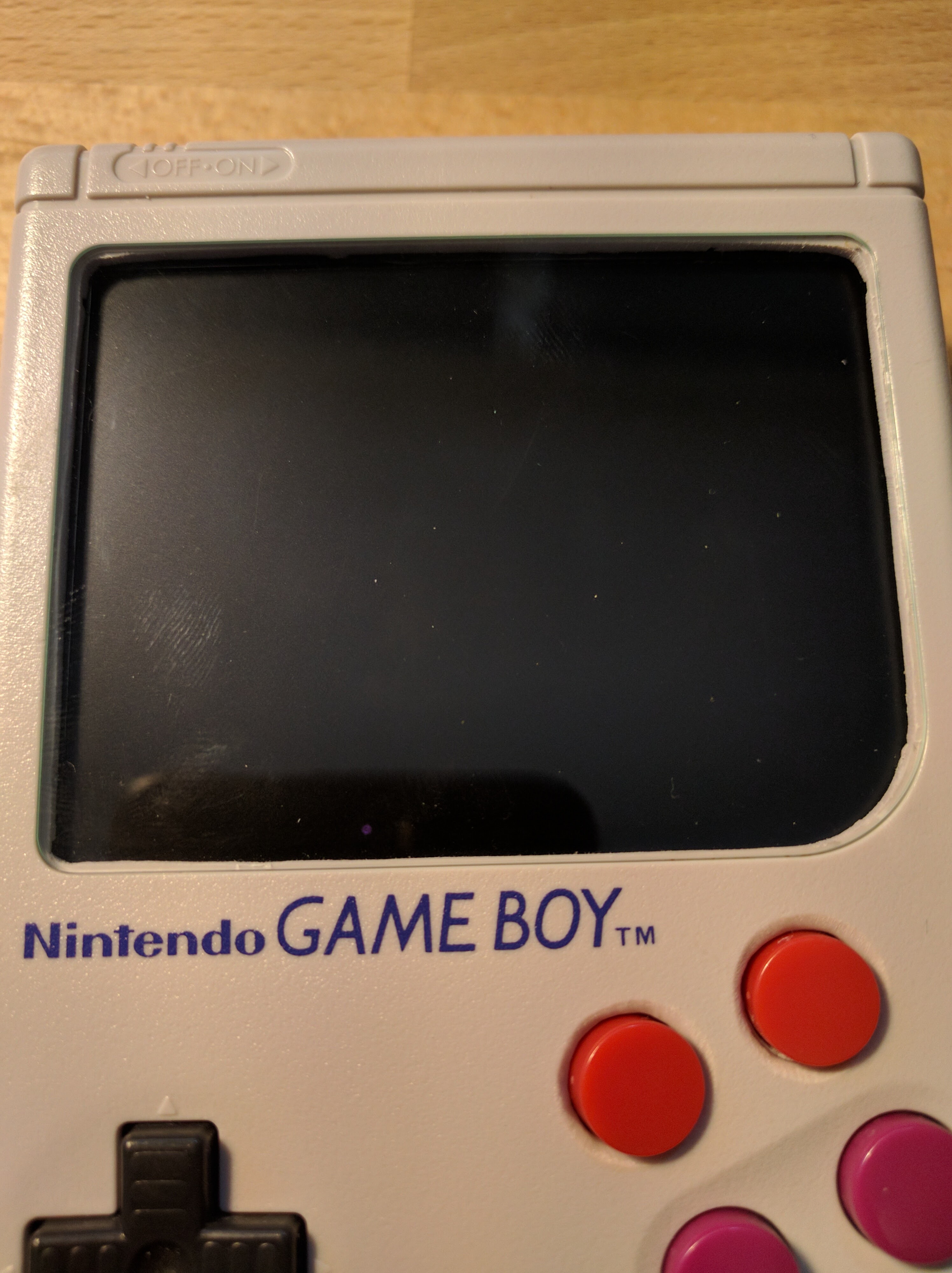

Now, I need to figure out two things with the remainder of the build.
1. I need to figure out how to get the top to close? I got some suggestions to drill a new screw hole on the back and glue a screw bracket at the top of my screen. This is a VGA screen so it is a lot larger then the other composite screens. Open to suggestions!
[spoiler="Need to get the top to close"]
[/spoiler]
2. I need to figure out how to attach my glass screen to the top? I do not want to use super glue on the sides because it leaves a very noticeable white film when it drys. Open to suggestions!
[spoiler="Need to get the screen to stick to the bezel"]
[/spoiler]

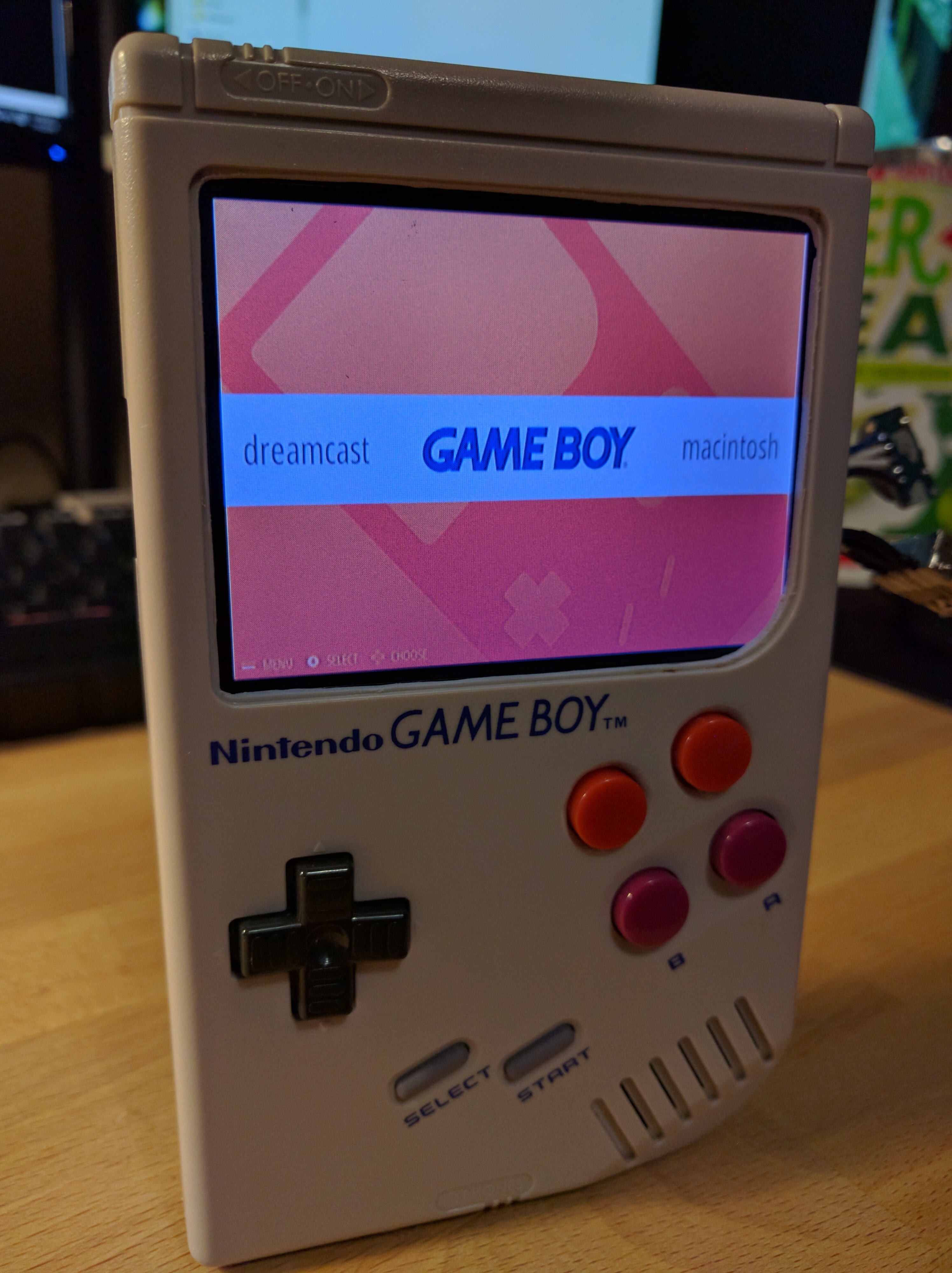

The screen seems align to the right side.
Is the the problem with 640x320 screen? Can we zoom/center the content inside screen so it can position right in the middle of cutted frame?
dirtybeagles
Posts: 386
Has thanked: 34 times
Been thanked: 64 times
Re: DirtyBeagles Gameboy Pi2
Post by dirtybeagles » Fri Jul 08, 2016 5:00 am
dboSS wrote:The screen seems align to the right side.
There are no setting that allows you to move the screen on the actual screen settings, but there may be some settings in retropie. There are some settings in config.txt that can be played with, I have not looked at them yet.
