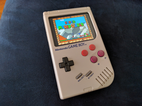

Hi another Dutchie here, this is my build:
Ter inspiratie :D

Post by BadBert » Mon Jul 11, 2016 3:19 am
that looks good :D
only thing that's missing (i think) is a nice screen protector with print :P hahaha
what screen did you put in?

sander
Posts: 34
Joined: Wed May 18, 2016 10:44 am
Re: Spook's project
Post by sander » Mon Jul 11, 2016 1:45 pm
Hi, yes a screen protector would be nice, maybe I will add it as well.
Mine is also running on the alternative booster/charger circuit, it works well and is alot cheaper
then the original one. If you remove the sides you can fit it infront of the charger port so the micro
usb connector fits nicely in front of the port.
