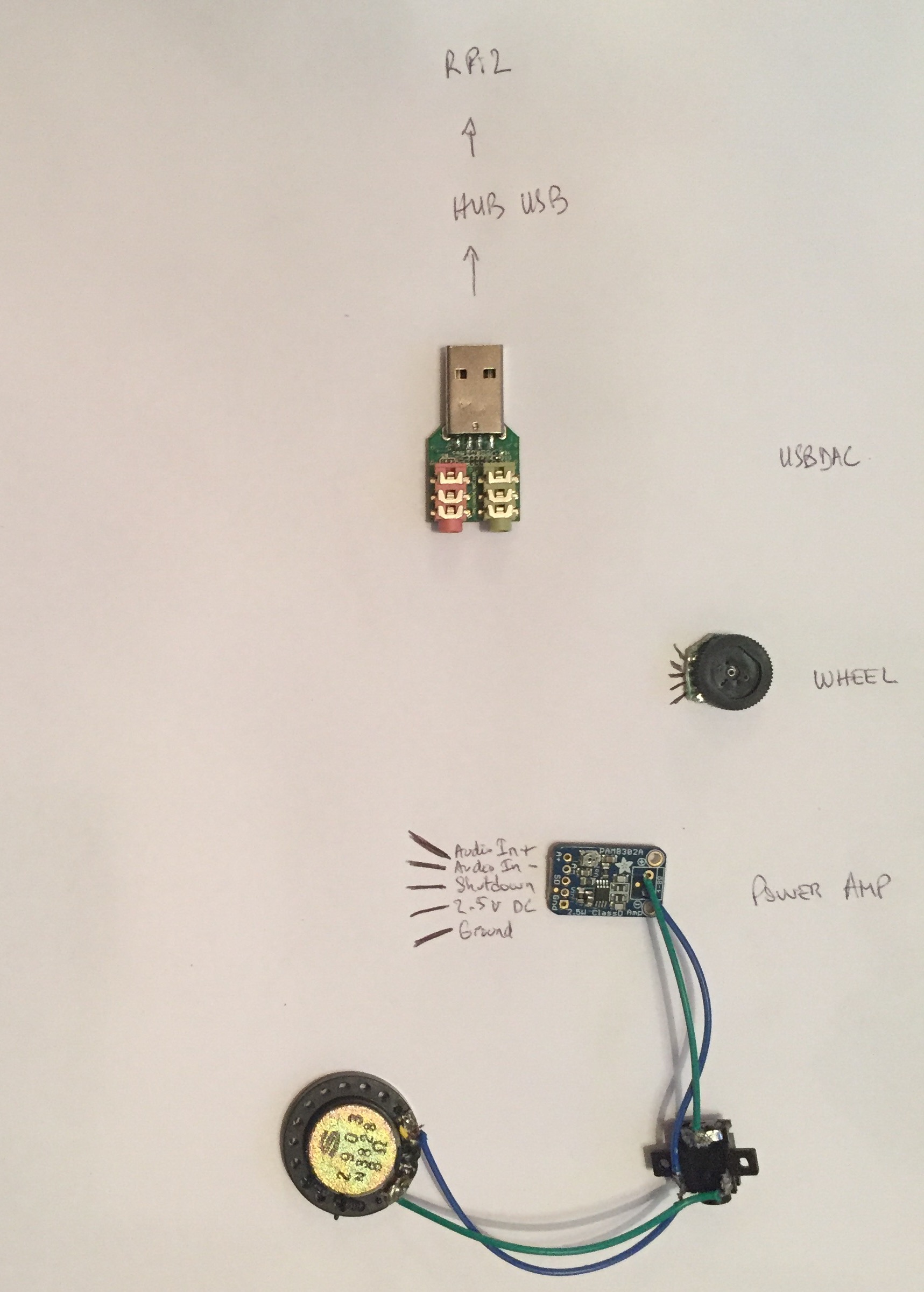

About the audio part.
I have connected speaker, audio jack and poser amp like Wermy's tuto but I am lost with the wheel and the USB DAC.
Could you draw the wiring on my picture please.
Thank you.
Fleder
Posts: 849
Has thanked: 183 times
Been thanked: 258 times
Re: chiz's GB Pi2
Post by Fleder » Wed Jul 06, 2016 12:01 am
Aiolia33Fr wrote:HELP!
Hi Chiz,
I need your help please.
Thank you.
B works pretty well.
[spoiler="Method B"]Image[/spoiler]
[spoiler="Full Wiring"]Image[/spoiler]
Aiolia33Fr
Posts: 30
Joined: Tue May 10, 2016 12:35 am
Re: chiz's GB Pi2
Post by Aiolia33Fr » Wed Jul 06, 2016 12:16 am
Hi Chiz,
Thank you.
Thank you Fleder
chiz
Posts: 228
Has thanked: 29 times
Been thanked: 119 times
Re: chiz's GB Pi2
Post by chiz » Wed Jul 06, 2016 11:45 am
Thanks for the rescue @Felder :D didn't have the time to make a diagram but yours is great!
@Aiolia33Fr
I have my wiring pretty muck like method A that Felder posted bit I suggest you try method B as well.
