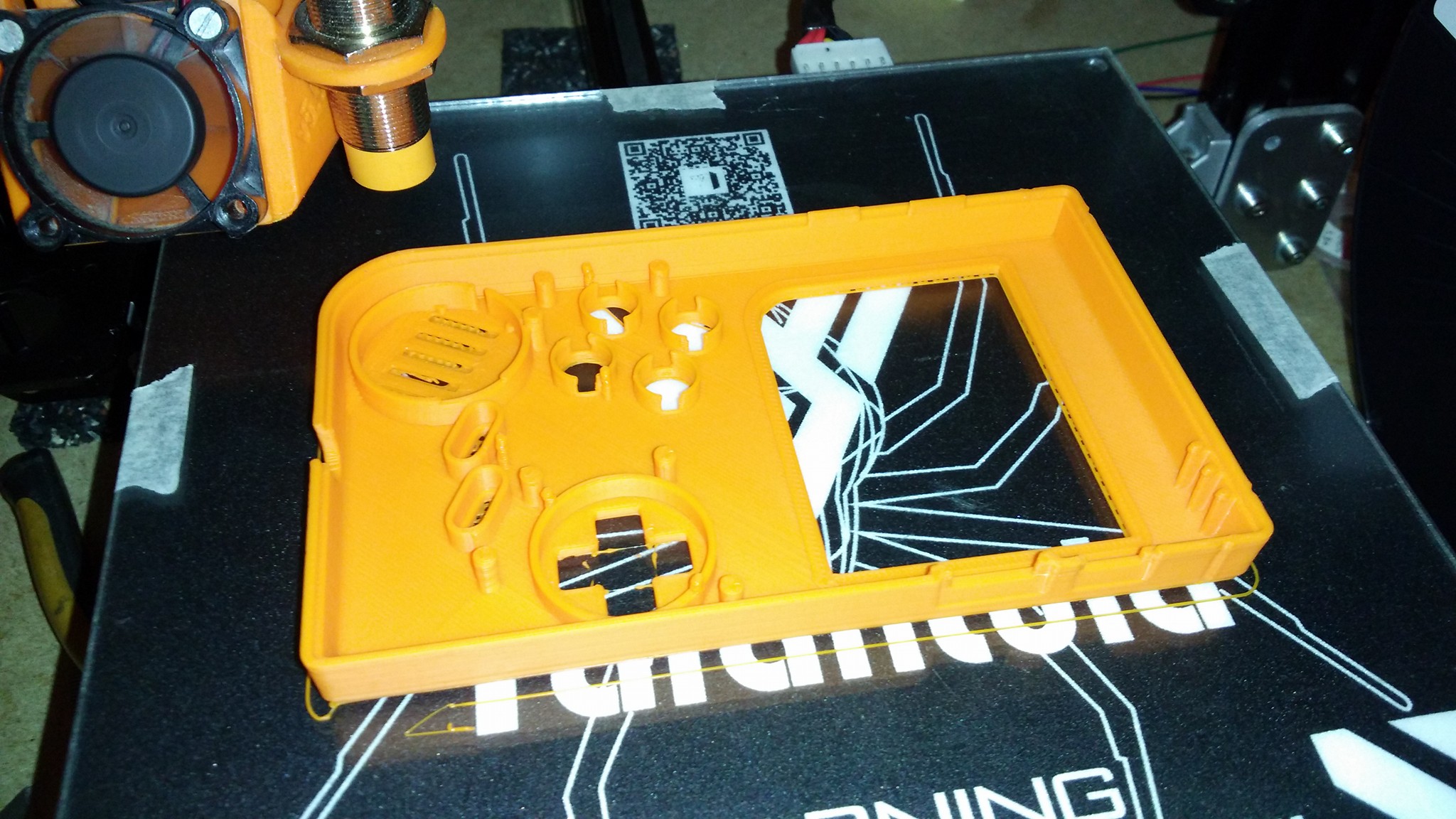

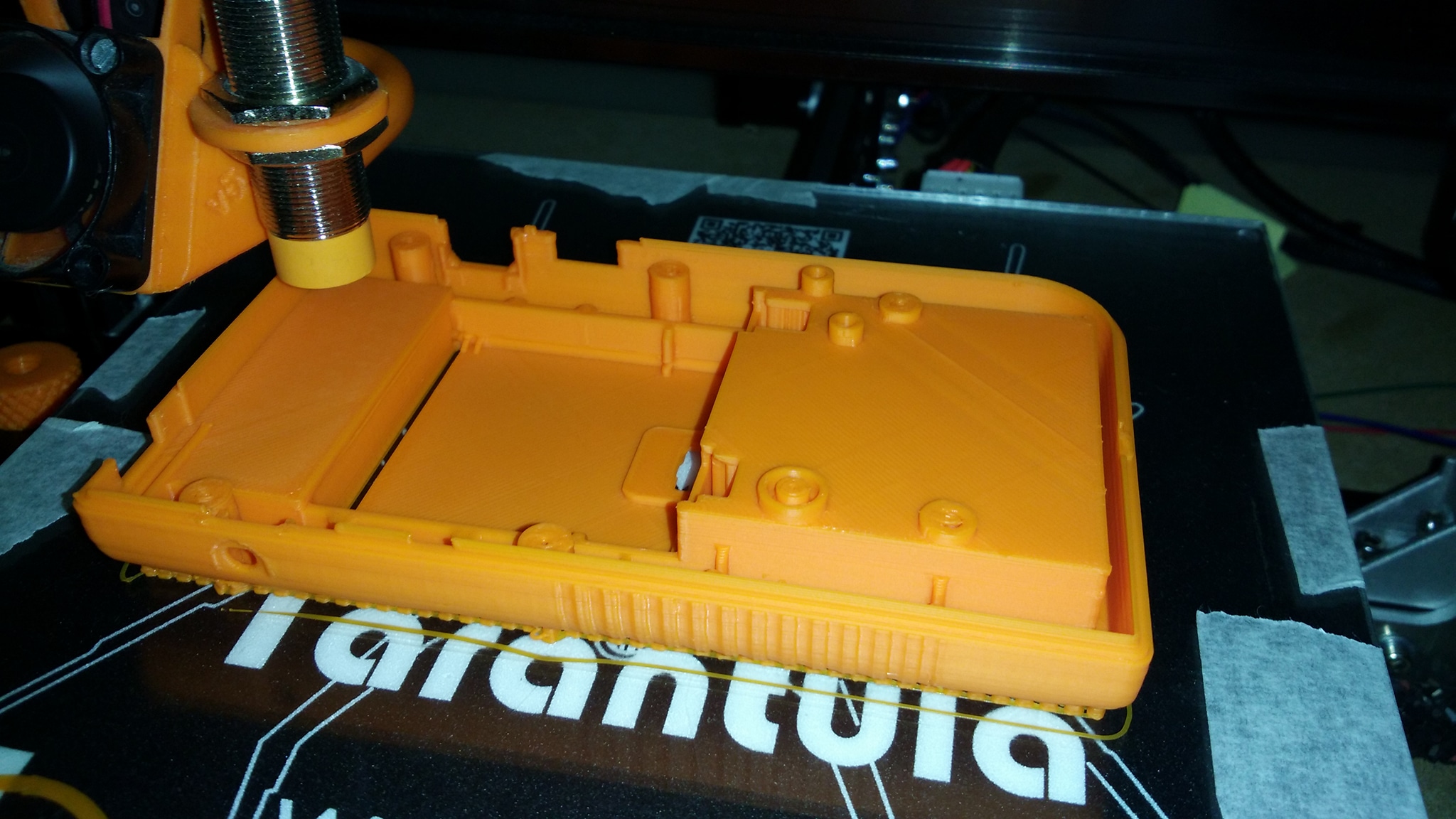

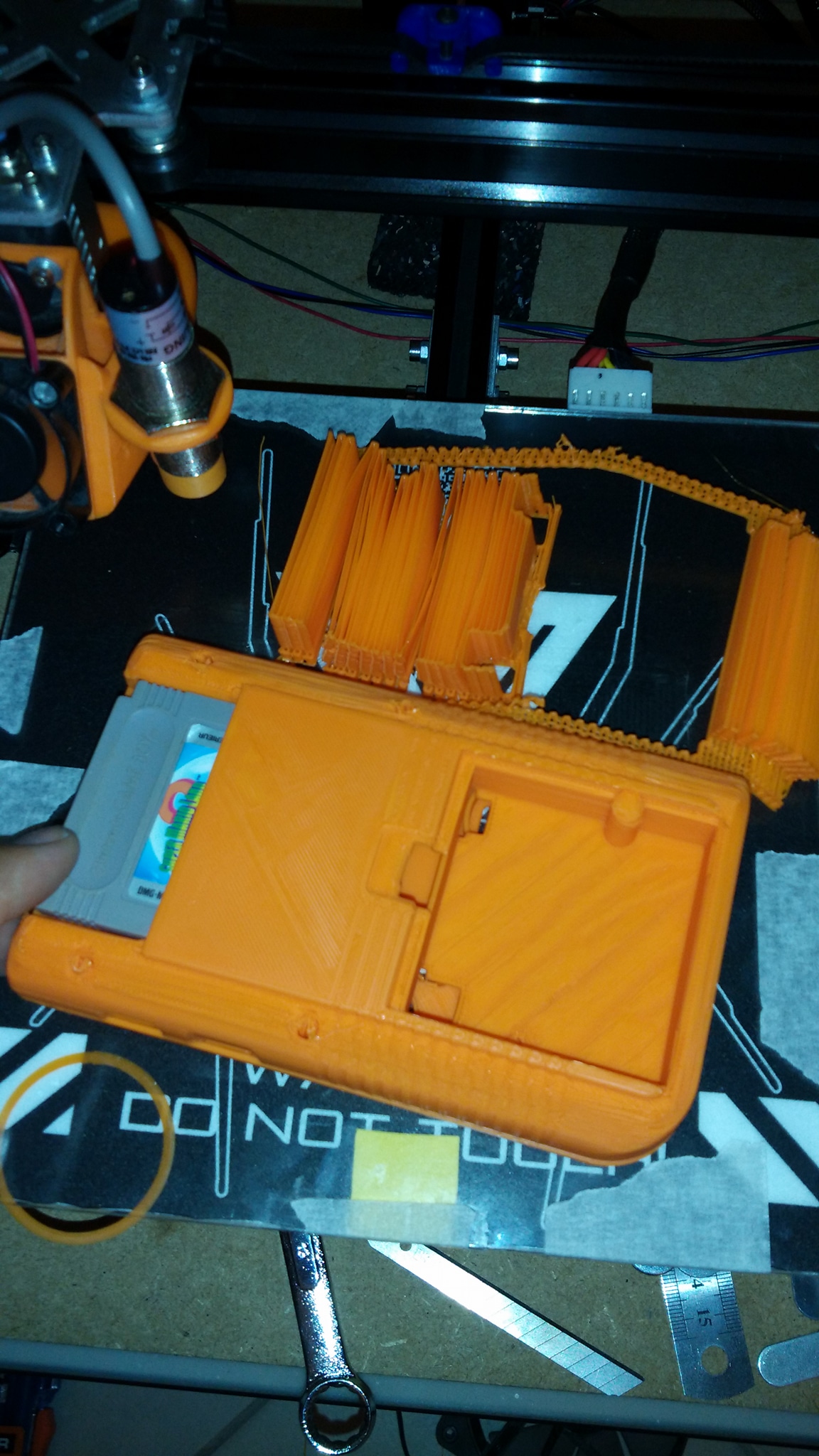

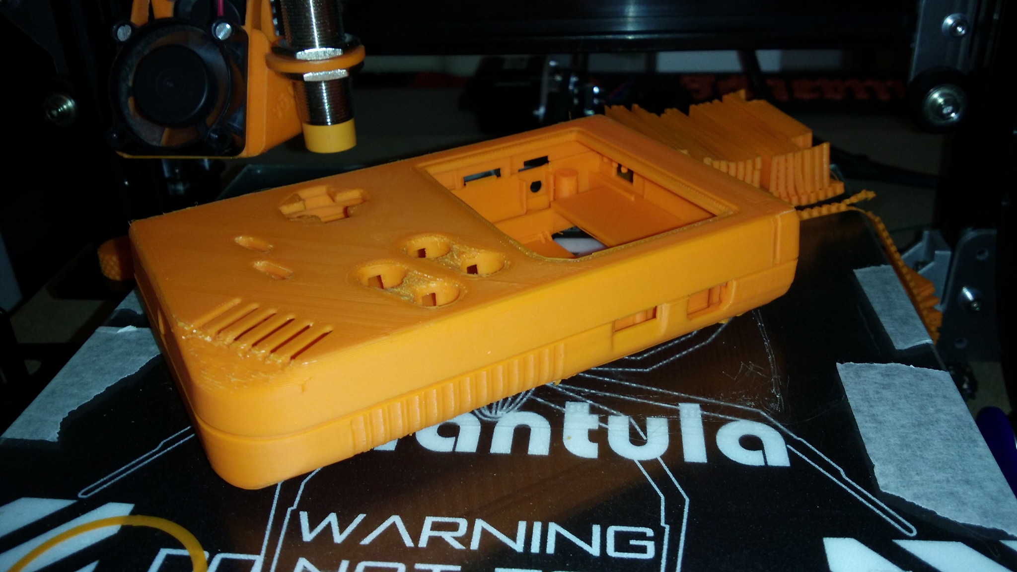

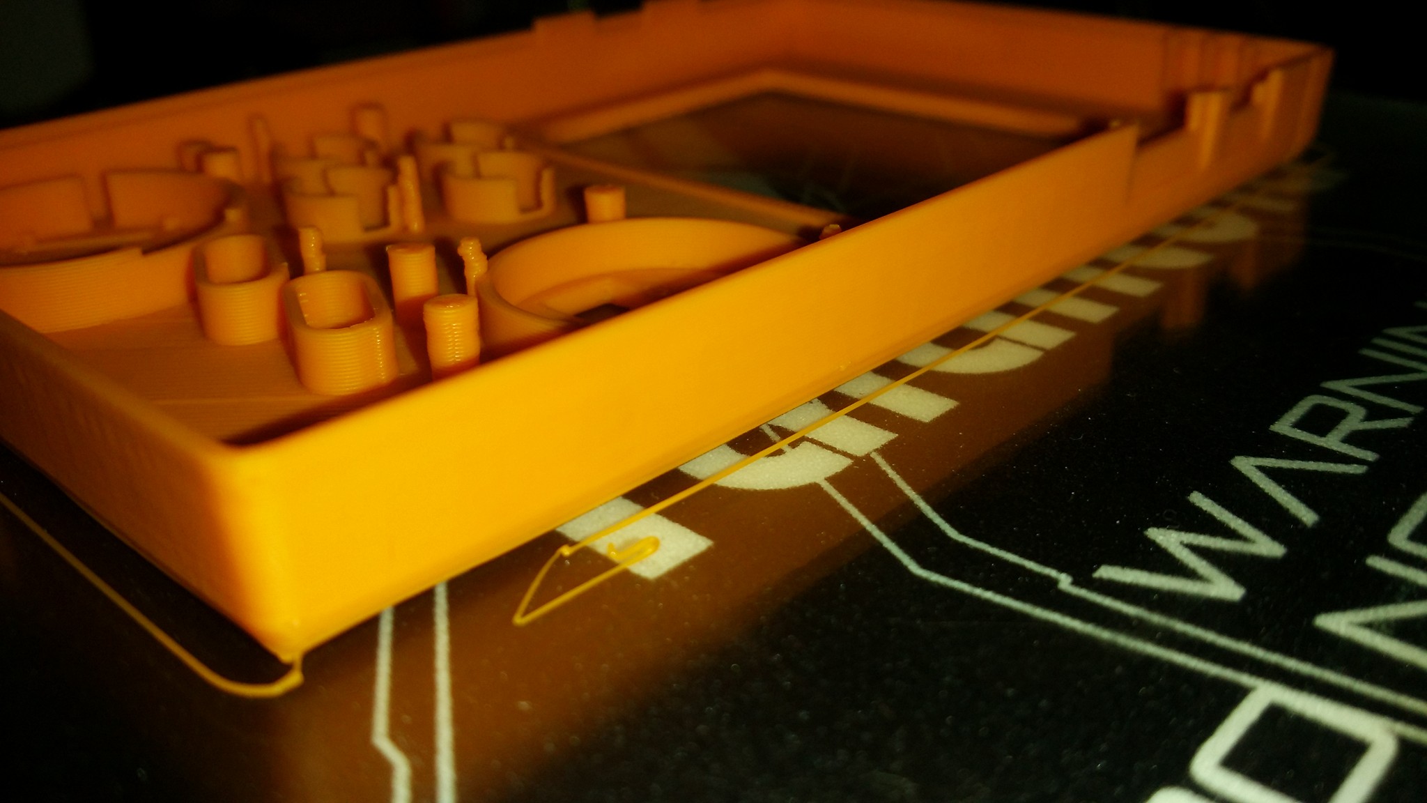

Here you are :p
this was printed with a tevo tarantula . This model was " faulty" and the screen did not fit :/ but its OK now . The print took 5.5 hours to print the back shell, and 2.5h to print the front shell
I think next time i print the back shell, it has to be printed on the other side, just a beginner's error :) ( i have the 3D printer since July of 2017 ) Also the model uses much supports

Hey, that's awesome! Thank you for the pictures! :)
That is a really good looking print. I am curious – do the two halves fit each other well enough?

Post by Al3x360 » Tue Oct 10, 2017 1:32 am
thanks! well : it fits perfectly :) but the parts have to be reinforced, i think adding some littles triangles to the interior side is ok to reinforce the thinner parts . adding glue do the trick as well ! since i added an aLu kit to my printer, the assambly is much better, and the prints are now much better quality than before . i am now looking for all the other parts and waiting to be delivered at home, if i can, i'll post the result on the others subforums :D
