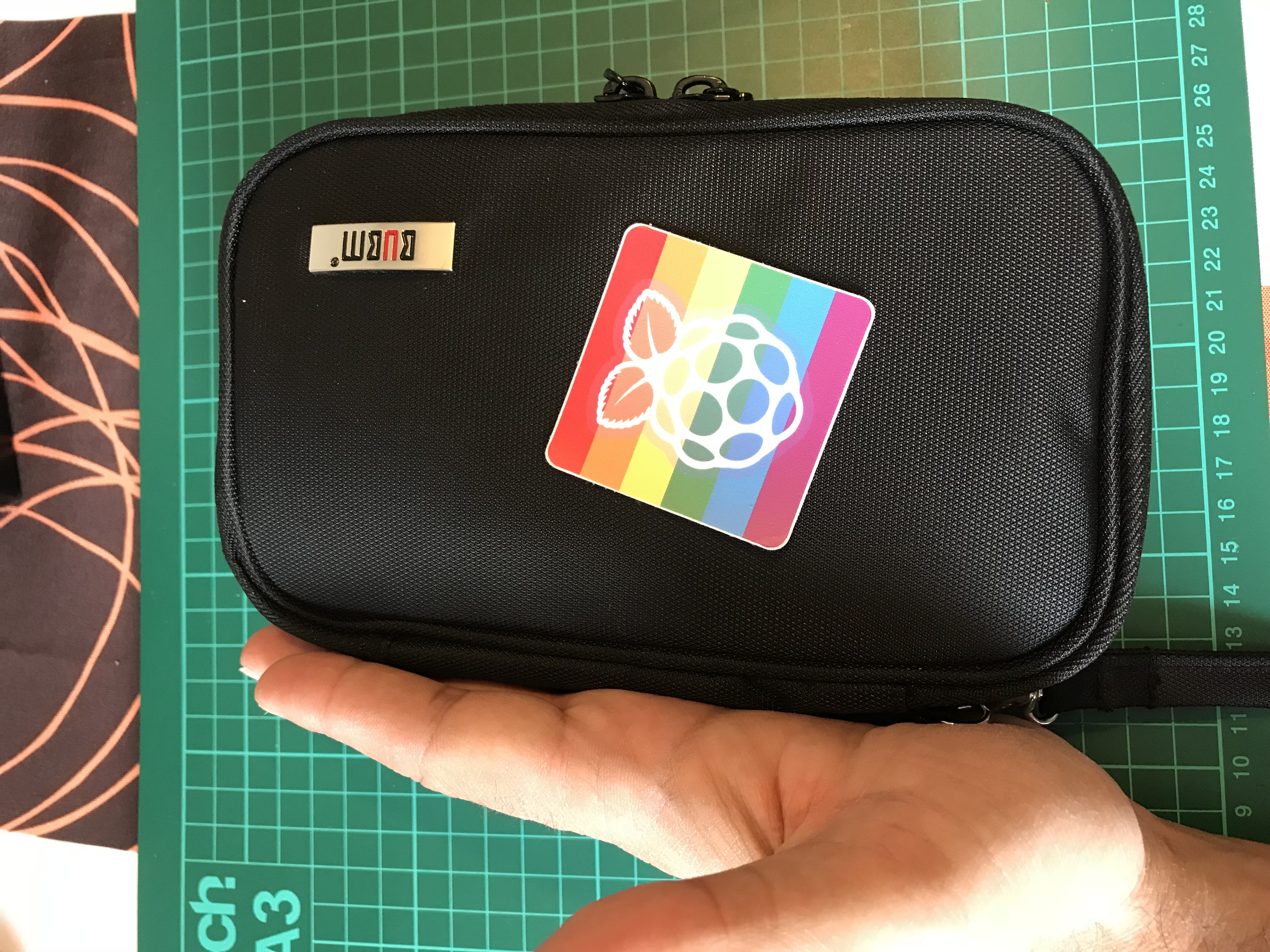

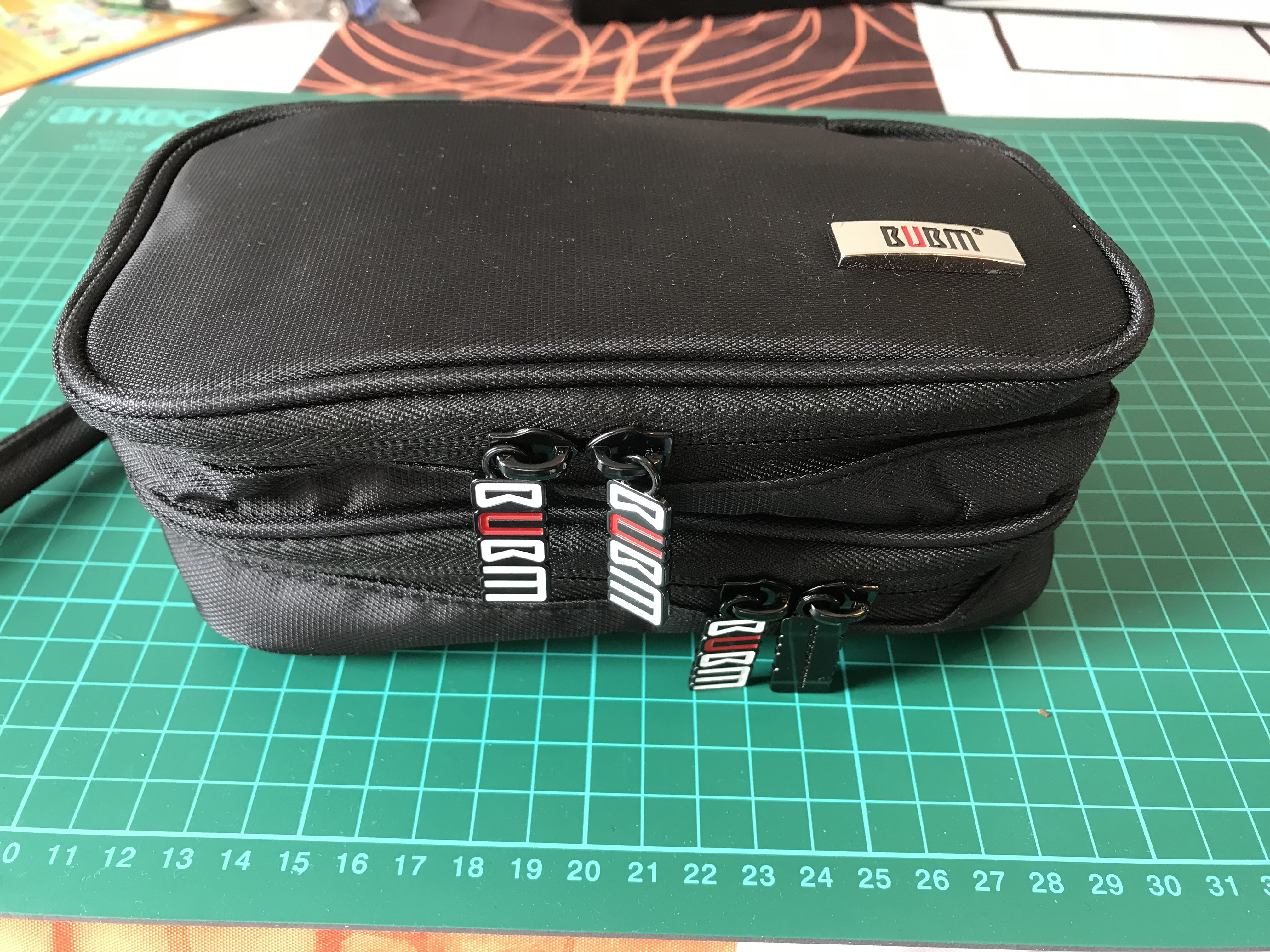

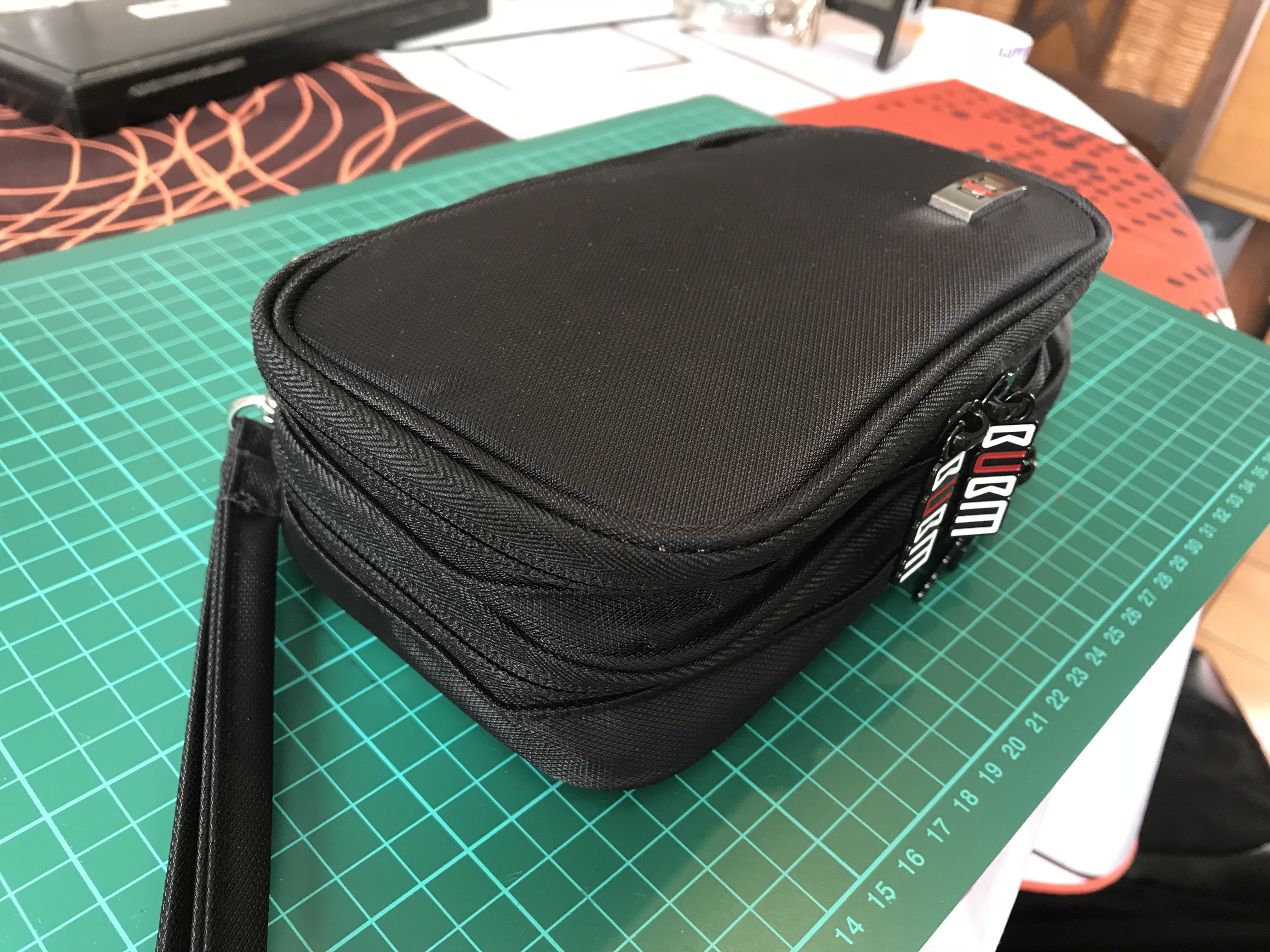

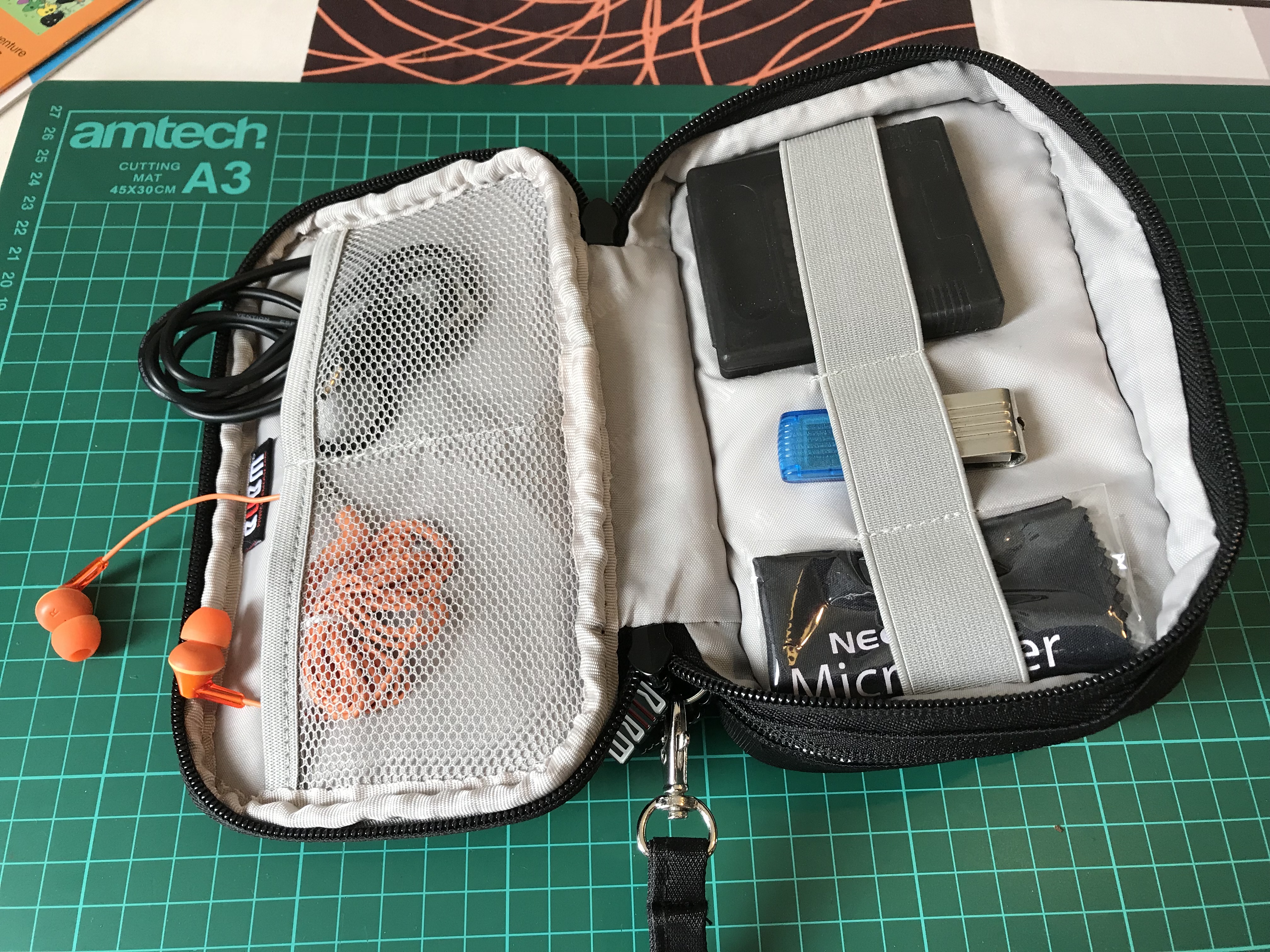

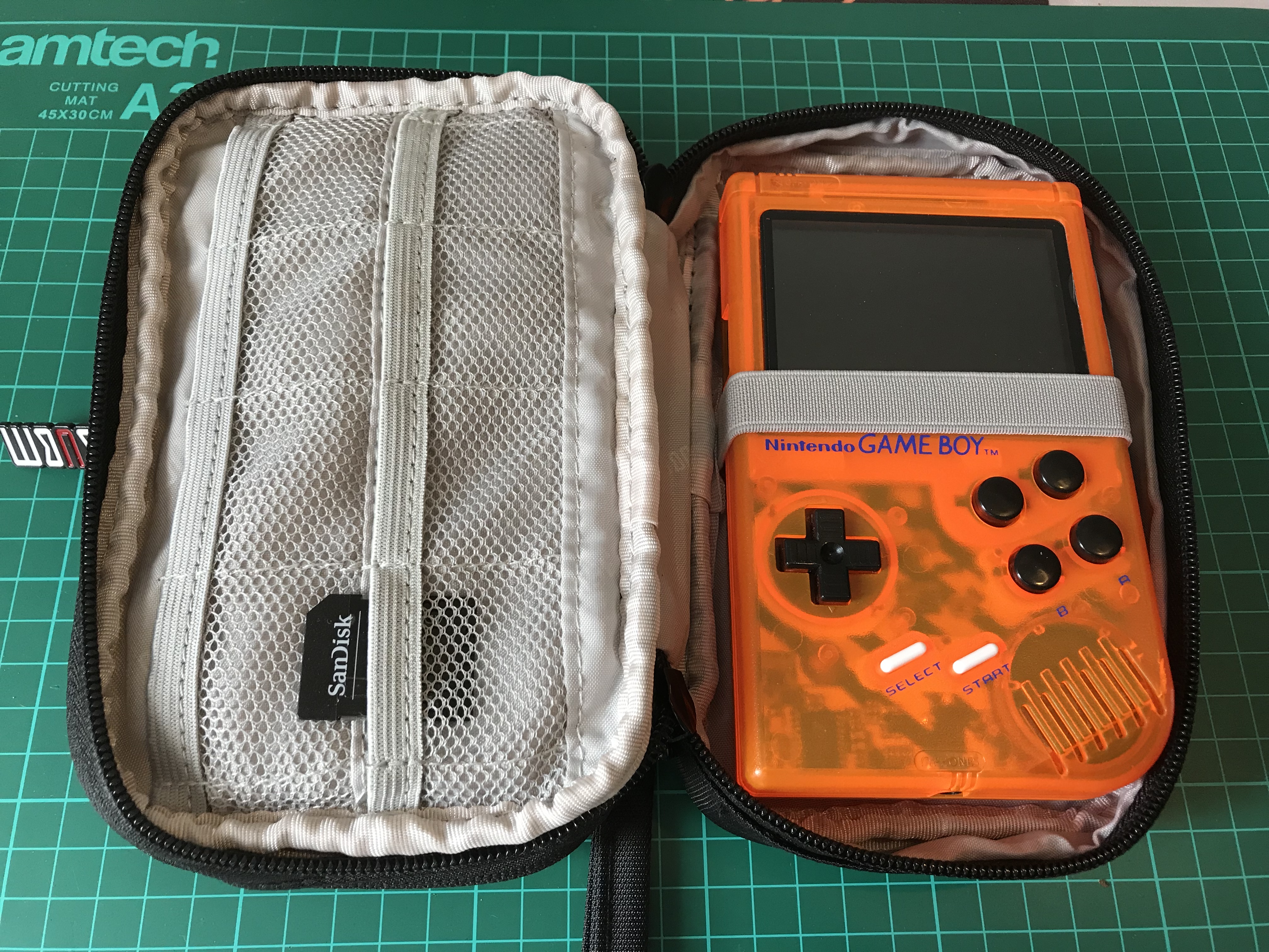

update 27/10/2017
HERE WE GOOO ! :mrgreen:
You said mobile handheld gaming device huh ? :ugeek:
I had few weeks ago some sellers over ali who had the charging cable in orange, the microfiber cleaning cloth in orange, a car charge plug in white/orange...
By the time i have decided to spend more money, those were gone and no more they are available for now. So i gathered what i had at home to fill the carrying case.
I need also to find an iphone type wall plug to plug the USB/jack charging cable in it so that i can have a very flat charging outlet in the case :mrgreen: and of course, should be orange :roll:
I also need to find a 32Gb usb key (orange of course :lol: ) this usb key contains the compressed backup image
Note : i love those free stickers from The Pi Hut but i don’t know where to stick it :D

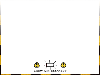

Post by YaYa » Sun Oct 29, 2017 12:57 pm
update 29/10/2017
Automatic shutdown feature addition on low battery :mrgreen:
So, i think this was a missing feature that's why i have worked a bit to add this to Kite's image.
In the following video you will see the overlay for low level warning (occurring at 3.3V but for testing purposes, i have cheated this value)
Then at 3.2V, a countdown will play overlapping everything and if you do not power off the device, it will do it for you...
As i'm cheating for testing, the change between low level and critical level is very short but in reality, depending on you configuration, it will last from 10 to 20 minutes so i advise you to properly save state, shutdown :D
:mrgreen:
Re: YaYa's first GBZ - Kite's SAIO - Big Battery - NO Glue - Custom 3D parts - DC Jack - minimum case mod
Post by YaYa » Sun Oct 29, 2017 1:11 pm
you can get the code in my github
https://github.com/YaYaLanD/Super-AIO
To activate this feature, you edit the config-saio.txt from the boot partition and add the value
# Ability to allow auto shutdown on low battery - by default OFF to let user switch off manually, 0=False / 1=True
AUTOSHUTDOWN=True
