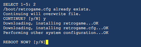

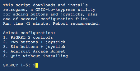

if you've done everything correctly so far (just copy and pasting)
you'll be presented with this screen....
Select Option 1
and allow the installation to complete
once completed...
Reboot, and Retrogame will be installed....
you can now configure it however you have the controls wired/connected to the GPIO
the standard (out of the box) configuration that Retrogame has or installs for you is this....
# Here's a pin configuration for the PiGRRL 2 project:
LEFT       4  # Joypad left
RIGHT     19  # Joypad right

i'm also using the basic gpio assists from that site to organize everything, and for power, one is using a 1000c/camble shutdown and the other is using the power assist pro from pocketadventures. both use pwm audio, and have ads1115 battery monitors.
for one of them, i was actually having issues where the button presses from some of the gpio-mapped buttons would interrupt the screen and cause it to stutter and freeze. it seemed to be a bridged connection somewhere, but i couldn't find it. to get around that, i re-mapped the control board to a teensy/usb and stuck a little hub in there for it, which seemed to work fine. i didn't have the issue on the other build, so that is still using gpio buttons.
