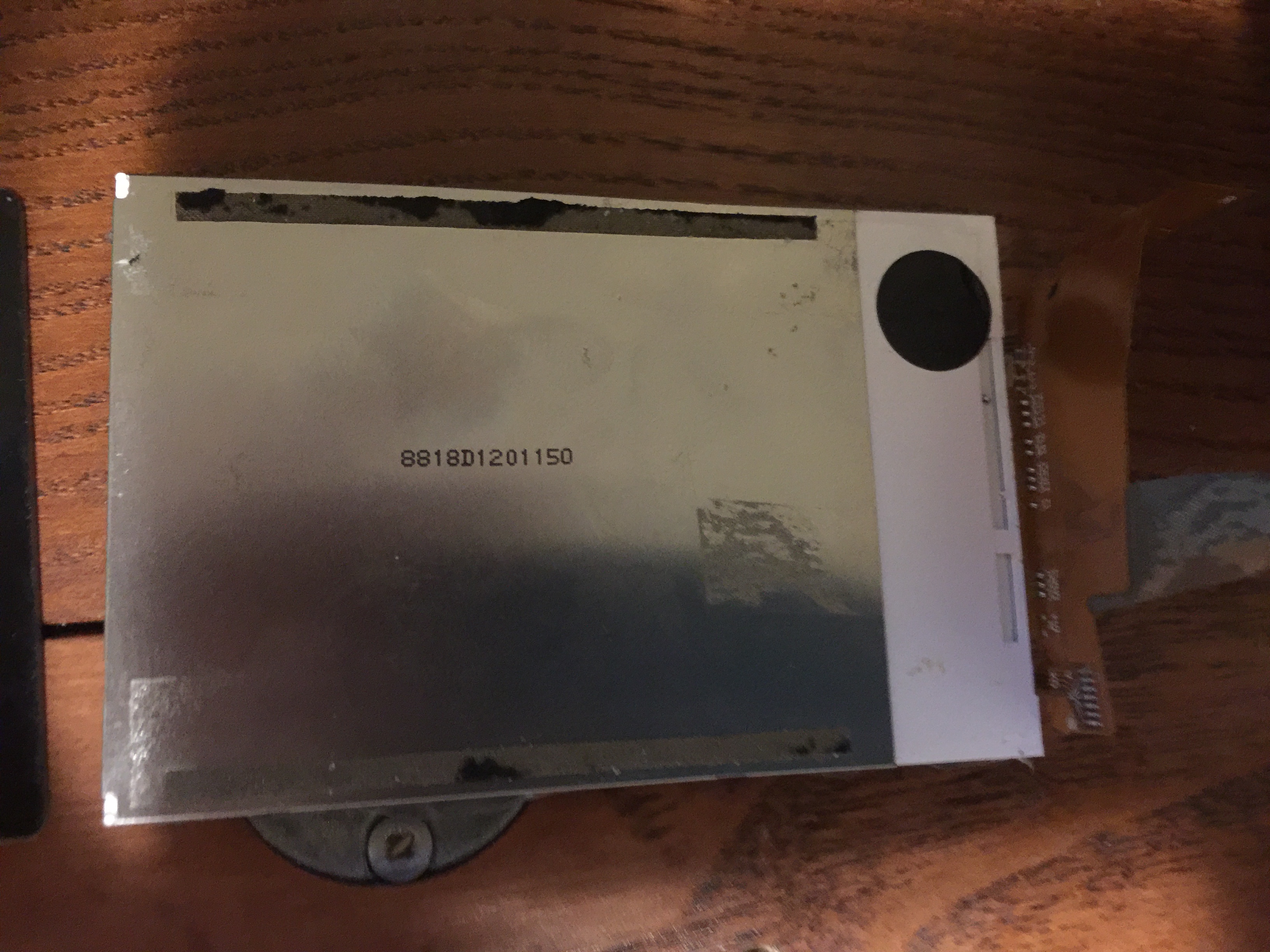

Sorry it took a while, but here are pictures of my screen.

I need a bracket for this screen :-)
Or some 3D printed screw bracket so that I can screw the two halves of the case together.
For anyone interested (it been done but no one posted it here) you can shave off 1 mm on the screen by carefully bend away the ribbon cable and cut off the white plastic part on the screen.
I do not have a dremel so I have to sand the two sides of the front half of the case by hand now the screen fits, just a little tight.
