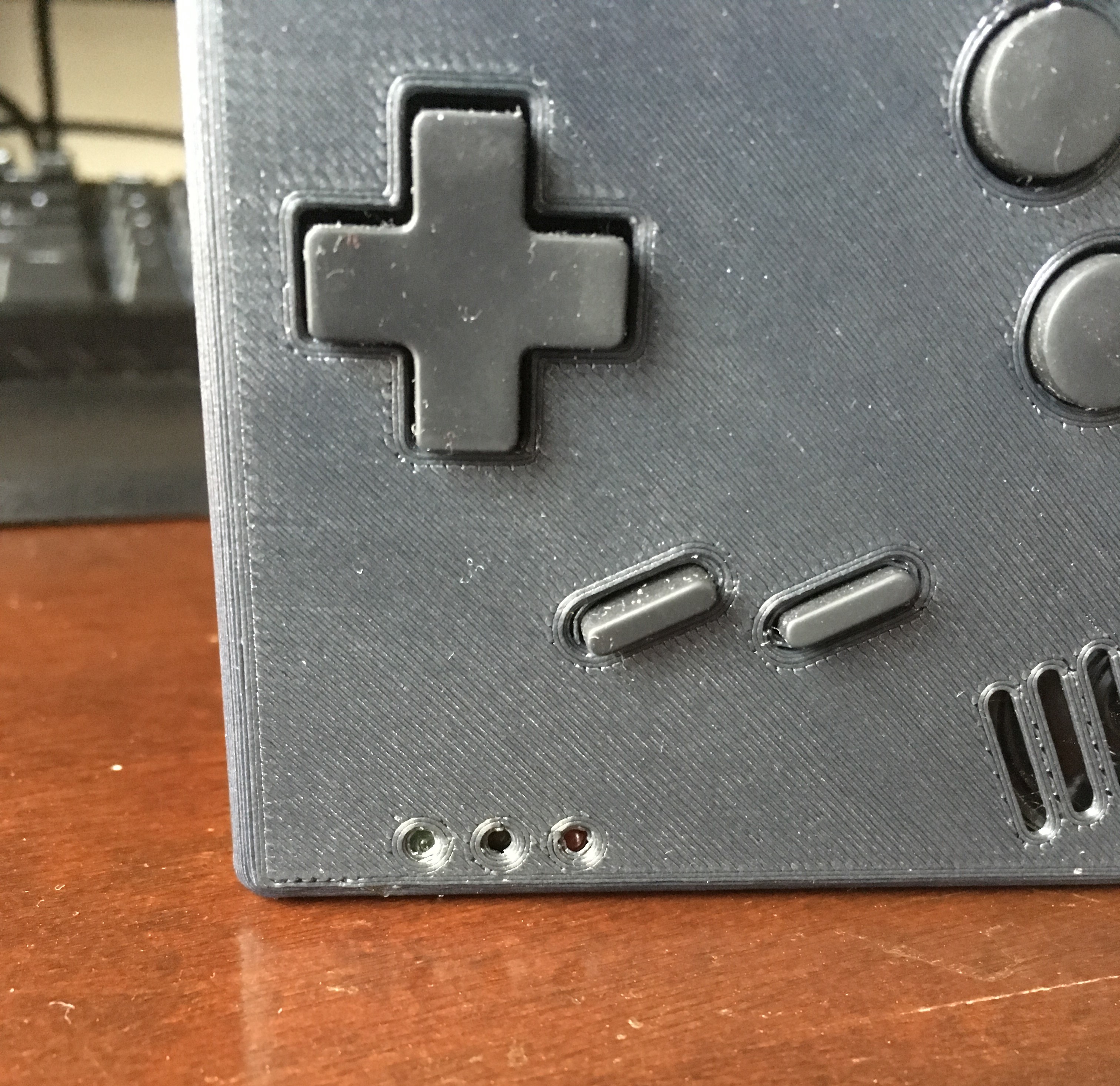

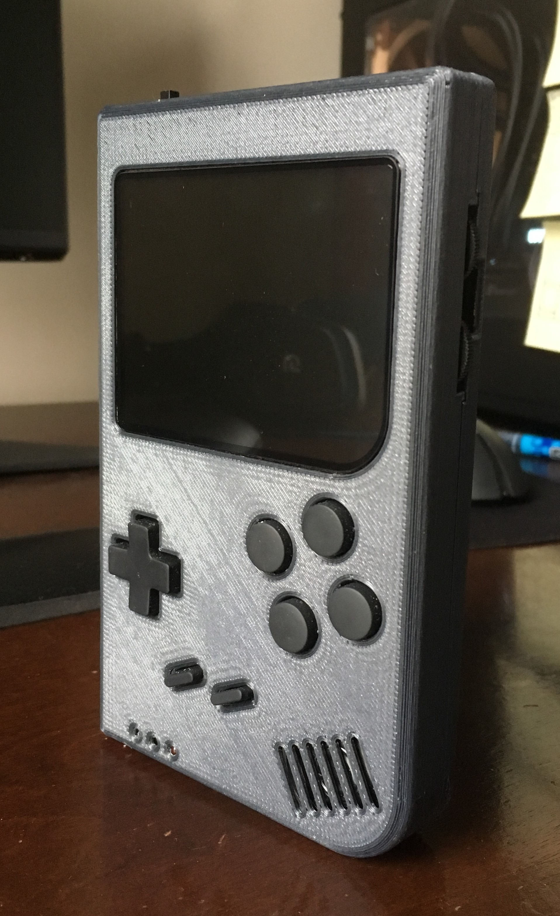

It's a bit irrelevant now, but I've perfected the design (and will be releasing the STLs with this post!). I reprinted and rebuilt it with new features like:
-SD card access
-Larger triggers
-Raised buttons
-Volume wheel
-Brightness wheel
-Battery indicators
---Low
---Charging
---Charged
PicturesShow
FilesShow
-Assembled entirely with M2x5 screws
-Surround bonds directly to screen for space savings
gb3su.zip
(1.86 MiB) Downloaded 403 times
