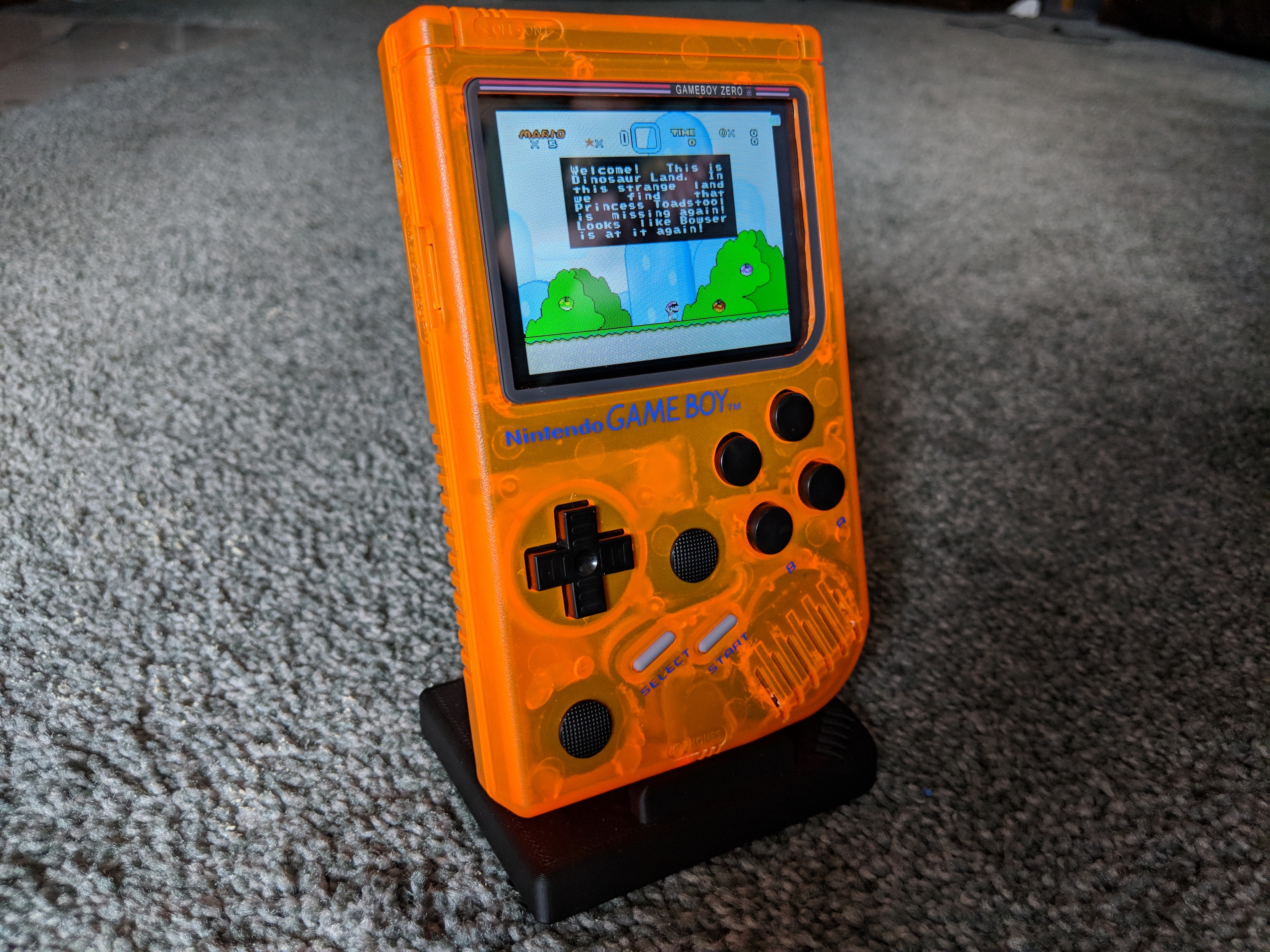

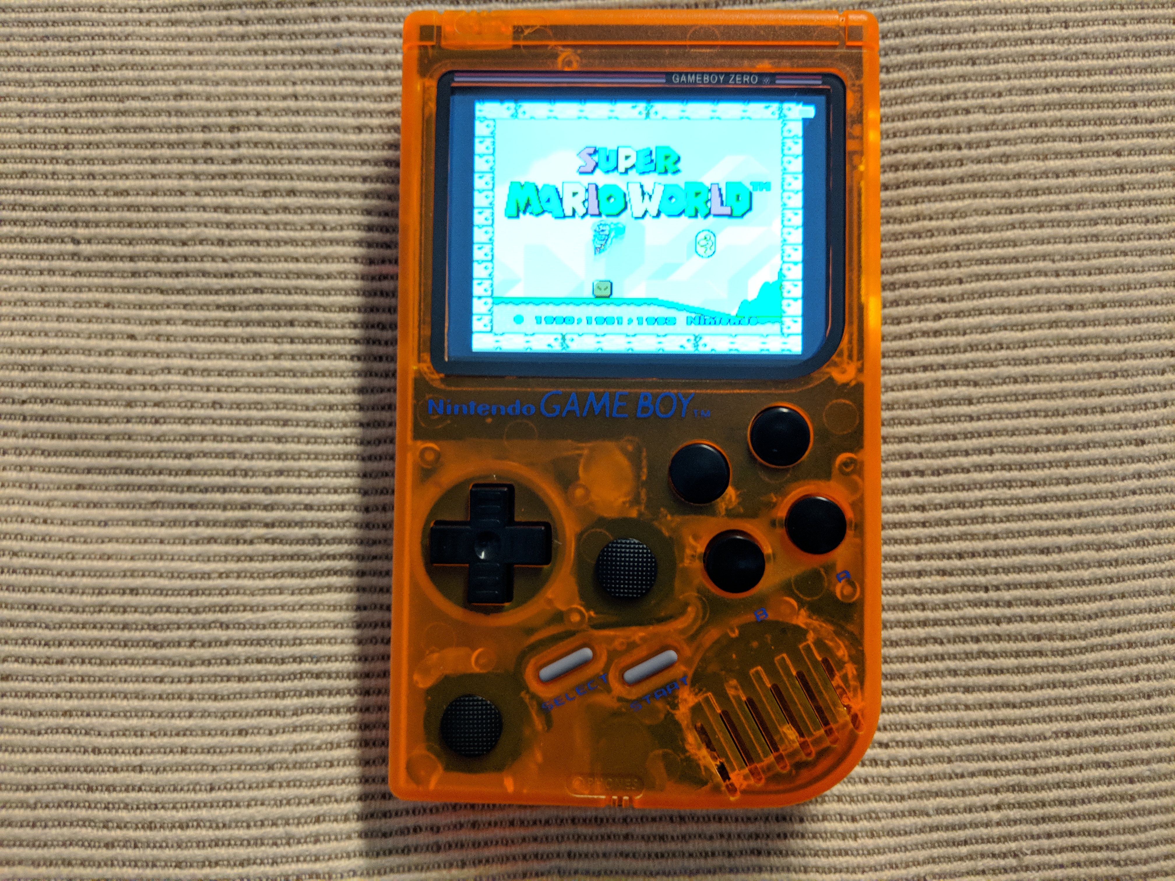

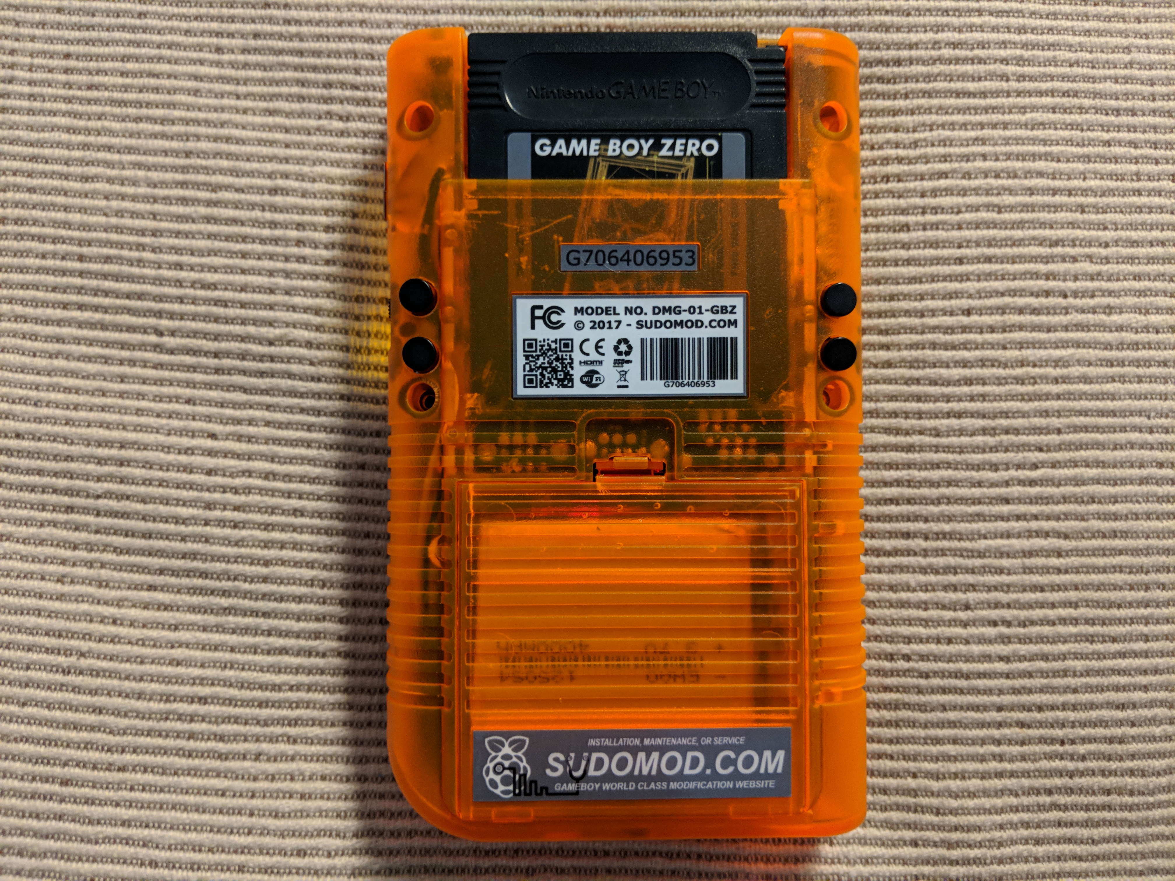

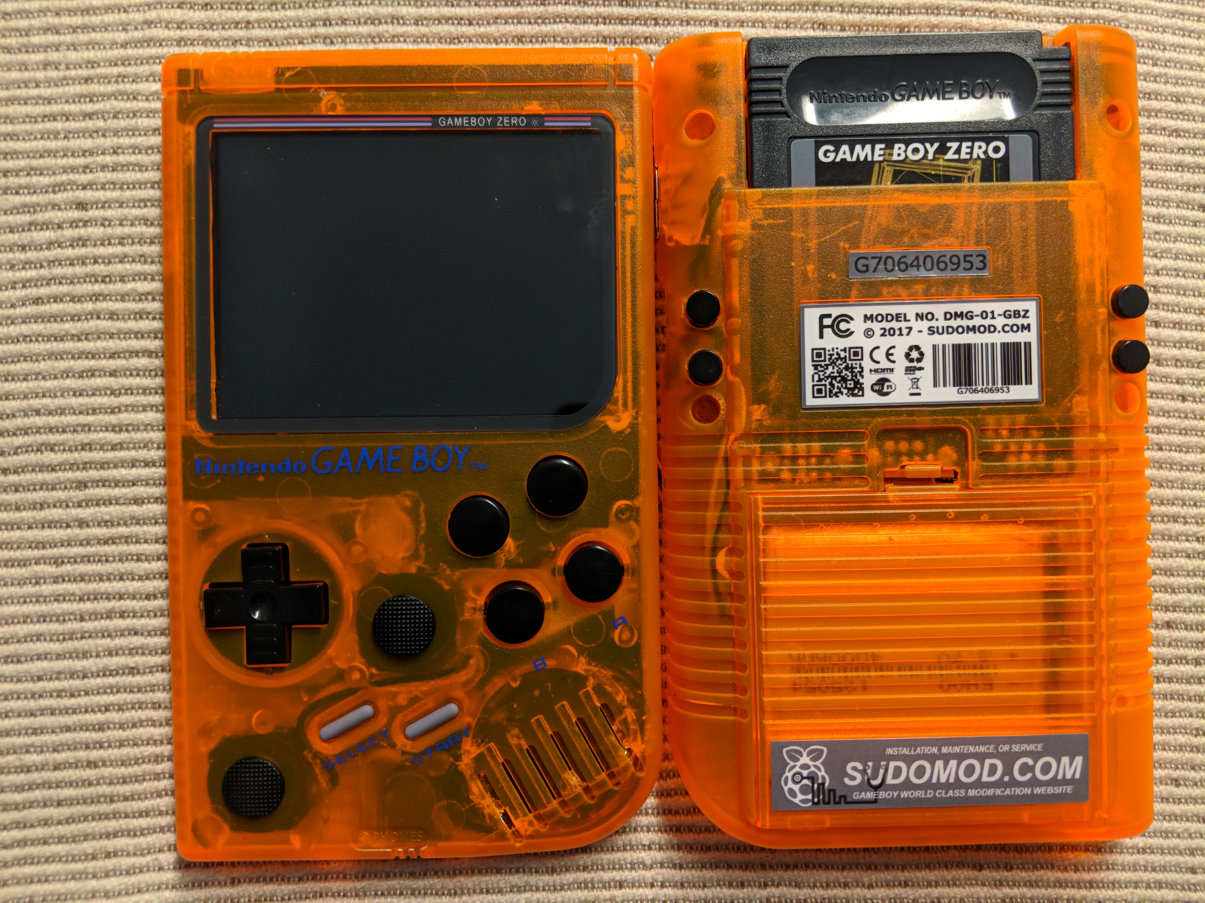

Project Complete:
- I ended up changing a couple hardware items while completing this build.
- I switched to the standard bangood power supply while troubleshooting and it worked well so i left it in permanently.
- I replaced Camble's switch with a standard DPDT and added a tactile safe shutdown.
- I took the shotty looking heat shrink off of the HDMI cable and left it bare. Case closes easier and it actually looks a bit better too.
- Made some minor display adjustments to config file and HoolyHoo's awesome battery monitor script.
Everything's working great!
