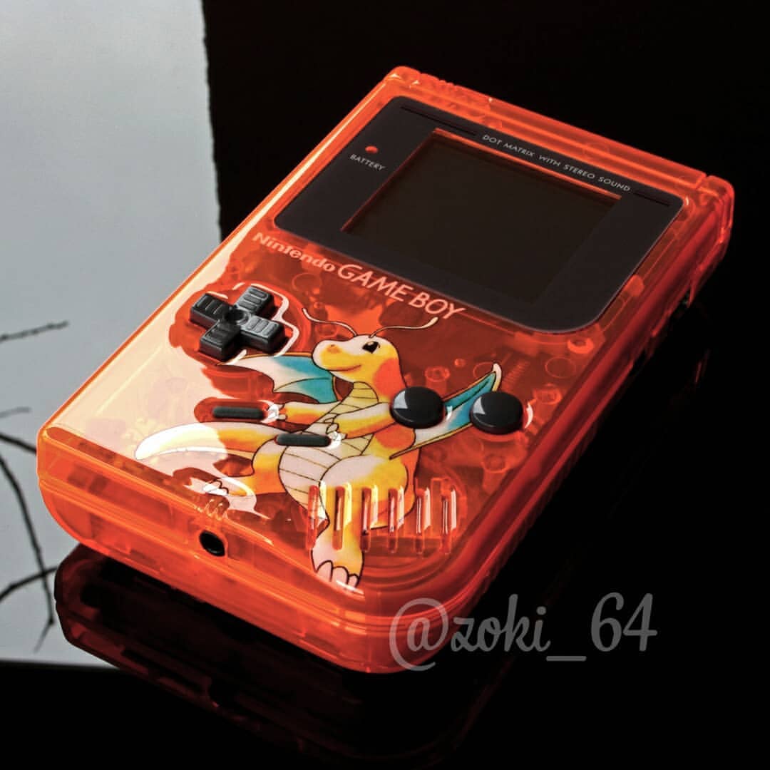

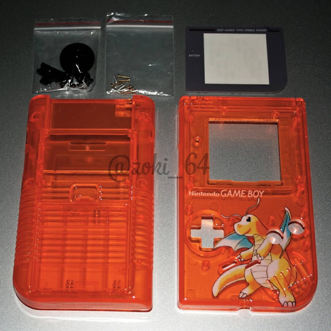

Post by AntFJ » Tue Feb 26, 2019 2:30 am
The clear shells look amazing! that is for sure.
Here is some work from Zoki64 - he does not sand them prior to spraying paint.
From my conversation with Zoki64 on etsy "Its clear plastic primer, binder/intercoat clear and topped with clear coat. Clear coat needs that for proper adhesion."
I believe he needs the intercoat/binder to help cover his artwork. If you are going straight clear you just need the adhesion promoter (plastic primer).
https://www.deviantart.com/zoki64
