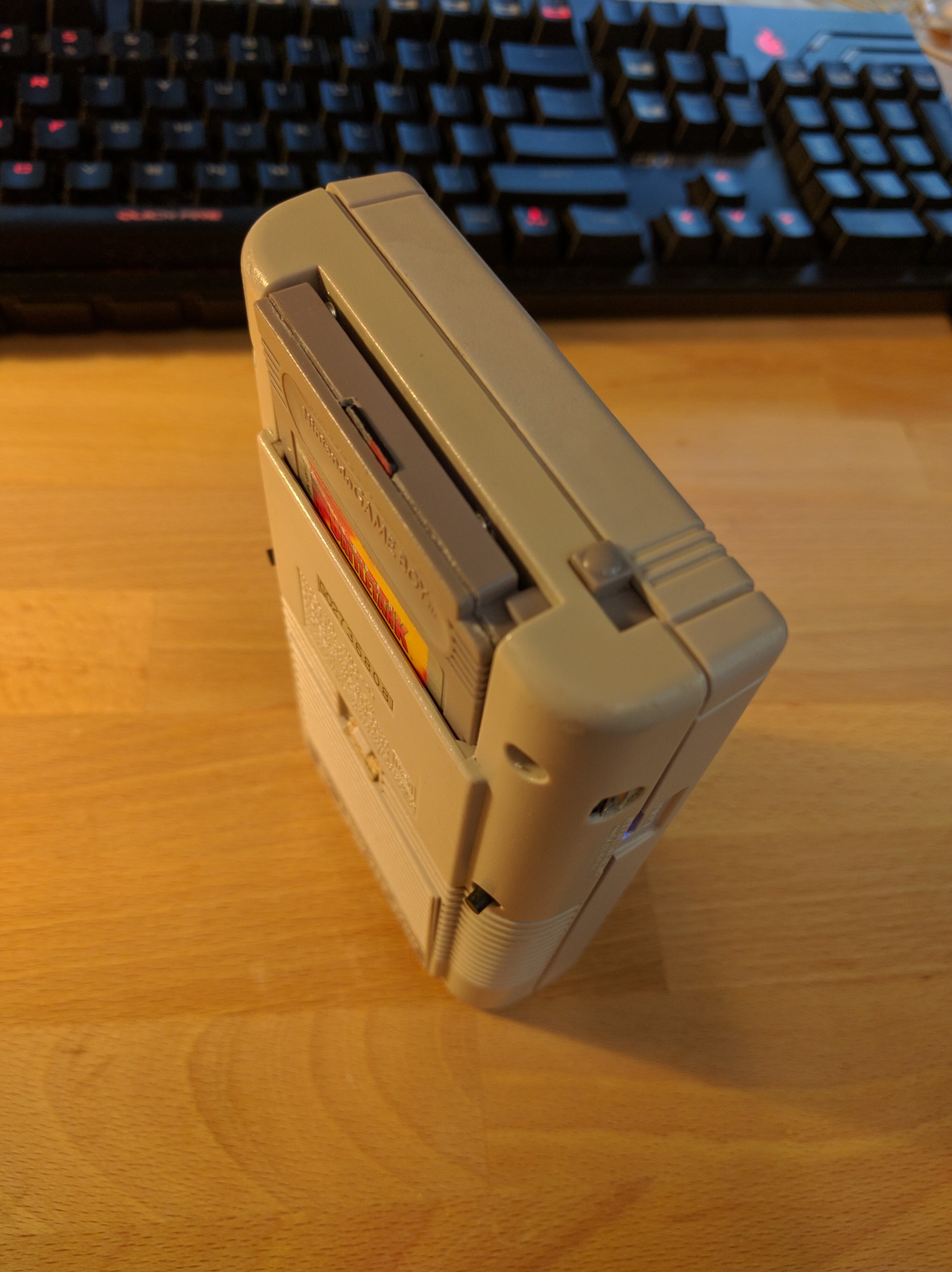

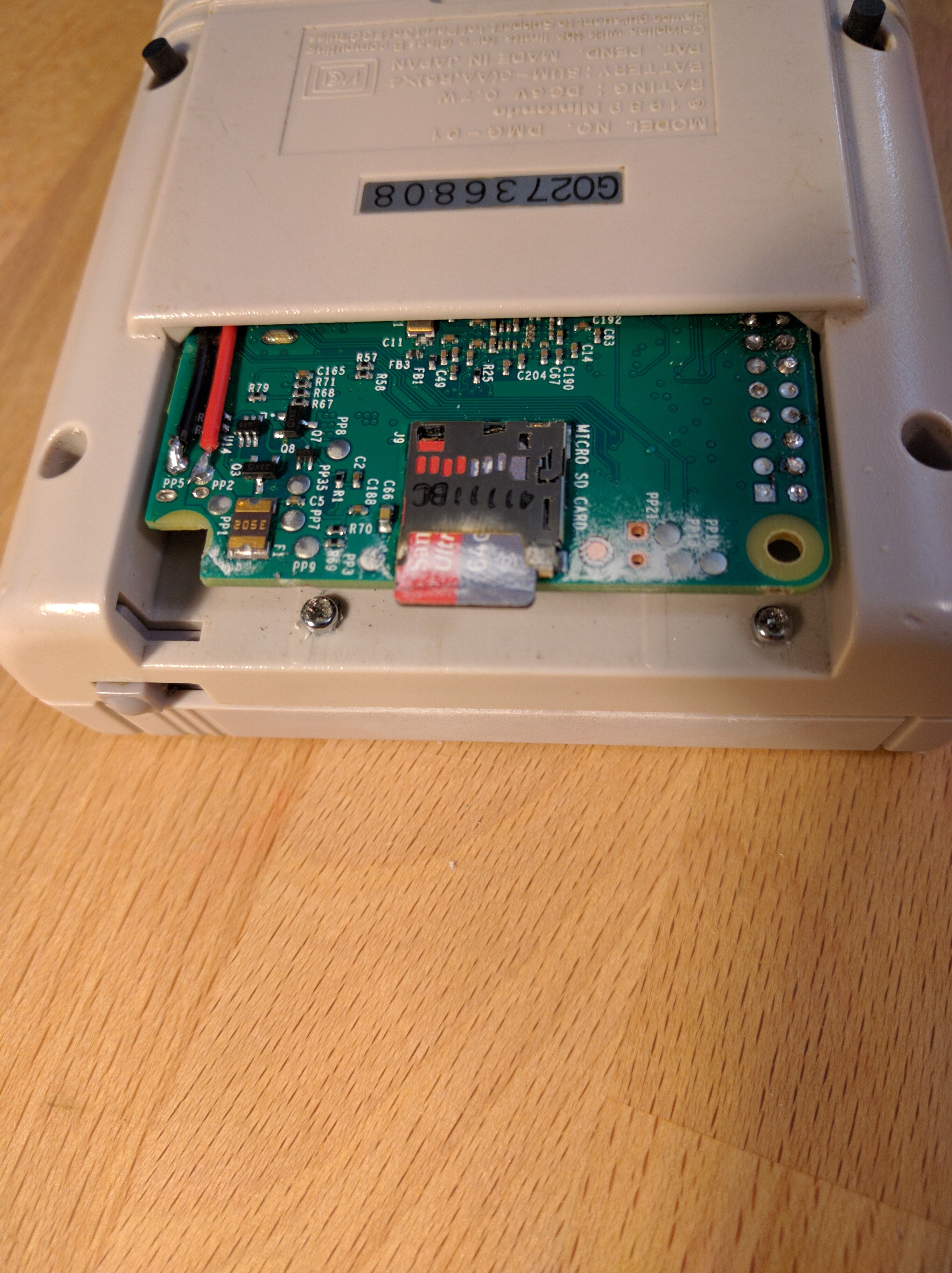

Well... I did not see anyway around it but I had to drill some holes in my poor case and I had only one change to not screw up. Because it was such a snug fit with the larger display, I decided to do two screw holes. Turned out pretty well I think.
Being very careful in drilling the holes. Used 1/16th drill bit
[spoiler="Screw Holes"]
[/spoiler]
Needed to cut some Styrene because the screw brackets are not high enough.
*I needed to use 2 cuts of .060 Thick Styrene. Seemed like the right size after testing a few times. Was a pain in the butt to cut through because the width had to be pretty small.
[spoiler=".060 thick styrene for screw brackets"]
[/spoiler]
[spoiler="Added some epoxy glue"]
[/spoiler]
[spoiler="annnnddd Added some MORE epoxy"]
[/spoiler]
[spoiler="Screwing it together, it worked"]
[/spoiler]
[spoiler="Success"]
[/spoiler]

Great solution, @dirtybeagles!
I noticed however that the cartridge isn't flat against the case due to the screw heads. You may want to use a countersink screw to make the screw head flushed against the GB case.

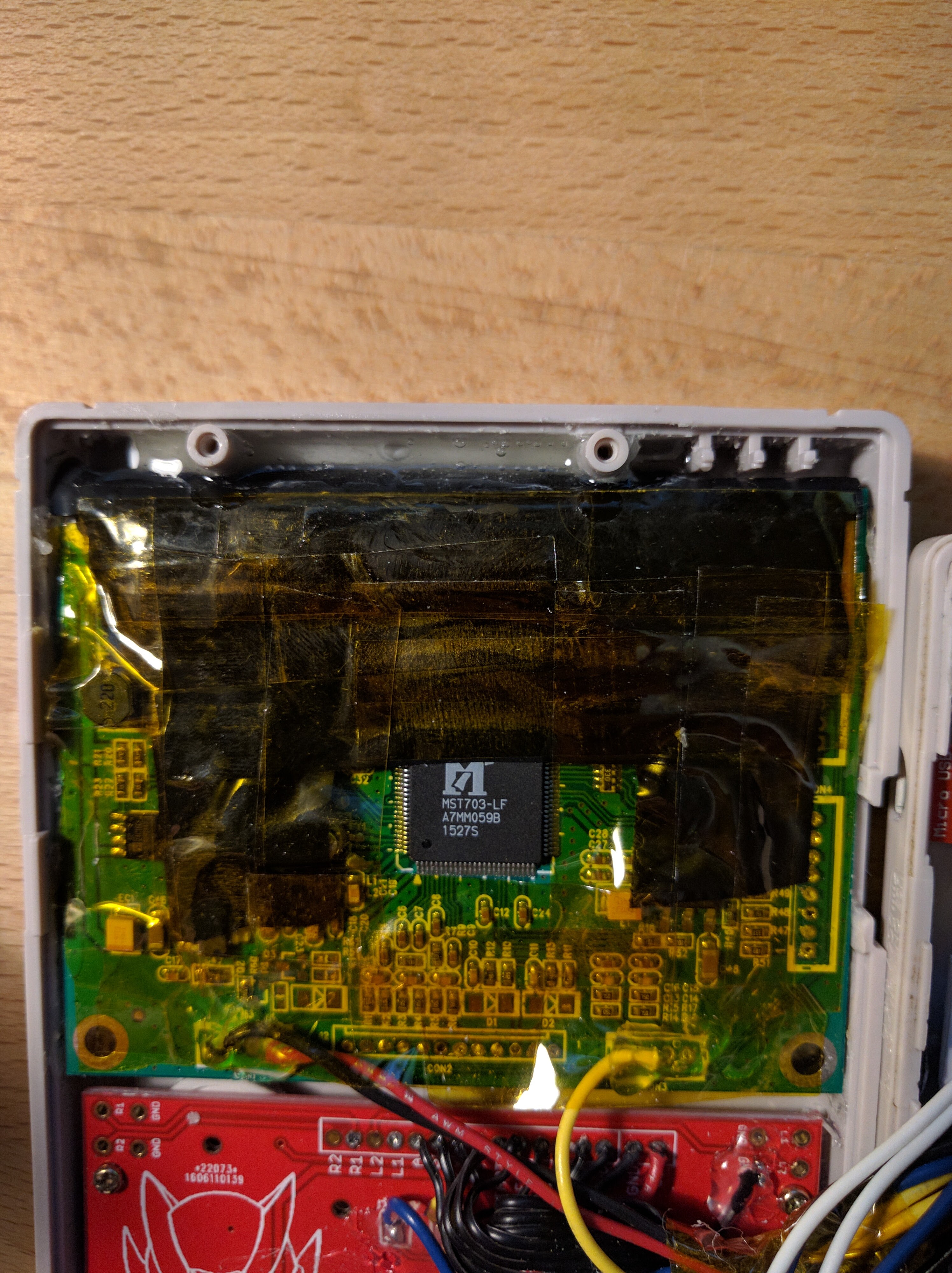

Hi,
not sure if I am right. But on your Button PCB I see you have the PWM -Mod used for getting normal audio from the PWM-outputs of the zero.
I had the same idea. can I somewhere download your Layout (or better not only the gerber file but the whole Eagly project?).
