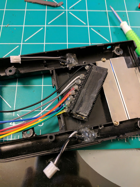

Well, its been a bit since I had some time for the project. Lately I have been modifying the cart reader, soldering that, and now I am adding all my wires to a good Pi Zero.
I did test the image I had against another Pi I have on my TV. I couldn't tell that I was missing anything. All of the games I tested were centered and none of the items were cut off the screen. When I SSH into the Pi none of the scripts run off screen either. So far so good!

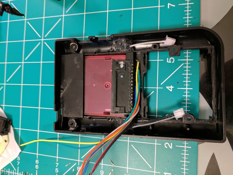

Cartridge reader modifications:
Got these from Ebay, and I am not sure, however think it is the GBA reader from a DS, the 'Cart 2' slot as he called it. Had to trim a fair bit off the sides to sneak it in there with the way I have to route the HDMI adapter.
Cart 3.jpg (104.35 KiB) Viewed 10468 times
As you can see I broke a pin off... Turns out there's a ton of extras that you can push out and move to the needed spot.

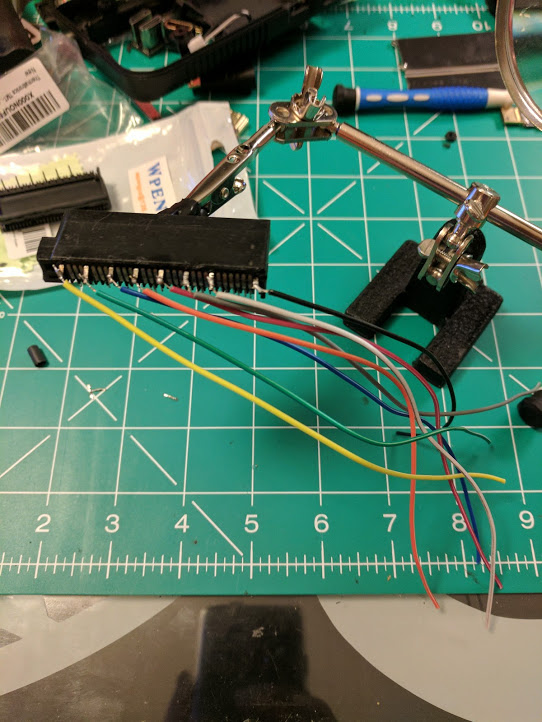

Soldered up
Cart 4.jpg (130.53 KiB) Viewed 10468 times

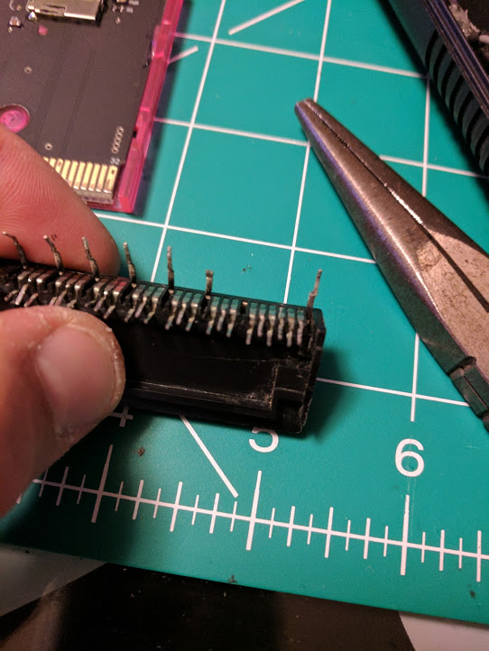

And laying in there...
Cart 5.jpg (144 KiB) Viewed 10468 times
I actually broke the reader in the photos and had to go to my back-up (Good thing I got 2!). I will snap some more photos tonight and get some more work done.

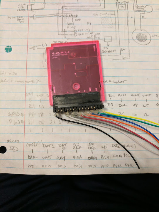

The card reader completely disintegrated so I had to make use of my spare.
Here it is with my notes visible with the PP #'s
Reader 2.jpg (91.93 KiB) Viewed 10426 times

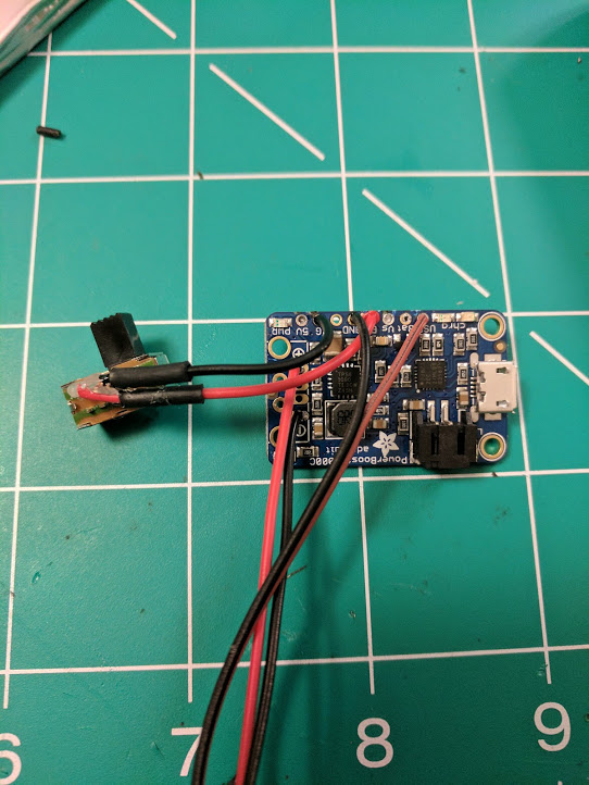

Here's the power boost all wired up with the switch
Power boost.jpg (111.27 KiB) Viewed 10426 times

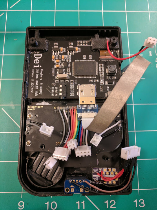

cobramike
Posts: 230
Has thanked: 55 times
Been thanked: 60 times
Re: 1st GBZ build- HDMI Screen
Post by cobramike » Wed May 24, 2017 3:51 am
Just give you a headsup. You can make the pcb smaller from the screen. Then you have more room. But for the rest a nice build. Greets Mike

cobramike
Posts: 230
Post by cobramike » Wed May 24, 2017 5:15 am
Yes when i am back home ill sent the pics. I now this because i orderd one 1up 2017HD gameboy.

He BadBert. Are you dutch!! hjaha no here are the photos
