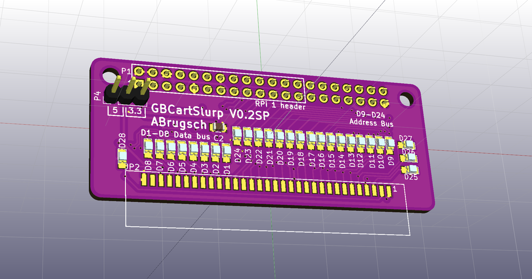

I'm in the process of converting from I2C based MCP23017 to SPI MCP23S17 chips as I've kinda hit the limit of what's doable with a PiZero and I2C, and it's about a factor of 10 too slow (compared to what a dedicated MCU can do, particularly BennVenn's Joey Joebags - which uses something like a maple mini for its core with USB to transfer the data. I had a play with one a while back and it absolutely wiped the floor with GBCartSlurp taking mere seconds to dump carts that took several minutes with mine.)
the project's not dead, just I get very little time to actually work on it. I'm converting one of my PCB's made for I2C to use SPI and then I have to re-write bits of the code to make it work... some of this will be happening tonight ;)
TBH I'm beginning to regret not using Helder's and Kite's suggestion to use an ATMega 32U4 or similar... ;) but you know, I like to do things on hard mode :lol:

I've shared the project for V0.1 on OSH park
It works but it's slow... https://oshpark.com/shared_projects/dTC1g6Jf
SPI version is all plotted out now and ordered from OSHPark so should be here in a few weeks :)

No. This is only a prototype /standalone/proof of concept. The final version will either be integrated into my own AIO or be small enough to fit in with others. As it stands it won't actually fit into a gameboy shell mainly due to all the led's which are only there for test/debug/show purposes.
Tetris takes about 10 seconds, perfect dark takes about 5 mins.
The whole joey joebags is a 3D printed shell square slightly larger than the width of the cartridge. Inside it's a maple mini mcu board with an adapter board to the cartridge port. Not very conducive to putting inside a gameboy. Also there's an issue with drivers. I don't know if there any for Linux and the access software is written python with a gui
