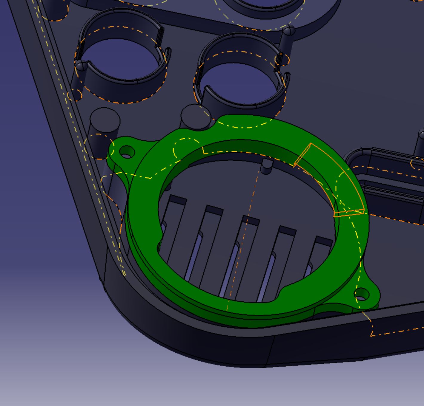

Since we opt for a modified printed case why not to integrate other mods as well to make assembly easier.
Im a friend of no glue and removable solution so I have modified the speaker area with an fixation for it that can be screwed tight.
I have added some domes to the front shell for the screws.
See the pic.
Next I want to find a way to integrate Hoolyhoo`s Screen bracket without gluing.
Since I've yet to actually build a GBZ I wasn't sure what people actually need and kept to the basics. I guess adding features for yourself might be easier than getting rid of things you don't want when things get more complicated. :D
See the pic.
Yeah, I am not a big fan of glue either. Nice idea for the speaker!
I am curious to see what you come up with for the screen!
