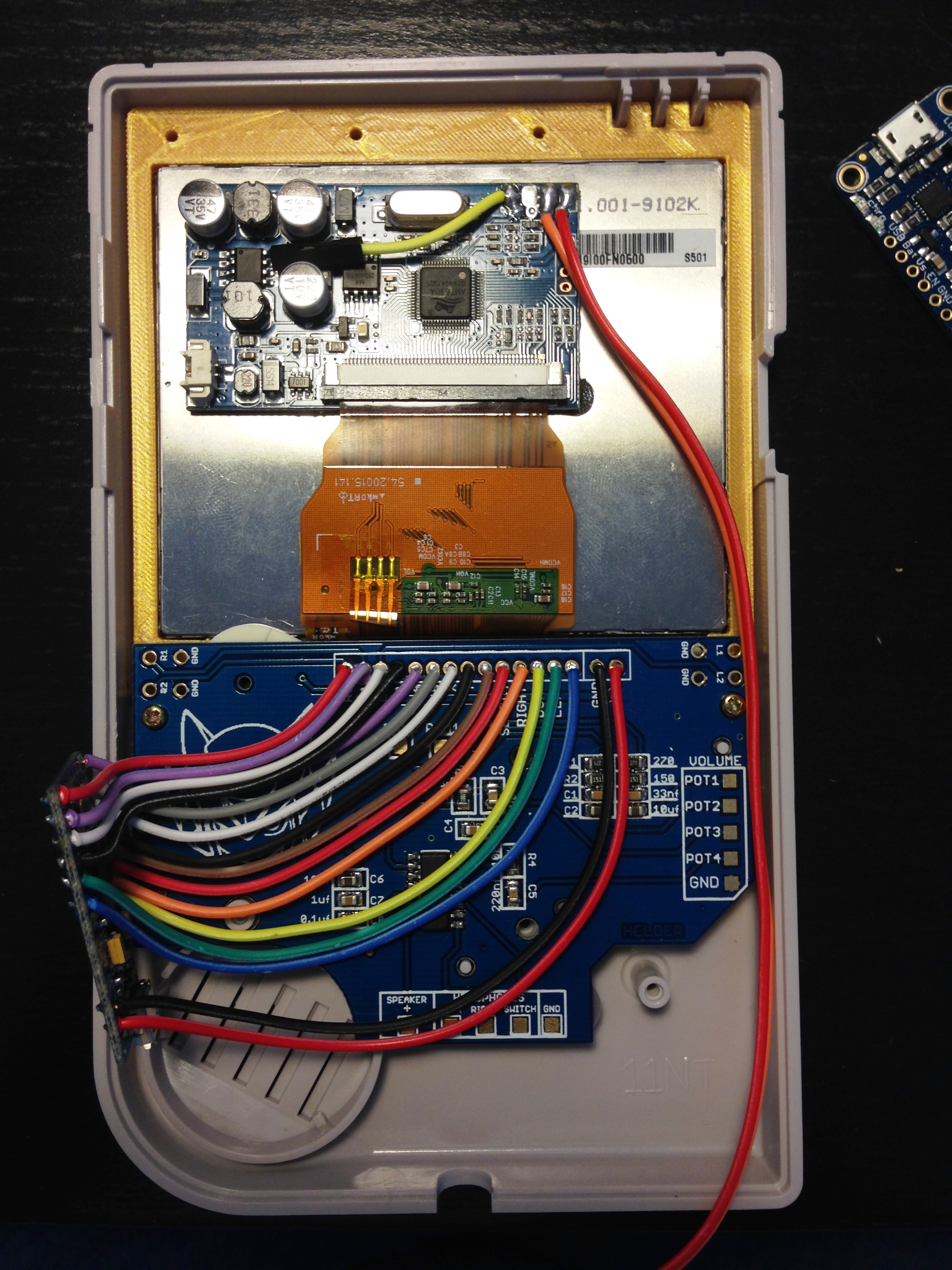

-GBZ Button PCB With Audio from Helder.
-BW 3.5 Inch TFT LCD Monitor for Car / Automobile from e-life.
-OSOYOO Pro Micro ATmega32U4 5V/16MHz
I want to use the original battery compartment so I will be using 4 NI-MH rechargeable batteries. I will have to remove them to charge them but for now I'm ok with that. That also gives me more room on the inside to organize better all the components.
I am designing my custom fitted parts and 3D-printing them. I guess I just don't like the hot glue very much :D . The project is not completed but if you are interested on those files I will be uploading them on PinShape.

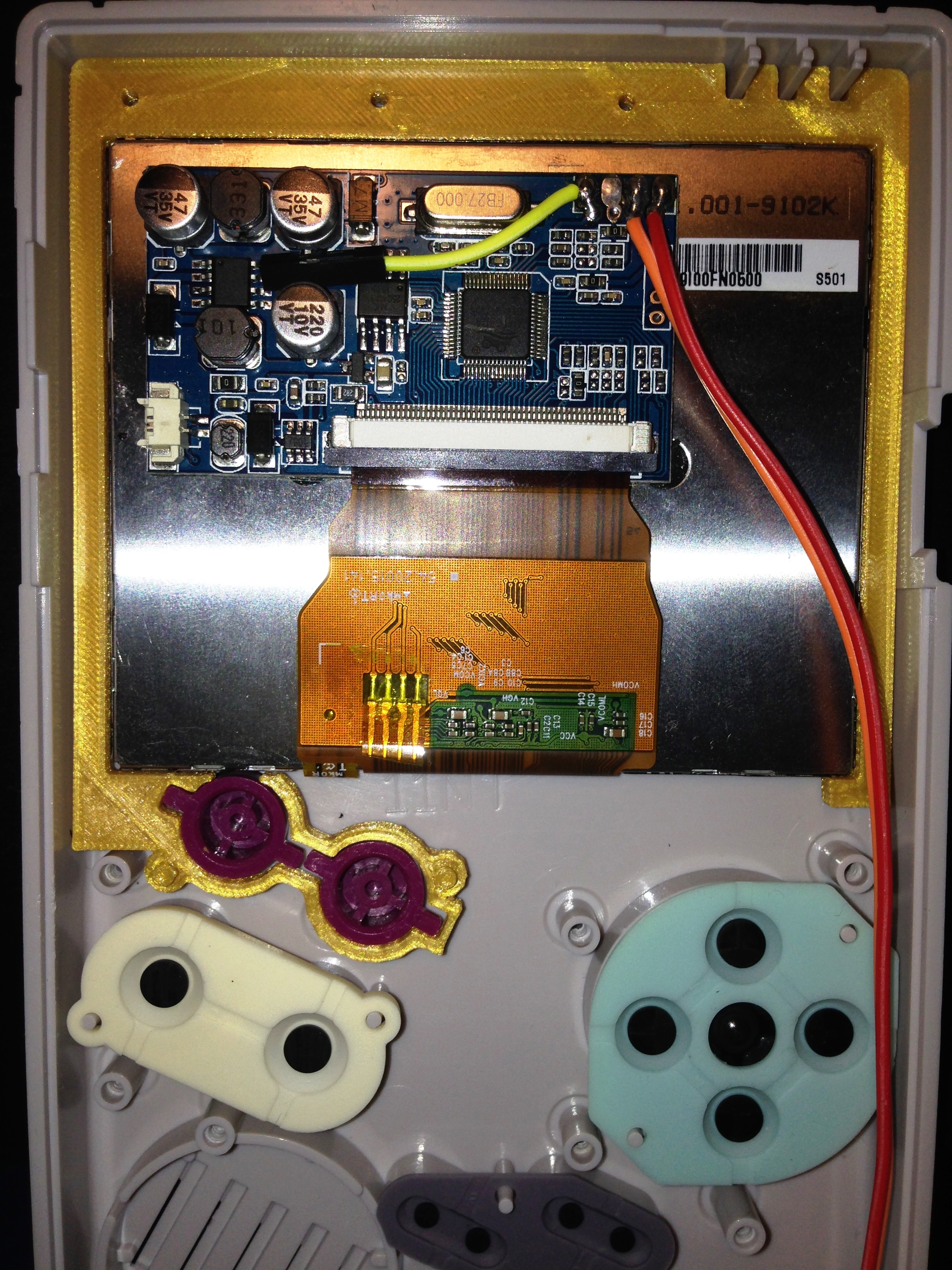

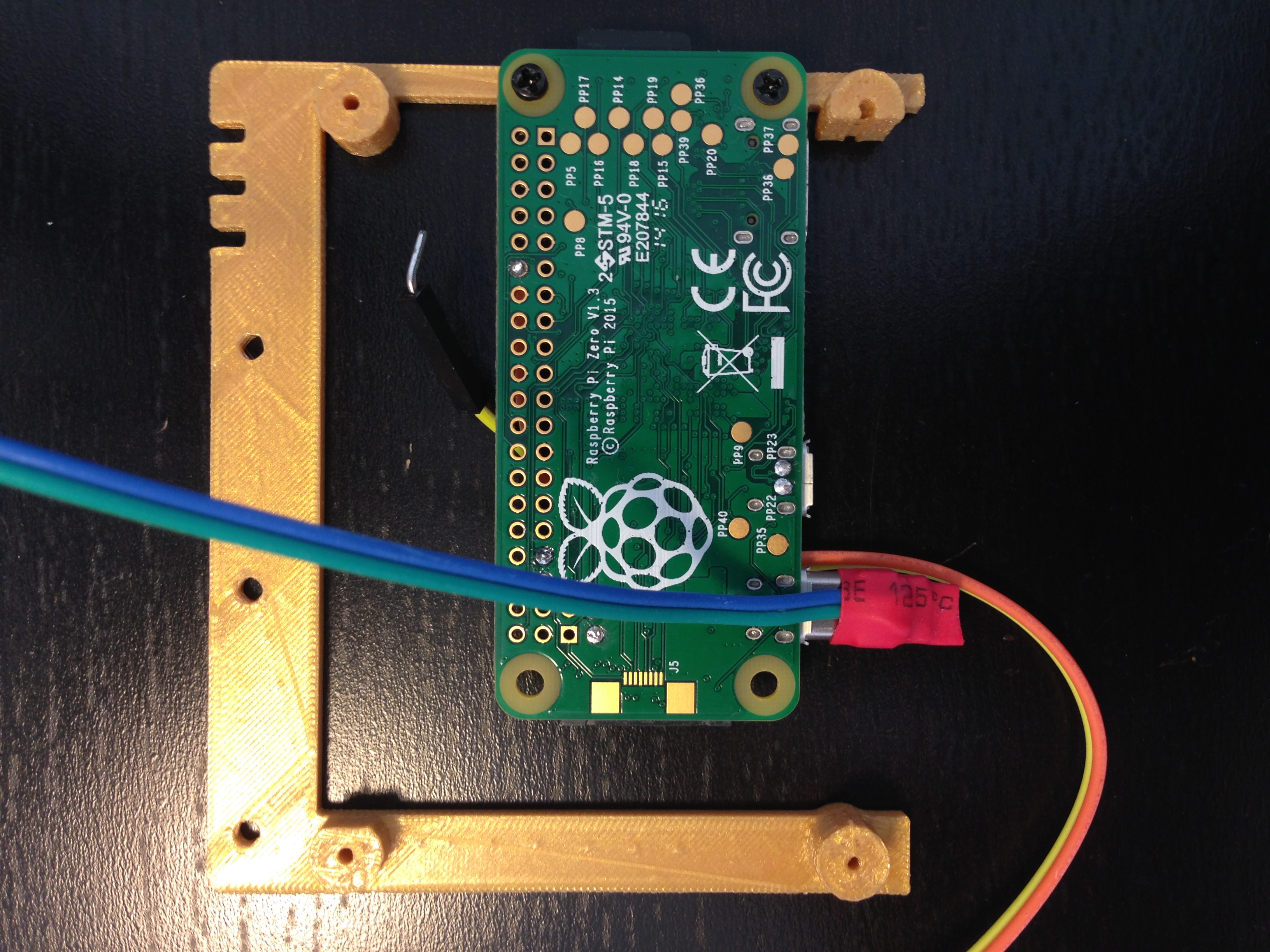

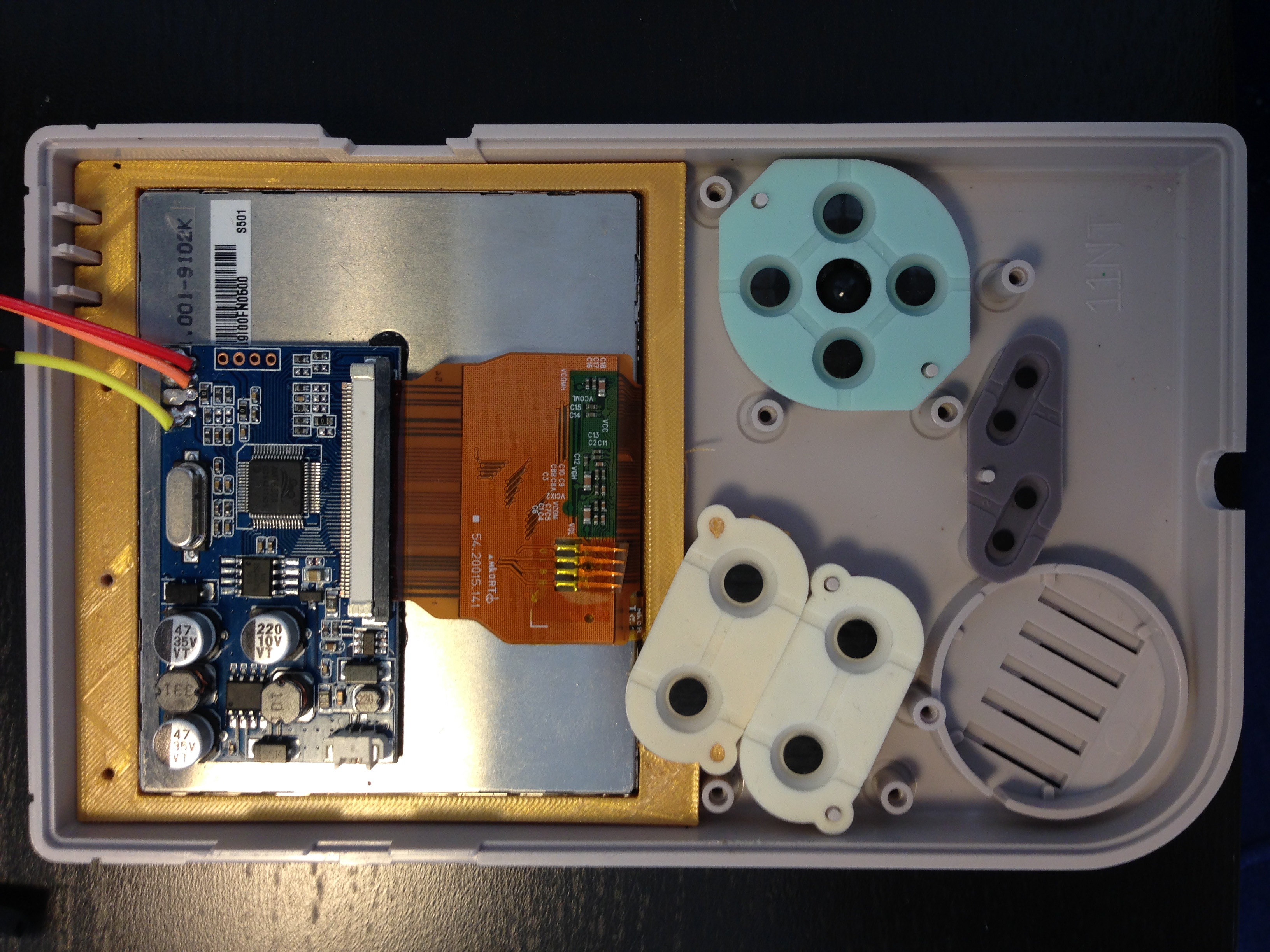

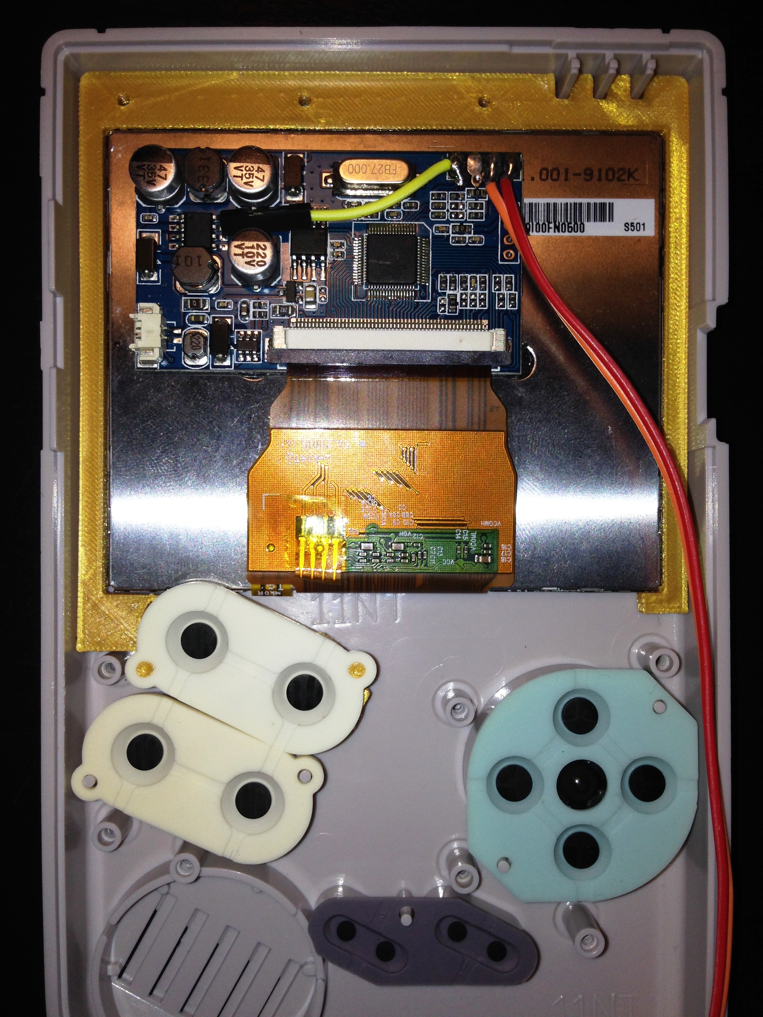

I made some changes to the screen frame to improve the stability and the feeling of the buttons. I will attach the frame to the case using epoxy. The three holes on the top I added so I could use a screw to attach the next section that will hold the raspberry pi and also includes the posts that hold the case together (and had to be cut to fit the screen).
I'm, going to reuse the PCB from the DMG to take advantage of the location of the power button and volume control. I also believe that I can modify the DMG port to fit a USB, at least until I get around to design my own on KiCAD.
I really like how tidy everything looks in there!

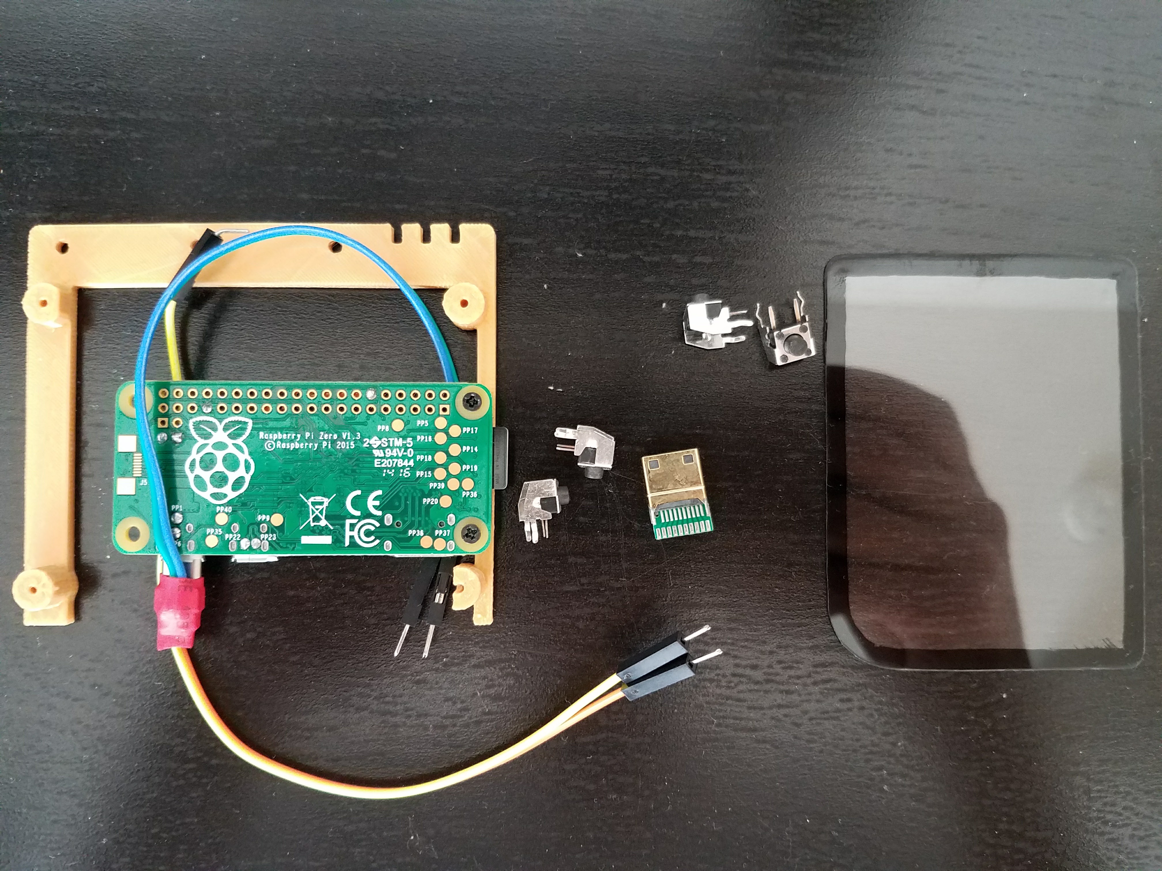

I have just received my vertical SPST throw switches and mini HDMI connectors. I also found that the plastic used for the screen protector can be bought at HOBBY LOBBY in sheets. So I cut my first try and it looks good, but since I have two sheets I believe that I have to give another try until it looks perfect!.

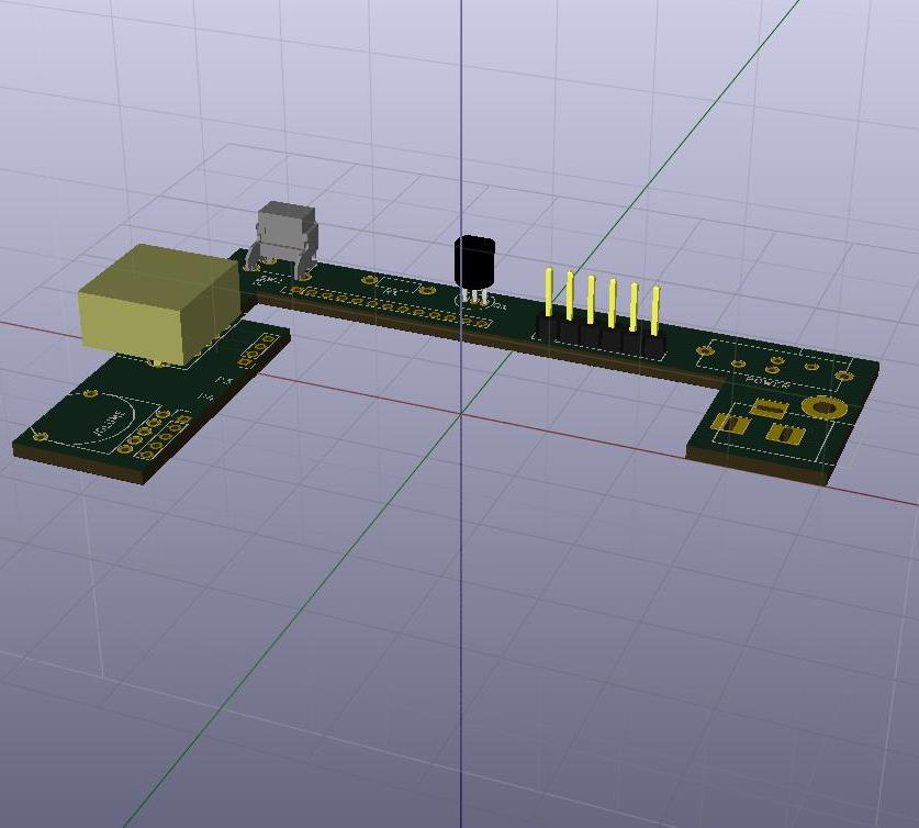

I have been working on a custom PCB that will contain the safe shutdown system with a reset button, volume potentiometer and one USB port.
As soon as I have pictures of the build I will post them.
