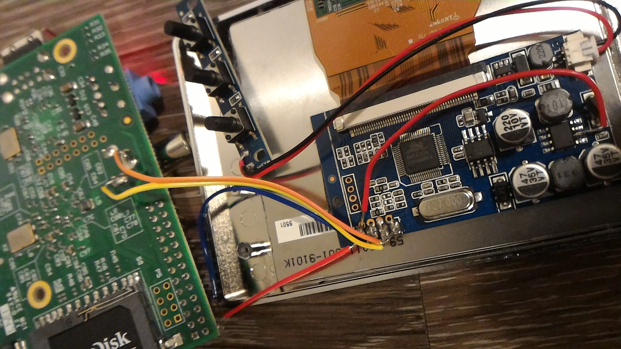

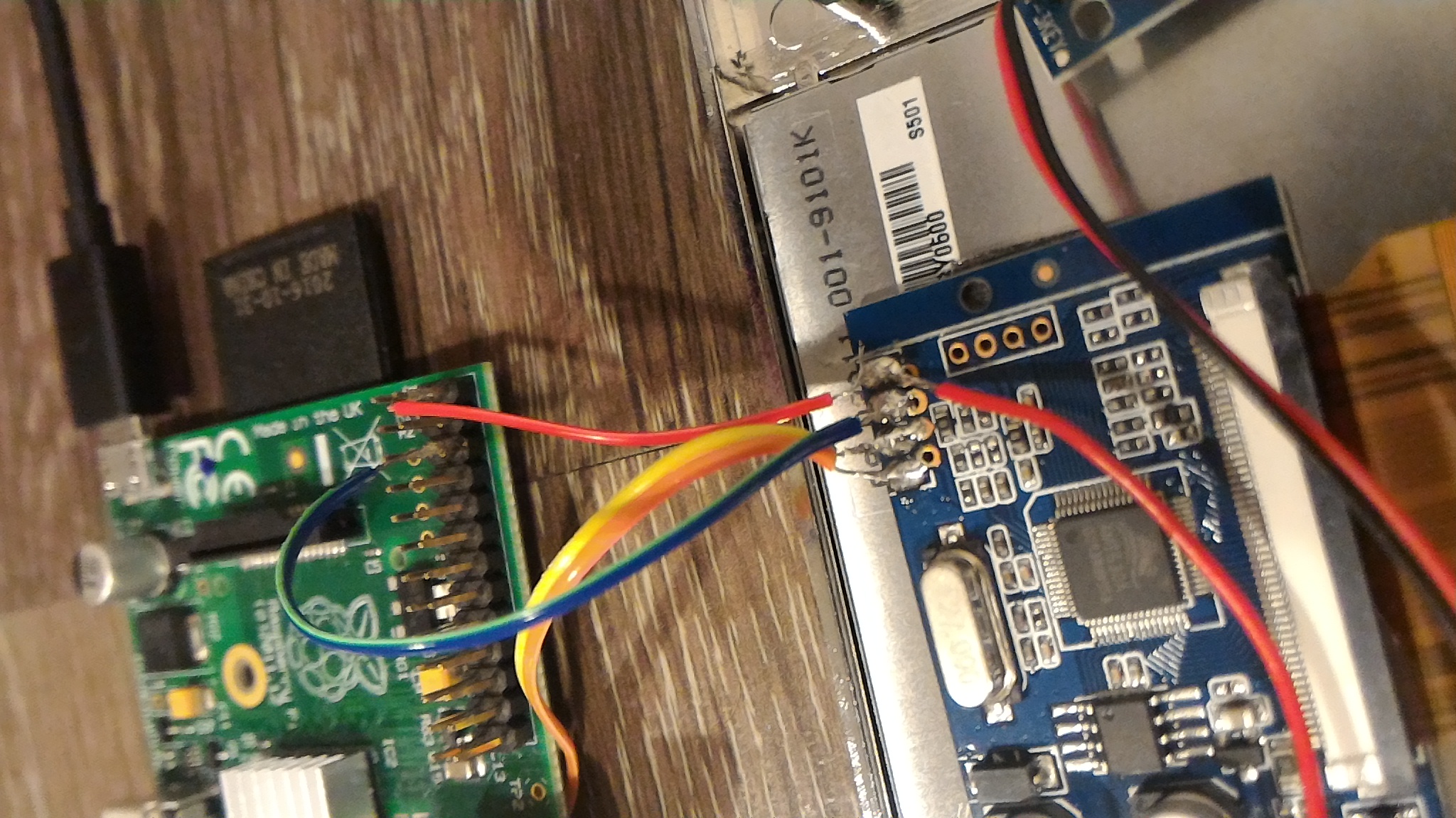

[spoiler="5V mod on the display board to reduce phasing. I used a screened primary wire as well to try and reduce interference"]Image[/spoiler]

I have the same screen, i tried to run in 5V, i did the pass to turn on 5V and don't have flickering but nothing happen with my new Rpi0.
Do you have change the code to display on the RCA component in the command line ?
