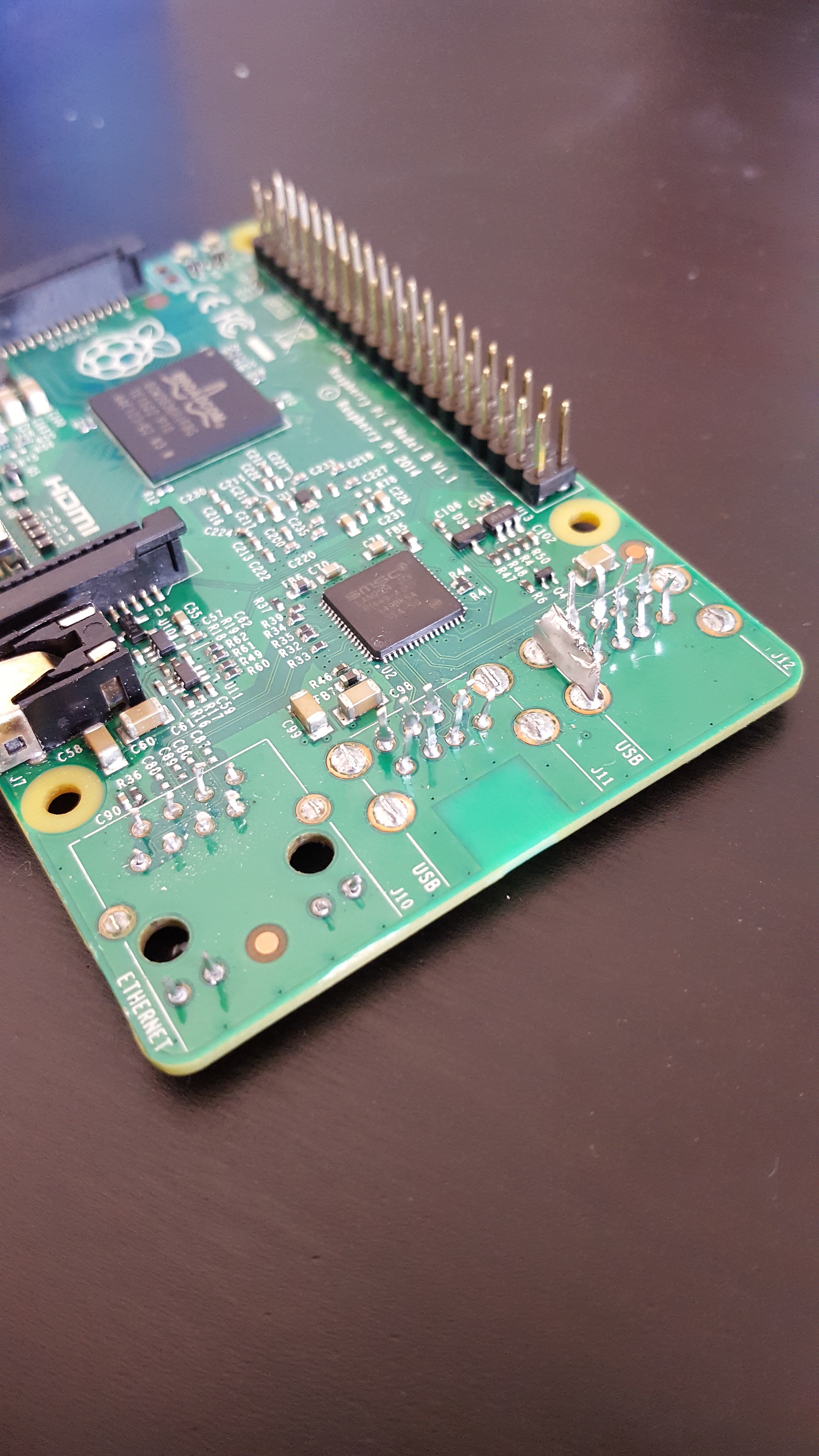

Re: My Gameboy Pi
I just used some wire cutters and hacked them up as I didn't need to keep them.
Still have the pins there, but I will desolder them properly.
Looks a bit messy at the moment, but it works fine.
You can see now the tallest part are the GPIO pins, which I will remove along with the headphone socket.

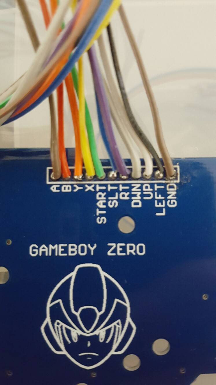

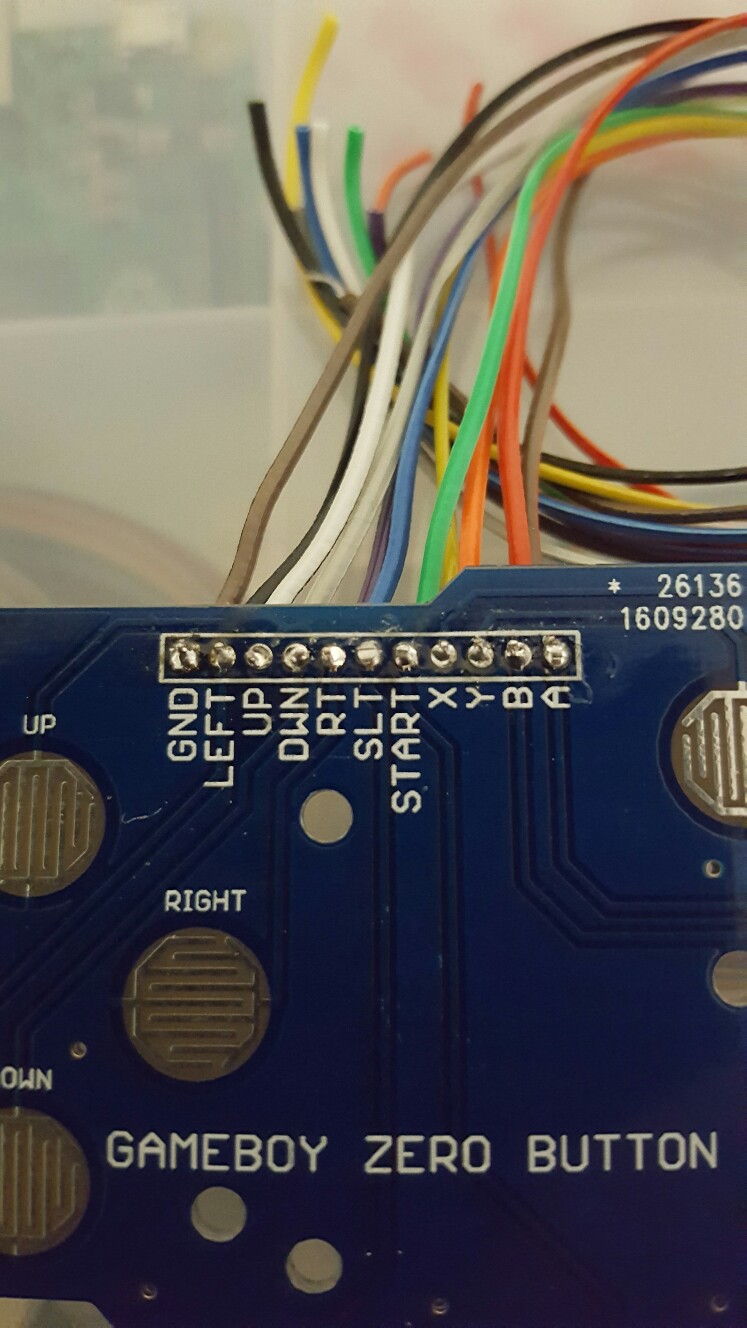

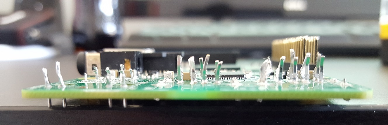

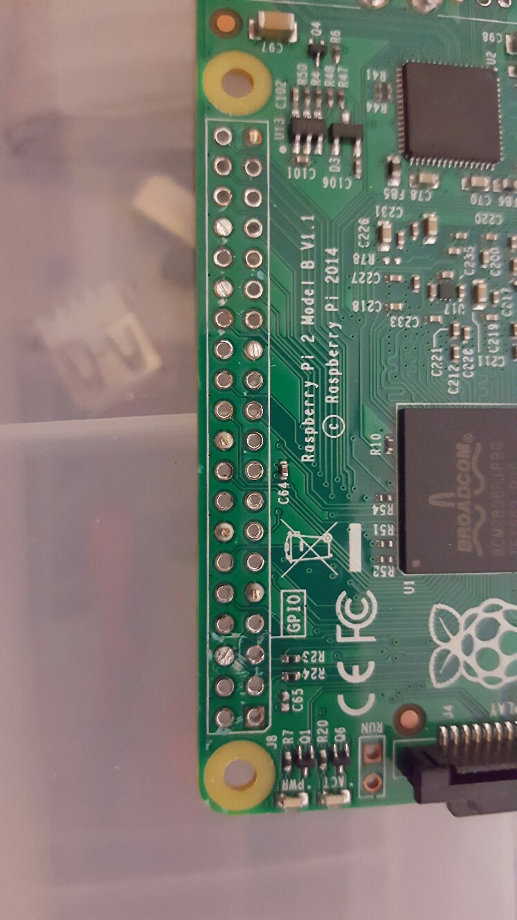

Button PCB arrived and I thought I would try soldering for the first time ever.
Also continued desoldering the Pi. Some pins seemed to be more difficult than others so I left them for now.

The difficult ones to desolder are the ground pads they will need more heat because the pads act like a heat sink, you have to keep the soldering iron on the pad longer but not too long so it doesn't destroy the pad itself, you will get their in the end
Re: My Gameboy Pi
I think I need a more powerful soldering iron for them. The one I have is 30w - 50w and I had it on the hottest temperature I could.
Will try again tomorrow and maybe buy a cheap more powerful iron.
Re: My Gameboy Pi
Just add some solder to the ones you don't manage to get off and heat the blob. You should then be able to pull the pinleftovers out easily.JoshL wrote:I think I need a more powerful soldering iron for them. The one I have is 30w - 50w and I had it on the hottest temperature I could.
Desoldered a complete rPI3 with a cheap 15W iron.
