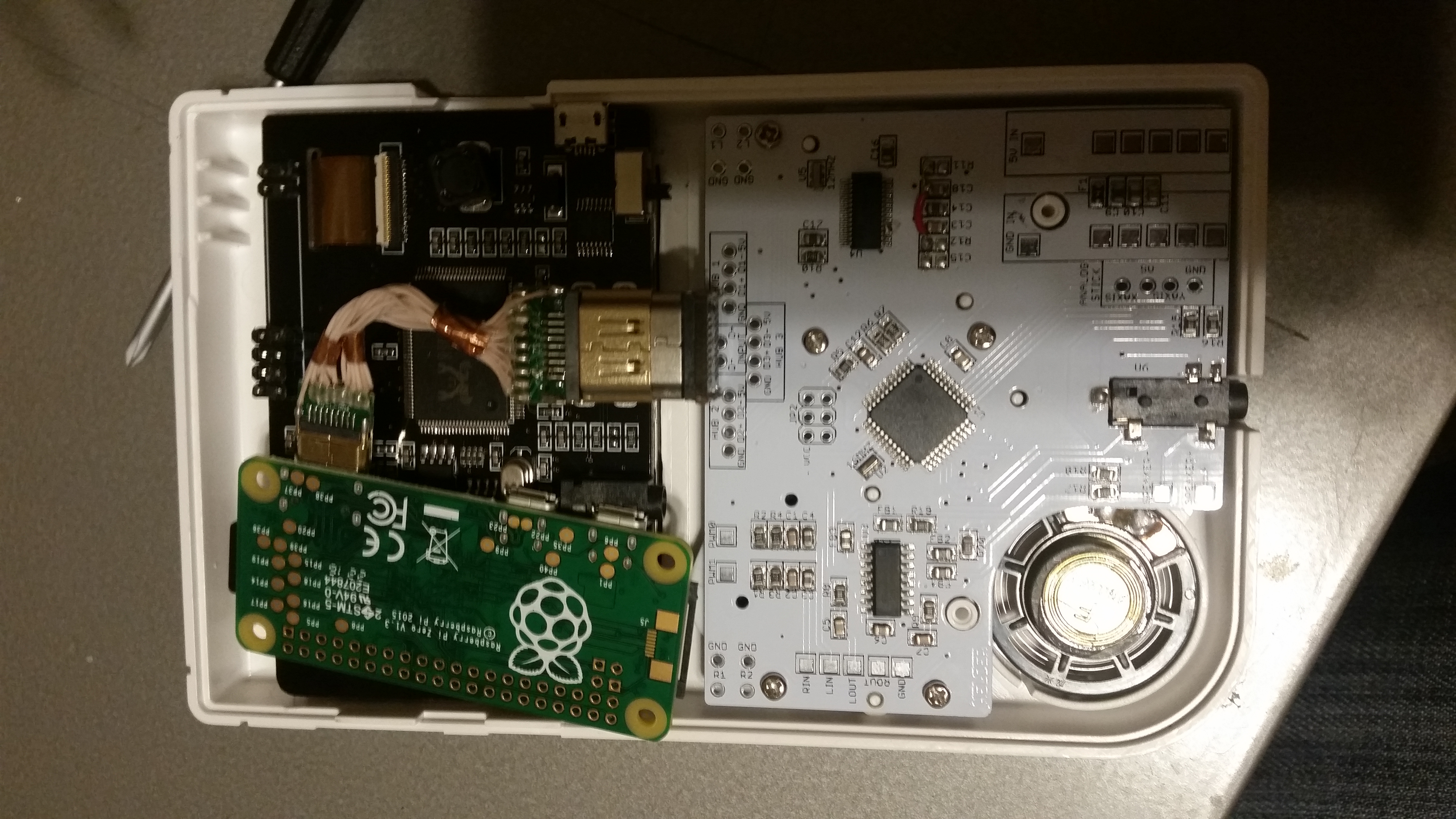

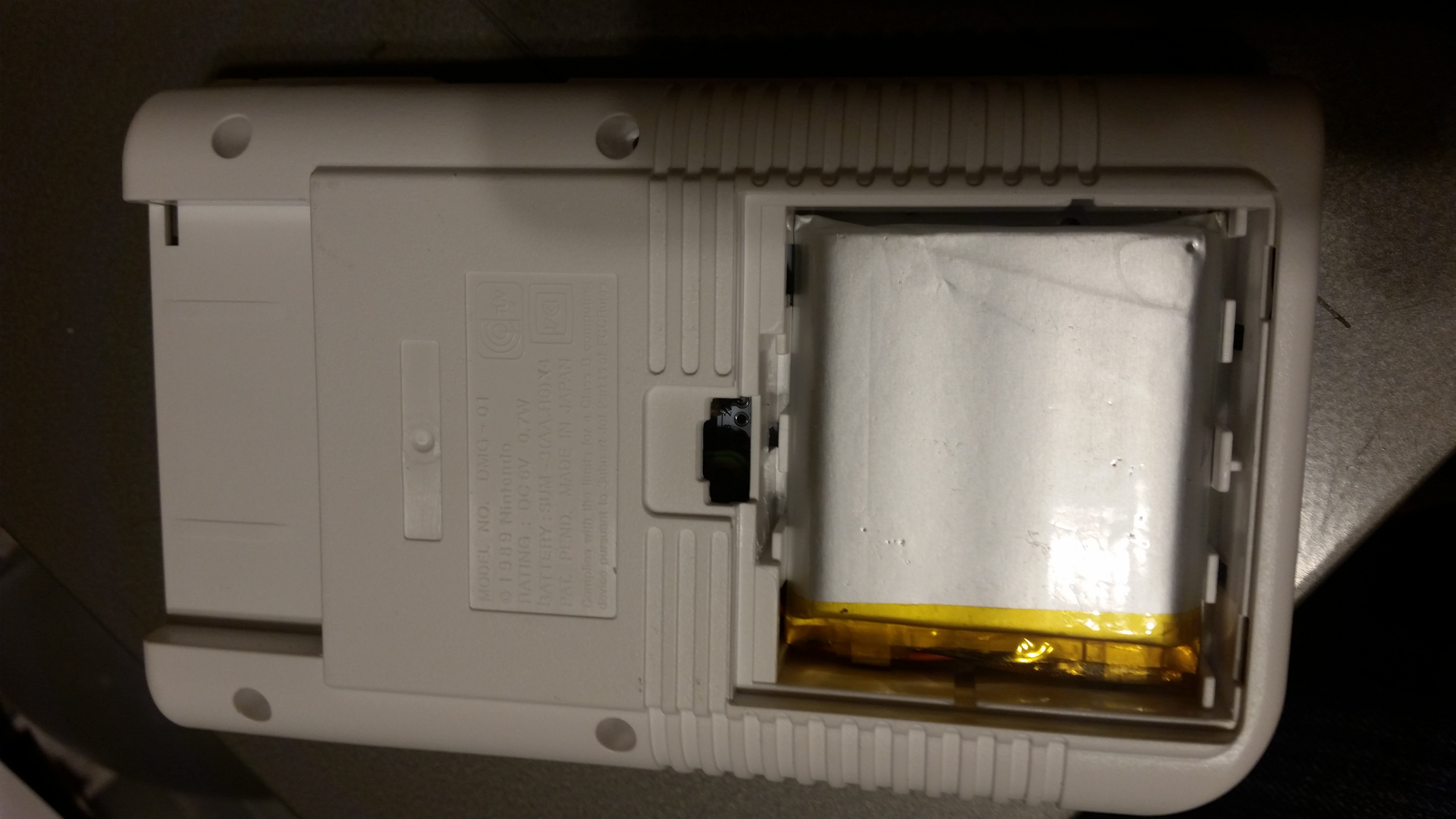

Haven't posted in a while, but over the last two days, I have been making a little progress on my Gameboy Zero. Figured out a way to cram my screen and Pi Zero in the case, while still being able to use HDMI for video output. Battery compartment will be able to remain unchopped. The sheet metal piece in the case that is up where the game slides in had to go. There just won't be room for it. I will possibly also need to hollow out a game cartridge as well, and permanently glue it in place. There are still a few other pieces I need to shoehorn in somehow.
This is a fun project.

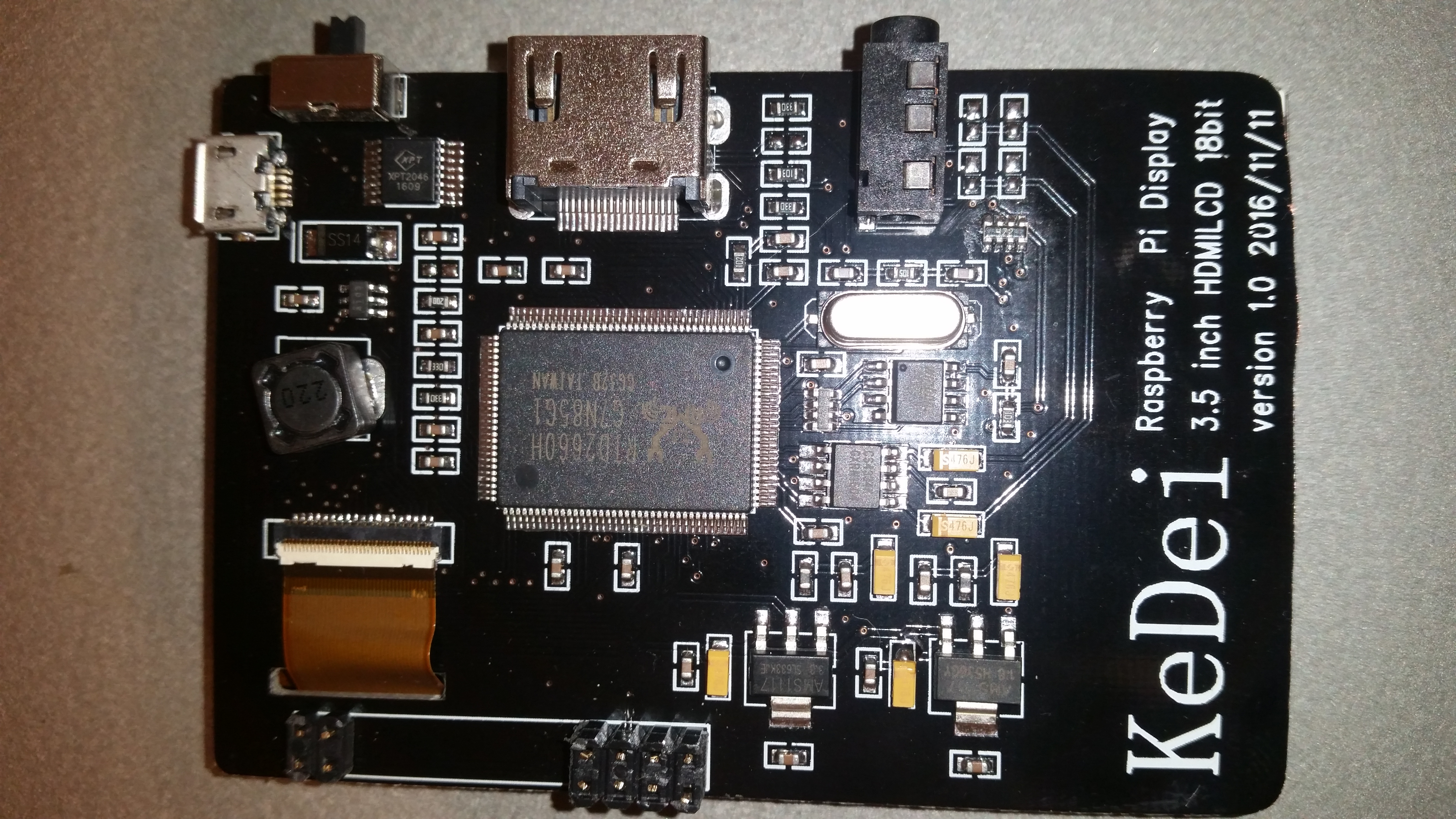

I'm still trying to figure out the best way to get power to my screen. It has a micro-USB input, but I'm not sure if that's something I can easily de-solder and attach wires to. Any suggestions?

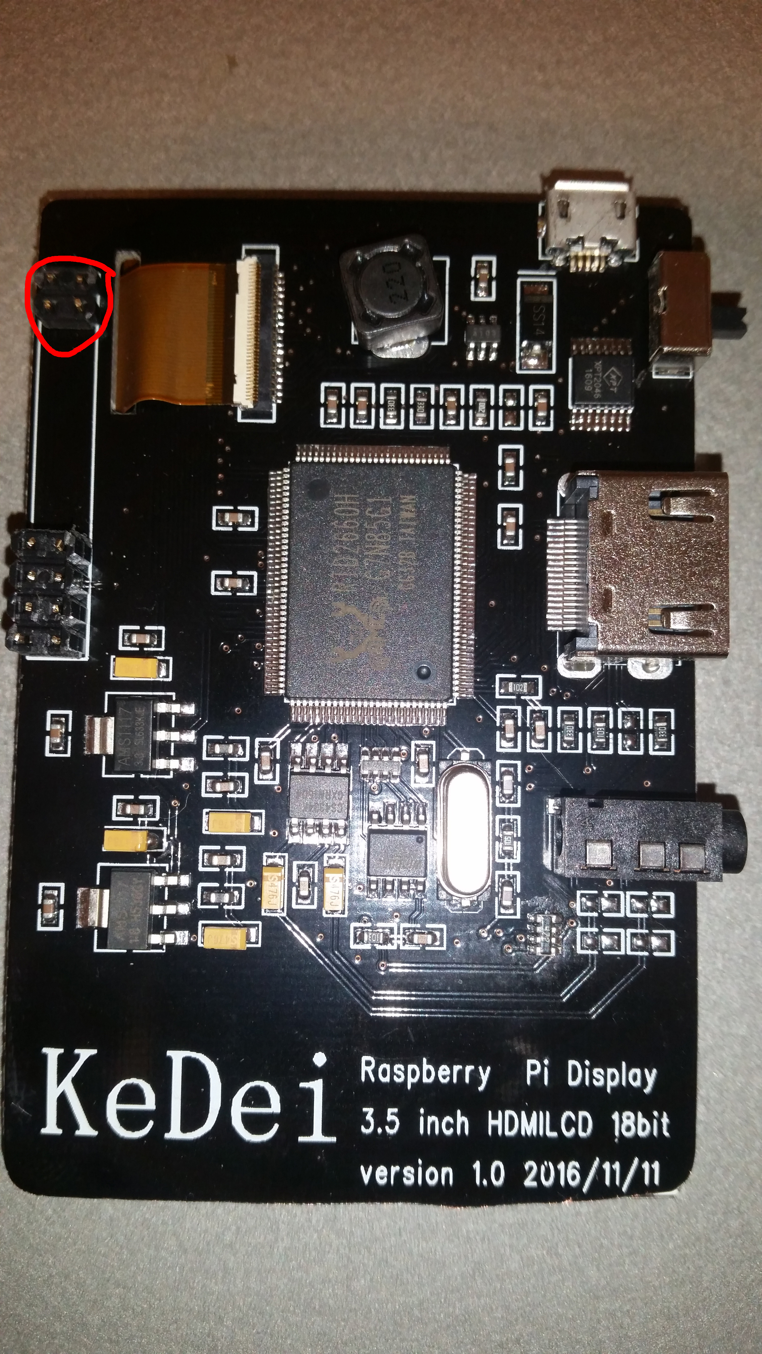

After some quick looking after posting my last reply, it looks like the mini-USB would be a pain to remove. But, there is a power switch right next to the USB that looks easier to remove. And since there will be master power for the whole GameBoy, it shouldn't need its own power switch.
gijoe4500
Posts: 22
Joined: Mon Dec 05, 2016 5:01 am
Re: GIJoe4500's First Build
Post by gijoe4500 » Mon Feb 27, 2017 8:09 pm
I'm an idiot. I can't just power to the switch. Because the switch only works 1 side of the system.

Check out these

ABH wrote:Check out these
That definitely helped! Both of those in that corner are 5v, but in the other bank of connectors, there was a ground. Rigged up some temp wiring just to make sure the screen would power on, and I had success! That's one more thing taken care of.

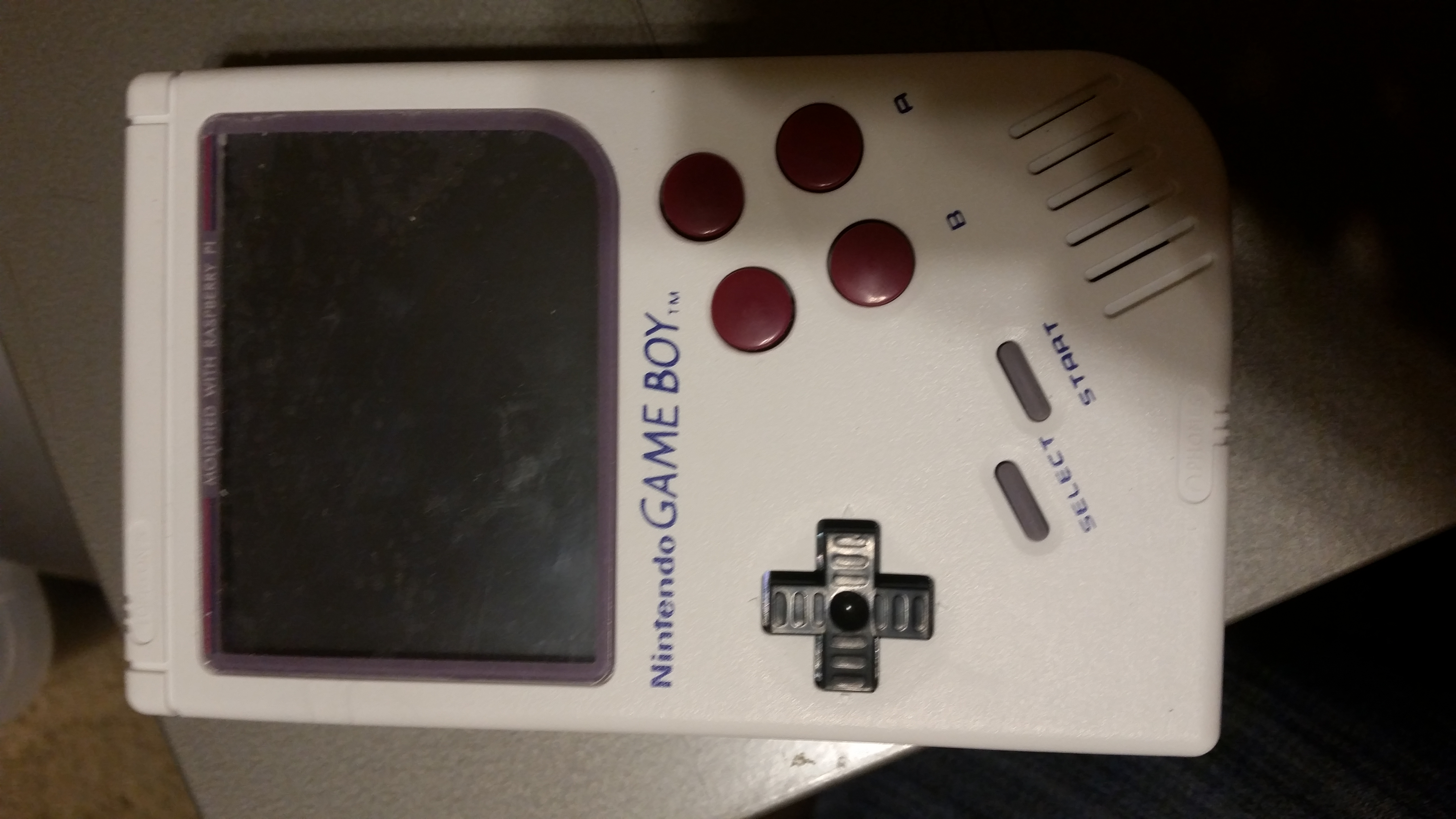

Everything actually fits pretty nicely! I was presently surprised. I'm hoping that all of my case modifications are done, aside from the L+R button holes.
