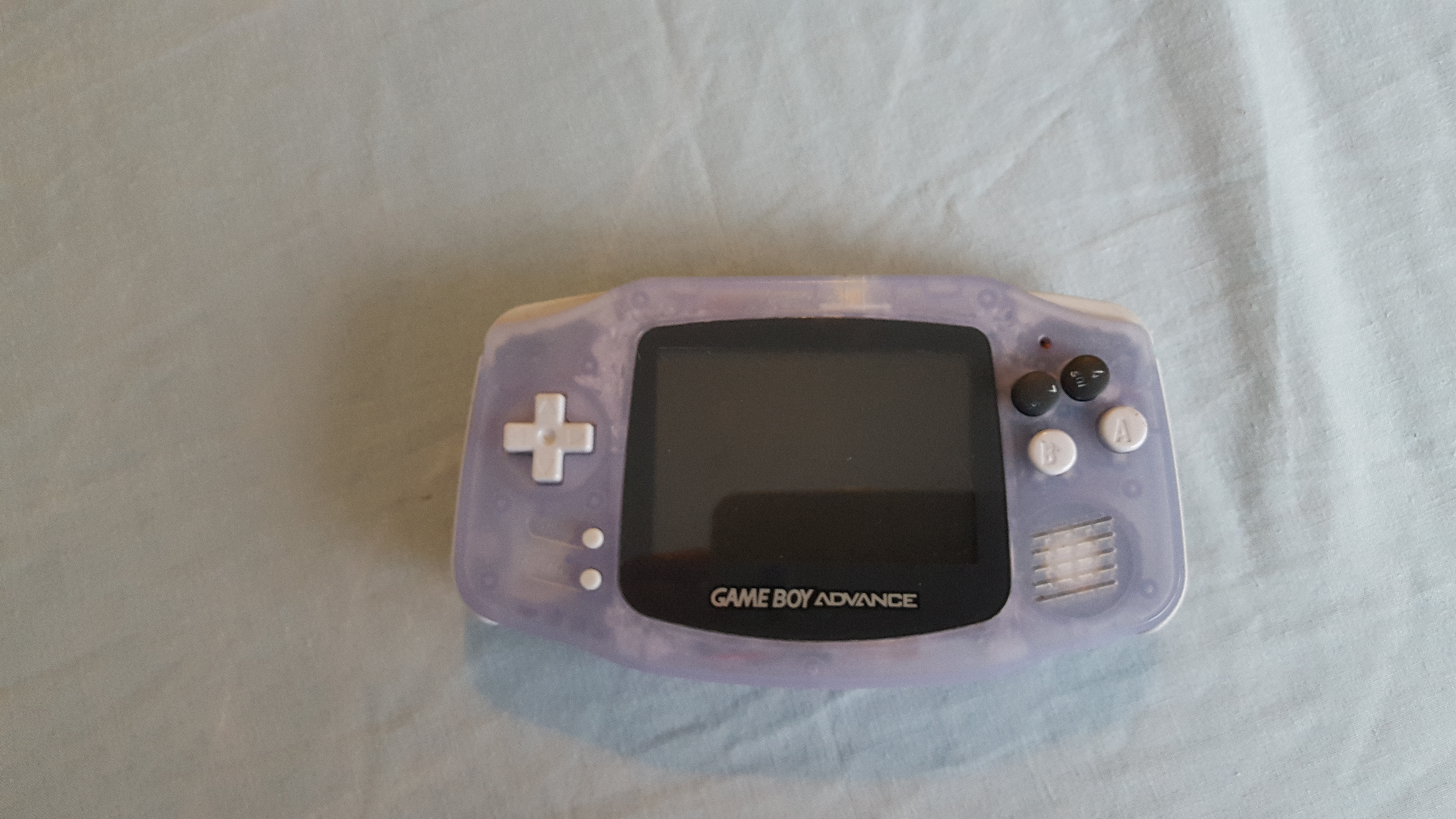

Here is my gameboy advance zero. This is my first show off (didnt bother showing my gameboy zero, looked the same as everyone elses)
After finally completing the @wermy build i decided this was next.
while collecting parts I got an old gameboy advance and always loved the feel of it so knew I had to fit it all in there somehow and make it my second build.
It has a 3.5" screen (banggood). I was split between cutting the front to have the full size screen or using the original bezel. Because it looks so good had to go down the original bezel look.
Added the x and y buttons. These are actually buttons from an old sky tv remote, due to the length they were perfect, if anything they need triming (on my to do list)

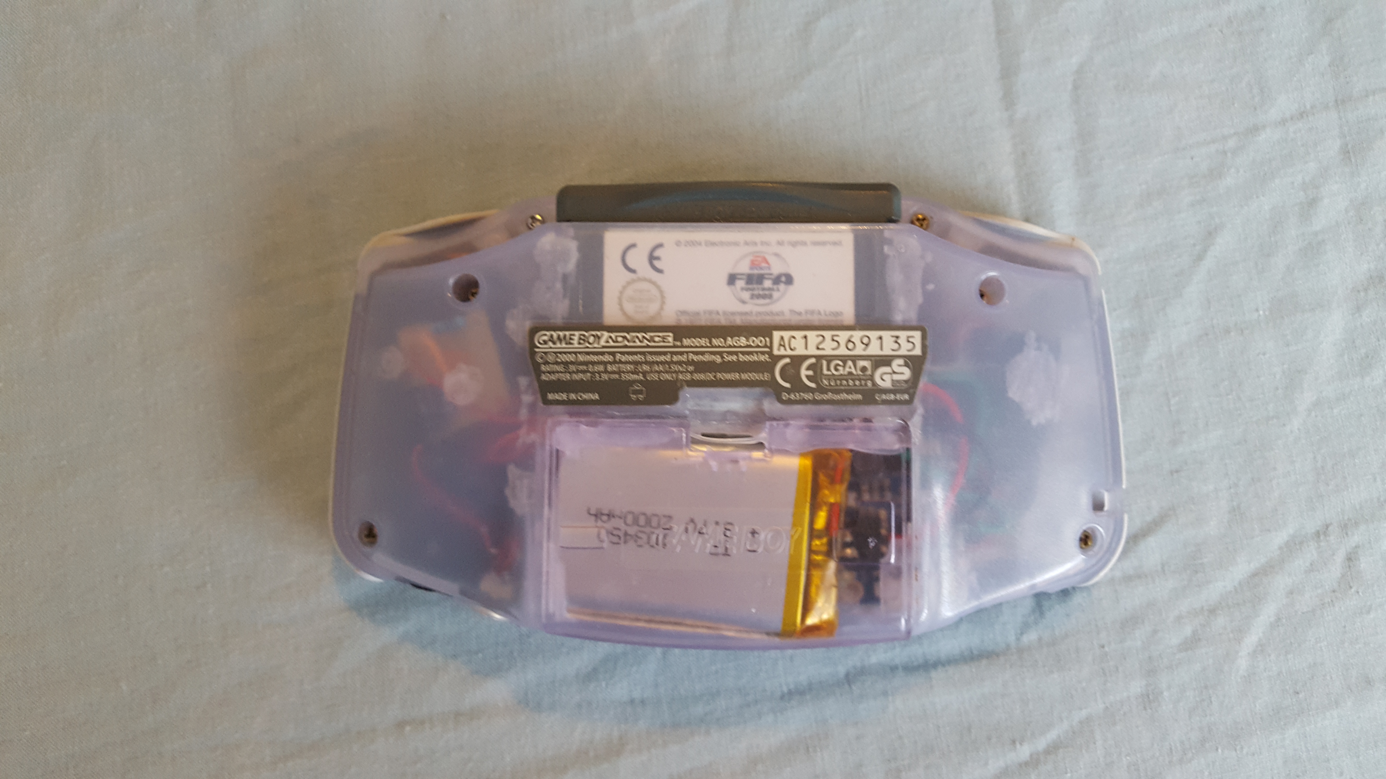

Has a 2000mah battery, powerboost 1000c. Currently have this running constant to see if it gets overly hot as battery is sitting right next to powerboost so need to monitor this.

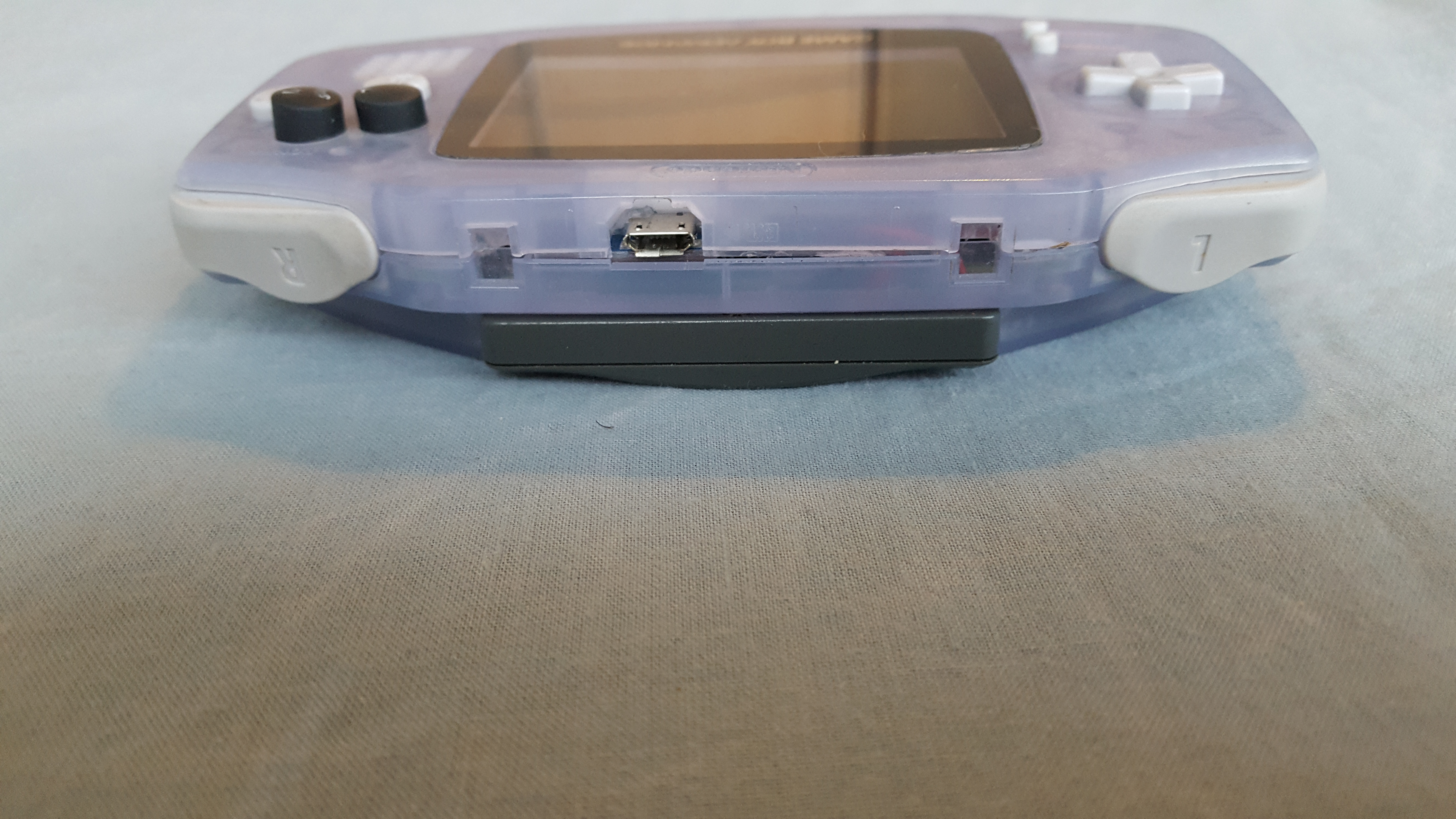

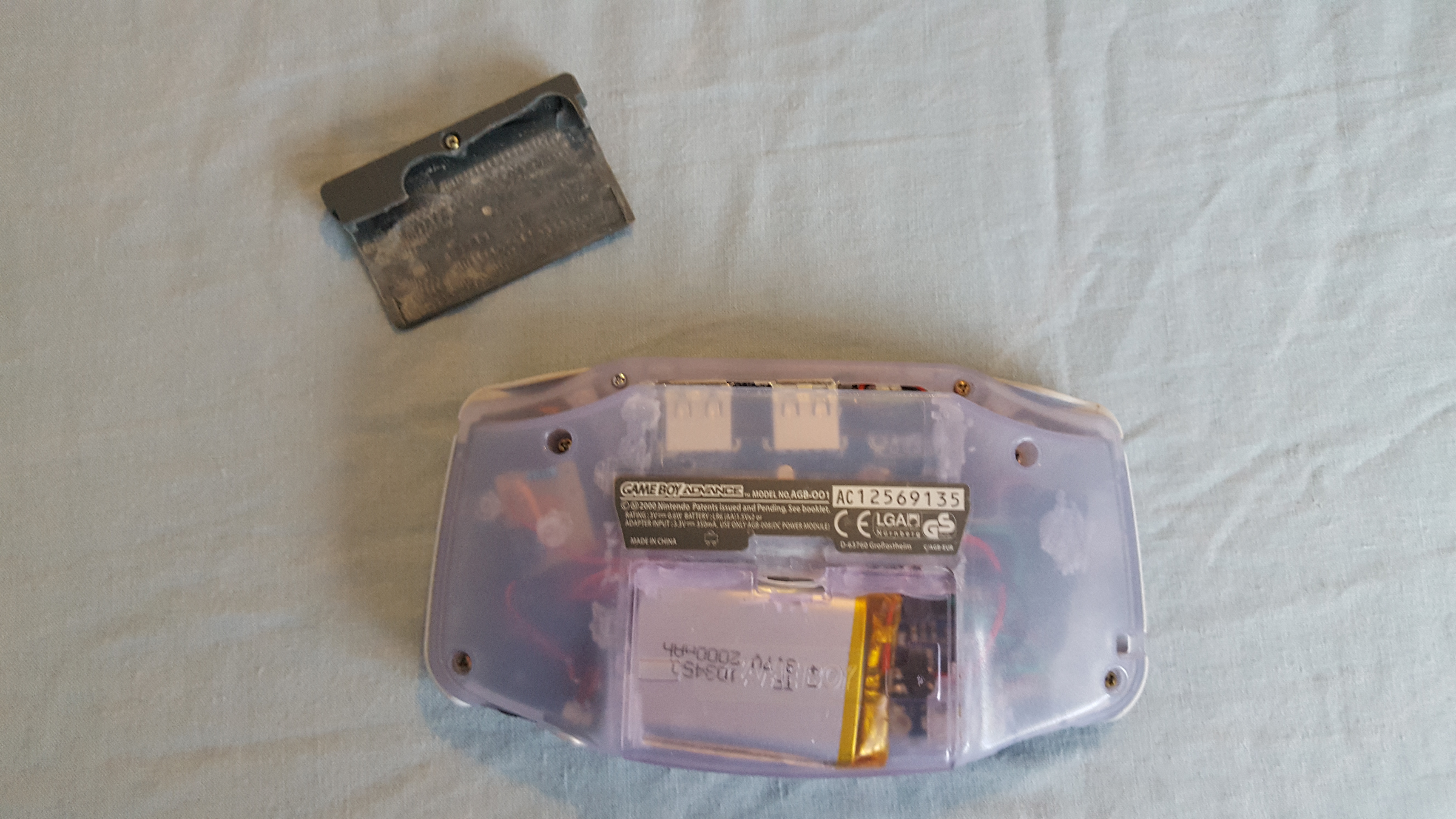

I have used the slot for the game cart for the access to the Usbs and I have hollowed out an old game cartridge (thanks Fifa) to cover it to make it look original, this just slides on and off.
The only extra external item added is the micro usb for charging. This is at the top where the original connection was (think the old charging port)
The Gameboy didnt come with a battery cover so had to order a replacement on ebay, was sent the wrong colour so got it for free :)
It didnt fit with the clip so had to break that off and glue on. Do not intend to move the battery so not an issue!

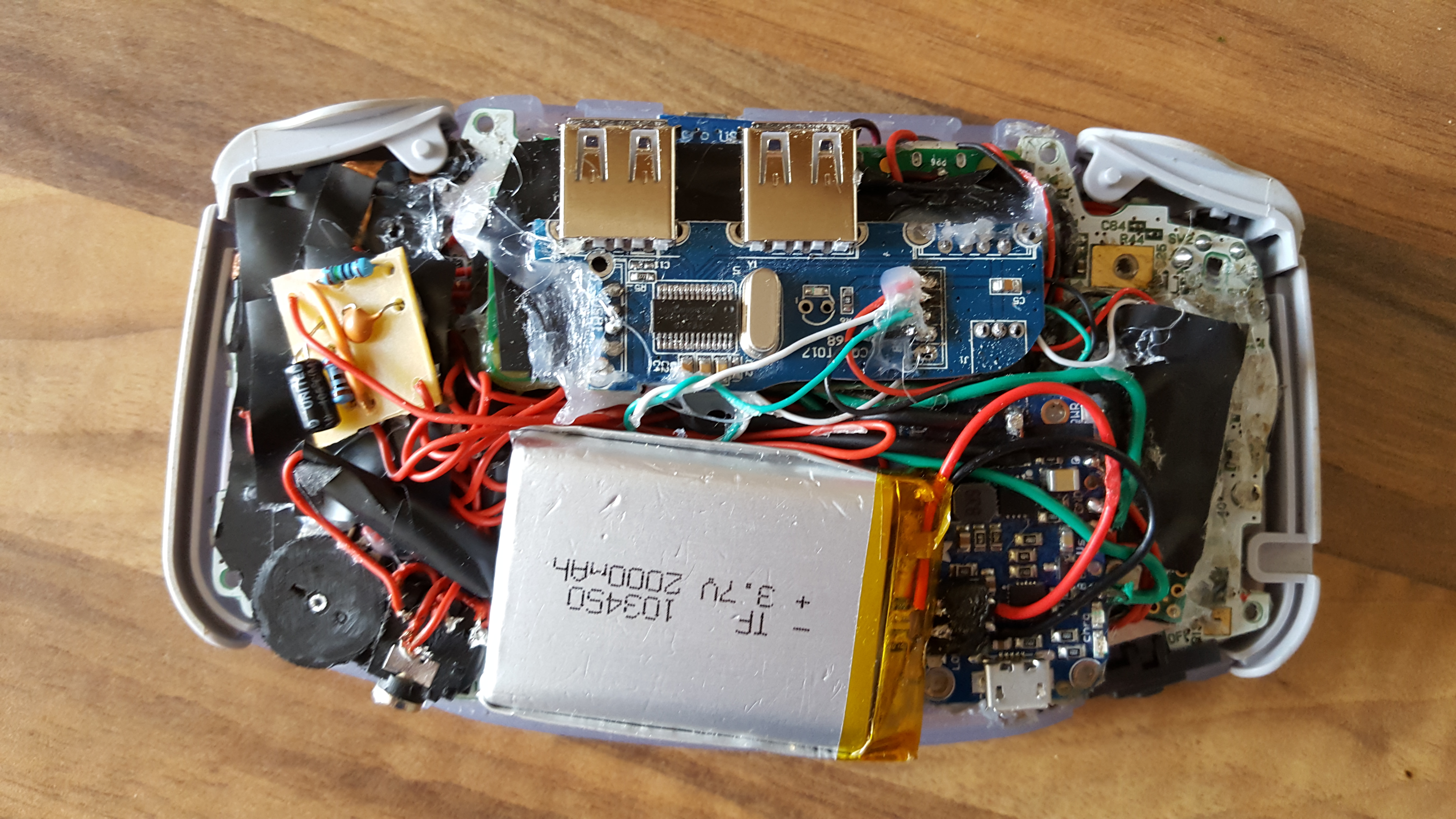

Good job there. Any pics of the inside?

I never expected it to close first time so I actually need to open it to put a bigger memory card in so will take some pics and get them on, it is hard to see though as most parts are on top of each other!

Post by Lpoolm » Tue Feb 14, 2017 3:24 am
few pics below of the internals.
