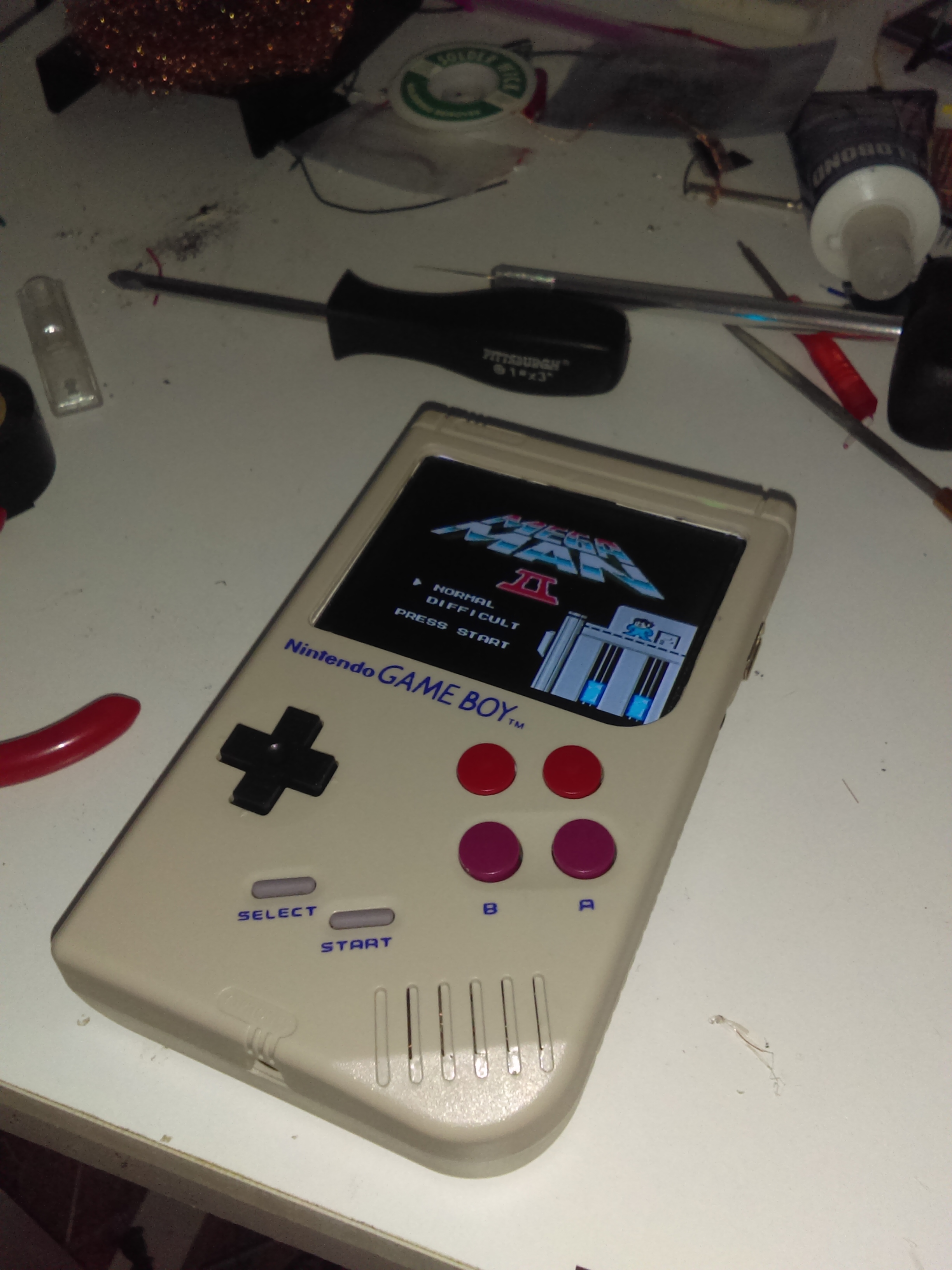

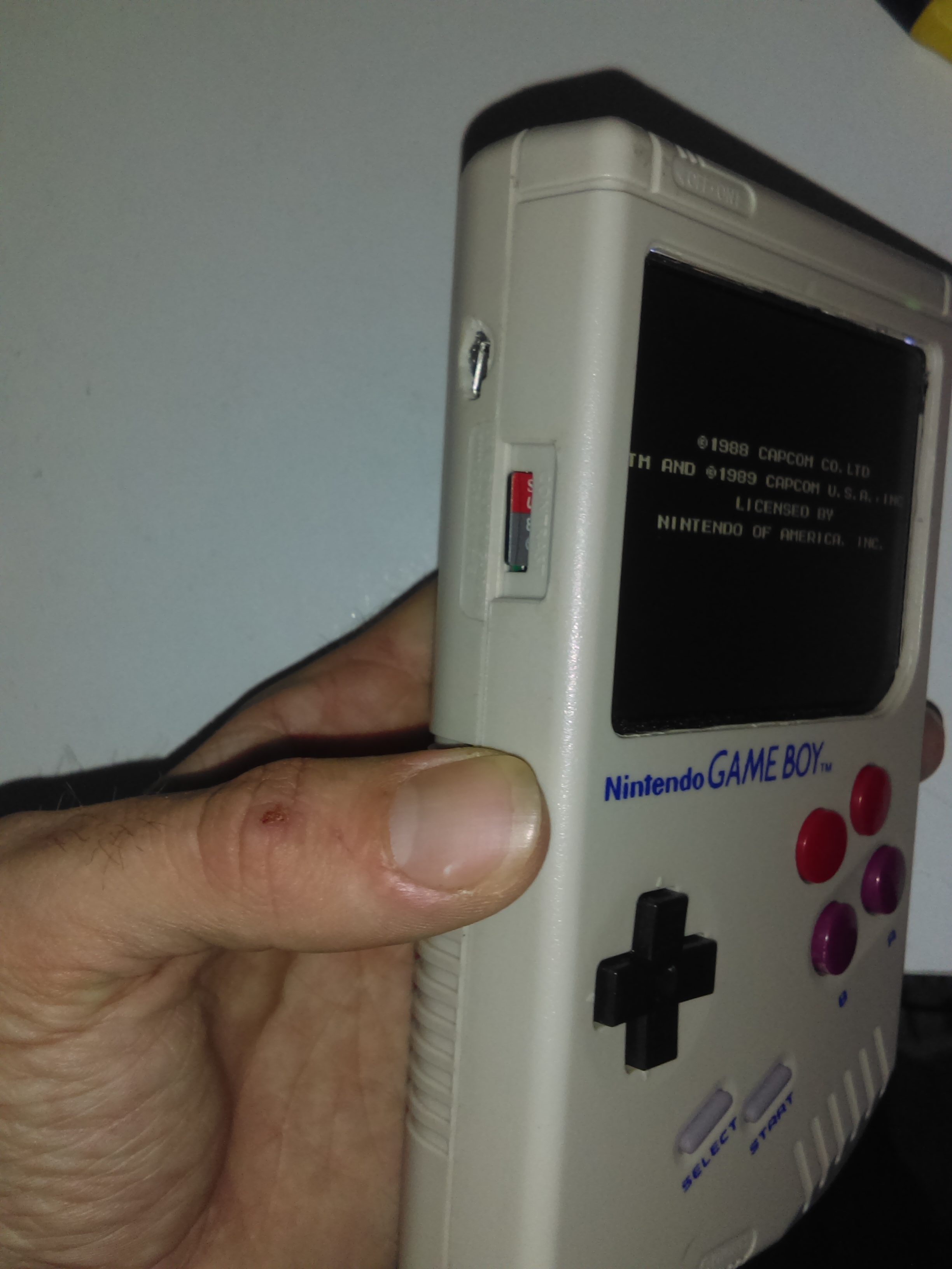

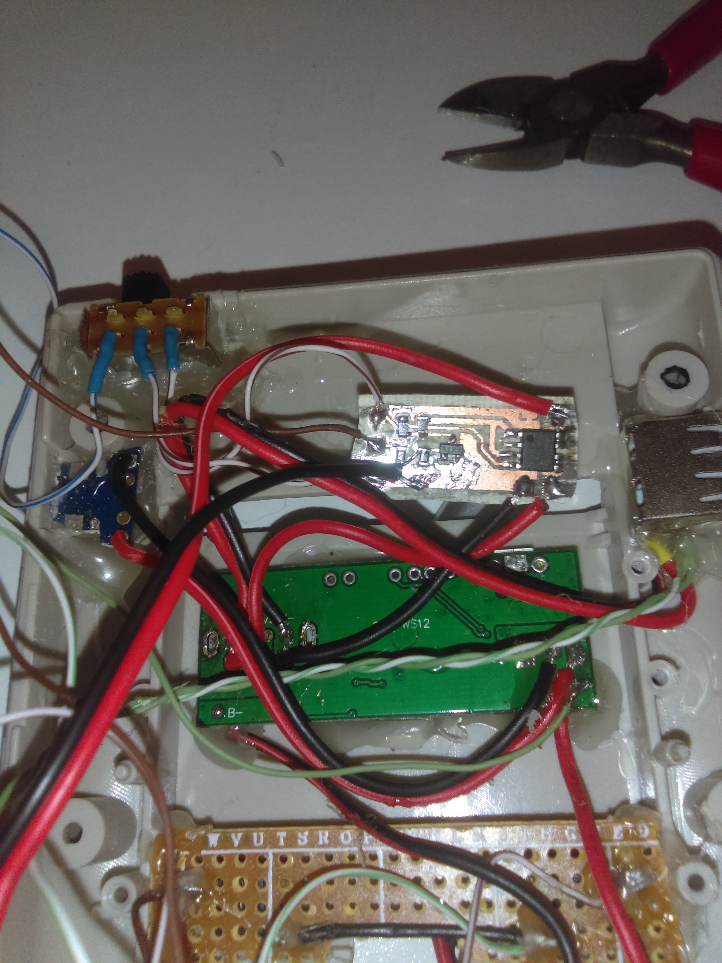

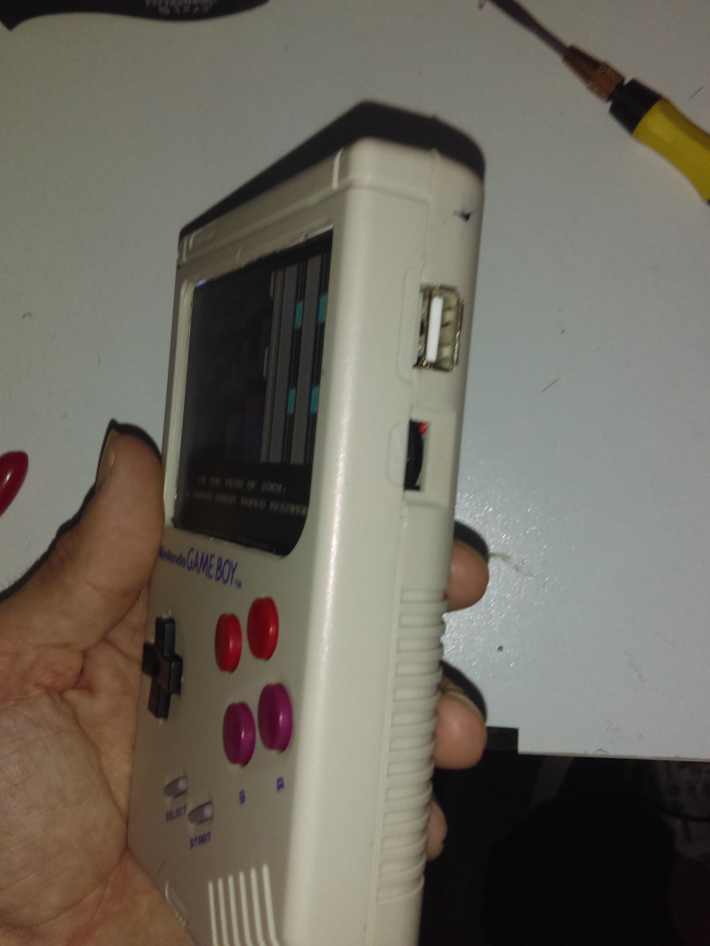

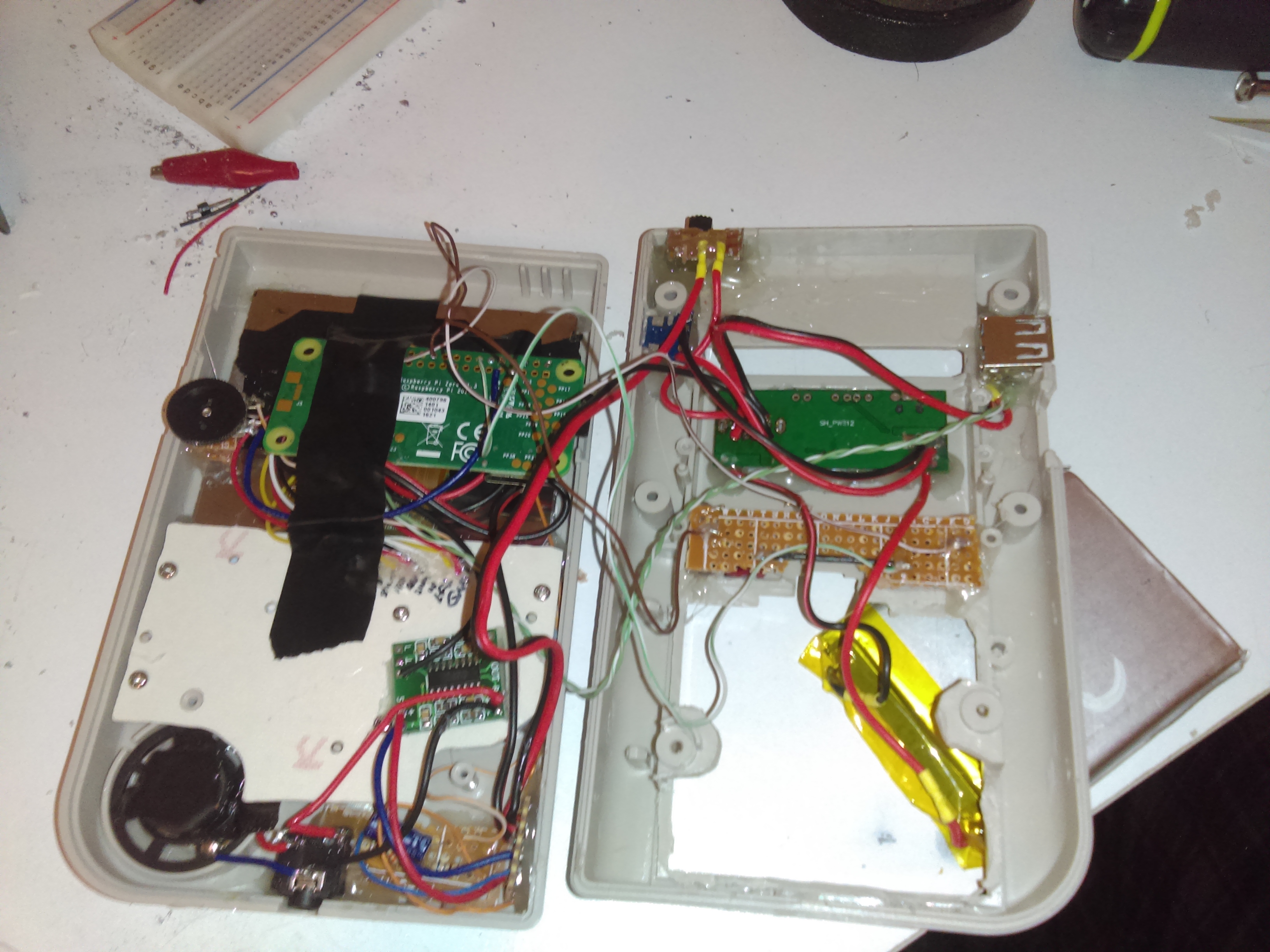

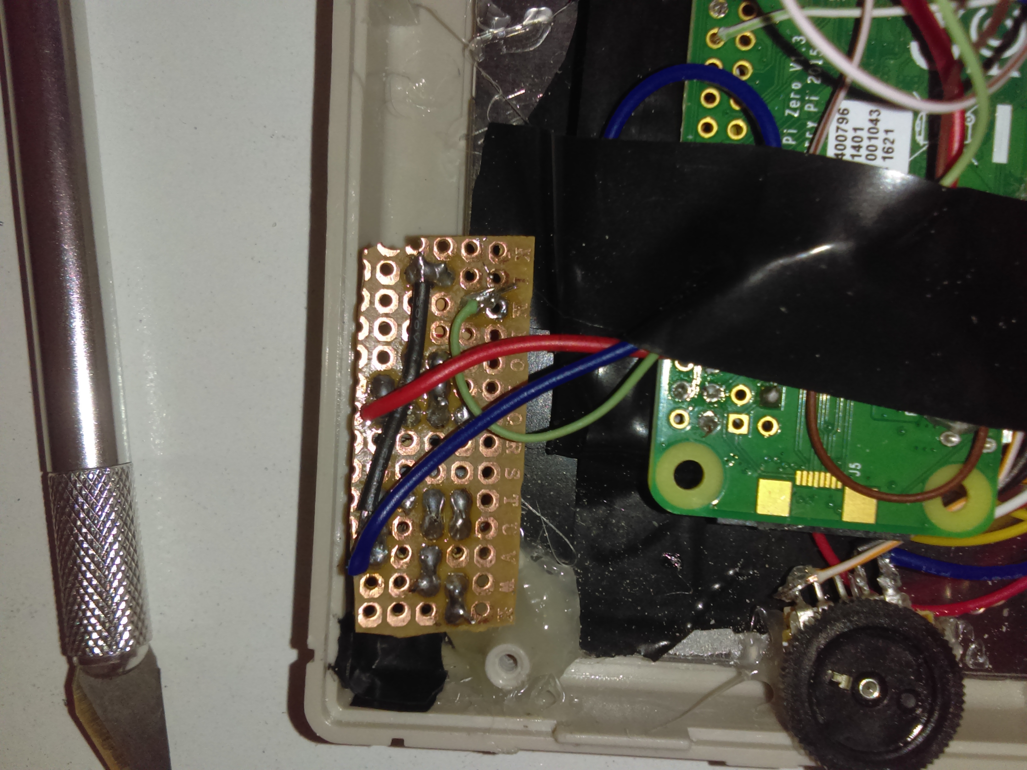

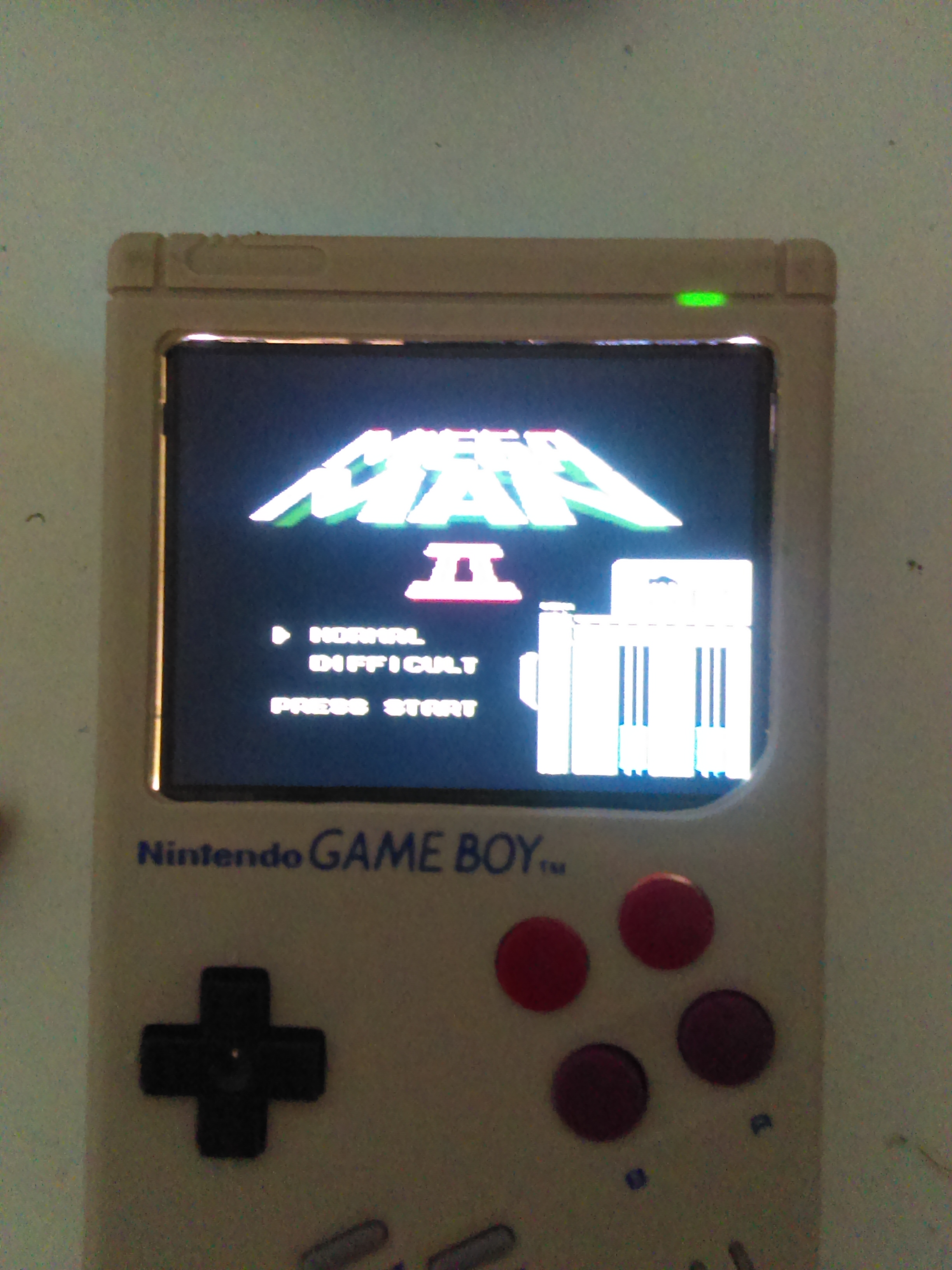

Here's my GBZ that I built recently. Did mine a little bit differently than most on here. Used the GPIO pins for the button pcb and decided to not use a teensy or a usb hub. I etched the button pcb myself but didn't take any pictures of it and its a little hard to get out now. The battery monitor is just using a picaxe 08m2 to read the battery voltage and light the appropriate light on an rgb led. I taped all but a small rectangle in the case so the light only shines through a portion of the line across the top of the gameboy. This does not shut down the pi, it is just an indicator so I can shut it down before the powerboost cuts the output. Thanks to everyone for all the ideas and knowledge on this forum. Still need to get a screen protector at some point. Here's some pictures:

Battery Monitor.
Finished.

Battery Monitor.
Battery Monitor.

The green LED at the top looks great.

Thanks. It goes solid red when there's around 30 mins left and starts blinking red when there's around 5 mins left on battery. I still have one pin capable of being an output left on the picaxe so i may use it to initiate an auto shutdown when the battery gets really low. A lot of this is just taped in so i can add things if i want.

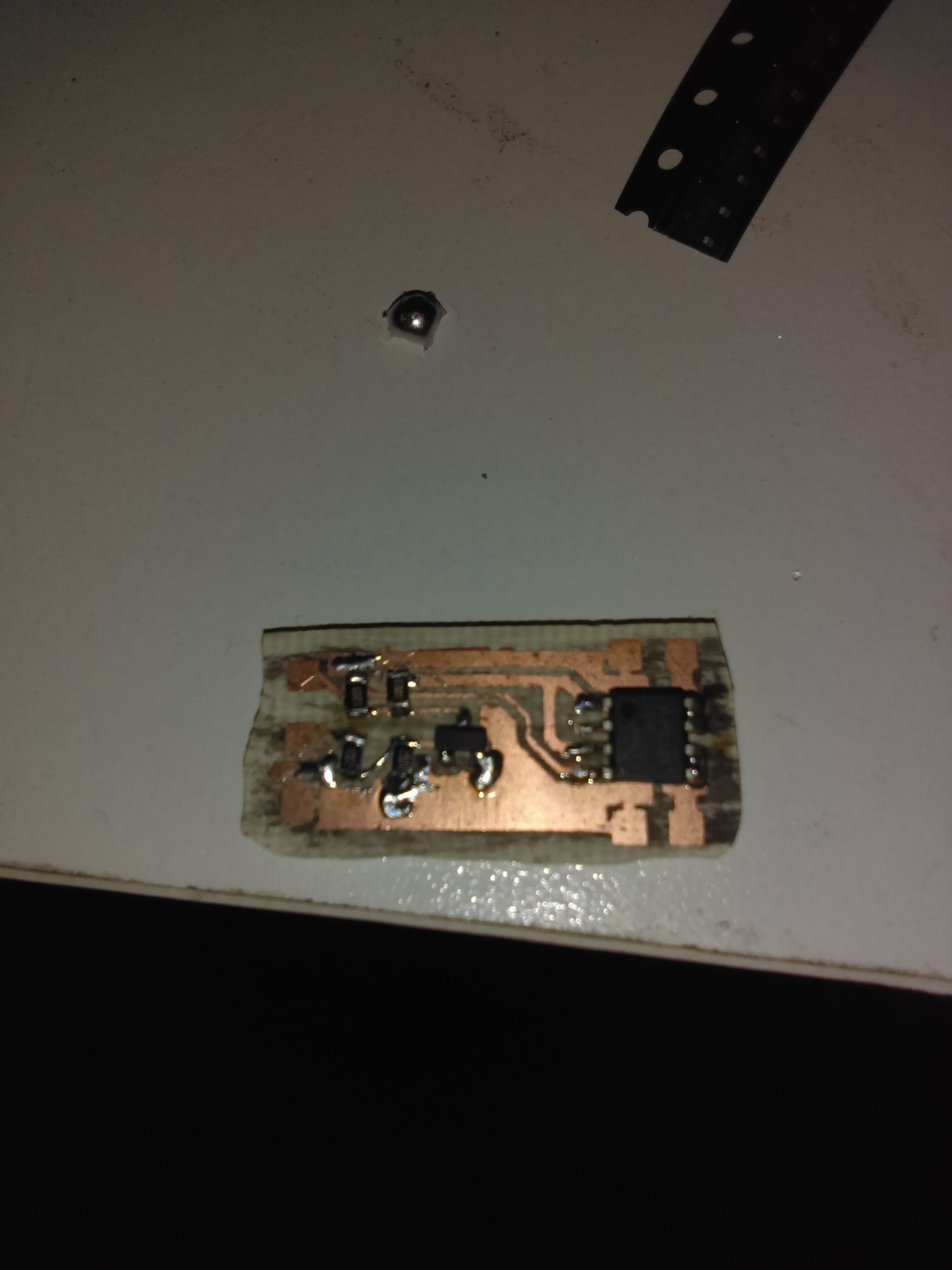

Recently built a safe shutdown board for my gbz. Works well although it does shut the pi down before its finished blinking its led 10 times, which so far has been fine although i think corruption could still occur. Now that ive got this build with all the features that i would need I'm thinking about making a second gbz with a little more care.

I designed the board using eagle then used the toner transfer method to transfer my design to the pcb. I then used ferric chloride to etch the pcb. Its kind of a messy process but you can make some decent boards.
