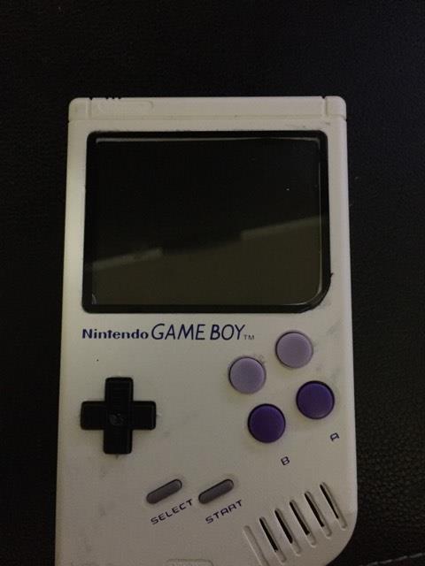

For my gameboy build I wanted to go with a white case and Snes color themed buttons. However, after testing this case I concluded that it gets too dirty, too fast. A black case and different buttons will be used for my final build. For the screen protector I made one using the cover of the original screen case (idea from Chiz). This screen protector is just for my prototype build. I have a screen from dominator waiting for my final build.
[spoiler="White Gameboy pi 3 with Snes buttons"]
Buttons are from an ebay snes usb controller
gameboy off.jpg (23.63 KiB) Viewed 11141 times
[/spoiler]

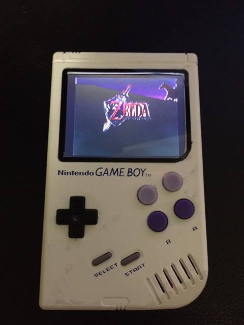

The main benefit of using a pi3 is the ability to play some Nintendo 64 games.
[spoiler="Zelda running on pi3"]
zelda opening.jpg (22.22 KiB) Viewed 11141 times
[/spoiler]

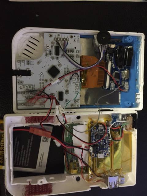

The screen frame and button well print came in very very useful. I'm surprised not many people use it in their builds! Since this is just my prototype, I'm using micro JST cables for testing purposes. In my final build, however, I will use thicker wires for my power circuitry.
http://www.thingiverse.com/thing:1815950
[spoiler="Internals"]
Power circuits
power and usb.jpg (40.34 KiB) Viewed 11141 times
Screen frame with button wells http://www.thingiverse.com/thing:1815950
[/spoiler]

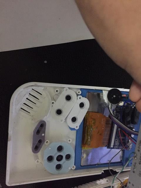

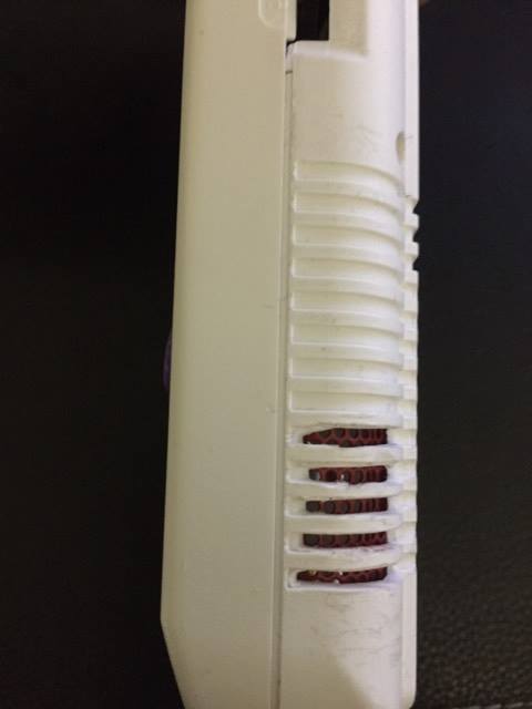

It is no secret that the pi3 and powerboost tend to warm up during use. To alleviate this I attempted to add fans to my build (sorry, no pictures). However, I couldn't find small effective fans. My next idea was to add some ventilation holes and vent openings to allow cooler air to flow in and out. For the side vents I glue a piece of a PCI Slot Cover bracket on the inside to give it a better look. I need to work on carving those vents out.
[spoiler="Ventillation holes and vents"]
ventilation sides.jpg (16.17 KiB) Viewed 11141 times
ventilation holes.jpg (40.27 KiB) Viewed 11141 times
[/spoiler]

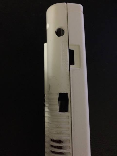

I also wanted to add a second usb port to my build. I made this square hole on the side to achieve this. I'm still debating whether or not to add this to my final build.
[spoiler="Usb port side hole"]
usb hole.jpg (14.11 KiB) Viewed 11141 times
[/spoiler]

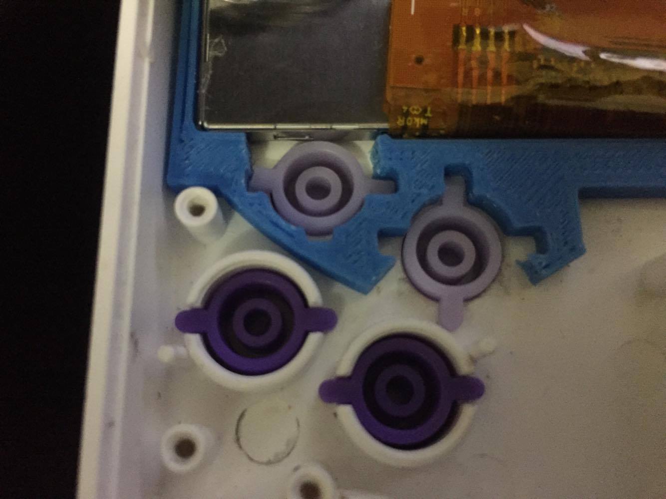

i'm also using that frame the main reason is that i'm aiming for a no hot glue build (epoxy and vhb tape).... i personally found that the button holes dont line up well with helders AIO so i've scrapped those and am gonna incorporate the wermy wells to the frame

I had the same issues with the button wells. However, I just modified the wells in order for the buttons to slide up and down easily.
[spoiler="button well mod"]
button well mod.jpg (90.71 KiB) Viewed 11127 times
[/spoiler]

@[mention]Francis[/mention] A tip from my side: the powerboost 1000c and also the pi3 are getting really hot, especially the powerboost during charging the battery. Maybe you should consider to put the powerboost at the very top of your shell and put some wholes/mesh into the plastic, so the hot air can flow out of the case. I also put some little heatsinks on each of the powerboost chips, as well as on the PIs CPU...

Thanks for that tip! I have been looking for heatsinks and small fans for my build. I will definitely consider moving it up there like you're suggesting.
