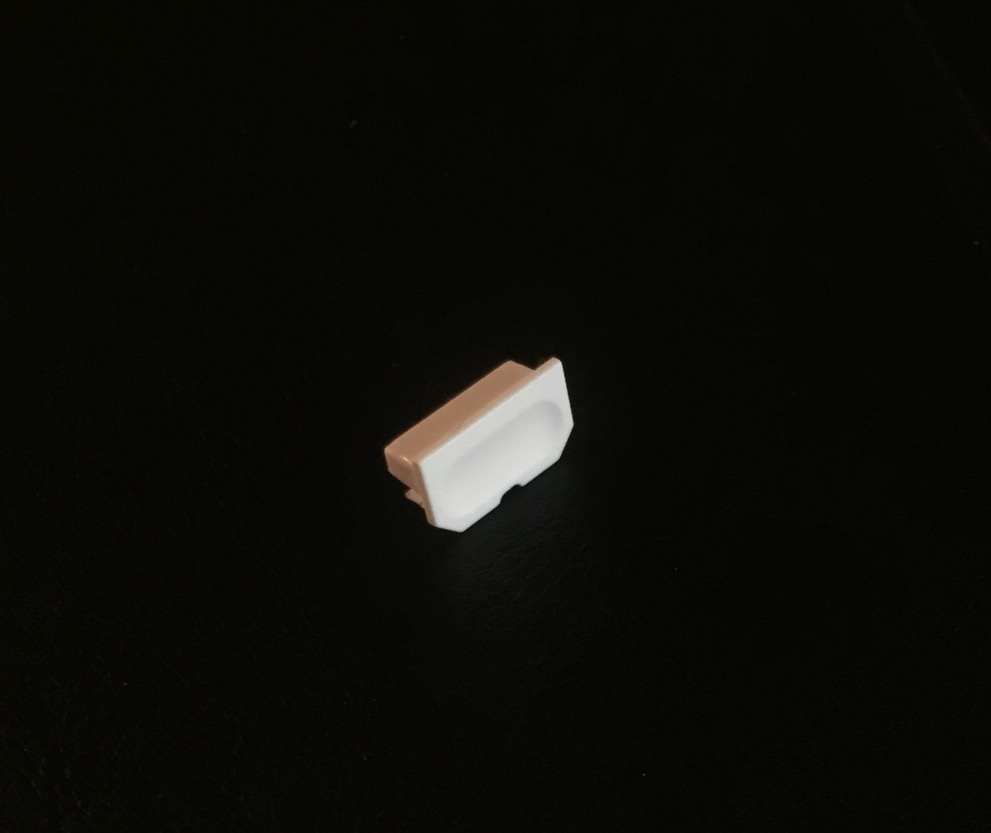

Last thing left was modifying the EXT connector that came with my GB shell.
Took ThisShow

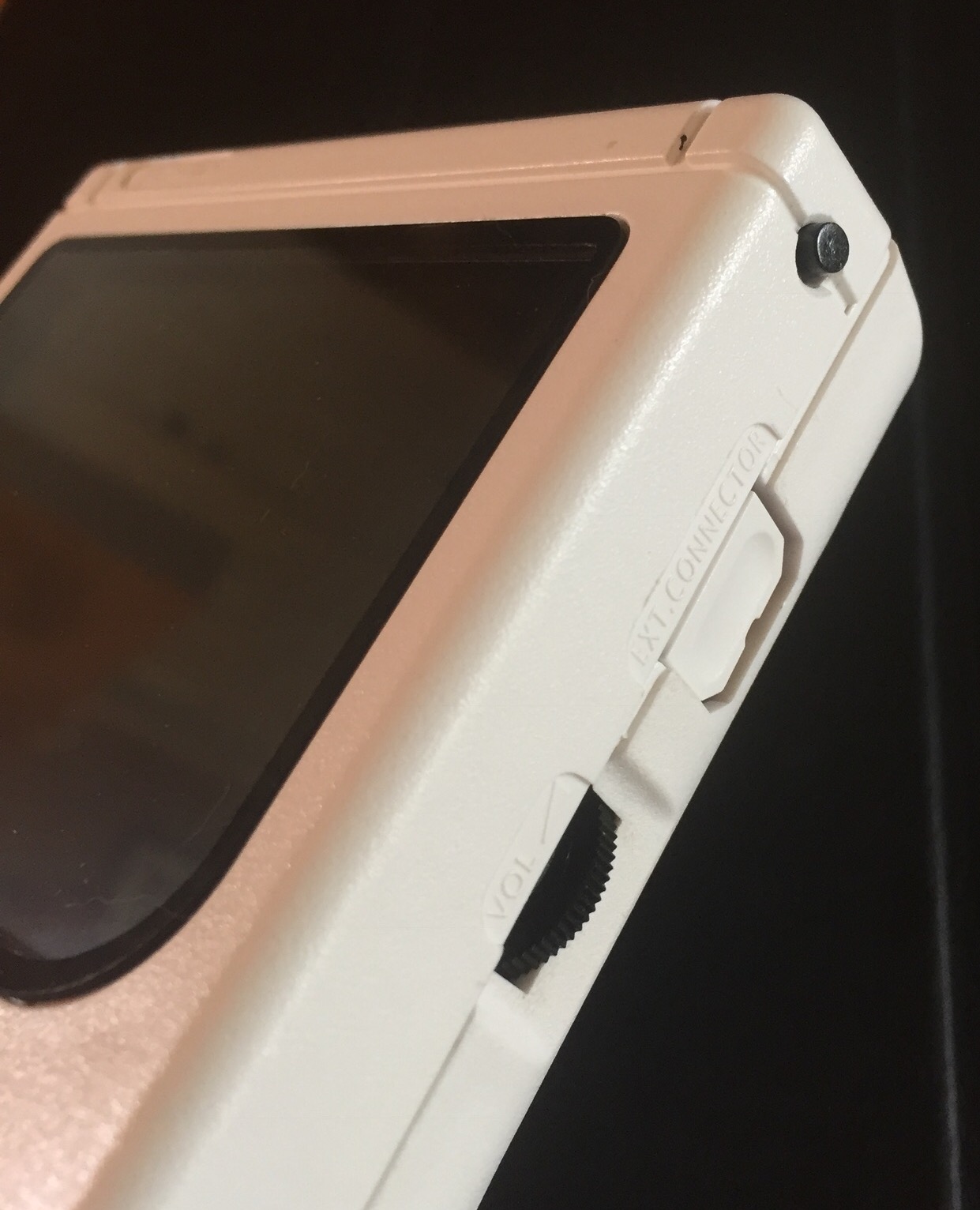

With a Sharp Exacto Knife, Notched It Like ThisShow
Finished ResultsShow
Attaches nice and snug and doesn't fall out but easy enough to remove if USB needed. :D

Yeah this part was easy. It came with my case and saw it sitting there and said, oh I think that will fit the USB port.
Took this.
With a sharp exacto knife, notched it like this.
Finished results.

HoolyHoo wrote:
Mon Apr 03, 2017 7:45 am
Now that latches on to the plastic half of the port itself right?
Thanks for the tip, will definitely do this.
